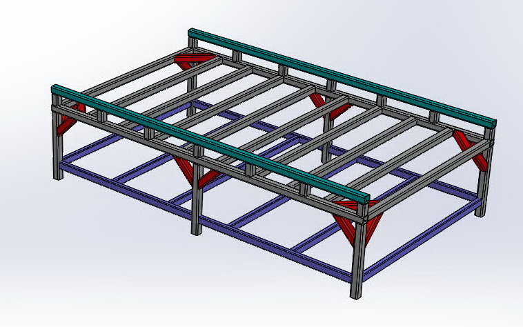

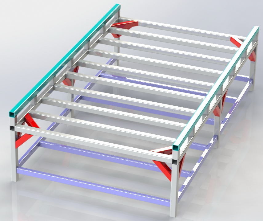

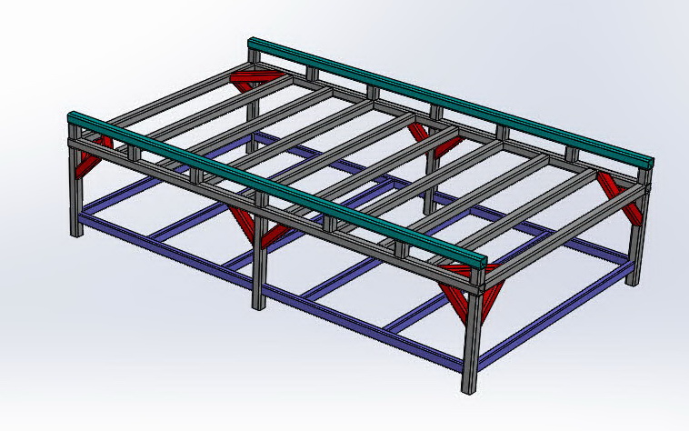

    Looks really nice. Is it 3100mm in the long axis? Are you bolting the plates to the vertical frame first and then weld the cross members in place or have them made before with the 2 plates attached and then bolt them to the vertical frames? Can I pre-drill plates and side members using a jig in a bench drill then tap then start building the frames or I will be way too off?
    Being new to CAD I spend the last 3 days trying o design a preliminary plan of the base. My main concern was to be able to design it parametrically so I can change most of it on the fly without having to redesign it again. So far it works well even though the design structure is like spaghetti code.
    The base steel tubing is 60x 60 x 5 and the lower grid is 60 x 40 x 3.
    The top right and left tubing would be bolted to the base for adjustment purposes if that is an extra benefit.Then epoxy leveling .

    Any particular reason your using so many cross members? Just out of interest how far are they separated? Its certainly not a bad thing, the more the merrier I would think, however I think it would be significantly stronger in terms of deflection to have fewer cross members that where triangulated to the bottom rails rather than more with no triangulation. Having more would be beneficial though because it would support the sheet more evenly along its length.
  10. #19
    They are 311mm apart when the base is 2800 x 1650.I was thinking of having the lower grid of the base free for storing ply .

    The best place to get the Hiwin CAD models is http://www.hiwin.de/en/CAD_Configurator.html
    Most cost effective way to get the rails and carriages is to go east. I would suggest that you get carriages with preload so they do not have any slop, it adds a bit to the friction but worth the extra effort.
    In order to account for distortion etc I would suggest you build, level and then drill. A hand drill with good bits and a drilling jig like you describe is good as long as you make provision to straighten the rails afterwards. Have a look at installation instructions from HIWIN which is similar to this NSK one for ideas on mechanisms to align and adjust for straightness and squareness, if you haven't already done so.
    You could have the top sections on bolts but what would be the benefit if you epoxy level and drill afterwards? From our conversation it seemed that you were not thinking of moving the machine around so stripping it down is not needed. I would have thought that, should you crash the machine, you would need to readjust everything including the rails. In a rigid system, you will potentially only need to readjust the rails.
