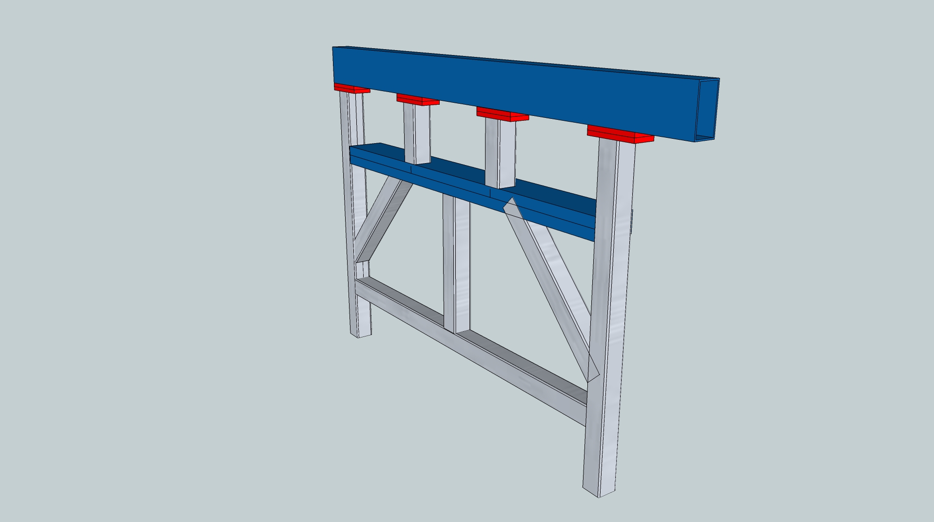

    Thanks pal, yeah I read both of those threads as part of the planning stage for this build. The Bed will be bolted together in the three sections shown. I will try to incorporate some diagonals too, thanks for that advice. As for the Z axis, what do you recommend? I did think about putting another length off 100x100 between the carriage and the Y axis, to lift it a little further but wasnt sure??
    This is the side arrangement I went for, the linear rails sit on top of the upper blue beam, top of the bed will be flush with the top of the lower blue beam.

    The top rail bolts to the bottom section via those red flanges, this allows me to level up the top faces using shims or compressing epoxy putty in the joint.
    I'm planning on 150 to 200mm for Z travel, you have to account for your longest and shortest cutters plus your workpiece thickness plus any sacrificial beds you might add in.

    I wouldn't use that method to build it.? I would drop the extra top rail and just extend the uprights to get your extra height.
    It will save on material and resonance because those will be 2 large drums you'll be creating. To be honest I wouldn't use 100mm Box I'd go with 80mm and thick walled.
    I'd use the design Eddy showed with top rails sat on plates which can be adjusted into plane much easier. The work involved with Epoxy is quite involved and to be honest a complete waste of effort if your going to use those Cheap round rails has there will be more error in there base than the surface your fastening to.! . . . . I also doubt you'll get it any better with epoxy than using the above method and it will take much longer and not be has flexible, it will also cost lot more money.

    On your last picture it seems you were thinking mainly of cutting aluminum . If you continue with this design, take care that the rails on the gantry should be maximum low, near towards the table and as round rails don't like that position nor milling aluminum something has to change there, for starters -square rails.
    Ok I will spend some time converting it all to 80mm box, what wall thickness would you recommend?
    Those rails are only for an idea of where everything will go, in the end I will use Hi-Win rails all round as I have read a lot about there flexibility in use and strength, I just couldn't find a model of then in Sketchup so put the SBR's in just for reference. My main priority is getting the frame completed as I would like to do the build in phases.
    If I extend the uprights and use the plate method to true it all, will five uprights be enough/too many? Or should I leave that as is?
    Also, should I leave the bed in 100mm box as surely that will need as much strength as possible?

    I considered this whilst planning it all, all boxed sections in the side of the frame would be filled with sand, and then the holes plugged afterwards, including the diagonal braces, would this be enough to damp the resonance?
