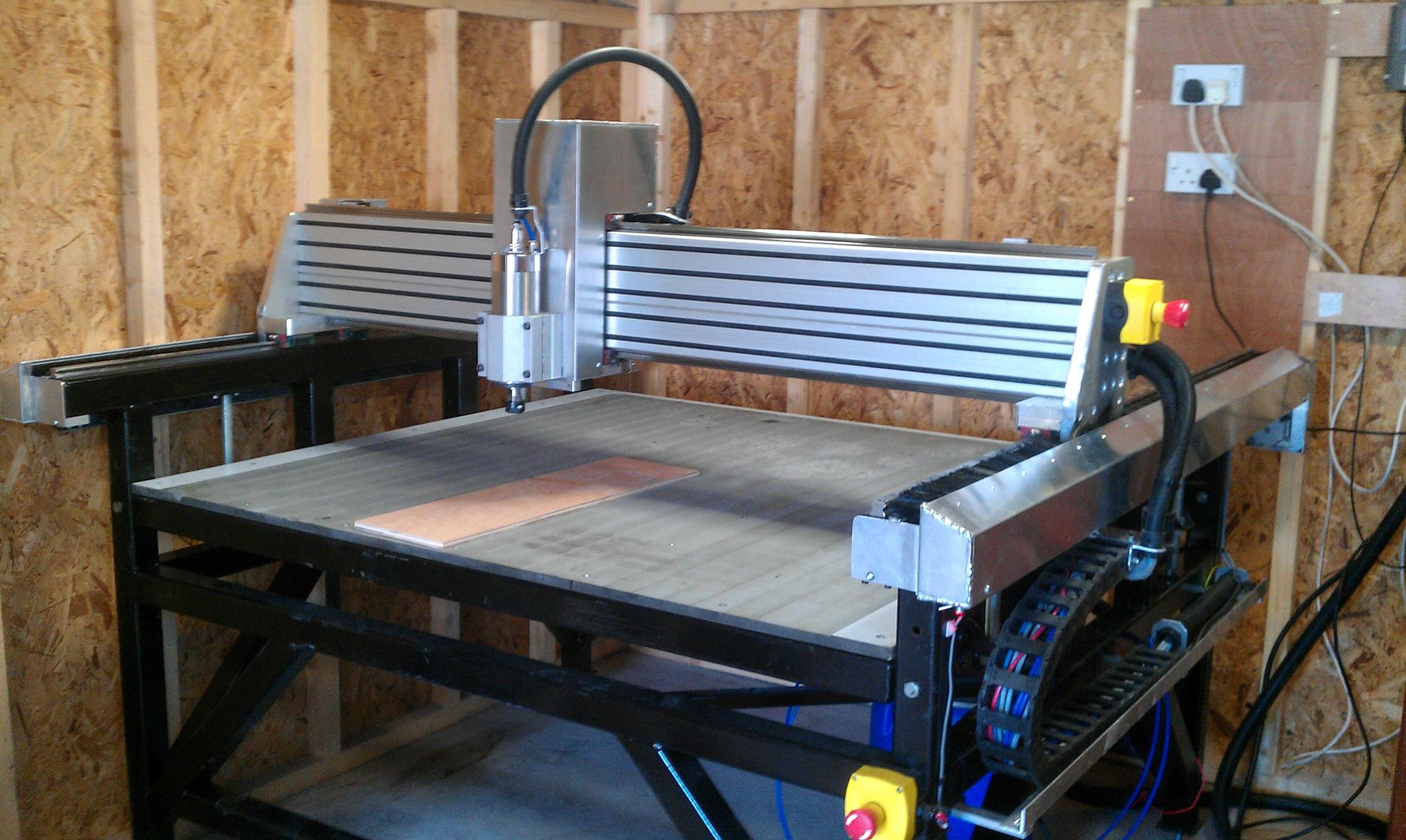

    Here's a 4x4 machine built using similair frame design but with adjustable height bed. Frame is 60x60x5 box.
