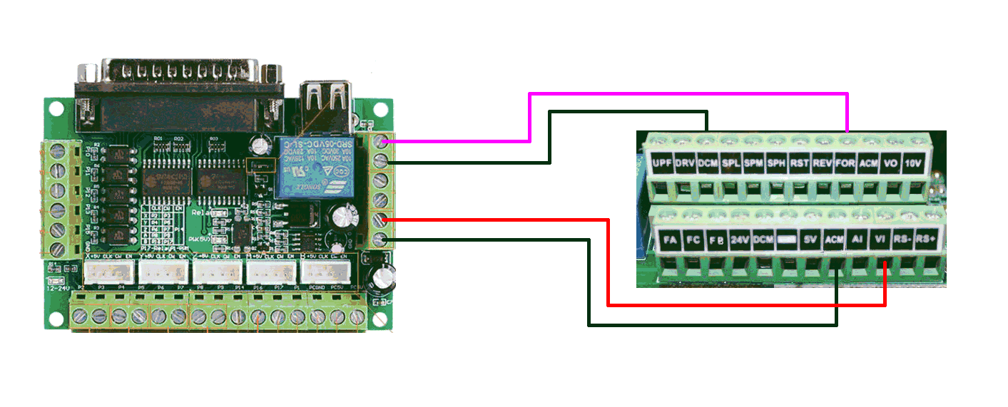

    I hear you, but I don't see how the connecting the FOR-DCM loop through a relay would help the software control the VFD/spindle. For that I need to wire it to the BOB's VFD control interface, which I currently don't know how, as explained in my first post of this thread. I've given my BOB's model and manual already but I don't know how to use the BOB spindle control interface to control the vfd.. I would love someone to provide a simple wiring diagram with on one side the BOB's VFD control terminal and on the other side the VFD control interface and tell me how to wire the together.. I'm so sorry for looking like an idiot, but I prefer having someone explaining it clearly to me so I can understand it, because so far I haven't found such diagram on the forum.. :(

    [ATTACH=CONFIG]It's easy see pic. Here we are using the Relay on the Spindle to Control ON/OFF. (Top 2 wires)
    The bottom 2 wires are 0-10V for speed control.
    You will need to change some parameters in the VFD. These tell the VFD it's being controlled from external source. (Won't be able to control from VFD front panel unless set back to 0)
    PD001 = 1
    PD002 = 1
    Now just set Mach3 up according to manual regards Spindle speed and Relay control.
    Edit: I loaded wrong Pic up first time, should have gone to V1 not A1. (Thanks for spotting Rob)

  11. #59
    PD001 = 1
    PD002 = 1

    Thank you SO much ! I will be connecting these four wires tomorrow and post pictures of the finished control cabinet :) ! Can't wait :D The machine's almost ready :D
    I was also wondering what the 10-24V inputs of the BOB (between top 2 and bottom 2 pins you connected to the VFD) are used for ?

    Quote Originally Posted by eurikain View Post
    It's so you can power using an external source rather than USB and I suggest you do that. USB is unreliable and not to be trusted.
