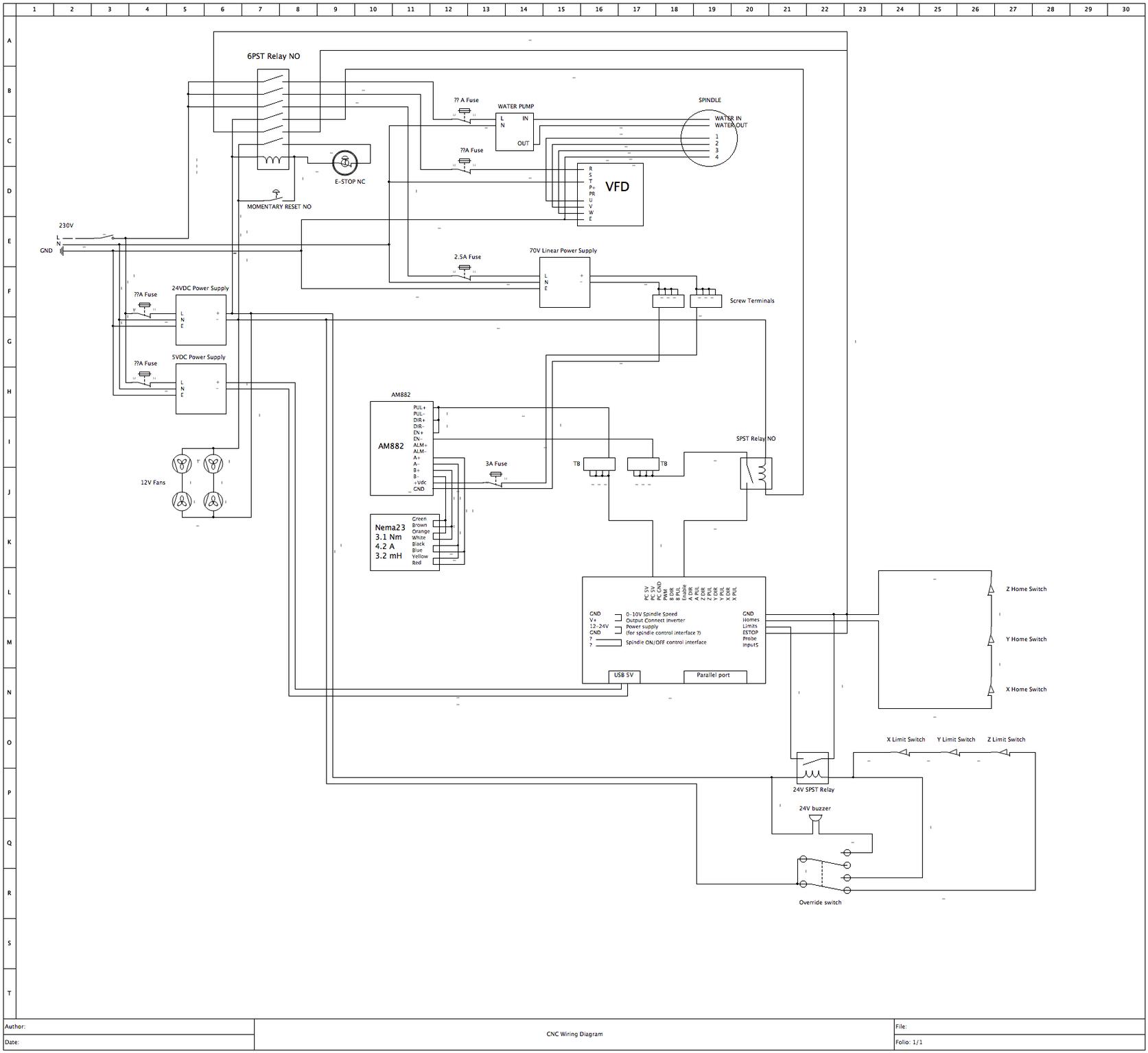

    What's wrong with connecting the buzzer in series ? If you explain to me the role of the override switch and how it works then i'll probably be able to understand what is not right in my diagram :(
    Here is the QElectrotech file, if that can be of any help :)
    Attachment 16860
    The BOB input names are relevant especially when you are asking basic questions.
    I believe you are using two 12V fans in series so that you can power them from a 24V supply now have a look at the drawing re the buzzer and the relay coil and see if you can work that out. (I am not trying to be difficult but you have to fully understand the reason) clue is you are halving the voltage with the fans..
    The purpose of the override switch is simply to provide a path to ground to energise the relay in the absence of a limit being tripped ie opened.
  2. #32
    Alright, I get it now :) Wiring the buzzer in series drops the voltage in half, therefore both the relay and buzzer get 12V, which obviously isn't enough for the relay. So, I need to wire relay and buzzer in parallel and the SPDT switch allows opening the override line that bypasses all switches PLUS a parallel line where the buzzer is. Back to physics 101... ! :D Is this correct ?

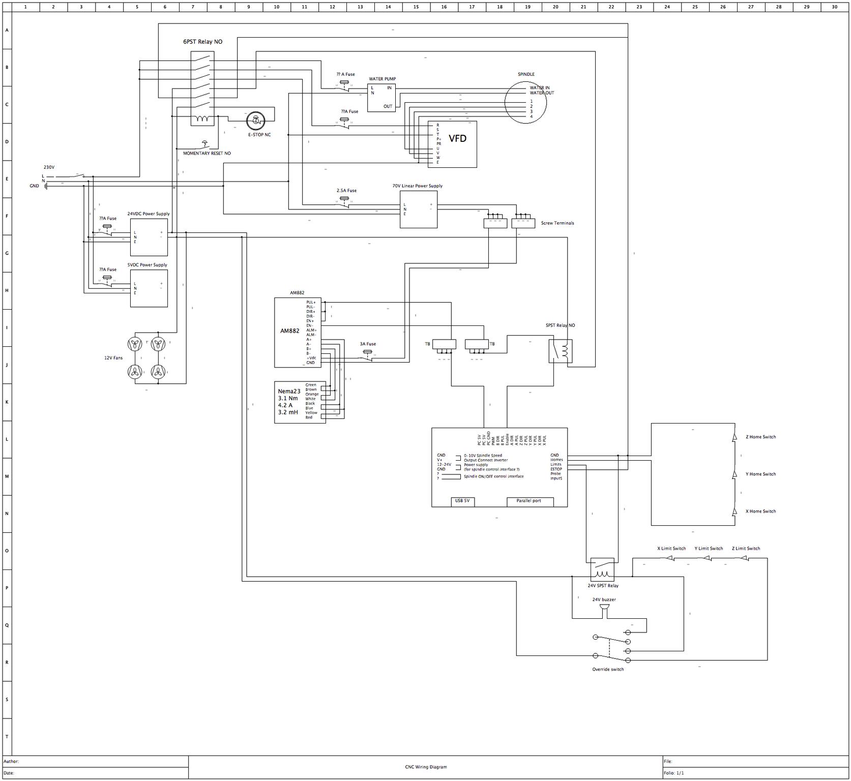

    Ok You are getting there BUT if you look at the changeover switch how is the buzzer going to get its ground?
    I feel it is better for you to work this out and then you will understand it.
    Also if you will allow me to correct the name for the contactor instead of contractor (they are two different things in English.) I also wish I could speak your language as well
  4. #34
    Whoops, forgot to pull that wire :) Sorry !!
    I'm writing on a MacBook Air, OS X keeps correcting my words especially when it comes to electronics. Contactor gets automatically corrected to Contractor.. sorry :D Are you saying my English is bad ? Lord, didn't think it was that bad :'(
    There you go :D

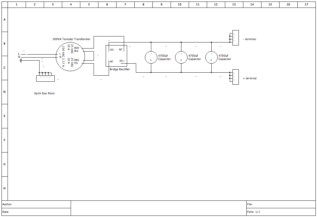

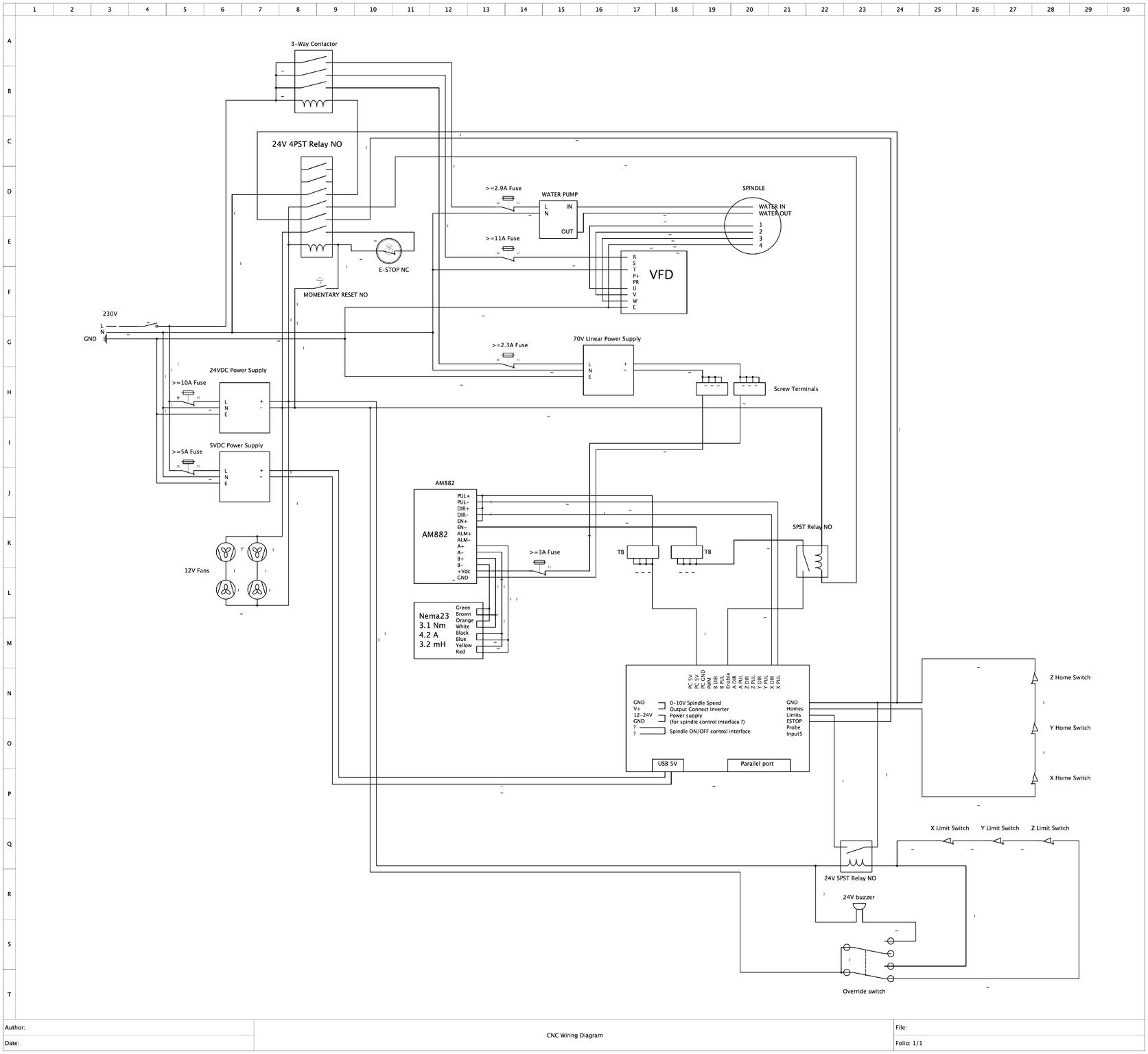

    Last update of the diagrams:
ID:	17262Click image for larger version.
    Note: this is a basic wiring diagram.
    Potential changes / improvements:
    1. Some people don't cut power directly from the VFD, they use a the start/stop pin of the VFD control interface and control it with a relay. This is safer for the spindle, it allows the VFD to slow down the spindle gradually without hurting it. if you really want to cut completely power from the VFD, some people (JAZZ apparently) also use a timer relay that delays for a few seconds the power cut to the VFD I'm not sure how to do it, I will look at it some time, and then modify the diagram in consequence.
    2. Pull earth cable from the star point to the shield of stepper motors and limit switches.
    QElectrotech files:
    qet-files.zip
    Cheers.
  8. #38
    Quote Originally Posted by eurikain View Post
    Statistically you'll use the E-STOP very few times over the life of your machine (unless you're goofy), so stopping all power going to the VFD won't hurt really.
    No this is wrong you'll use the E-stop more than you realise. It's not always an emergency, sometimes you'll need to use it because you realise your going to hit a clamp or or Screw etc and don't have time to get to Control software to stop in controlled manner.
    Who ever quoted me as using Timer relay with VFD is correct but only partly. Mostly I don't Kill power to the VFD I just send it Stop signal.
    Pull earth cable from the star point to the shield of stepper motors and limit switches UNLESS you're using good shielded cable. In my case I'm using UTP ethernet shielded cable so no need for that. Plus I've got a VFD machine, so no real risk IMHO.
    Again wrong. No matter the cable quality the shield should still go to Star ground. Ethernet cable can still be affected and Using a VFD makes it more important to have good grounding not less improtant.!
