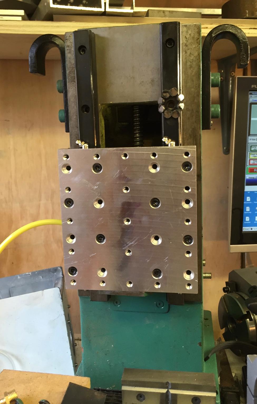

    Just an update
    I decided to bolt two rails onto the dovetail and mount a sled onto those, with a bracket attaching the base of the sled to the orginal Denford Z-axis positioning plate.
    Picture 1, shows the basic sled, provided curtesy of a member on here in response to an RFQ.
    (Also, the neodymium magnets on the right rail tells the tale of my hand-drilling the cast iron of the original dovetail)

    Elsewhere on the site I've discussed the problem with wow/flutter on the spindle, ultimately overcome with using RS485 between the computer and the Spindle Controller. At this time everything works as I'd hope it to.
    That's looking tidy, have you mounted the new spindle to give the same throat as the old one?
