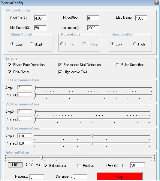

    Im having trouble setting up my drives to my motors. Im using protuner and have not tried using the dip switches. ive got the 4nm motors from cnc4you and it says max current is 4 amps.
    So ive setup pro tuner as follows
    ive even tried the max current at 3 amps which seems to make no difference. I know it should be 4amps but im just guessing at things now.

    The major problem is it keeps tripping the sensorless stall detection even on the x axis where the belt is not even installed on the pulley. Sometimes (but very rarely) ive had it move the z axis (thats linked up with the belt) and the x axes motor only. All the motors seem to move freely.
    Can anyone help as im out of ideas why at the moment.

    You 100% sure it's Stall detect because it only works above 300rpm so if it's not even moving then it won't be that.!! Have you counted the flashes.?
    If this is happening all the time and has done since fitting then I be more inclined to think it's a Phase fault.
    Have you tried swapping the drive with one that's working.?
    Hi Jaz thanks for the reply, i tried a different usb to serial cable and it all came to life which is great.
    it even stops when it hits the limits. Although once when it hit the limit (it cuts the enable signal) then the drive did report a stall. could this be due to it running along (not very fast) and then stoppping dead when the limit takes away the enable? If so is there away to stop the stall, may have been a one off as i havent tested again.

    Yes I was using it as my laptop does not have a serial port so I had to use it when using protuner. For the motion controller I'm using csmio/ip-m. I've done some initial setup but not alot as I wanted the drives to be programmed first.

    One setting i had trouble with is the active high active low setting. On my cnc i control the enable signal so if the enable contacts are being fed 5v then i wanted the drives to be enabled, i found the description next to the checkbox in pro tune unclear/badly worded. But all in all if your drive is ready to go, and is enabled the red led will be off and the green power led will be flashing. Are your drives like this?
    Also in protune once you have made the changes you wish to keep do remember to use the write to eprom button, otherwise when the power is cycled it will forget your new settings.
