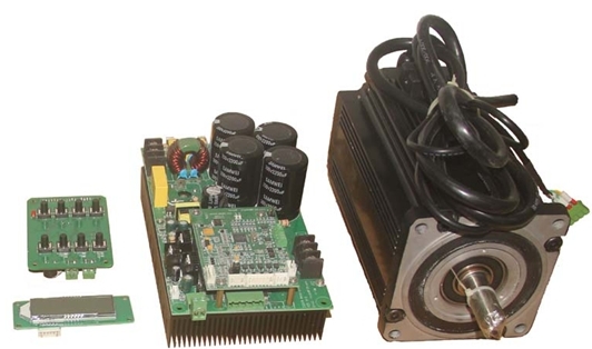

    Whilst I convert my AMA30 to Belt drive i've been looking at spindle options over the classic Chinese spindle. I've come across a company who's producing the following options for a Brushless DC Motor and Controller.
    1100W 3600rpm
    1100W 6000rpm
    2200W 3600rpm
    2200W 6000rpm
    I'm more interested in the 2.2KW version so I've attached the manual and listed the essentials.
    Power (W) Speed (RPM) Shaft Pole Torque (N.M)
    2200 3600 42 8 6.1
    2200 6000 42 4 3.5
    0-5v or 0-10v input for speed control.
    Has anyone used something similar? I mainly mill mild steel and aluminium.

    It looks like it's the same as the kit linked in the following.
    http://www.automationtechnologiesinc...tor-and-driver

    trouble with that motor is theres no torque curve, ive asked beforw
    Quote Originally Posted by andy_con View Post
    Very true although at the price point of these and the chinese spindles, there's no chance of getting one either :)
