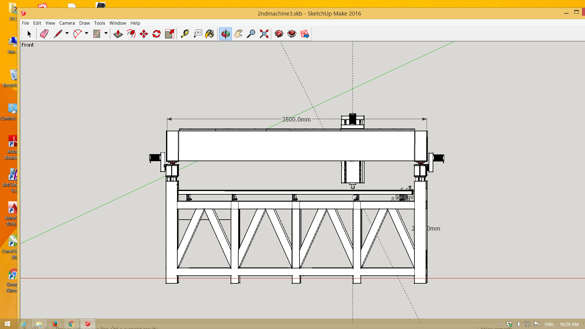

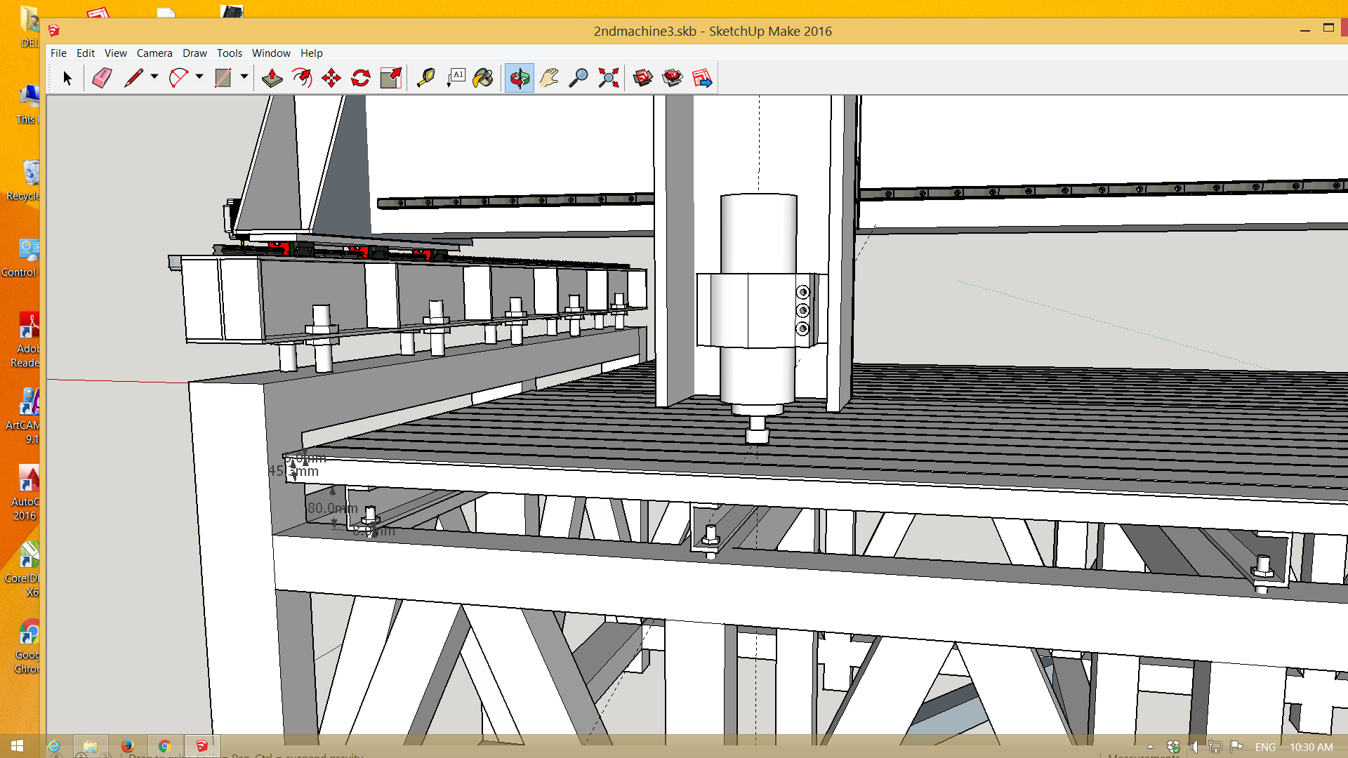

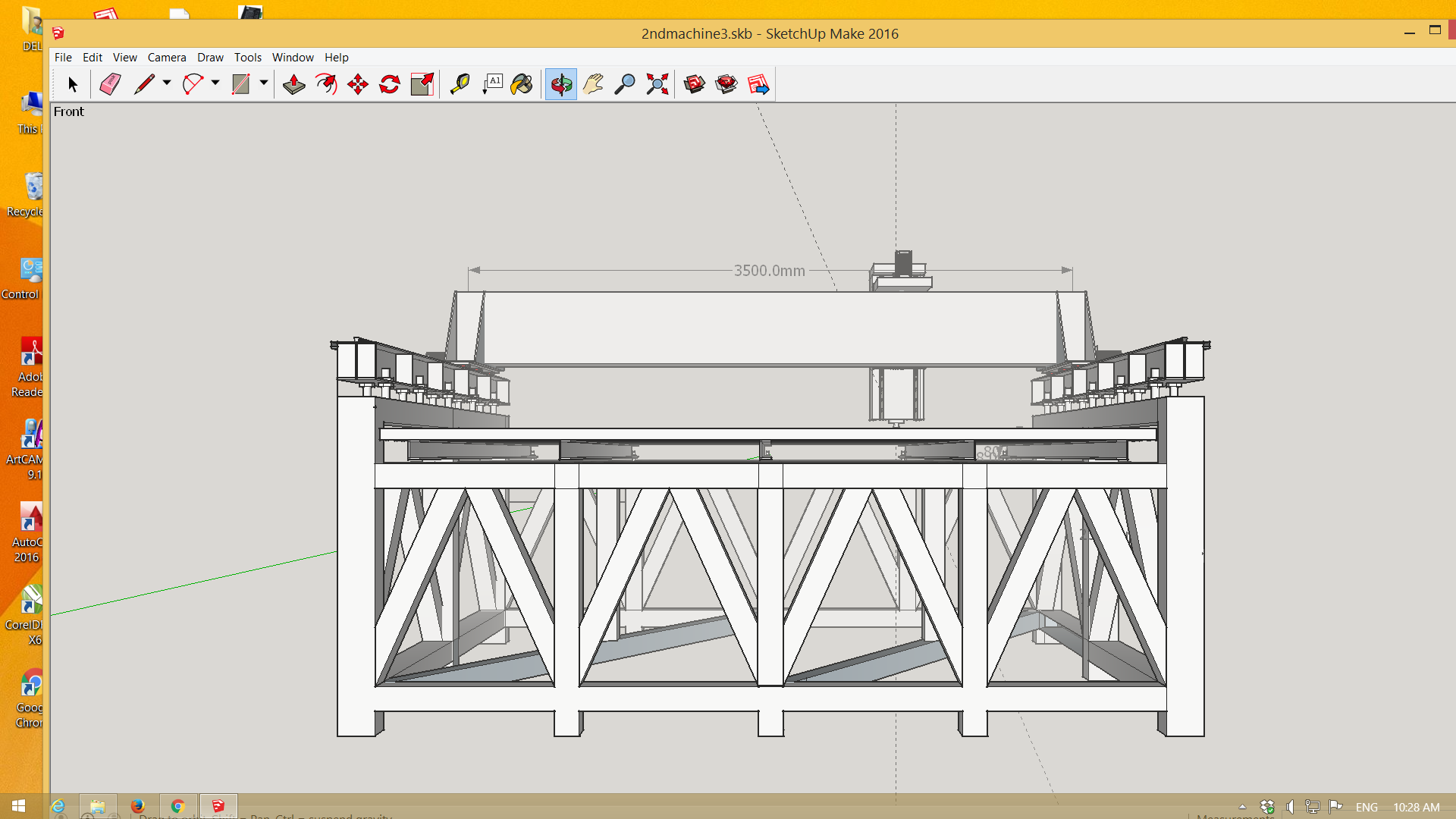

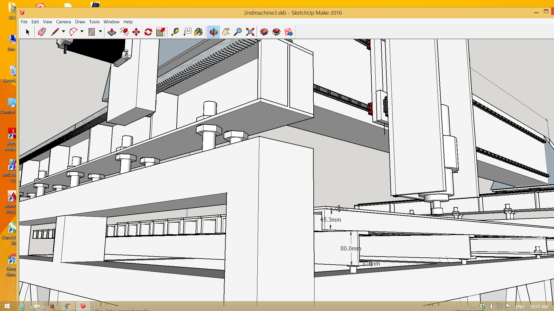

hii jazz i have to agree with you on the point that all stone machinery producers use R&P so i after reading previous threads on large machines and seeing a lot of nice designs i made a preliminary design ,
i made a adjustemnt screws for the y linear guides to adjust parralel and leveled axis,this machine will work on marble and graniteso we nned a heavy body as the wieght of the slaps can reach 5oo kg
waiting for your input
