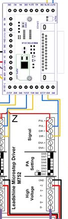

    Maybe a stupid question but I really don't want to fry anything! Can someone tell me how I should connect the enable pins on my stepper drive?

    The drive has an ENA+ and ENA- but my BoB only has an ENA-.
    Thanks,
    Jim
    What Bob is it Jim.? . . . . Also do you realise you don't have to use the enable on the drive if you don't want to. ?
    Hi Jazz,
    Sorry its not so clear in the image I uploaded is it...
    Its a pcpps bob
    http%3A%2F%2Fwww.diycnc.co.uk%2Fforms%2FPCPPSV3.pd f
    And the drive is a leadshine m752.
    I have been running without using the enable function (nothing connected on the drive) but i wanted to understand how it could work really.
    Cheers,
    Jim
    Yes I had a feeling it was PCPPS.
    just take Ena(+) on drive to Ena pin on BOB and Ena (-) on drive to Gnd on BOB. You'll then have to set the Enable output in mach and tell it which pin number.
    Great, thanks for that Jazz I will give it a go. :)

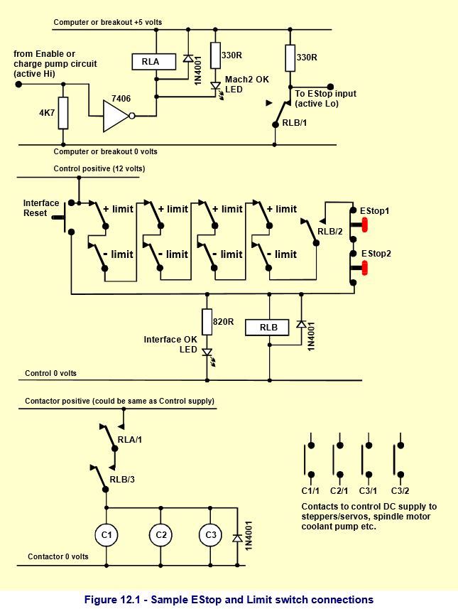

    Follow up question, should there be a power up order for the PC, BoB, stepper drives, Vfd etc?

  7. #6
    Quote Originally Posted by cncJim View Post
    Cheers,
    Jim
    It is always good to power the PC up first the BOB and Drives would come on together and it is optional for the VFD as you might want to get the holding down and zeroing done before powering that up.
  8. #7
    Clives correct but really if control is done correctly it would go like this.!
    PC First then turn on Power to control box which turns on the BOB and Low voltage PSU for safety. Then the drives etc come on when you push the Reset button and only if every thing is safe do so.
    This way if the Control software isn't in control and ready. ie: PC crashed Bob will disable motor outputs because no charge pump.
    Or if the E-stop is pressed safety system won't turn on the drives, vfd etc.
    Or if limit is pressed the system will reset and drives will turn on but won't enable there outputs and also shouldn't allow control softare to reset.
  9. #8
    Merry Christmas! Thanks for the replies and advice Clive and Jazz.
    I am following the sample circuit from the Mach3 manual:-
    Would using this give everything needed or is there something extra to do/add?
    When talking about the charge pump, is that essentially the ENA- pin of my BoB?
    Thanks,
    Jim
