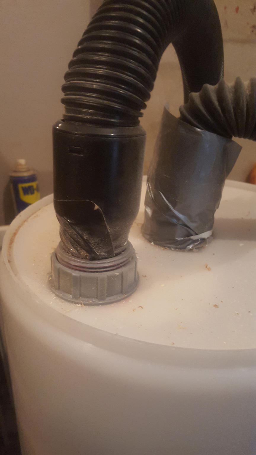

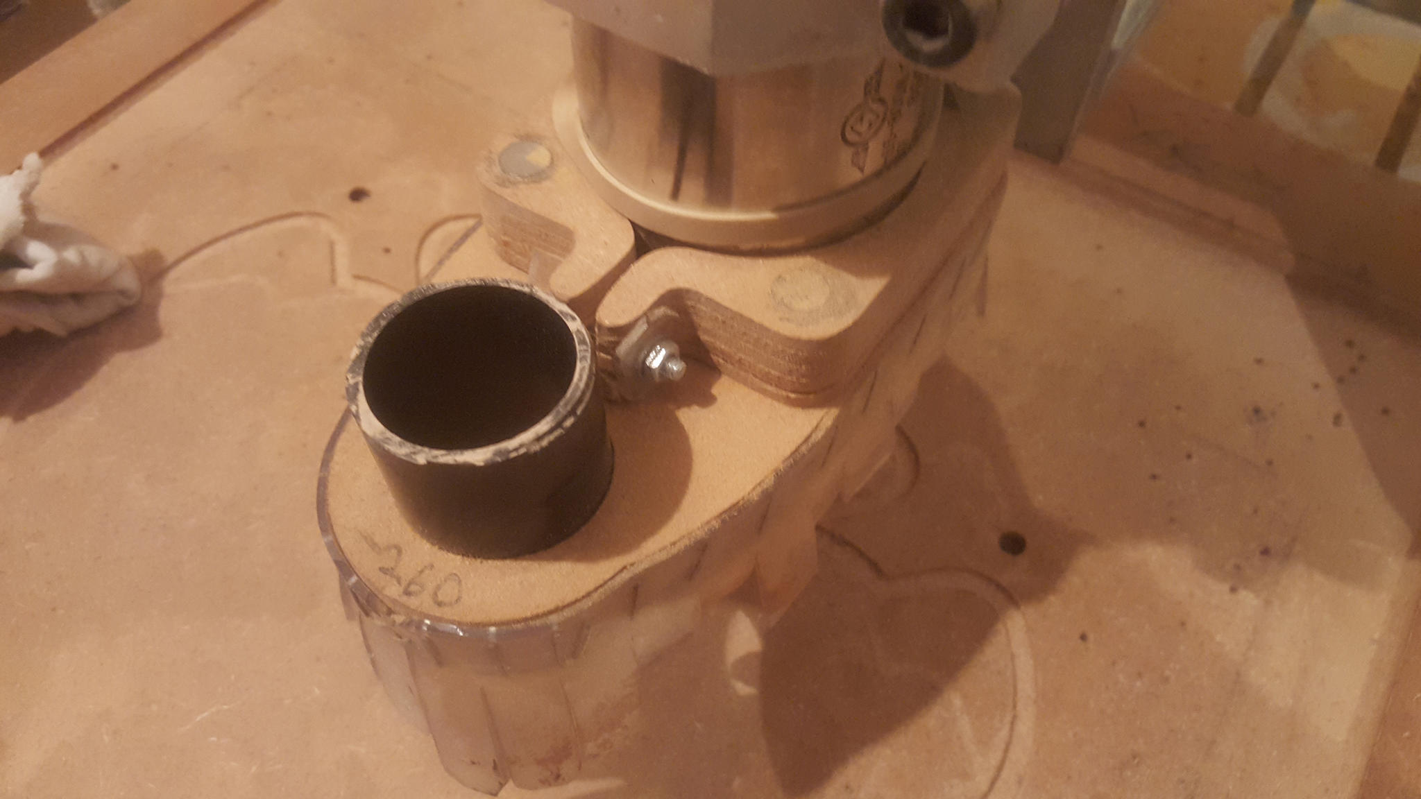

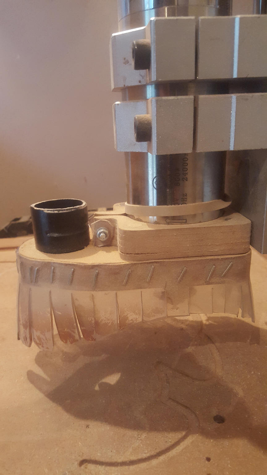

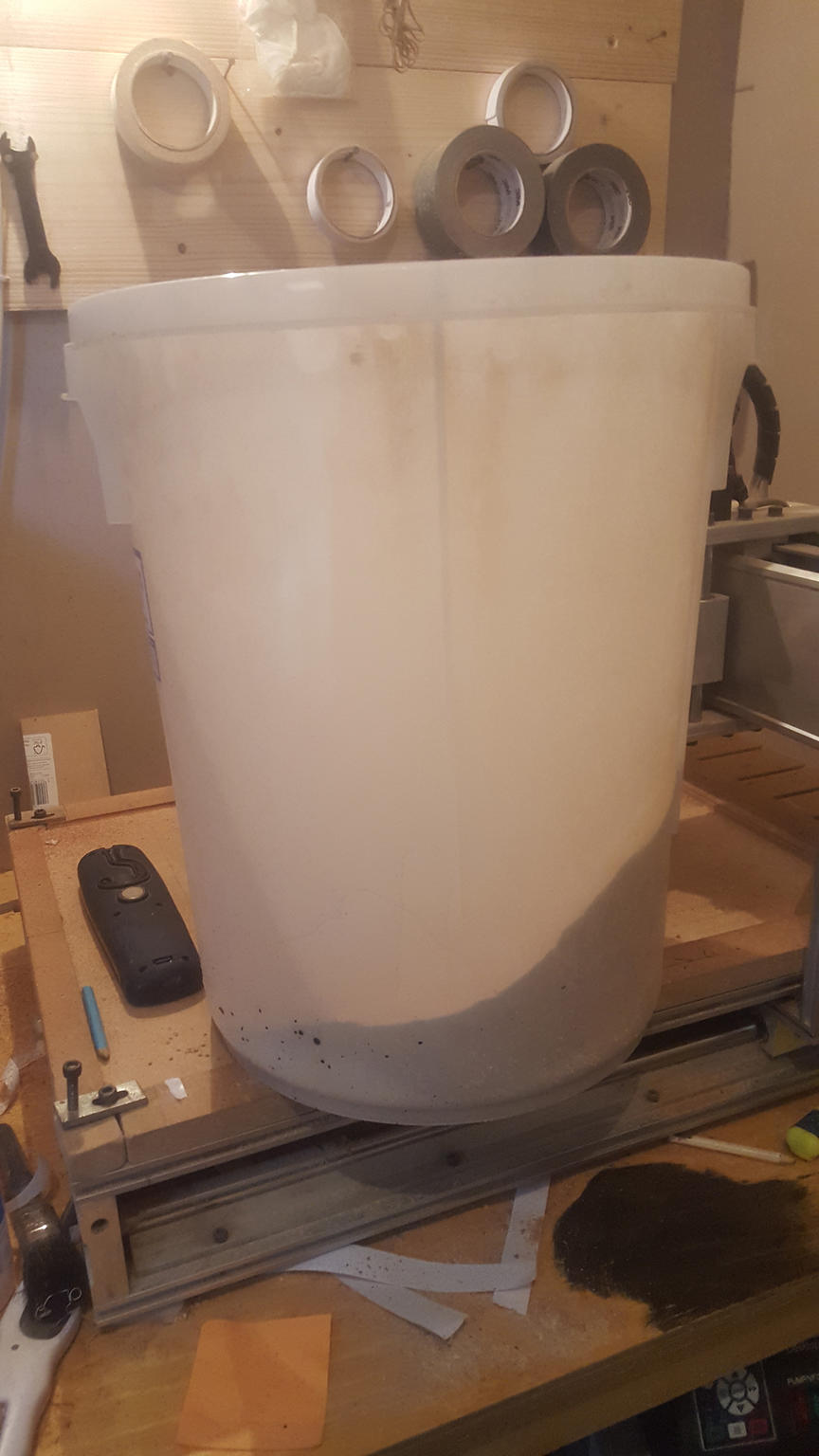

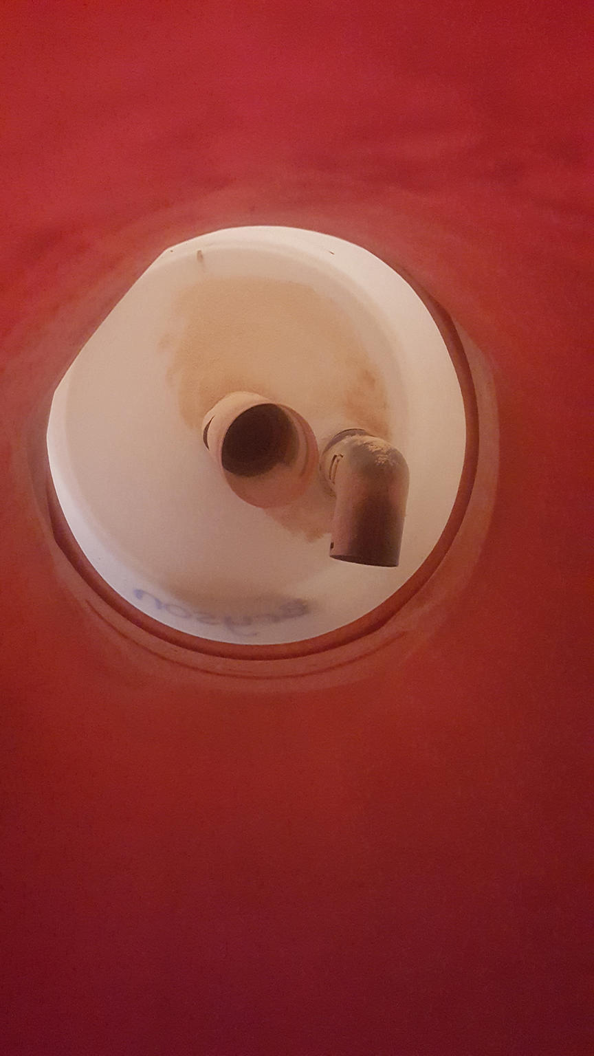

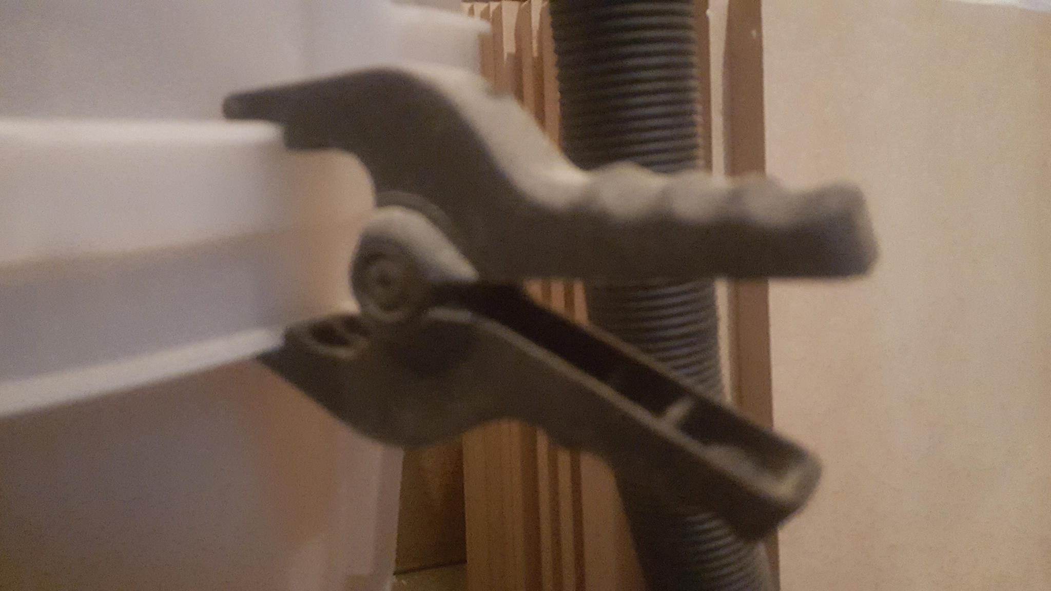

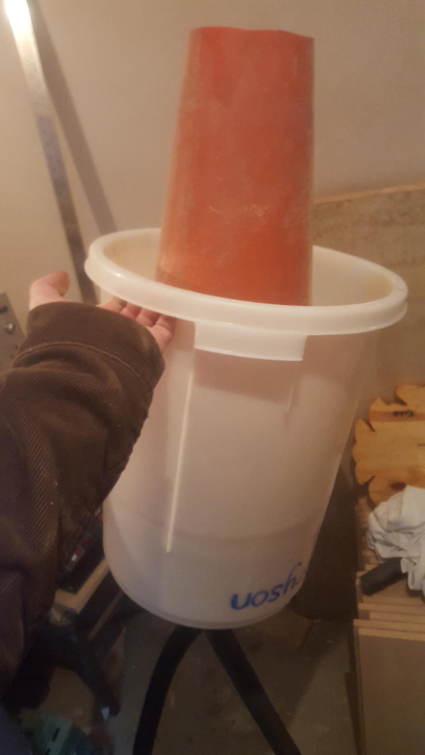

    Hi guys,
    I had a go at making a cyclone dust extractor.
    I used;
    1 Old broken hoover I had in the attic. Dump nothing!

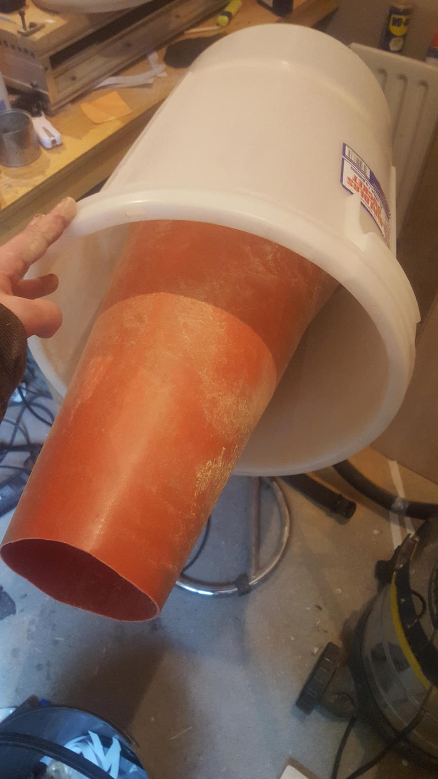

    1 Traffic cone I acquired one drunken night way back..!
    2 Plasterer's buckets I bought for this job - £14.
    2 Flangey plastic screw-on fixture thingys from the same shop - £3.
    2 Plastic spring-clamps.
    1 Shampoo bottle.
    Lots of Duct tape.
    It works a treat.

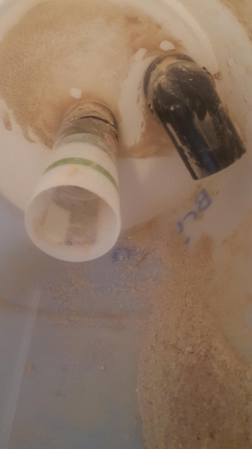

    I managed to bodge all of the hoover attachment bits out sawing up of the old hoover
    tube bits. I even got the the angled bit off it!
    The best bit is how the traffic cone just sticks to the bucket! I just jammed it up
    in there and it worked! If it ain't broke...!

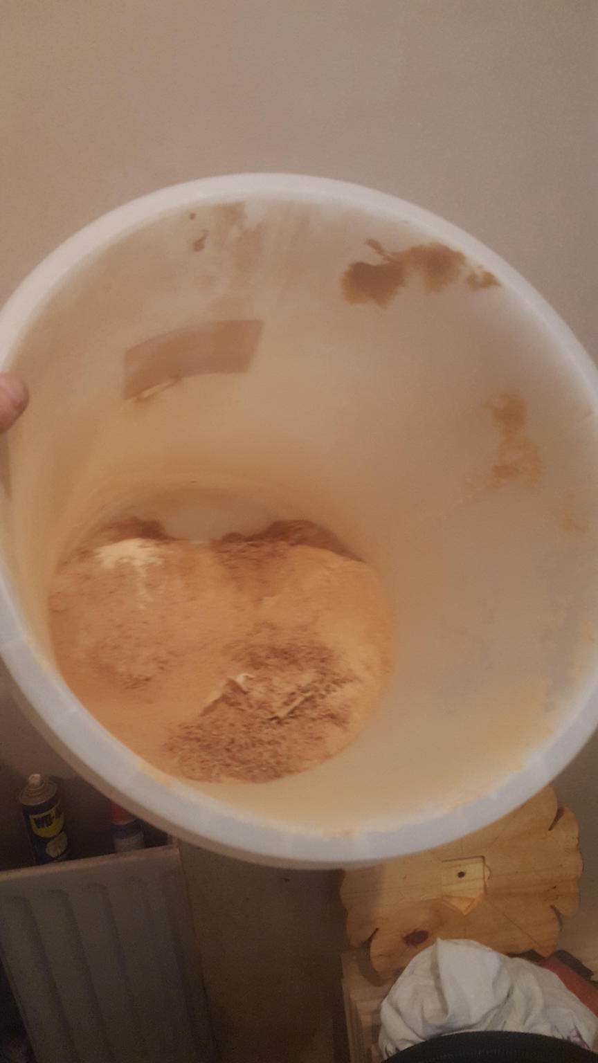

    I am very happy with how it works. It gets 90% of the chips and dust. I have filled
    the bottom bucket 3 or 4 times now and the hoover bag isn't even half filled!
    I'm open to suggestions for improvements!
    Thanks guys,
    Kevin.
