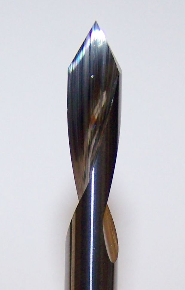

    1. 1/8 or 3mm fishtail spiral 2 flute Kyocera from drillman1 . 12-16mm flute length. These are the most outstanding bits this size ever, especially for the price, not worth buying inferior or more expensive.
    They are good for small jobs on all plastic, wood and aluminum. Buy at least 2 packs x10 each, one the fishtail and one normal flat bottom

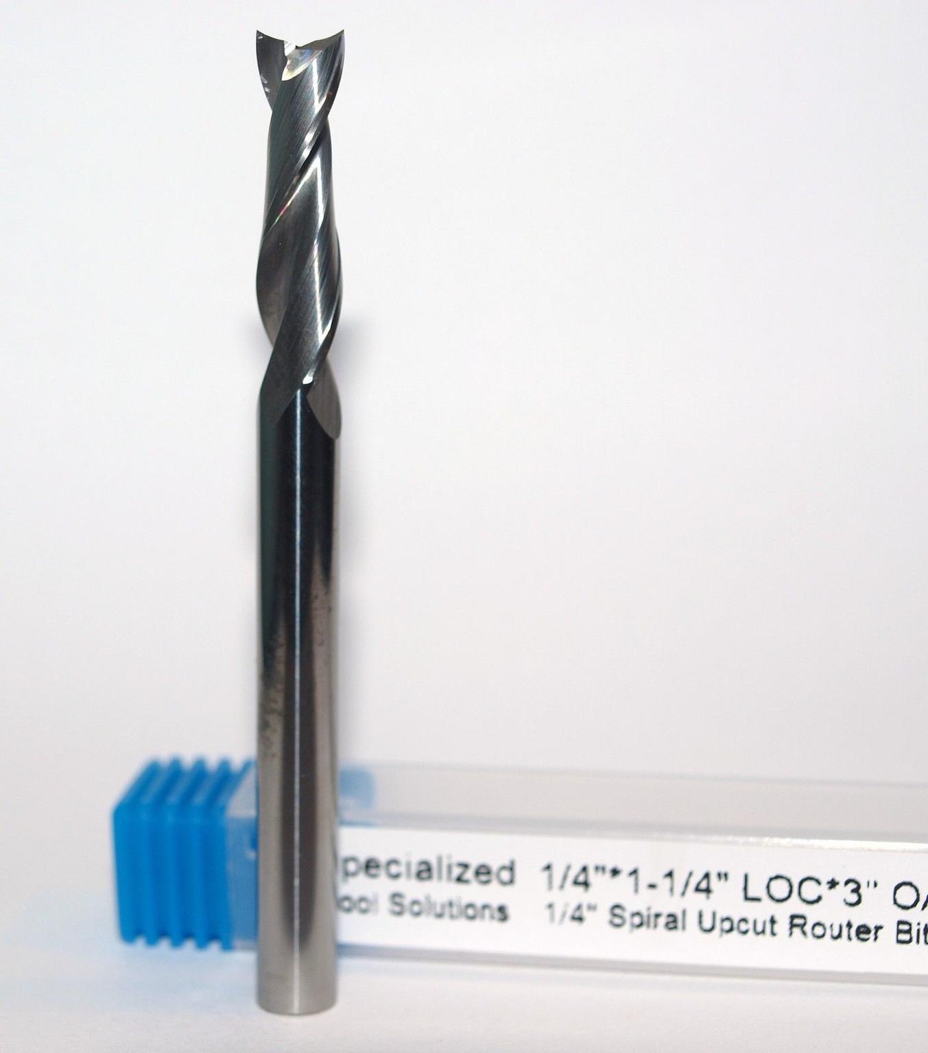

    That bellow is the perfect geometry i like and i have found is best for wood

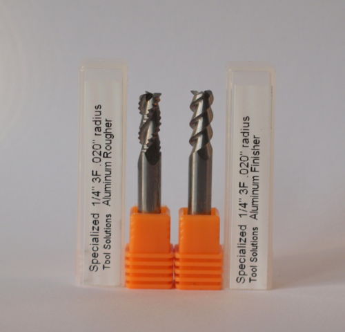

    -aluminum could be done better with roughing bit and later proper aluminum bit with different geometry
