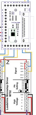

    Maybe a stupid question but I really don't want to fry anything! Can someone tell me how I should connect the enable pins on my stepper drive?

    The drive has an ENA+ and ENA- but my BoB only has an ENA-.

    What Bob is it Jim.? . . . . Also do you realise you don't have to use the enable on the drive if you don't want to. ?
    Hi Jazz,
    Sorry its not so clear in the image I uploaded is it...
    Its a pcpps bob
    http%3A%2F%2Fwww.diycnc.co.uk%2Fforms%2FPCPPSV3.pd f
    And the drive is a leadshine m752.
    I have been running without using the enable function (nothing connected on the drive) but i wanted to understand how it could work really.
    Cheers,
    Jim
    Yes I had a feeling it was PCPPS.
    just take Ena(+) on drive to Ena pin on BOB and Ena (-) on drive to Gnd on BOB. You'll then have to set the Enable output in mach and tell it which pin number.

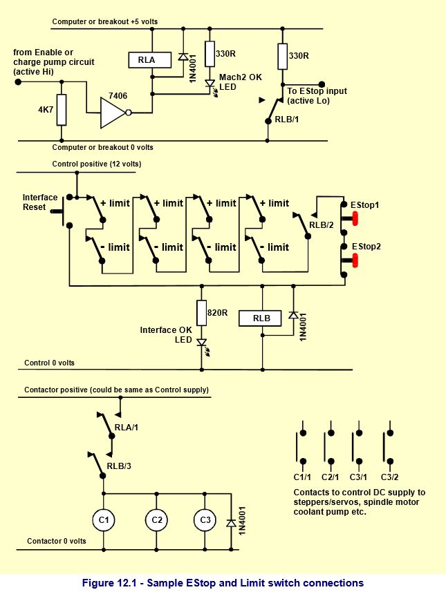

  9. #8
    Merry Christmas! Thanks for the replies and advice Clive and Jazz.
    I am following the sample circuit from the Mach3 manual:-
    Would using this give everything needed or is there something extra to do/add?
    When talking about the charge pump, is that essentially the ENA- pin of my BoB?
