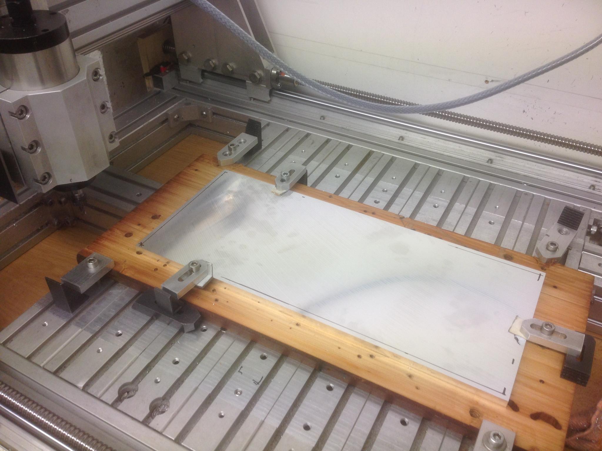

    Machining the pocket - no adaptive toolpaths I'm afraid so about 1 hour to machine this:

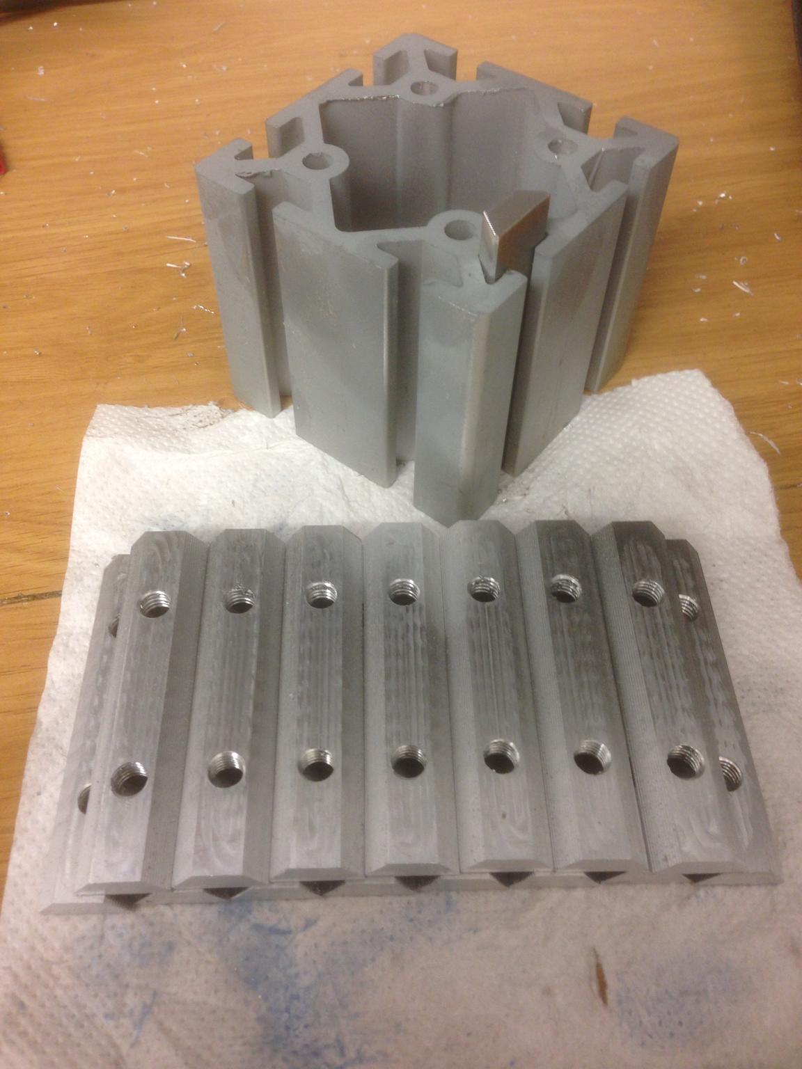

    All holes drilled to size, tapped, then on the very last hole backing the tap out - it snapped ! Aargh!
    Tap was 12mm into the part and bashing and picking was not working. Flatten the end off the centre punch so that was no good.
    Got some Alum powder (about £3.50 off ebay for 2x100g) and mixed up a solution with hot water:
    Then dropped in the part, and you can see it bubble straight away (bottom right hole).
    After a day there were lots of black specs and a general browny dust settled onto the part (hole now top left).
    But even after a couple of days it had only eaten about 0.5mm groove in the top of the tap. At this rate it was going to take weeks.
    I tried a masonary bit (3mm tungsten carbide tipped) on a very low speed in the pillar drill and this gnawed away at it for about 15 minutes. The drill kept trying to wander off into the aluminium at the sides, so I flipped the part over and put the drill bit into the hole hoping this would guide it. It made a sound like it wasn't enjoying it much but I pressed on. After another 15 minutes of drilling I got to within about 4mm of the surface, and then the drill broke and got stuck in the hole. Luckily I managed to get it out. I've since put the part back in the Alum solution. I think another go with a 3mm masonary bit will have drilled the last bit out, but I think the thread might be beyond use. I could probably live without that bolt and use the other 5 but it is annoying me now. I'll clean it out and see what to do. Could enlarge the hole then make a plug with a flange on it and press it in from the reverse side, then drill and tap into that. Probably tap it before pressing it in just in case !

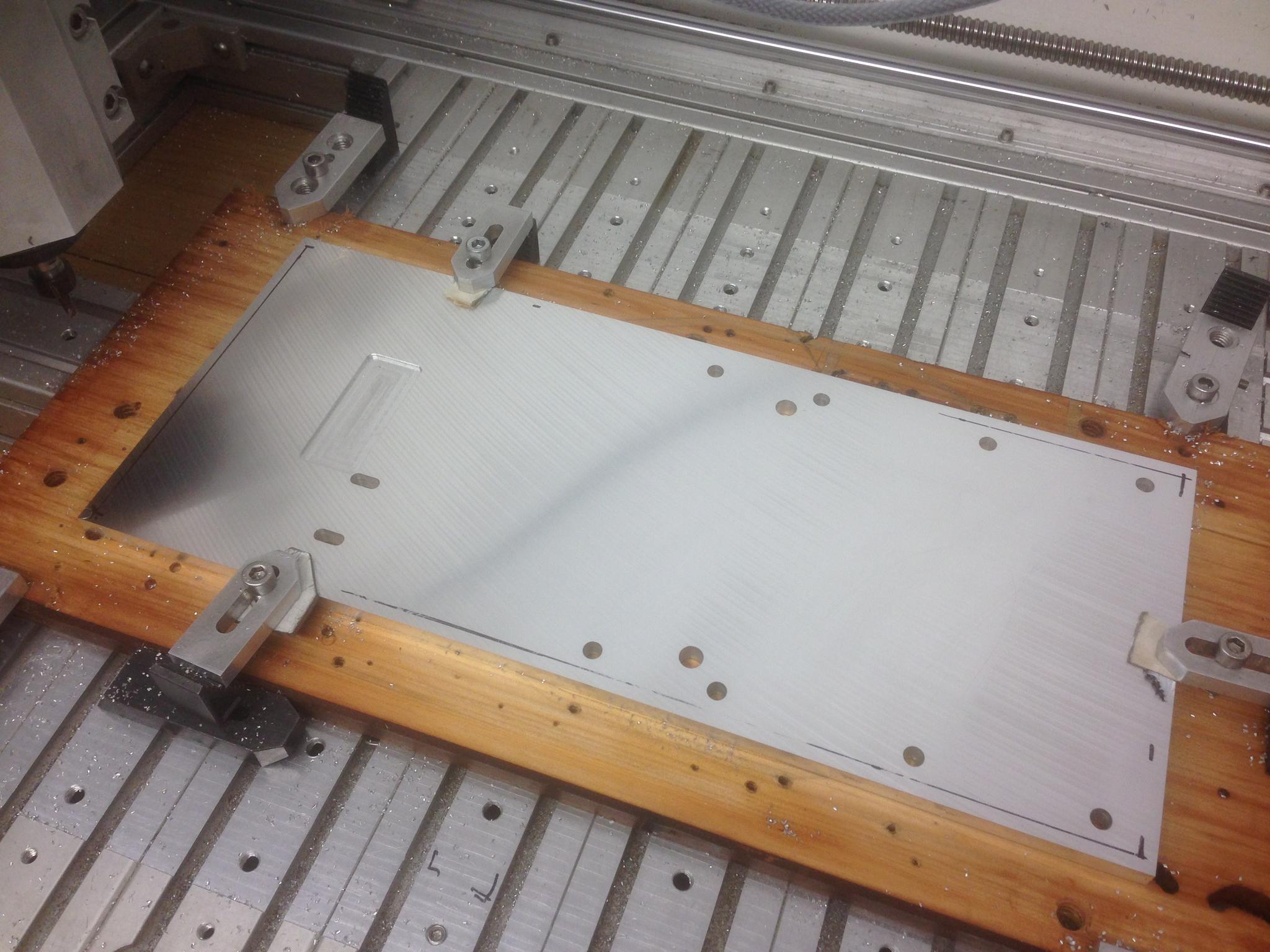

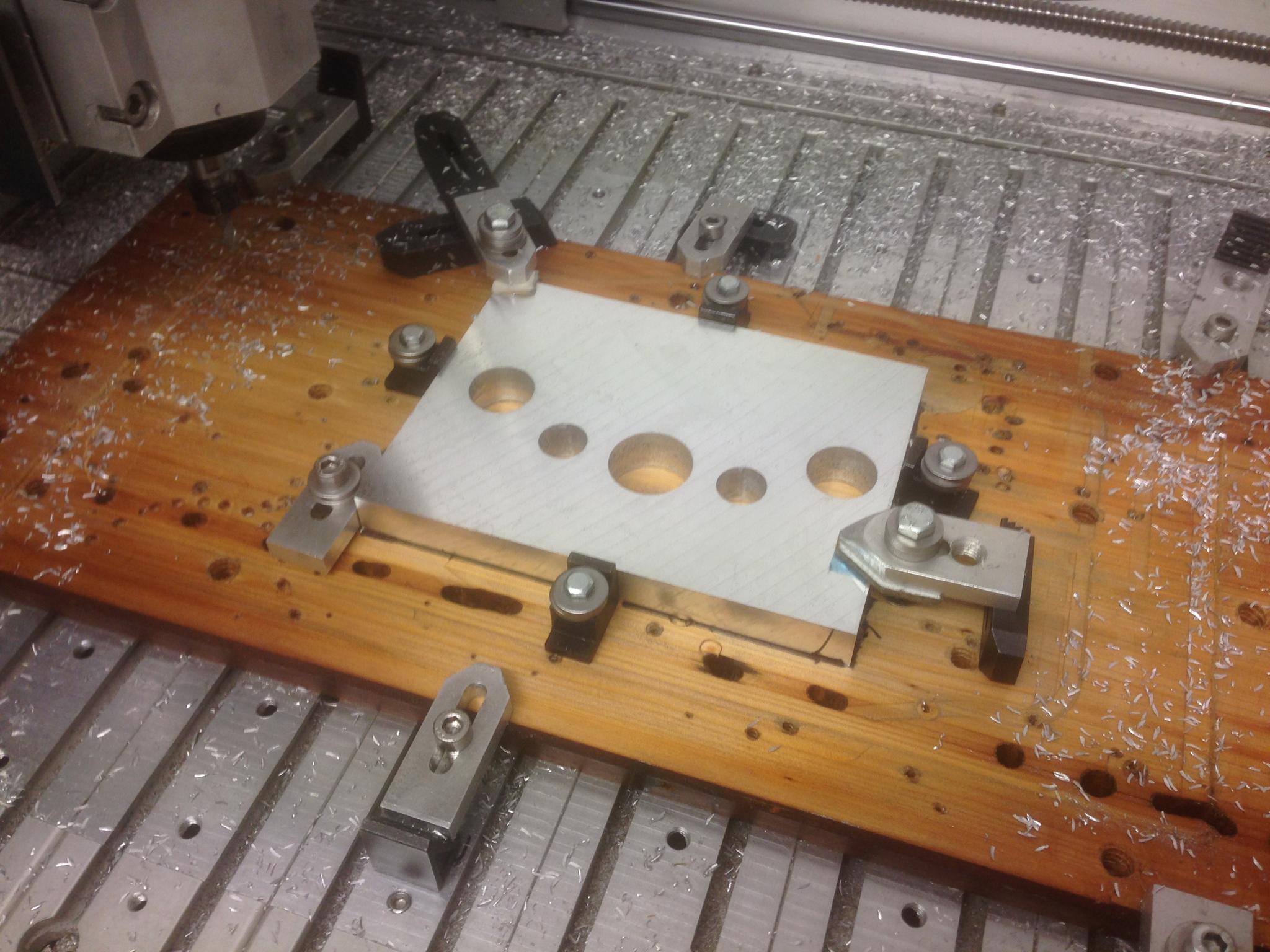

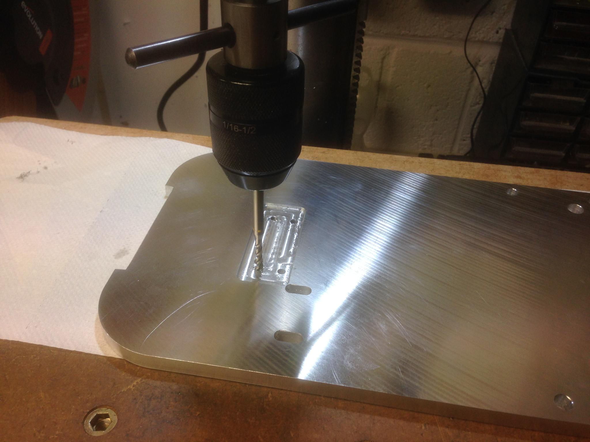

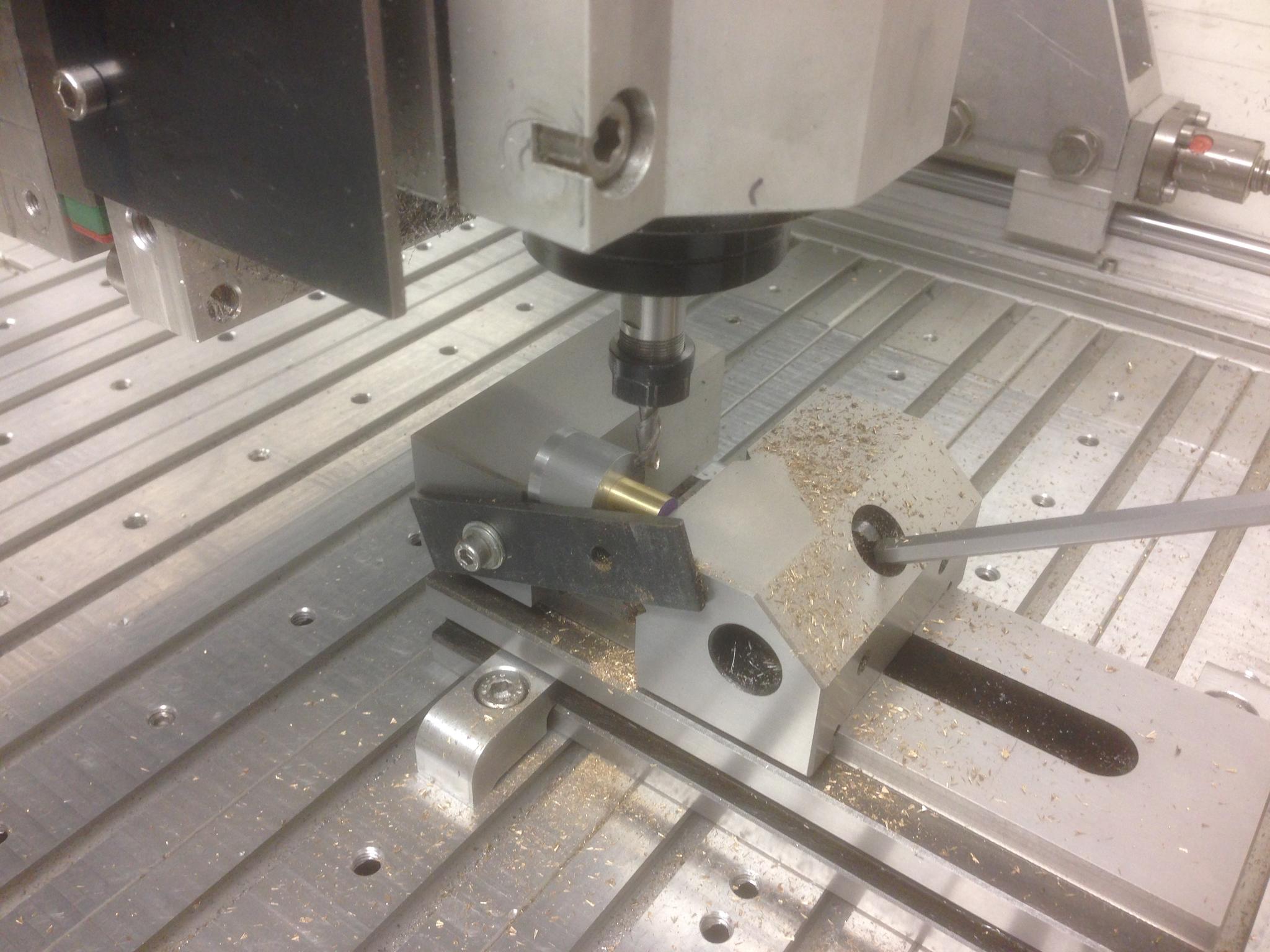

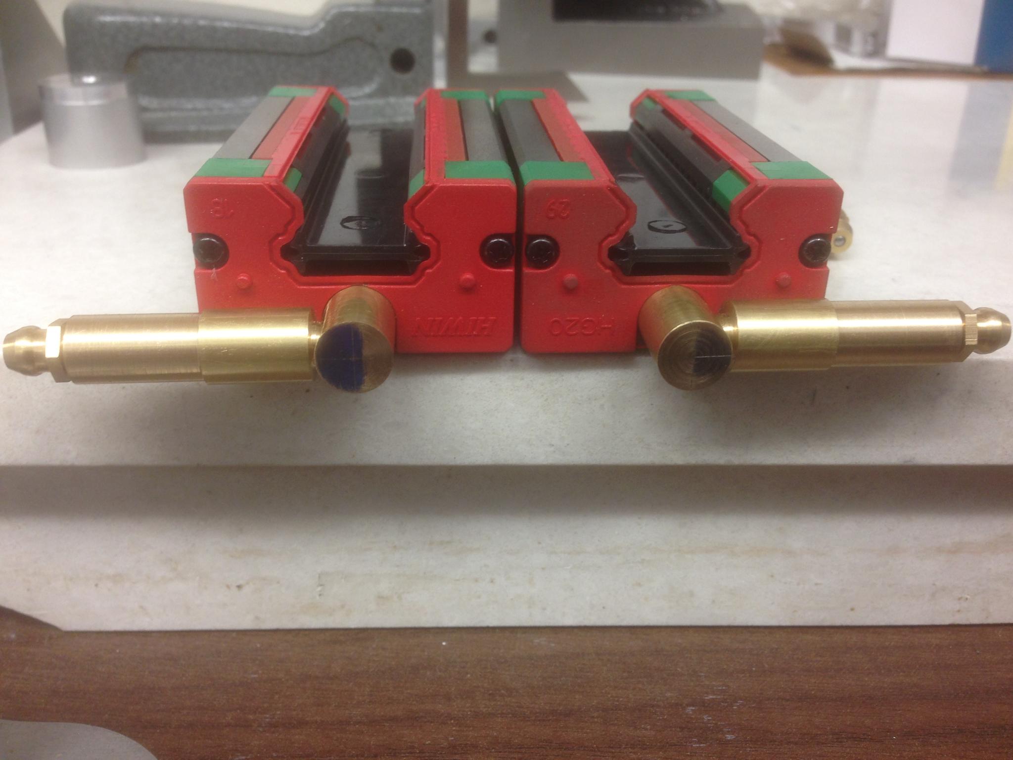

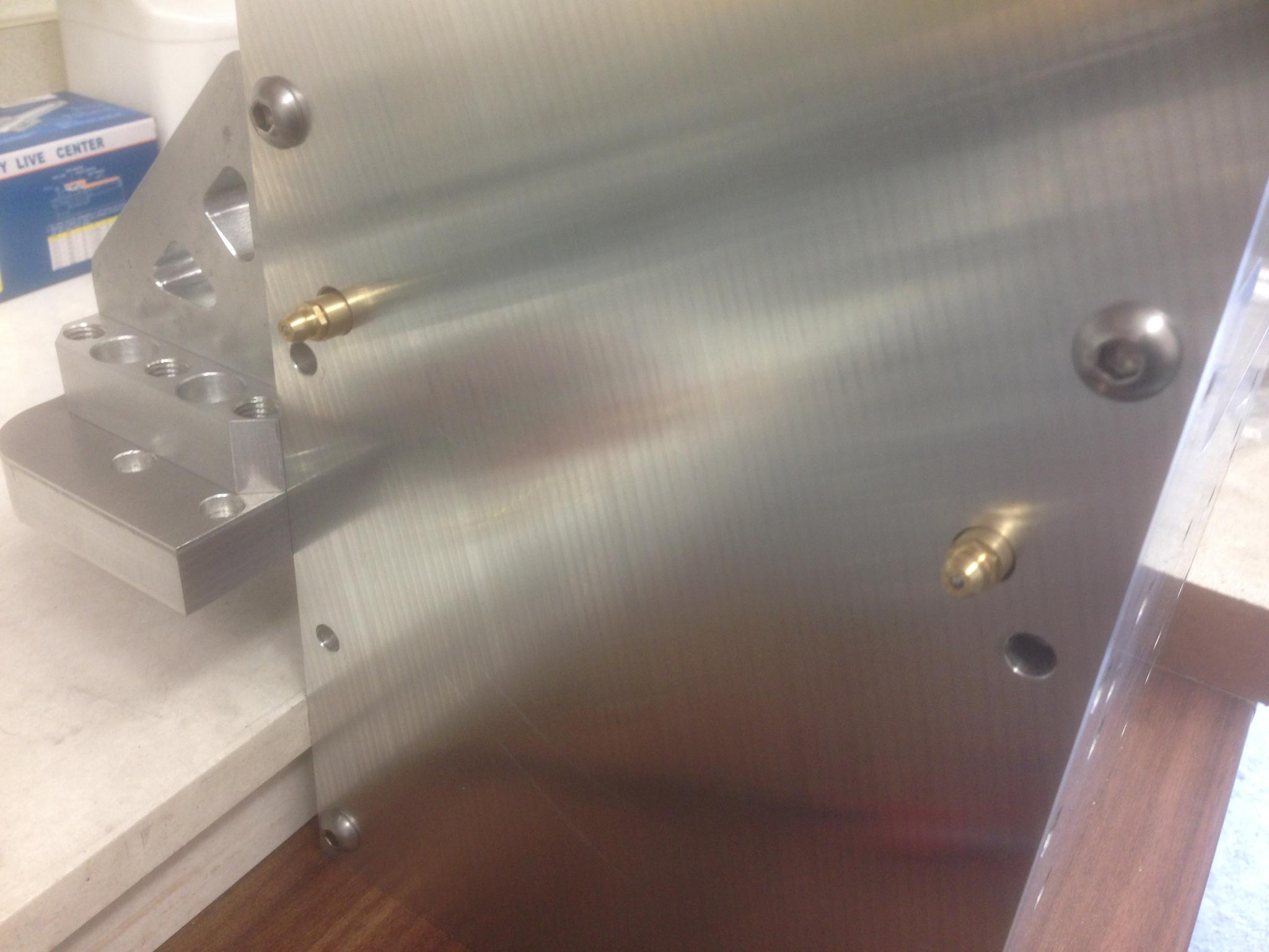

    An update on the next bits on the list - the gantry lower bearing plates. I need to make 2 mirrored parts, here is the first one progressing -
    Setting up and cutting some slots. These are to adjust one of a pair of ballnut brackets. I'm going to run 2 ballnuts pre-loaded against each other:
    The other holes have been spotted (to finish on the drill press) and the profile cut out. I tried something a little different to try and get the profile size as good as possible. As this sits on the X bearings I want this to be a datum part during the build. The rough profile cut was +1.0mm, then another rough cut at 0.2mm, and finally a finish cut at 0mm. You can see the finish in the photo which is excellent. I'll check with calipers how accurate the overall size came out.
    I've yet to drill out the holes on the top, and there are lots of holes required in the sides, but I thought I'd try a quick fit to make sure all was well. No bolts yet just propped together but looks good!

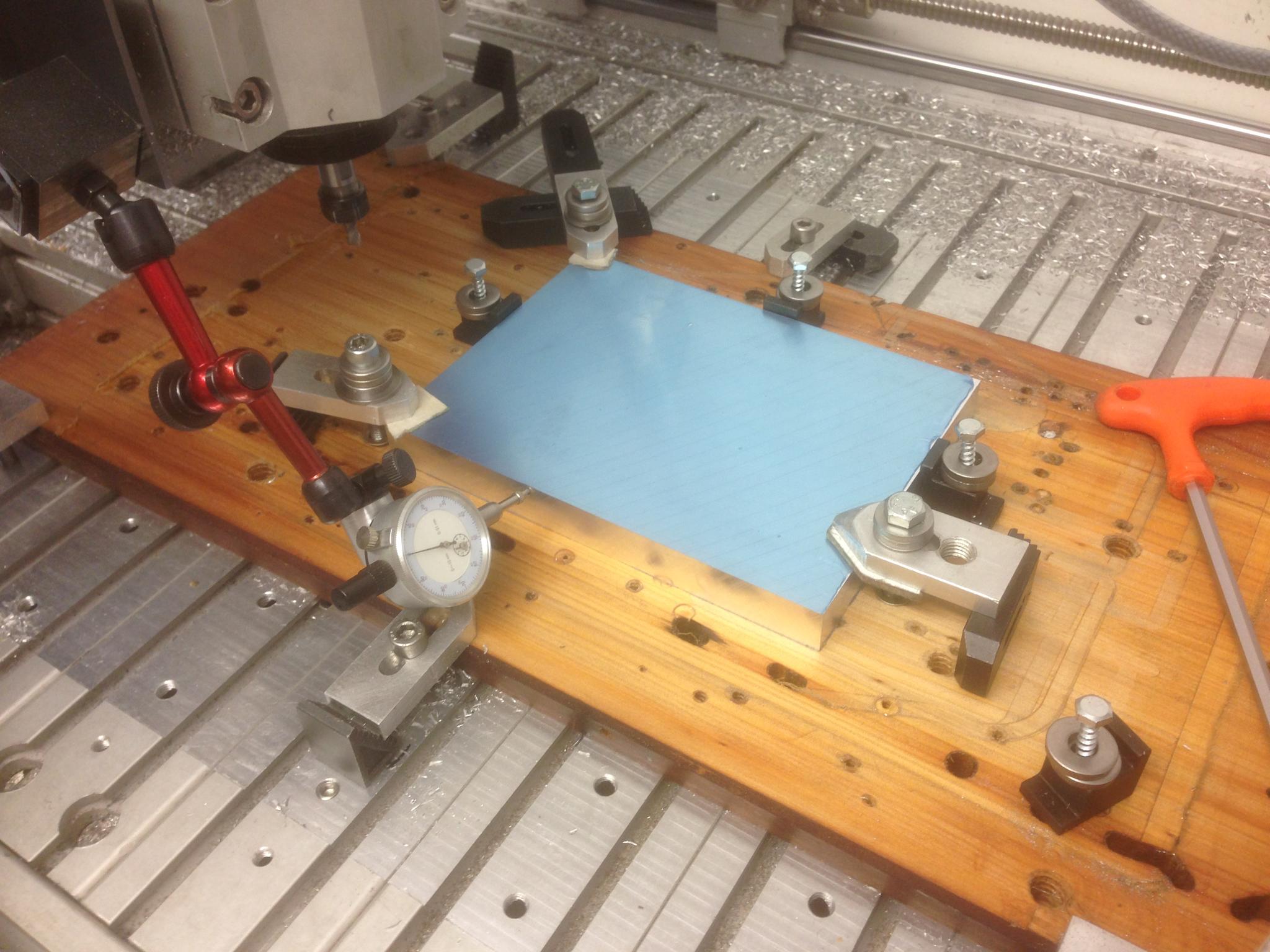

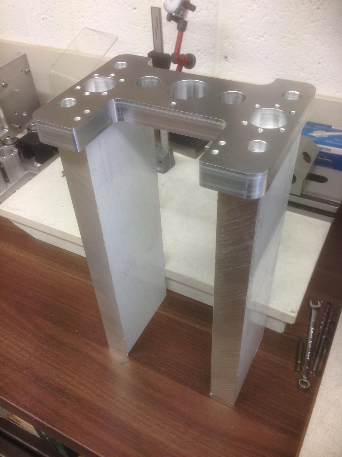

    Here is the start of the one for the other end. I had to line this one up using a DTI and get it very accurate to avoid hitting the holes in the donor plate I'm using. I've cut the slotted holes, next up will be spotting and profile:

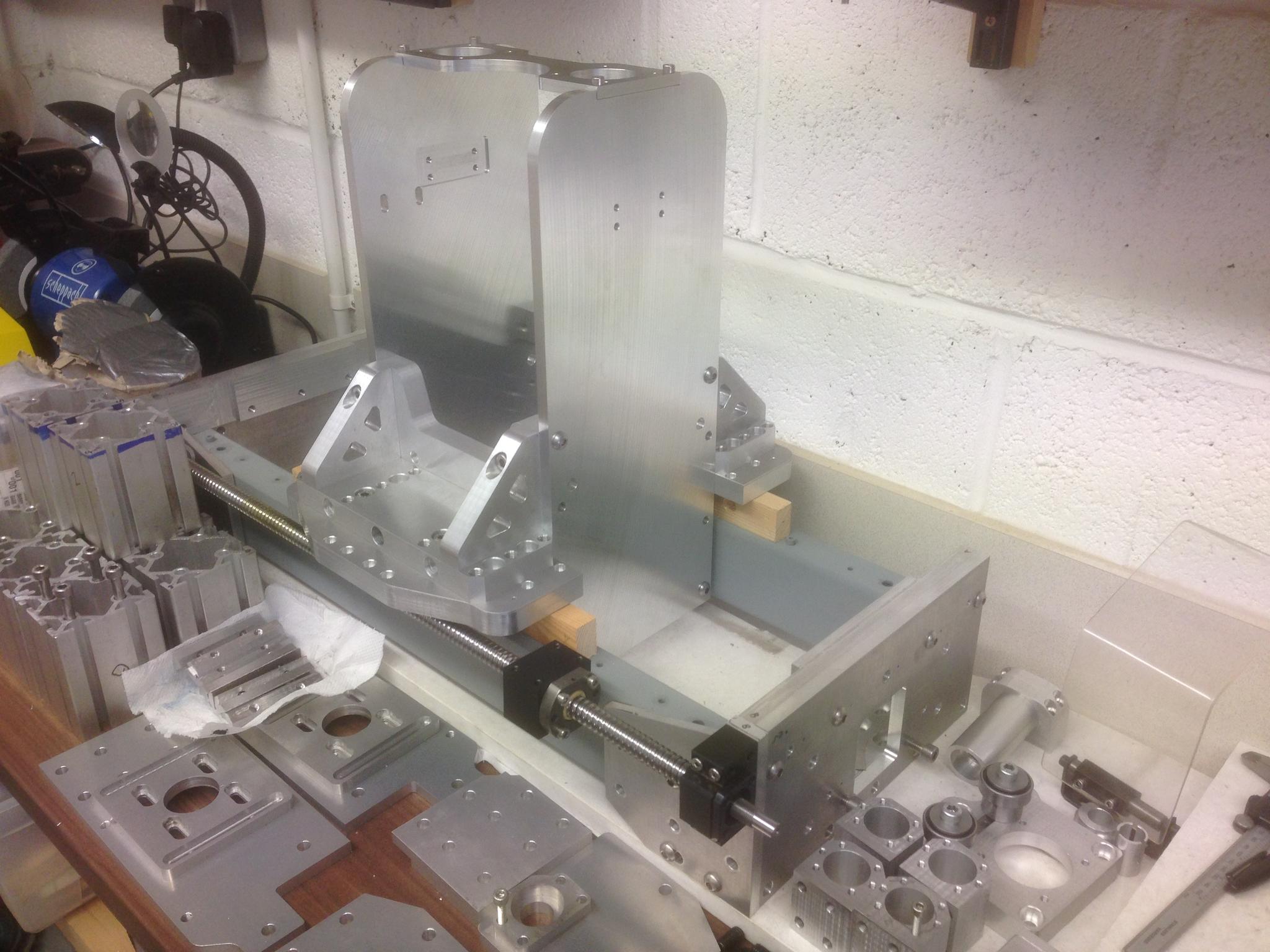

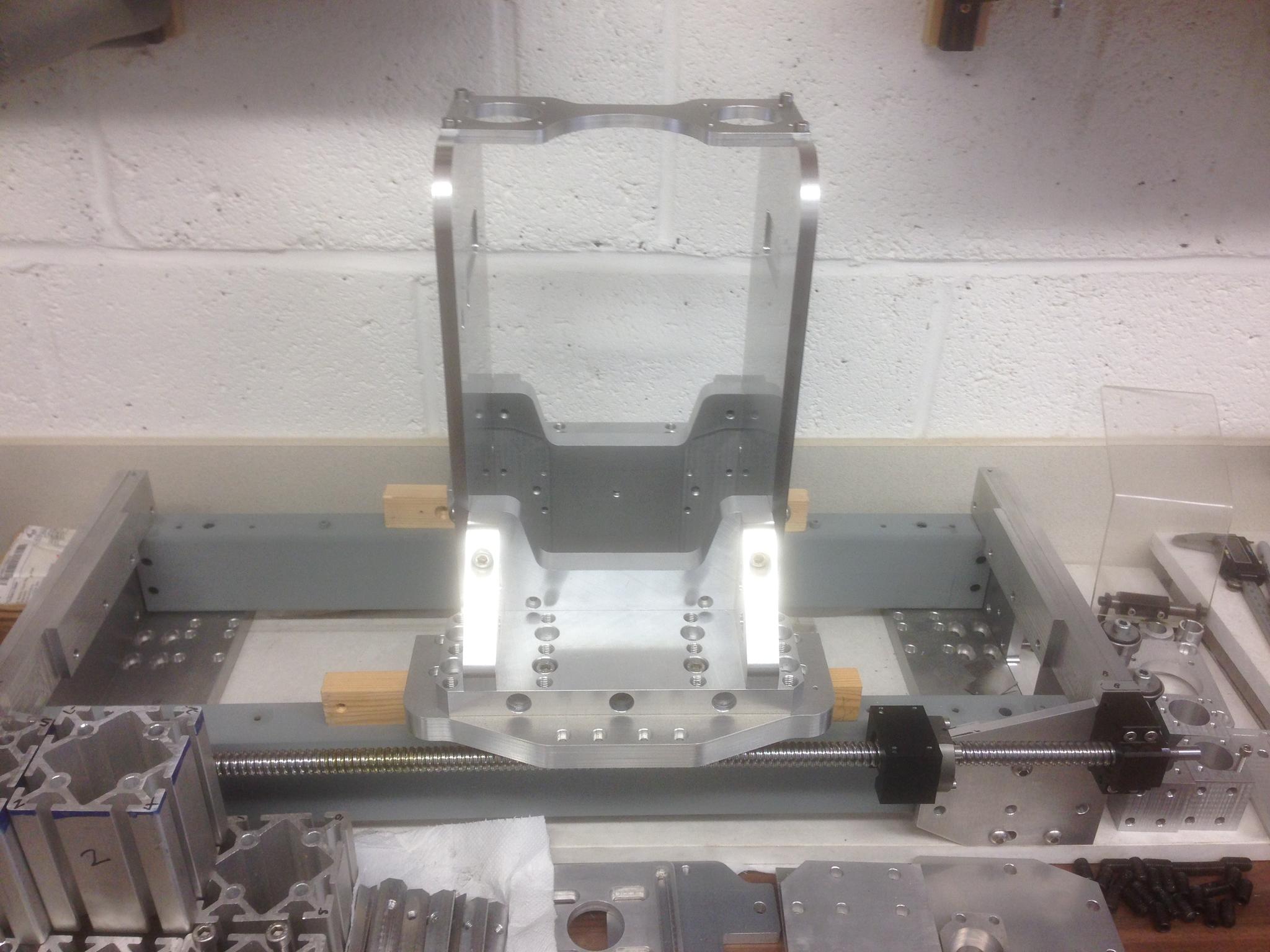

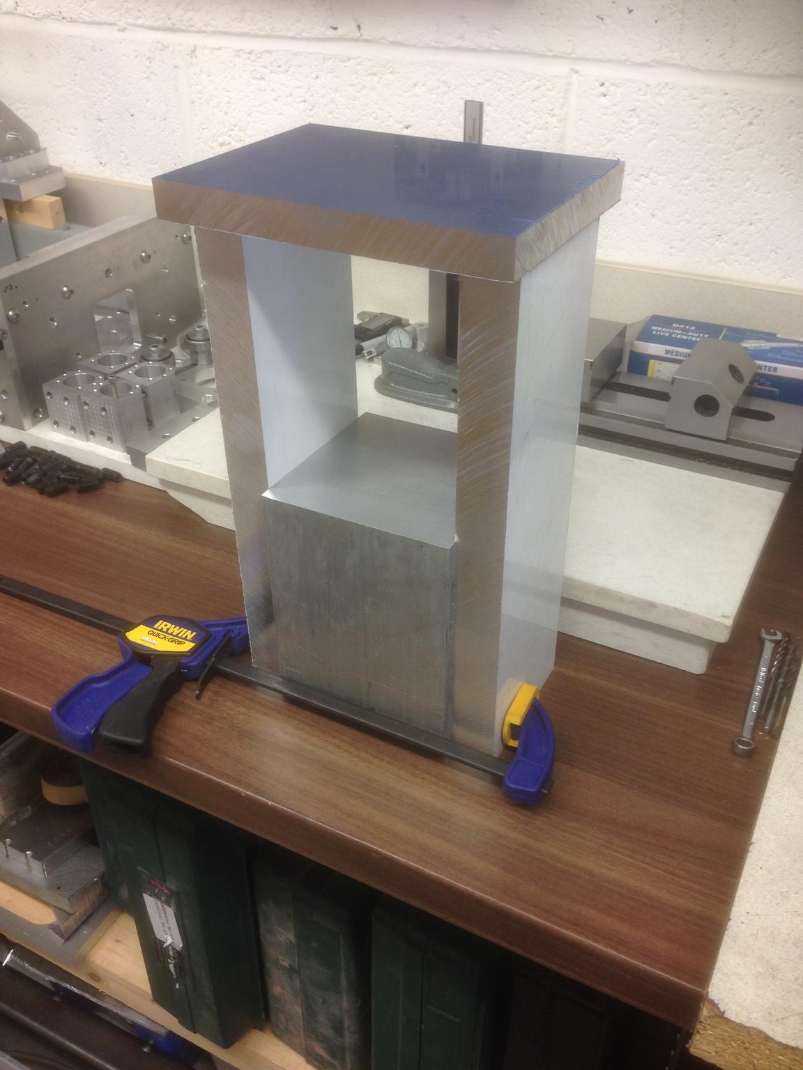

    Also, I'd made a few design changes a while back but hadn't posted them so here they are.
    1. Z axis
    -Twin ballscrew instead of single
    -Main body machined from solid
    -Upgrade from 15mm miniature rails to 20mm Hiwin
    2. Y axis
    -Double ballnuts, one fixed ballnut housing and one floating housing to allow pre-load to be added
    -Simpler bracing pieces
    3. X axis
