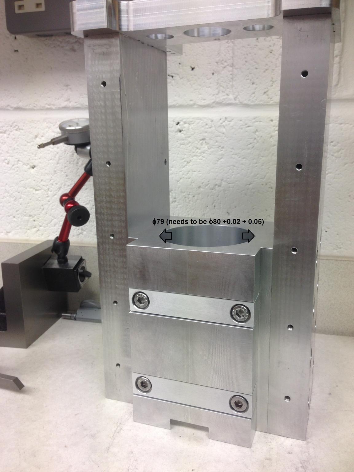

Z axis
Box-Z design clamping the spindle all round. 15mm 4off profile rails and 8 carriages. Went for the single Z ballscrew in the end as couldn't get a twin ballscrew design to fit and give reasonable travel etc.
This is how the spindle clamps, but still keeps the rails aligned:
