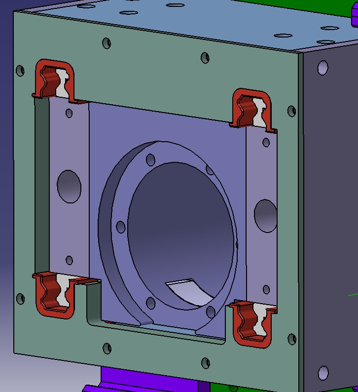

    In the meantime I'm working on the lower cover plate and decided it would be great to use Zeeflyboy's seals (shown fully retracted Z axis):
    More to follow . . .
    (Zeeflyboy - pm sent)
