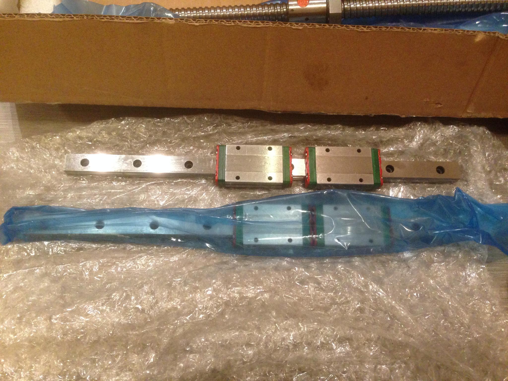

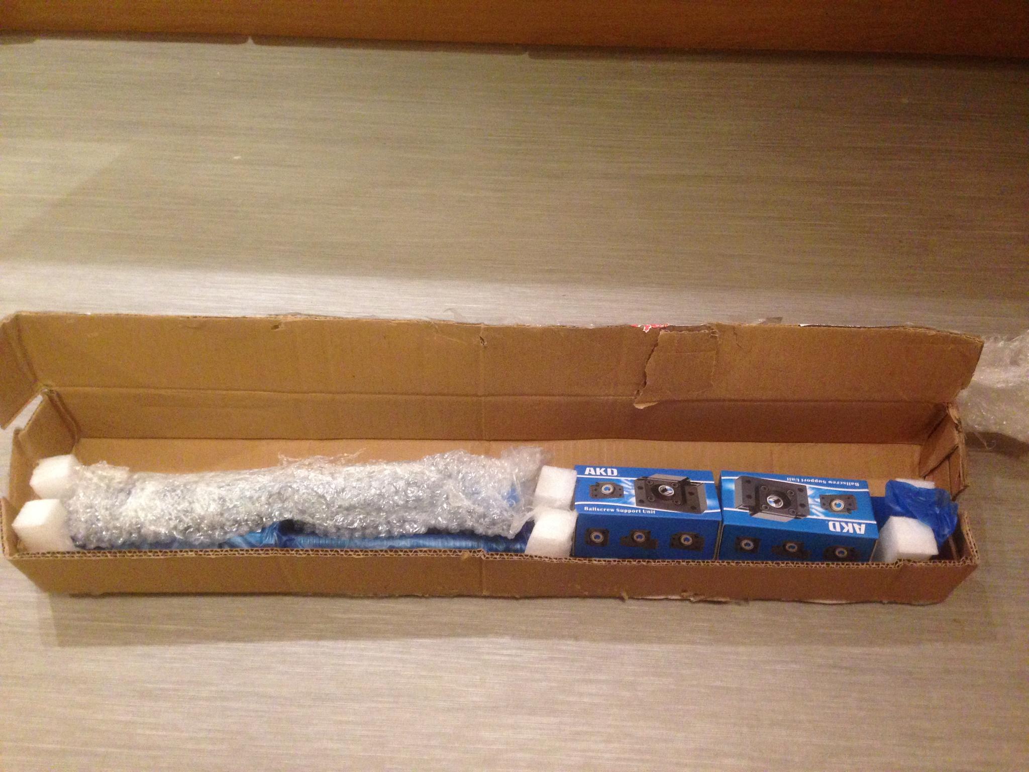

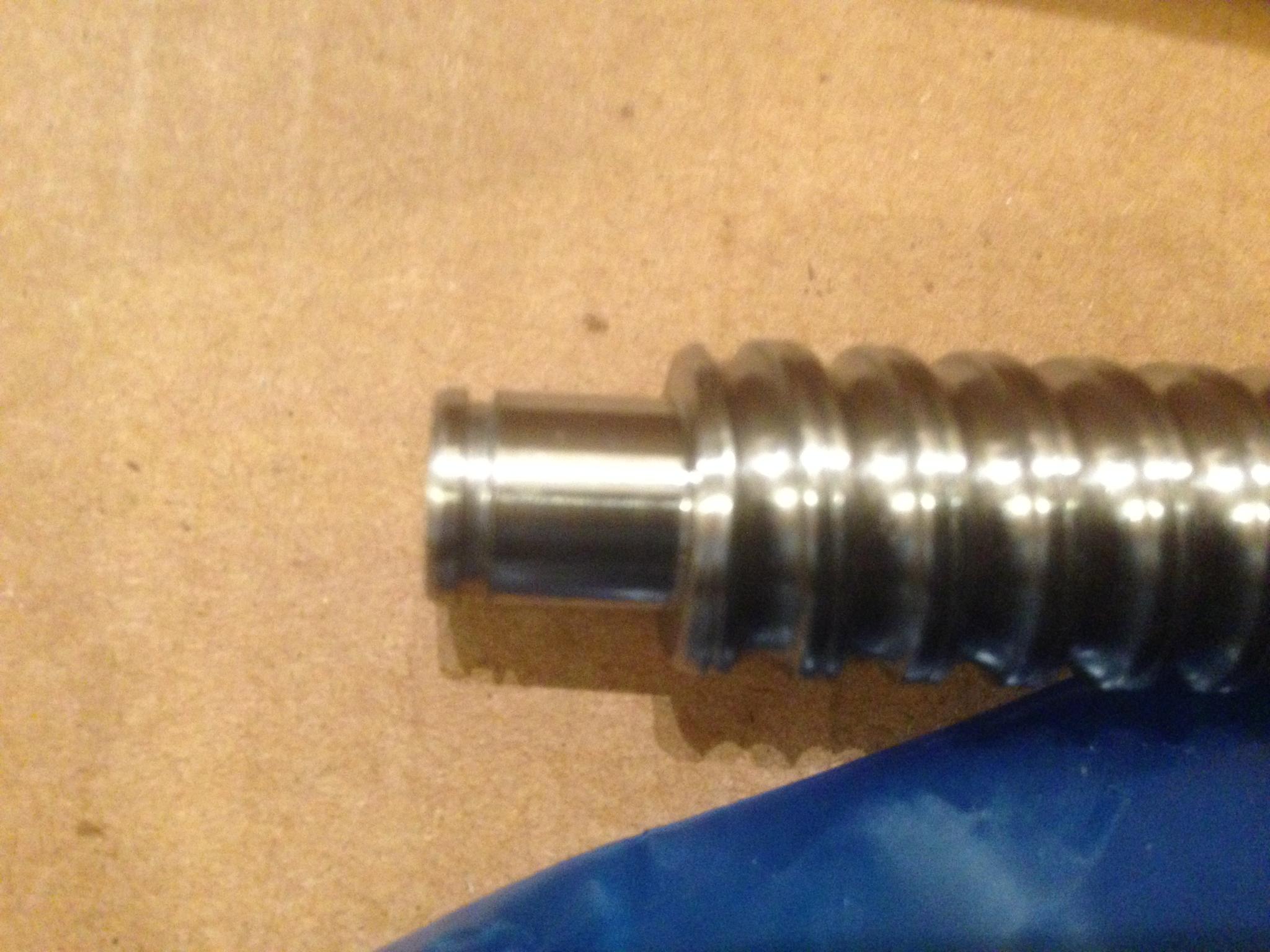

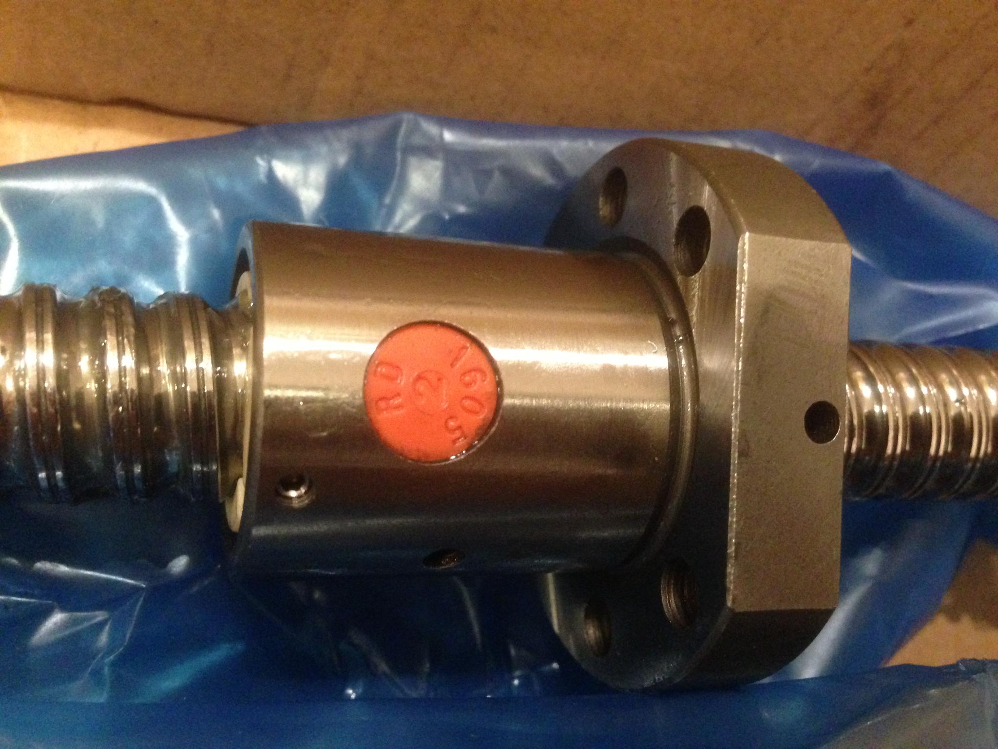

    These arrived recently as an early Christmas present. Another ballscrew for the Y axis, and another pair of 15mm rails and carriages for the Z axis. All the other mechanical and electrical bits will come from the MK3 machine.
    I ordered from Fred at BST automation. I should mention how the ordering works for custom orders. Obviously they cannot list every part in every size to I asked for a quote on the lengths I needed. This was a bit less than the website price, which was nice. I was then asked to add various items to the basket which were 'similar' to the parts I wanted. During the checking out I had to add a note to say the actual lengths I wanted, and then wait at the payment stage for Fred to amend the price. I could then confirm the order.
    It's a but of a concern that the order shows stock listed parts and lengths, and you have to take it on faith (and Fred's confirmation emails) that the parts you will receive are the ones you asked for.
    But I didn't need to worry - everything was exactly the length I'd asked for. They arrived in a cardboard box, not wooden, but it was well packed out.

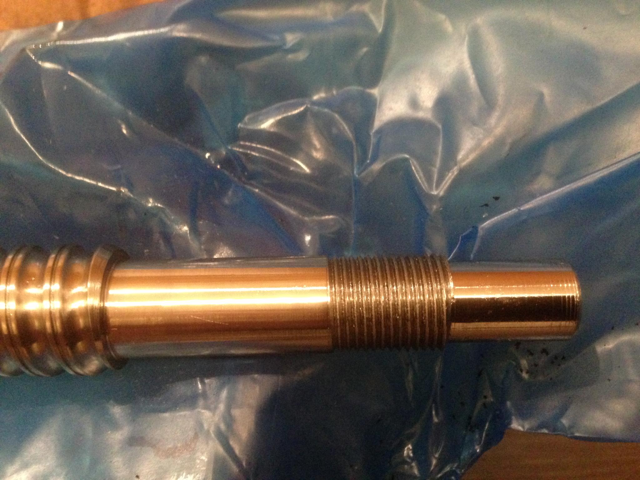

    I immediately checked the ballscrew and it ran dead true to the eye (unlike the previous ones from other sellers which arrived bent). Bearings were a nice fit on the machined ends, and the end machining was nicely done.
    Last job was not forgetting to confirm goods received on AliExpress, which then releases the payment to Fred. Note how this is different to ebay. Overall very pleased with my first order from Fred. Would recommend.

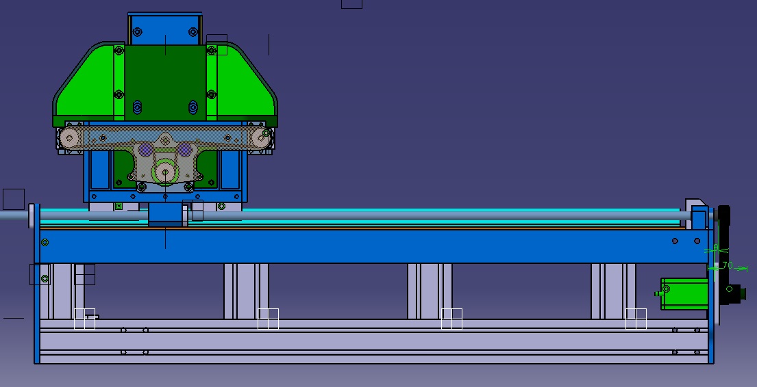

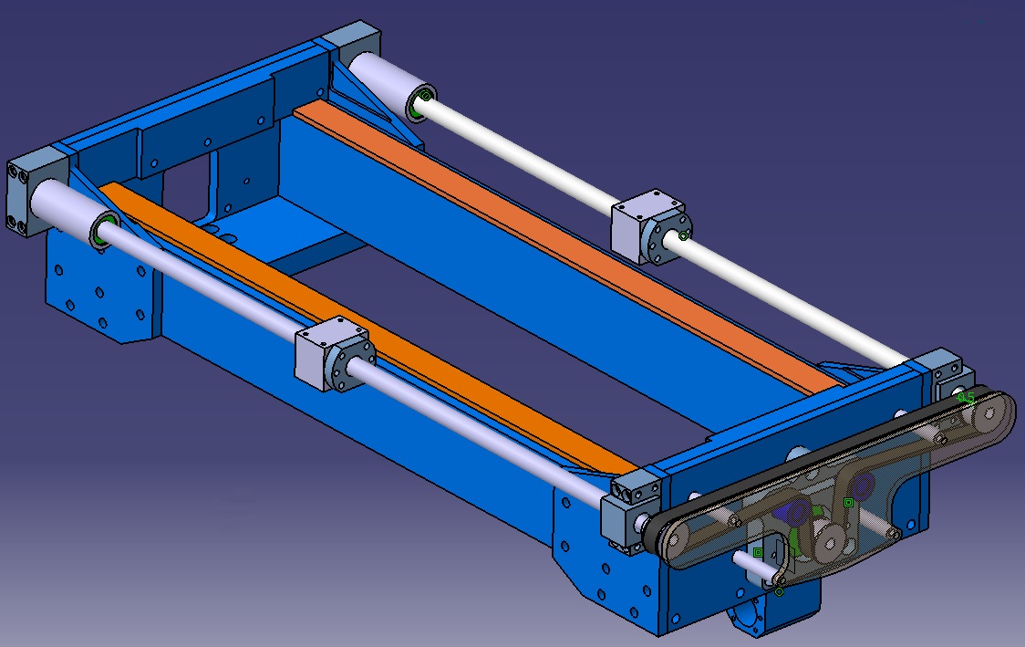

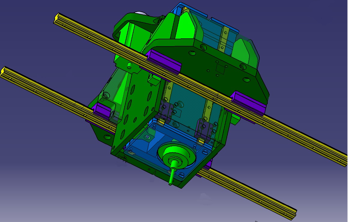

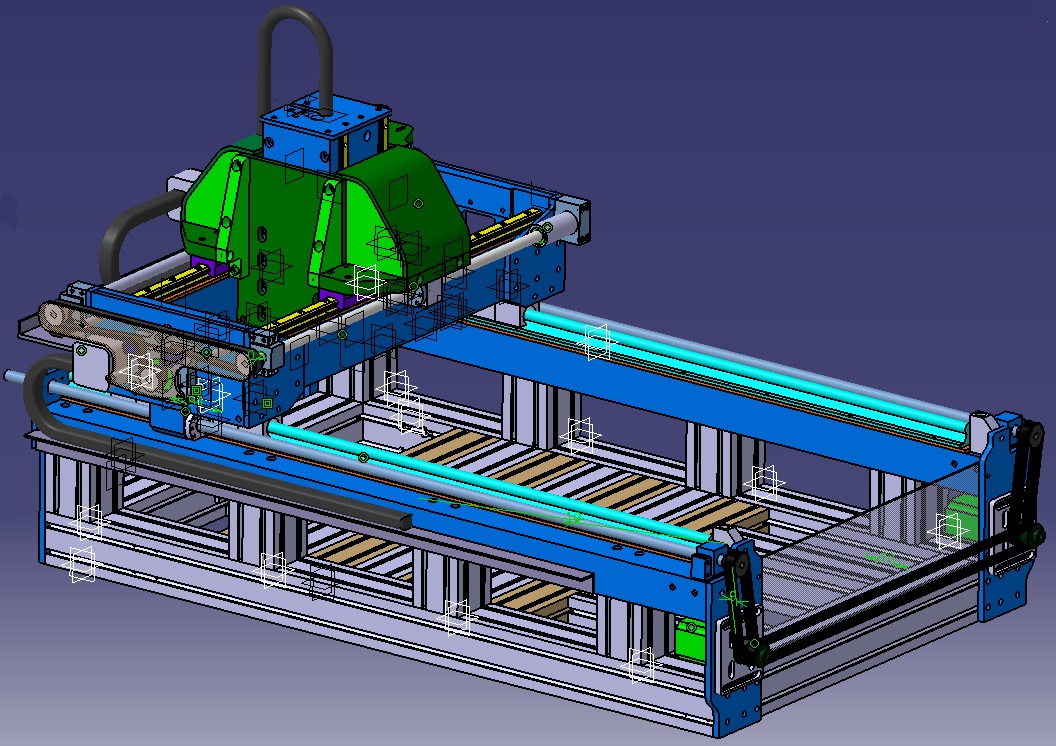

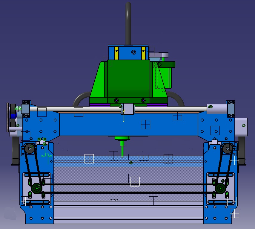

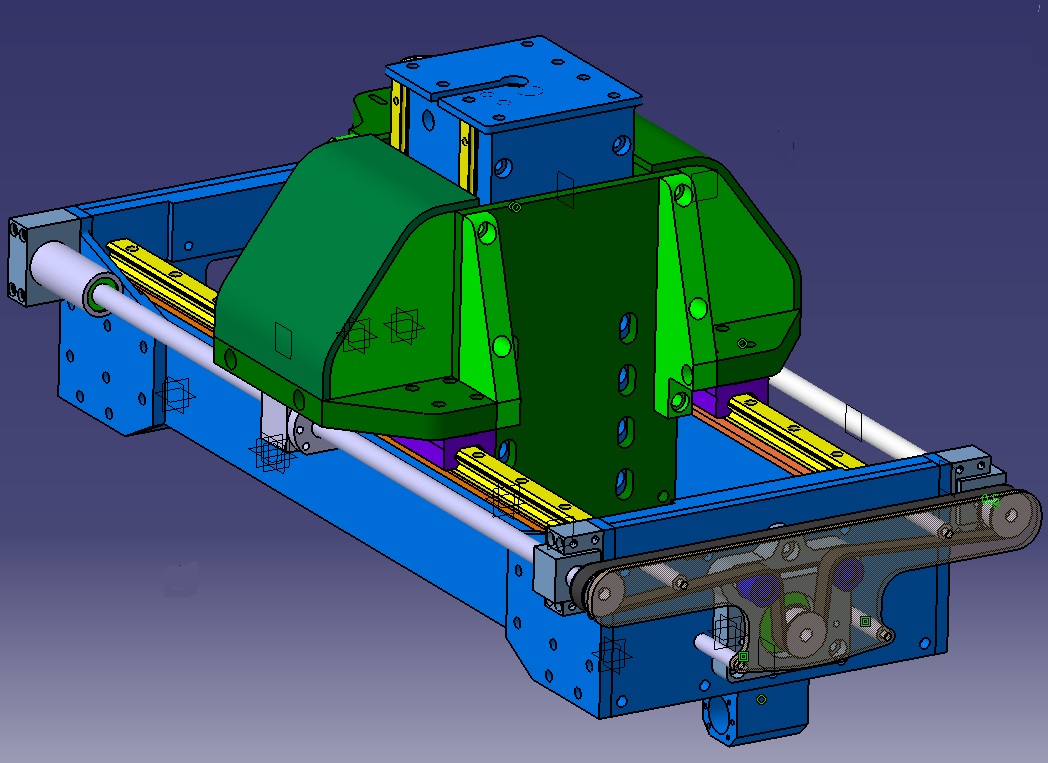

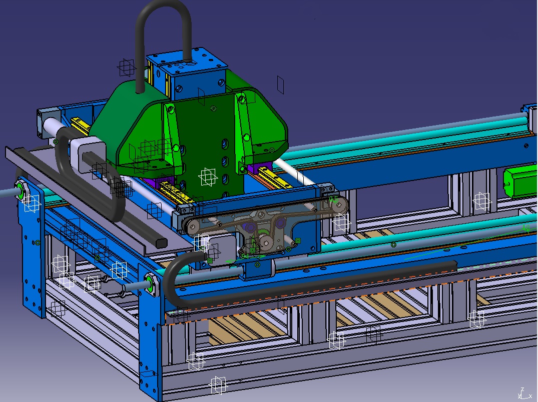

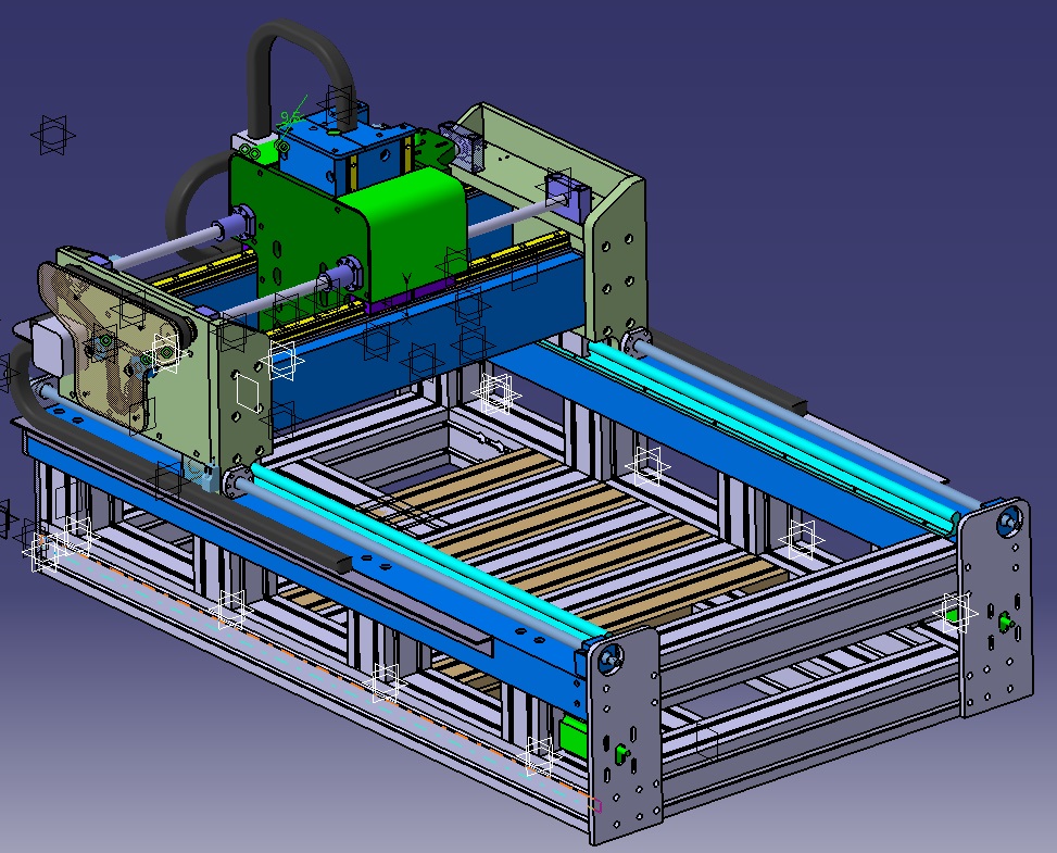

    As I feared the return to work after Christmas means workshop time has significantly reduced. For various reasons I've only been able to get about an hour in there.
    But I have been able to get a few sessions on the CAD and this has meant I was able to go over some of the other designs and have one last go at unlocking some of the compromises. The net result is I've developed some of the other ideas and ended up with what I think is a much better design.
    Old one for comparison:
    Here is the new version:
    iso
    iso rear
    X axis
    Y axis
    Z axis
    Just X axis showing gantry, ballscrews, epoxy (orange), and custom ballscrew floating end as the ballscrews were not long enough to mount the standard floating end.
    X axis drive and belt tensioning arrangement
    Side View:
    The new features are:
    Gantry beams smaller
    They are now 80x40x5 RHS steel (down from 100x60x5). I'd put too much emphasis on huge sections, whereas with a double beam gantry I could afford to scale them down and still have plenty of stiffness in reserve over a single gantry.
    Because they are smaller I was able to re-configure the X-bearings, bring them closer together, and give more travel in X. They are now only 274mm apart which is getting close to my current machine spacing. I was also able to get the X ballnuts at the centre of stiffness, rather than at the ends of the gantry.
    Y rails are much lower
    With the smaller gantry sections the Y rails are now lower and closer to the tool, as are the Y axis bearings, which all provides more stiffness
    Ballscrews lower
    As the gantry sections are narrower I was much happier putting the ballscrews on the front and rear faces as there was much less of a bracket required to join them back to the main Y axis, therefore stiffer.
    These are now much lower in Z which also puts them much closer to the tool, which reduces the moments, which lowers the forces on the Y bearings and makes the machine stiffer.
    I was also able to put the ballnut in the centre of stiffness, rather than on the outer edge of the Y axis. There might be a marginal gain here I really don't know, but it does look nicer.
    Y axis bearings spacing
    By re-designing the gantry end plates to free up some space I was able to make full use of the linear rail and spread the Y axis bearings out considerably more than before - without losing travel. This should significantly improve the stiffness due to moment inputs when cutting in the Y direction. When coupled with the lower ballscrews there should be a double win here.
    In one of my earlier posts I suggested that double ballscrew on Y eliminates racking - whilst this is true for rotations about Z axis, it is not for rotations about the X axis. To eliminate these you could add another 2 ballscrews lower down, but that is not practical (!) so you do still need to space the Y bearings out even with double Y ballscrews. Rotations about the Y axis are dealt with by having the double gantry beams no worries there.
    X drive

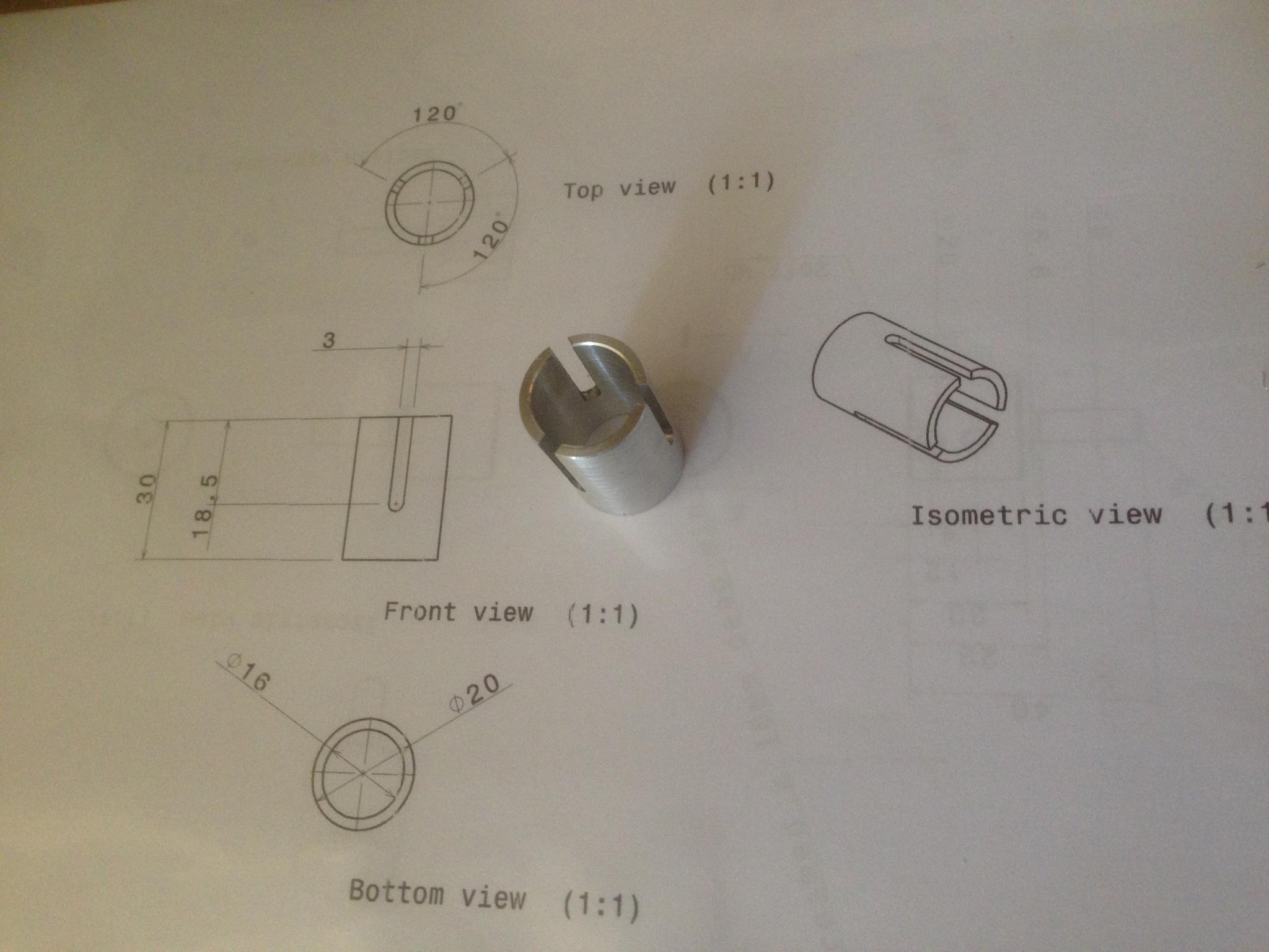

    I've gone with something a bit different here which does not use tensioning idlers. The steppers are on plates which are slotted, and the steppers are also in slots. Between them I should be able to tension the short belt up to the ballscrew, and the syncronising belt across to the other stepper at the same time by pushing the motor off into one corner. Everything is 5 HTD with 15mm belts.
    Cooling
    I've decided that there are a couple of options to place the radiator, plus the option just to go for the 'big metal bucket' out of sight. So I'm going to build it and then just see which one takes my fancy. Sometimes you can CAD things too much and get tied up in the last details.
    Luckily the new design retains the parts I'd already made so nothing lost. Thank you for the comments made so far, stirring up the doubts I had about some aspects, and making me revisit the previous designs. I think it is all the better for it.
    Right, time to start CAMing up some of the parts ready for whenever the next workshop session is . . .

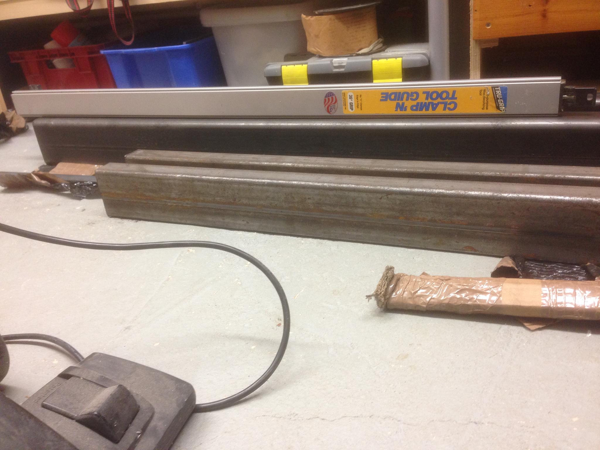

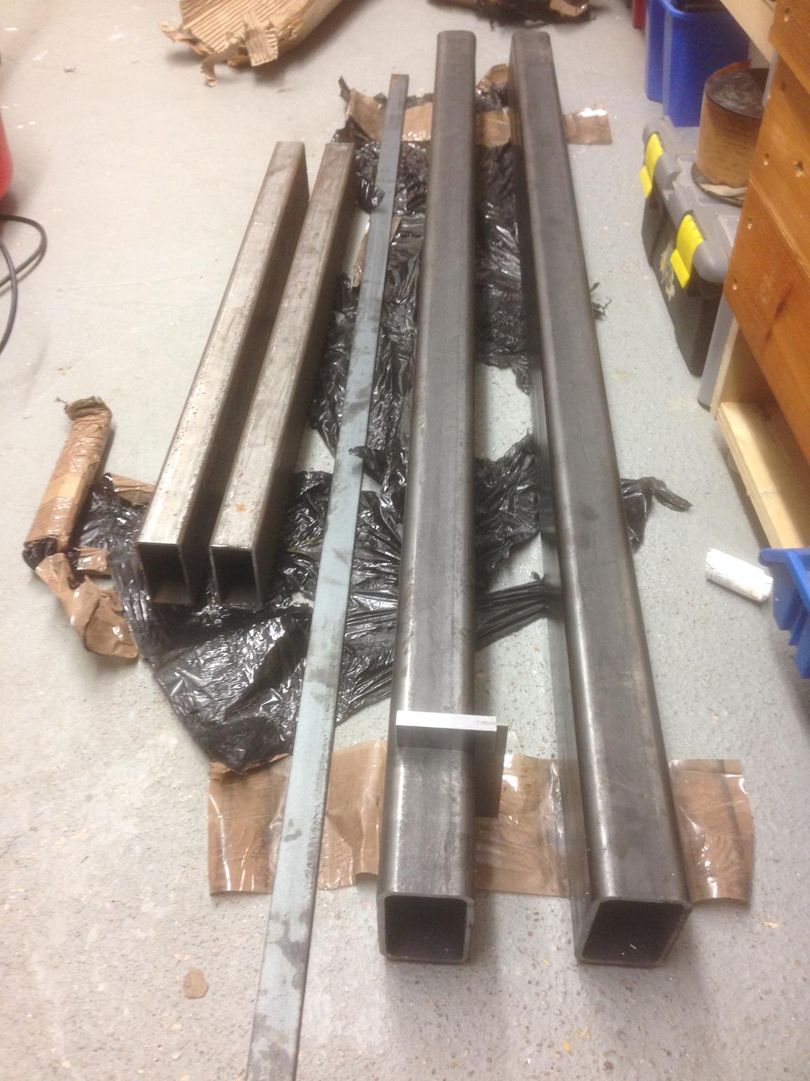

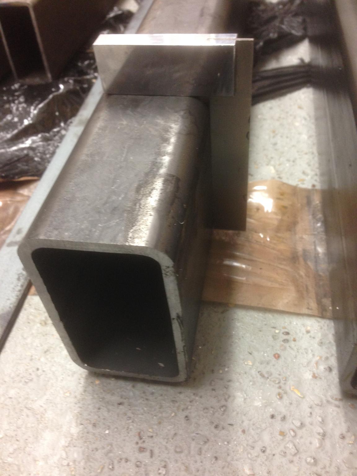

    This lot arrived recently.
    2off - RHS for the raised X axis sides - seems pretty square and reasonably straight

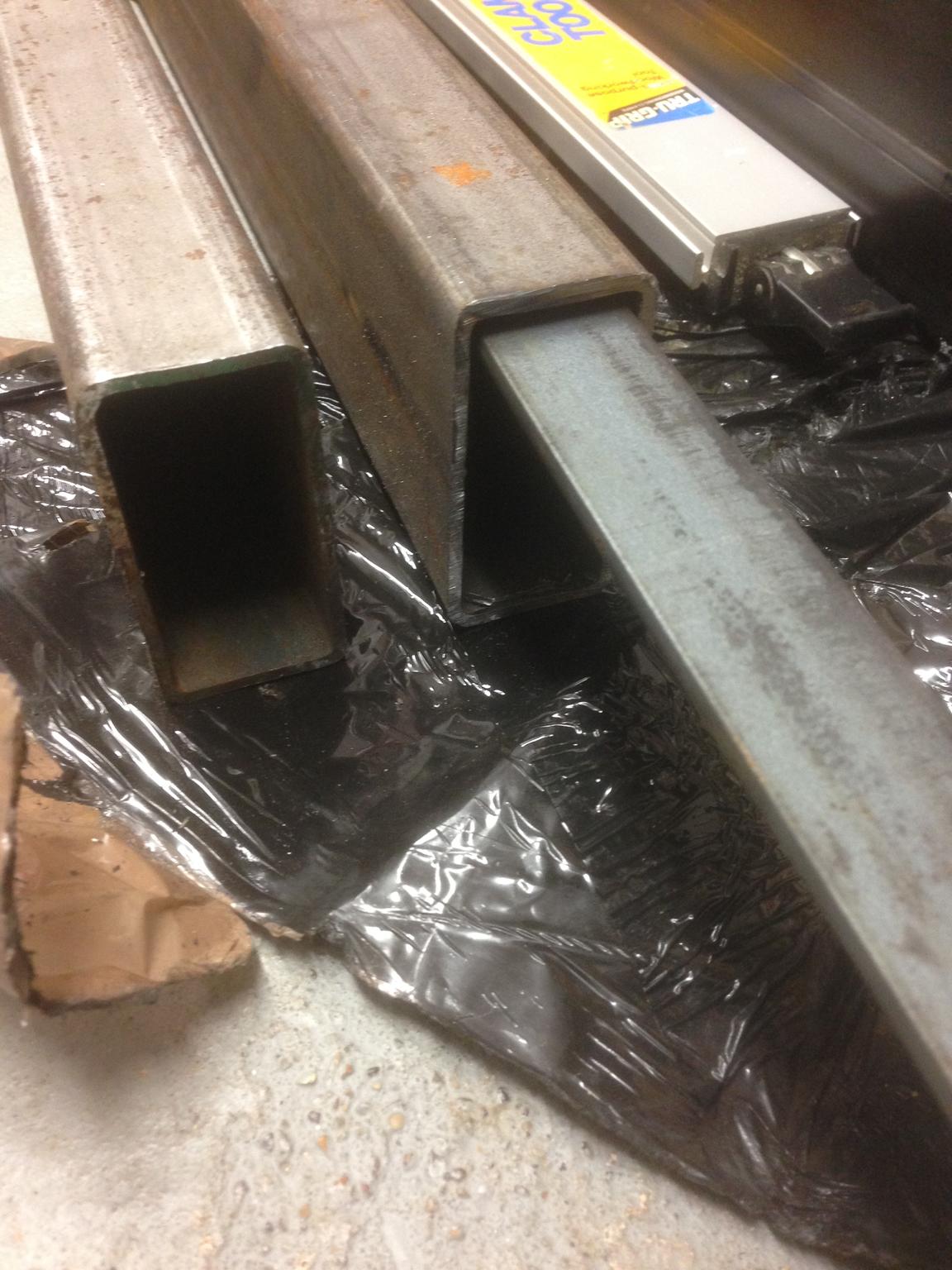

    2off - 80x40x4 RHS for the gantry beams
    1off 30x5 flat bar to reinforce the gantry beams where the rails will sit

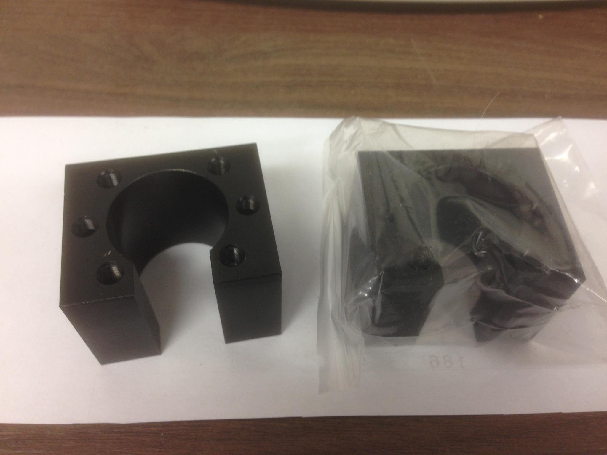

    2off ballnut mounting blocks (~£9 each)

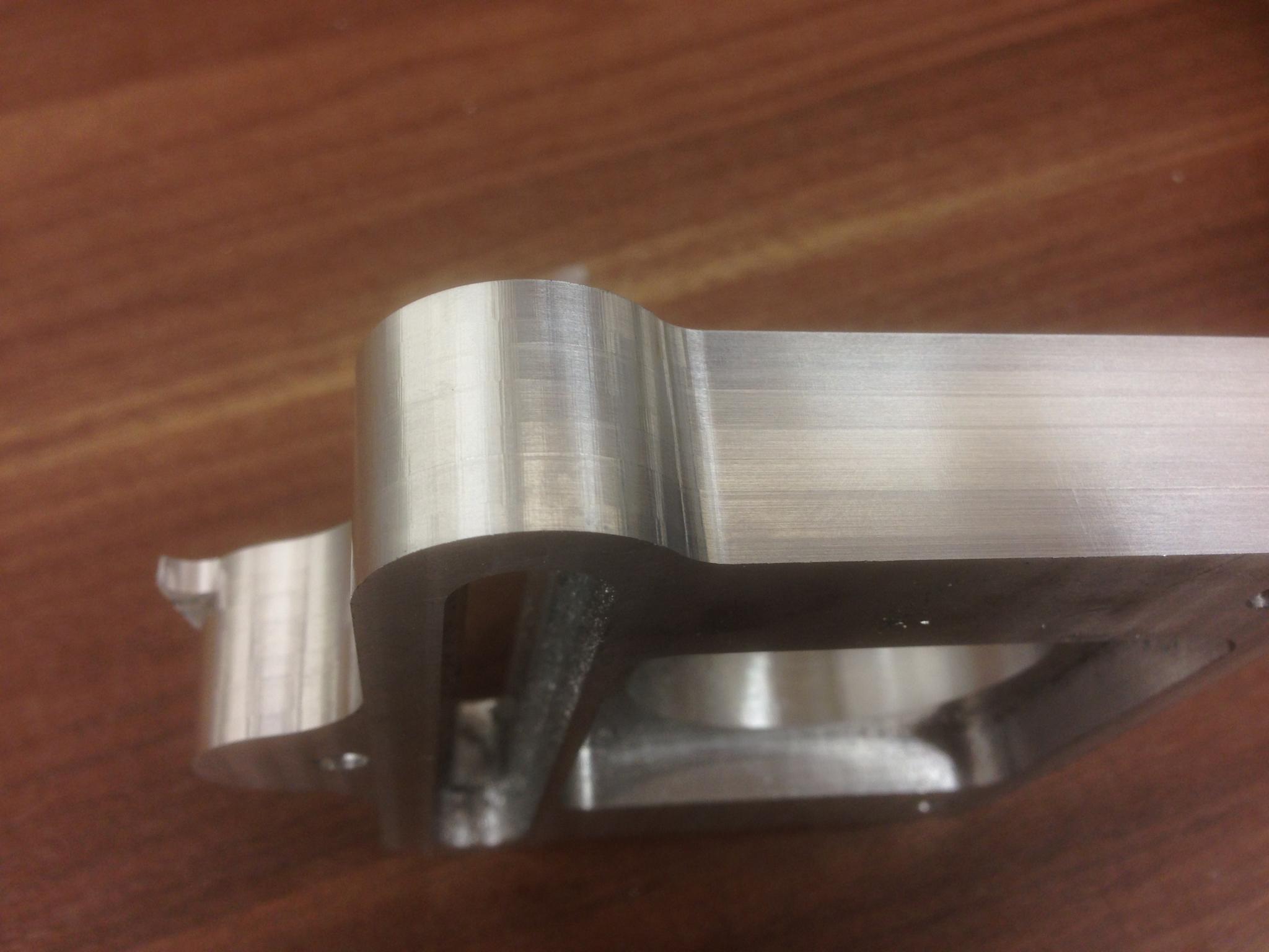

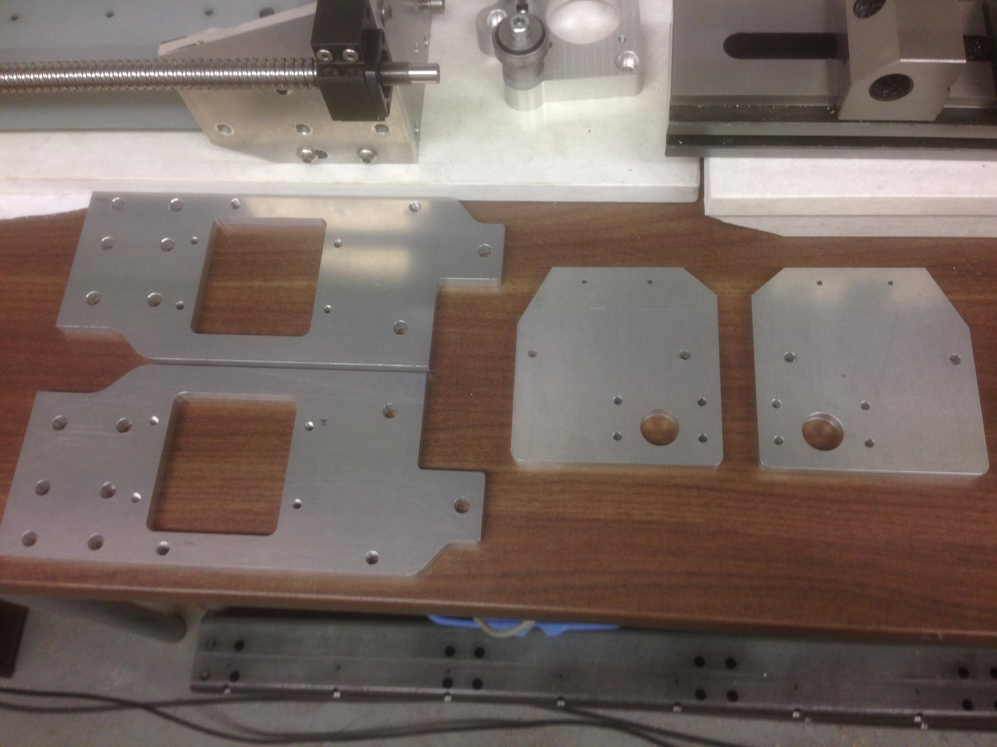

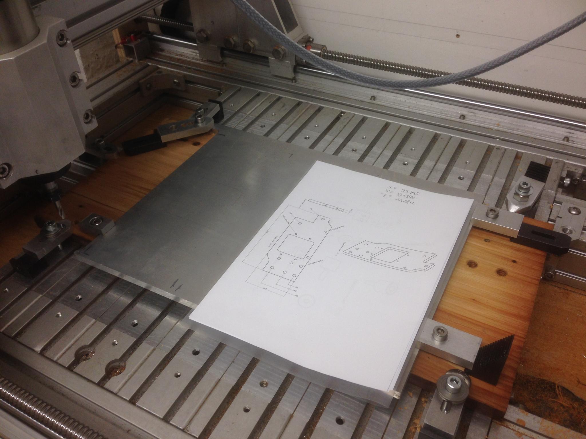

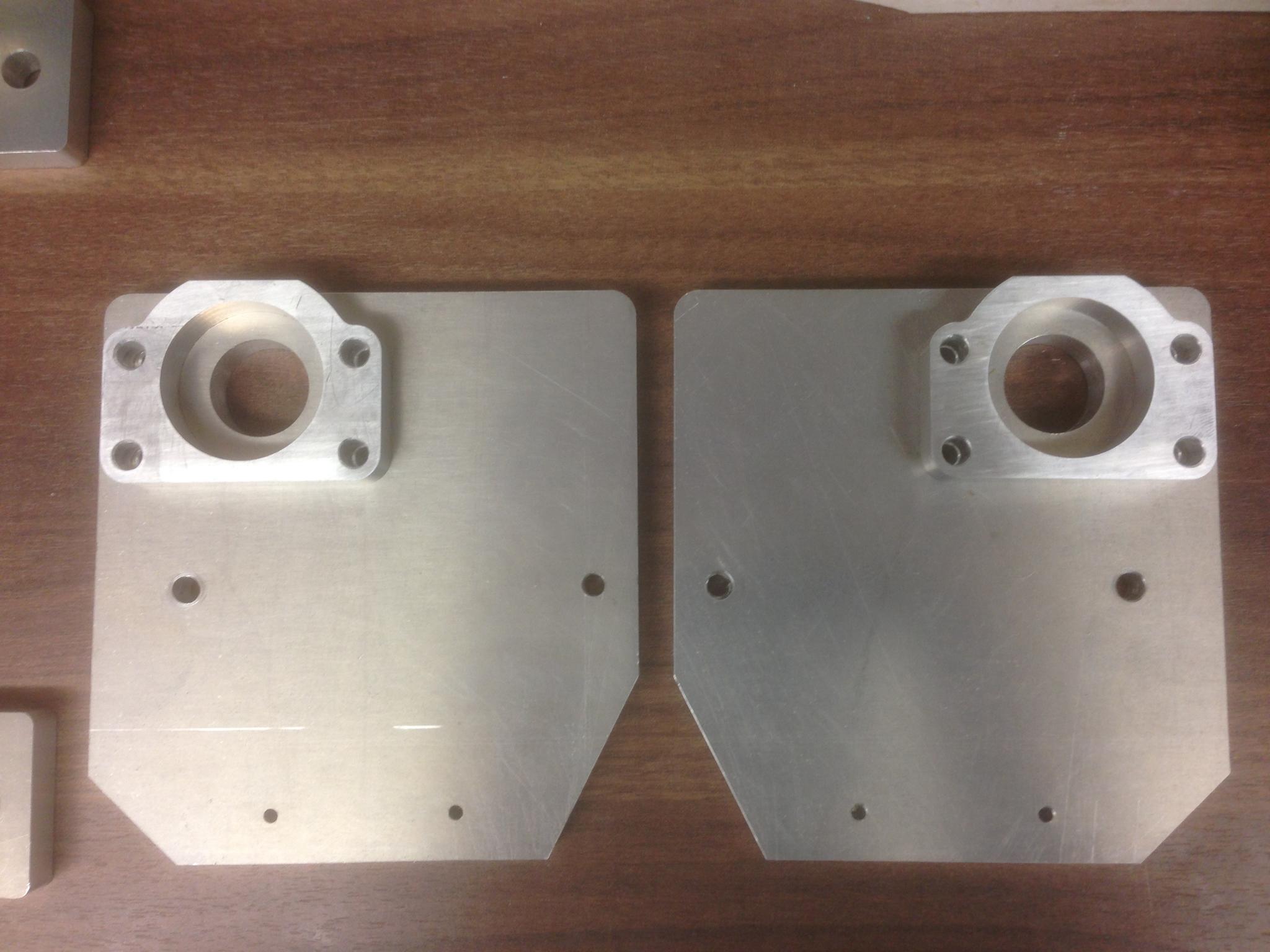

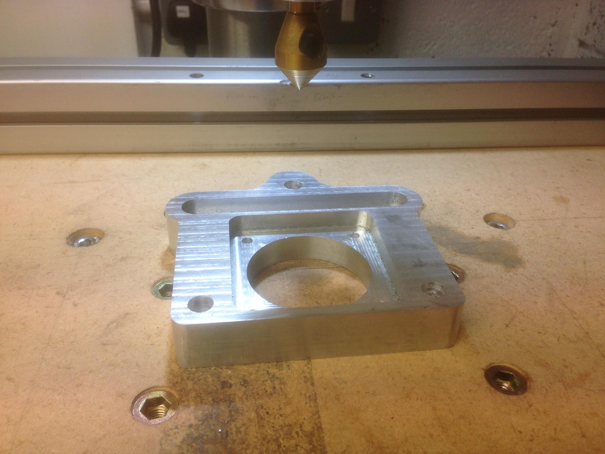

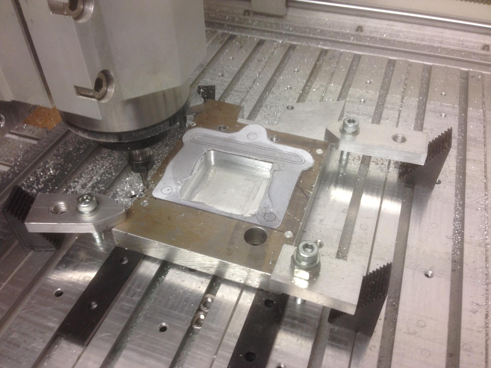

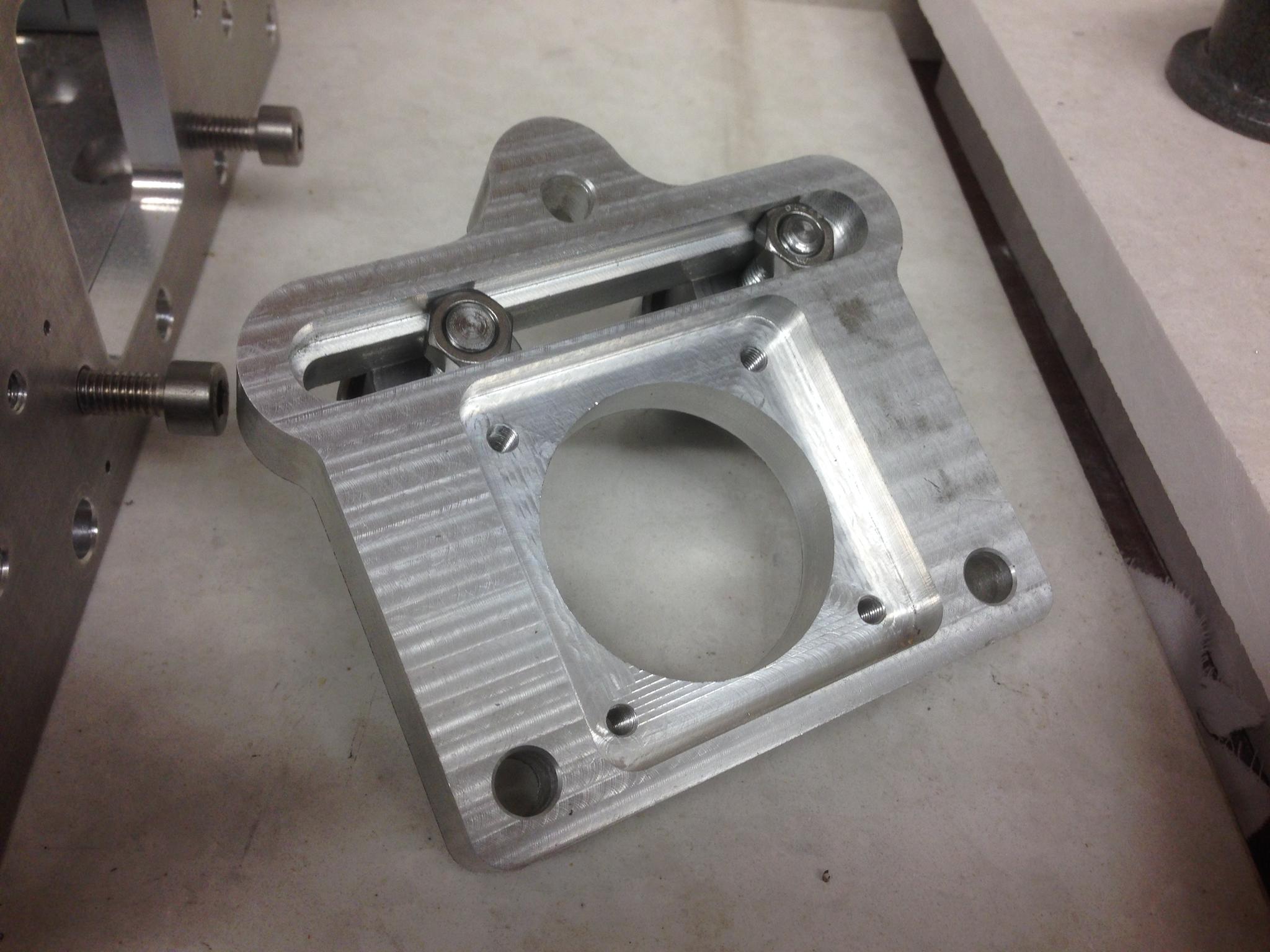

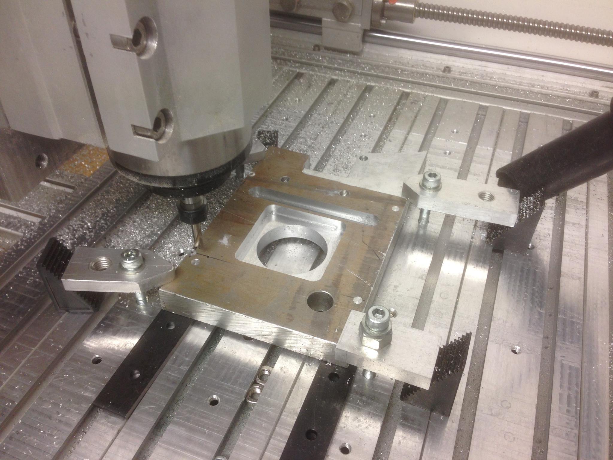

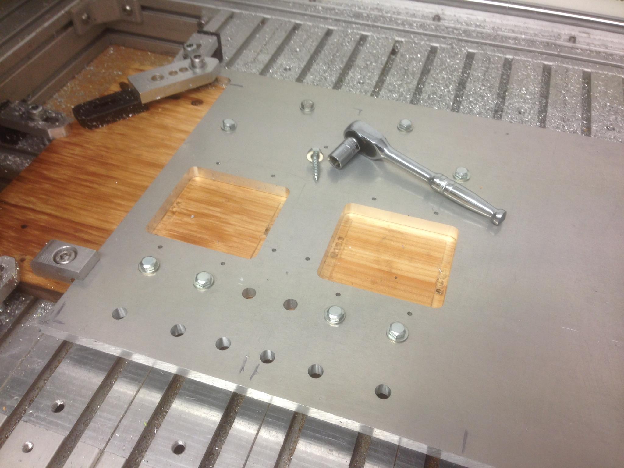

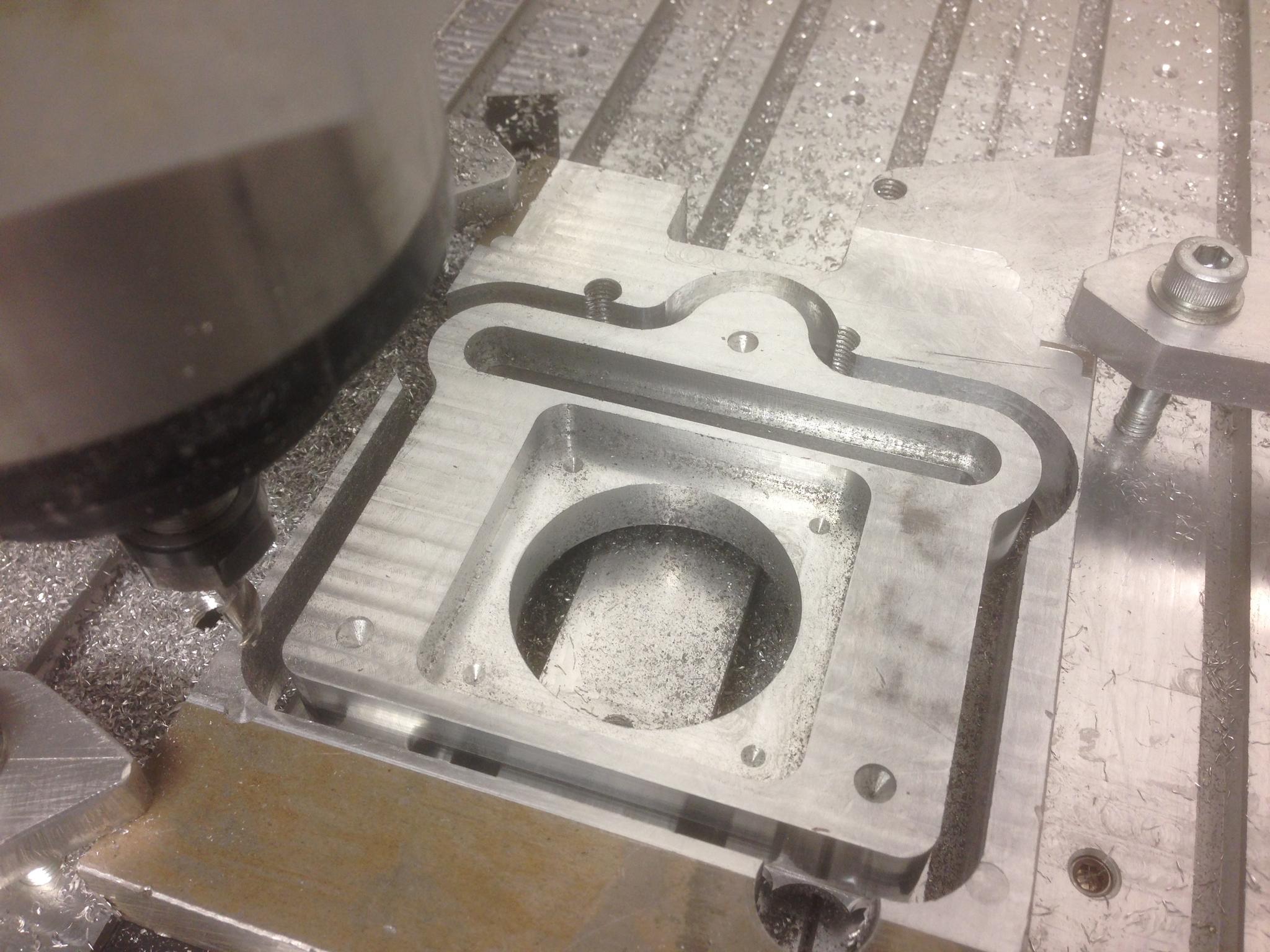

    Also, got a bit of time this week end to nearly finish the X axis motor mount / belt tensioning plate:
    Laying it out:

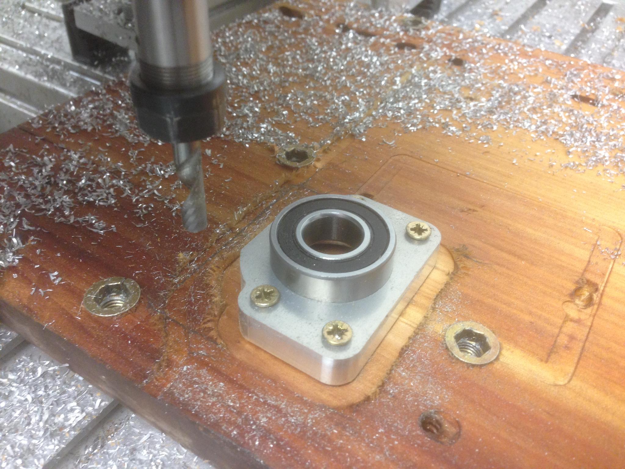

    First pocket:

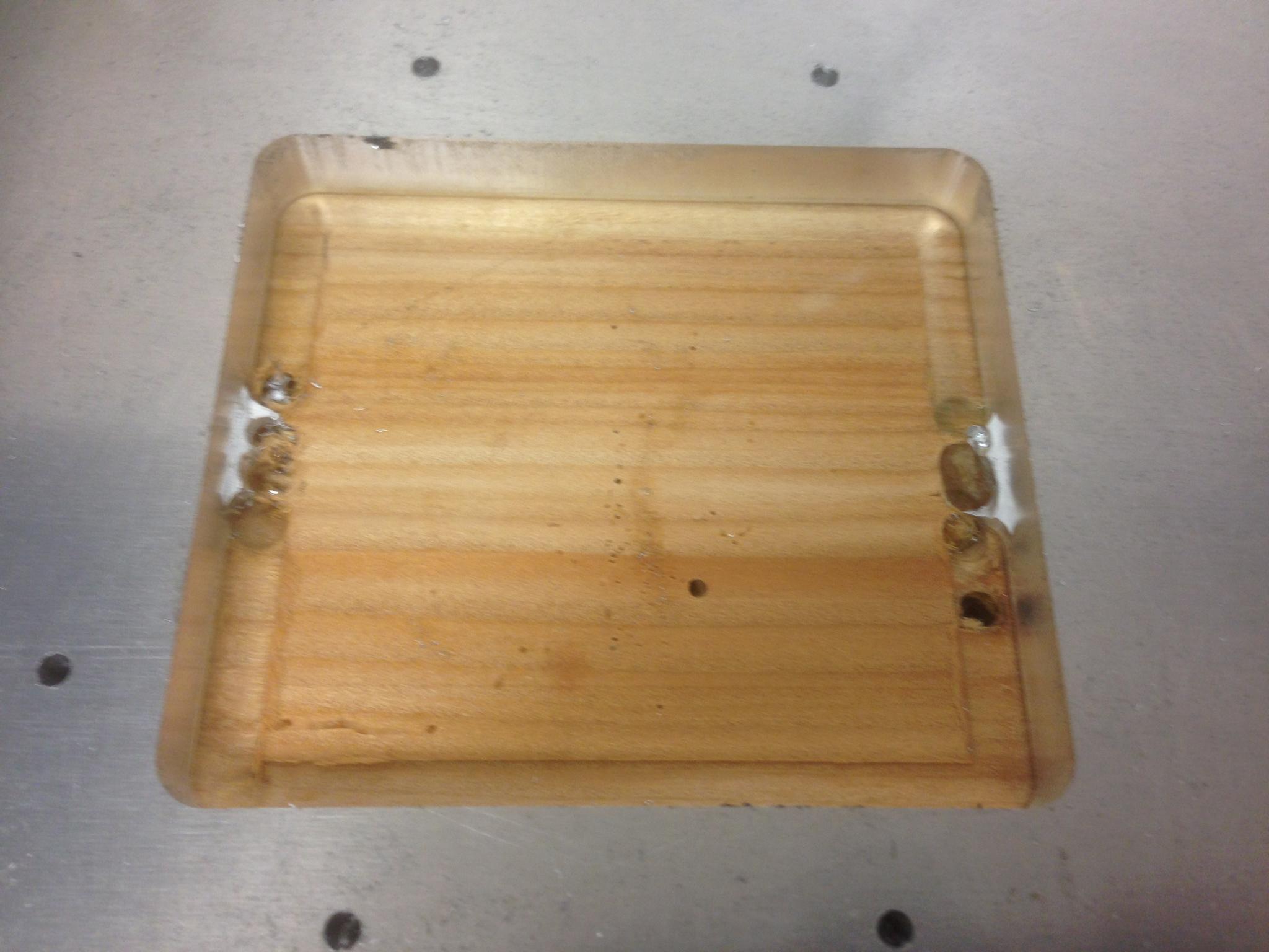

    More cutouts and slots:

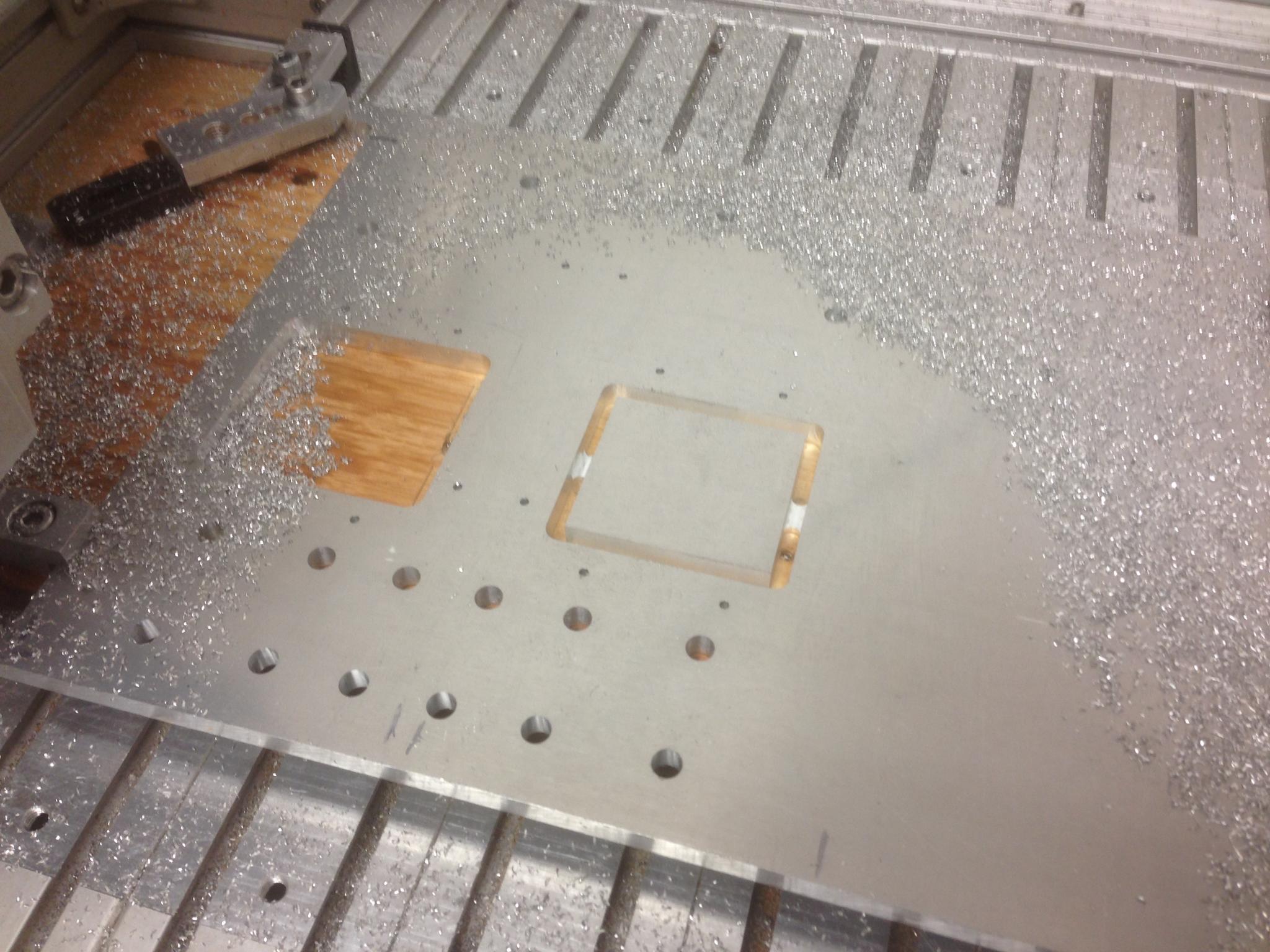

    Holes spotted, top skimmed, and profile roughed and finished:

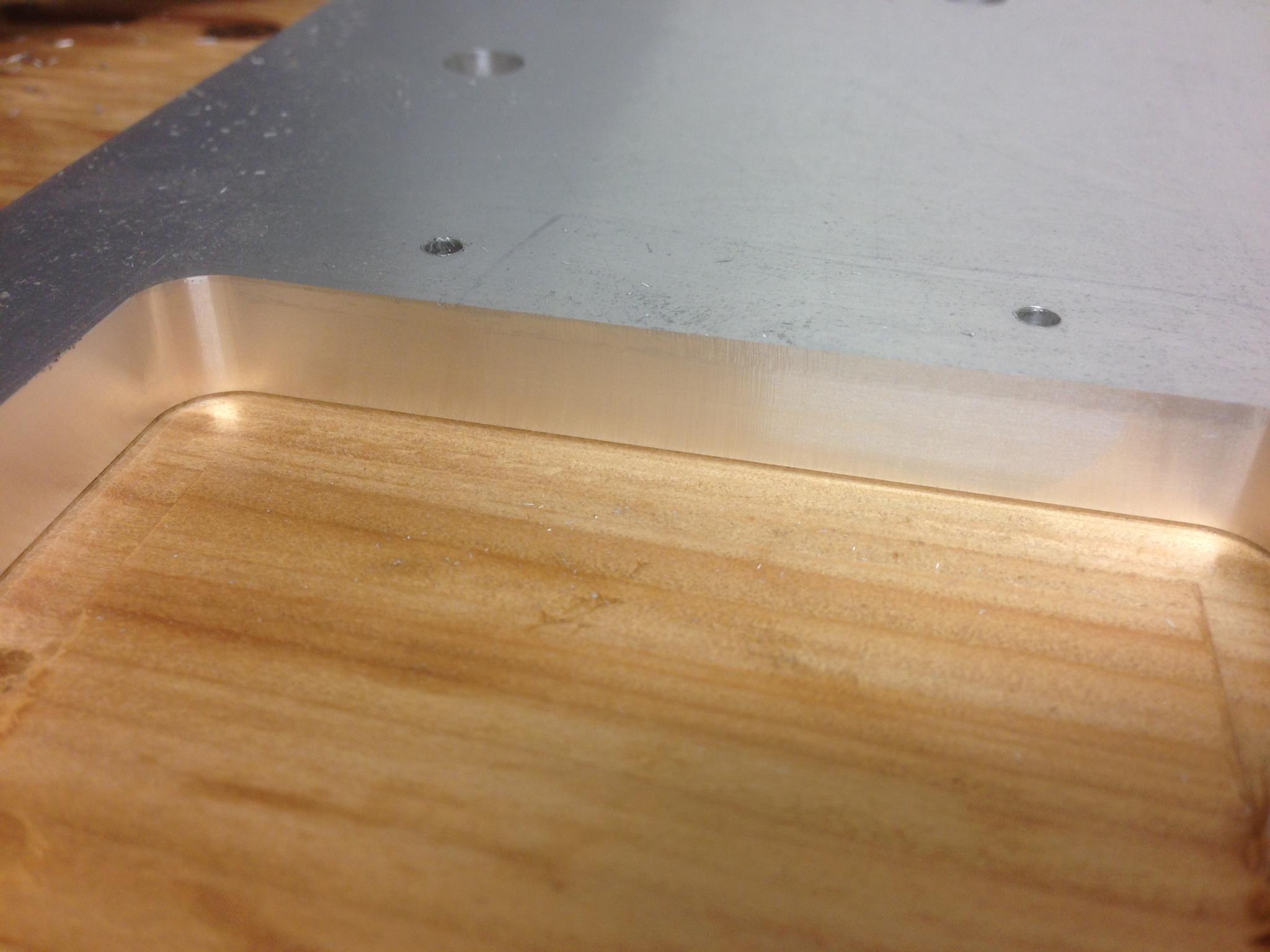

    Bought a new 6mm 2 flute 45deg helix (for aluminium) carbide from 'cncpoorboy' on ebay (for about £9) recently and just tried it out.
    http://www.ebay.co.uk/itm/2014350347...%3AMEBIDX%3AIT
    Very impressed with the finish:

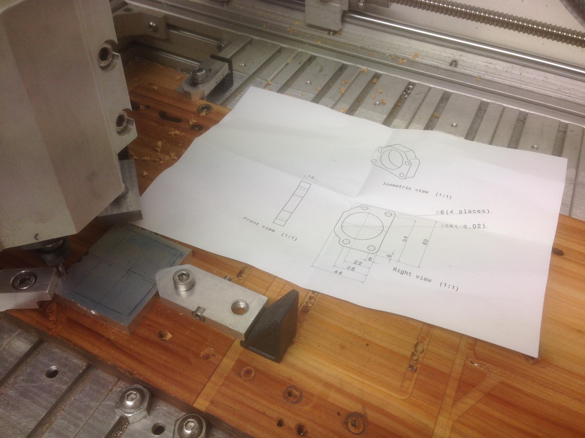

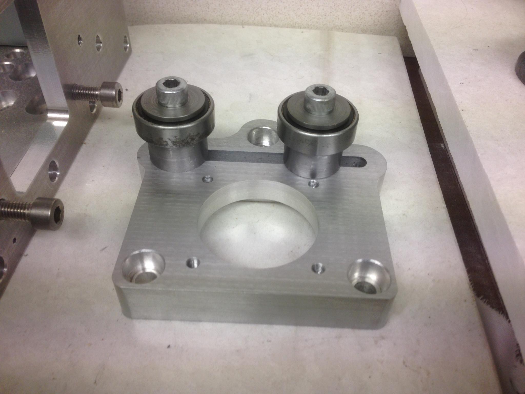

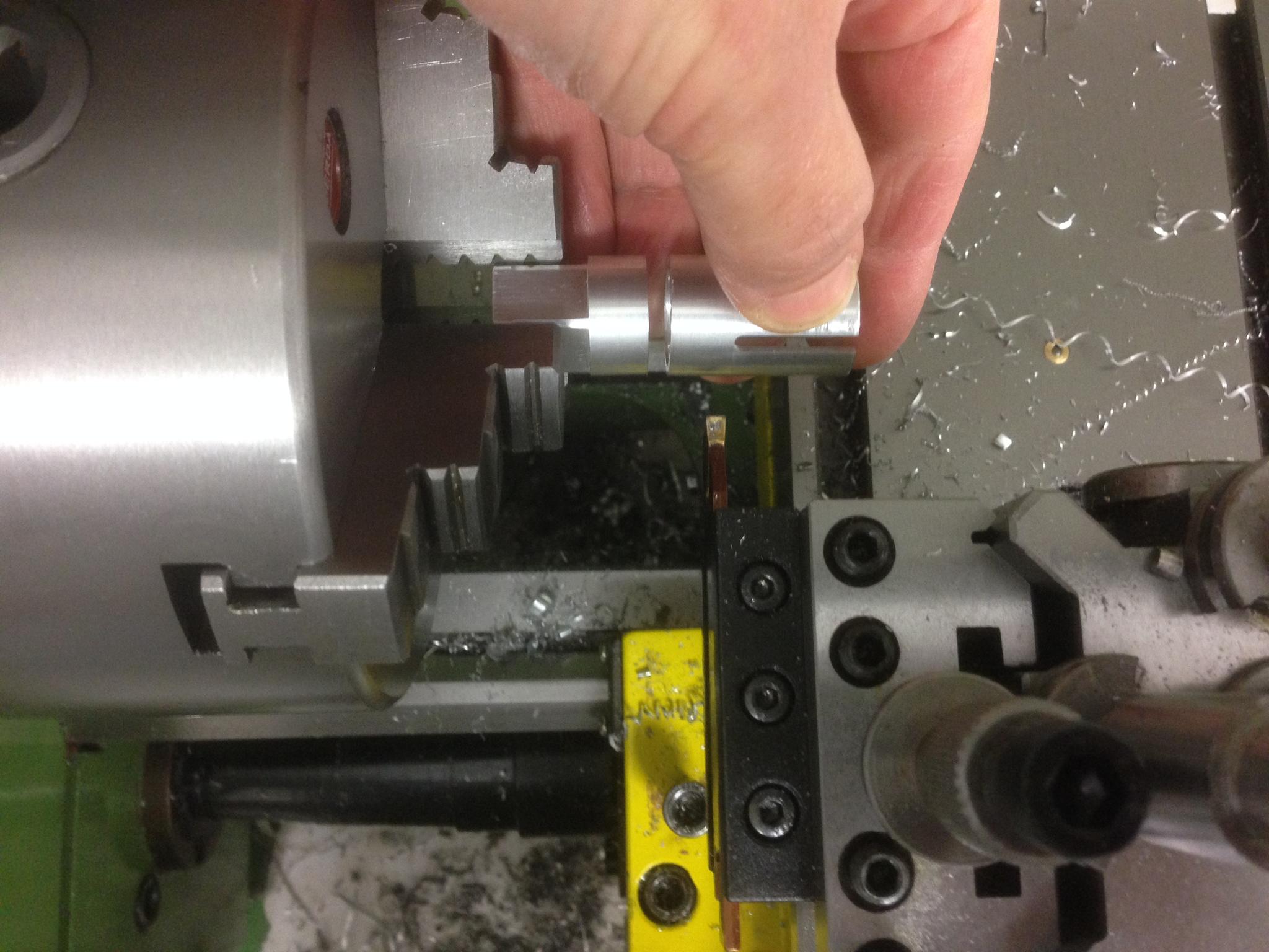

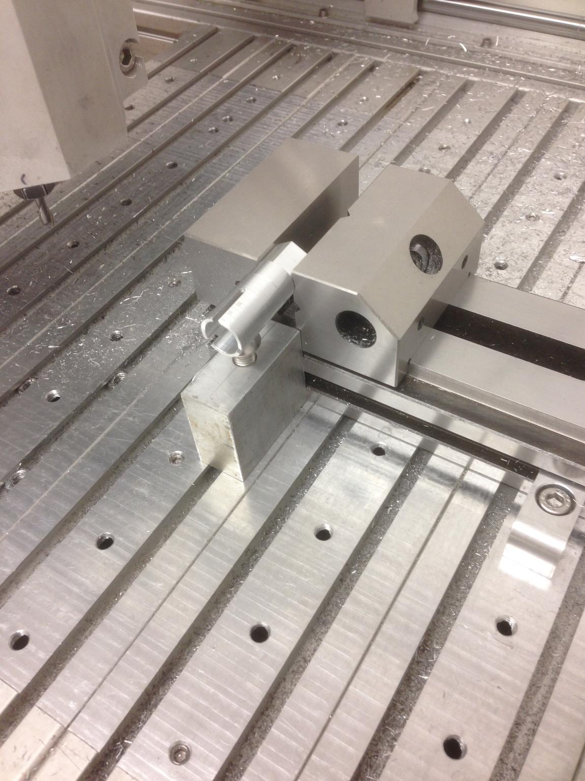

    Some work on the drill press:
    Need to skim one side and tap the M5 holes for the stepper, then its another one done.
    In case you were wondering the slot will hold the head of 2off M8 bolts to stop them rotating whilst allowing it to slide in the slot. On the other side will be a spacer and a bearing guide to tension the belt.
