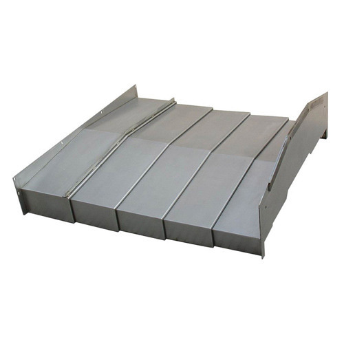

    If you accept challenges, here is one for you, as I see you are an expert at sheet metal bending: dust covers Click image for larger version.

    That sheet metal looks like a challenge. I guess they are concertina type? I think Chris Deprico (?) on YouTube made some and it looked very fiddly making the X bracing supports underneath which guide it.
