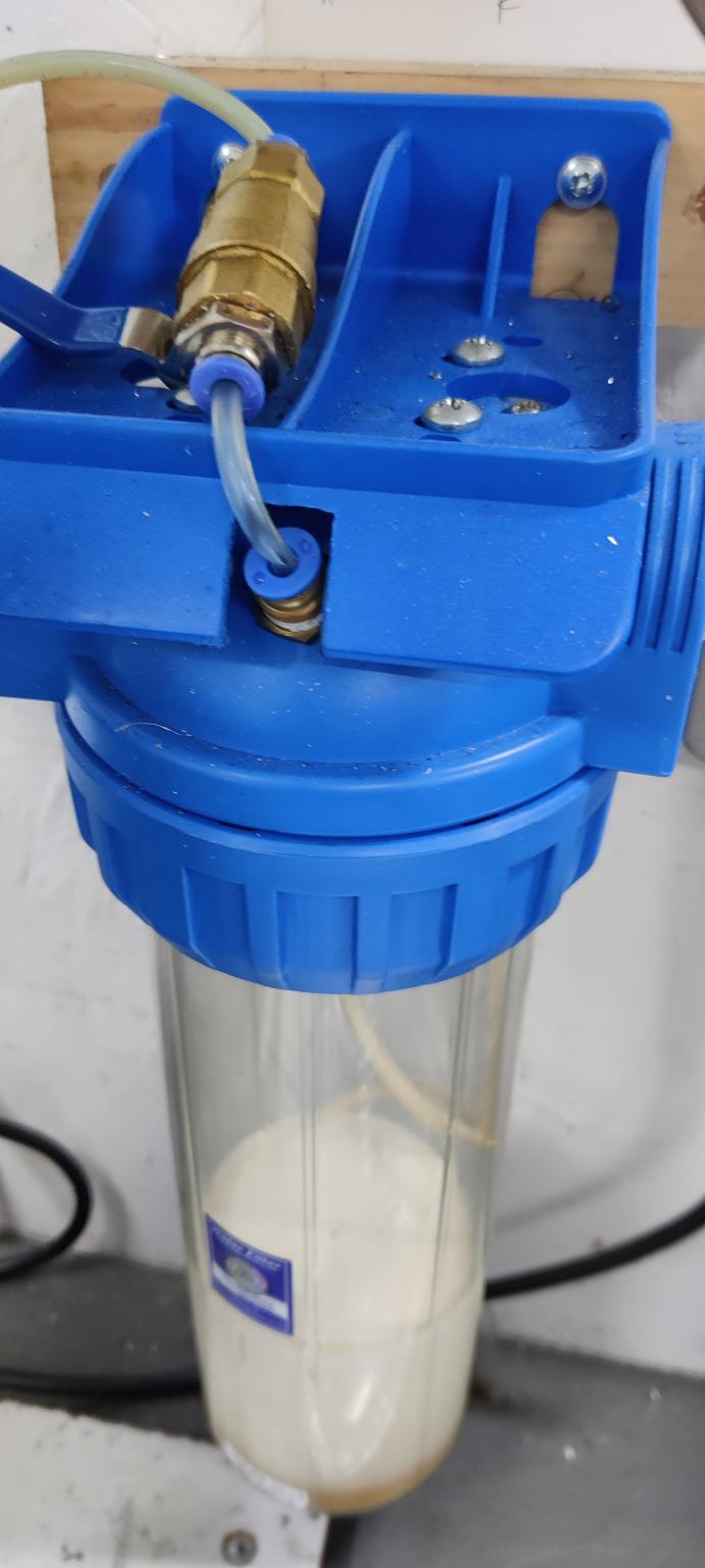

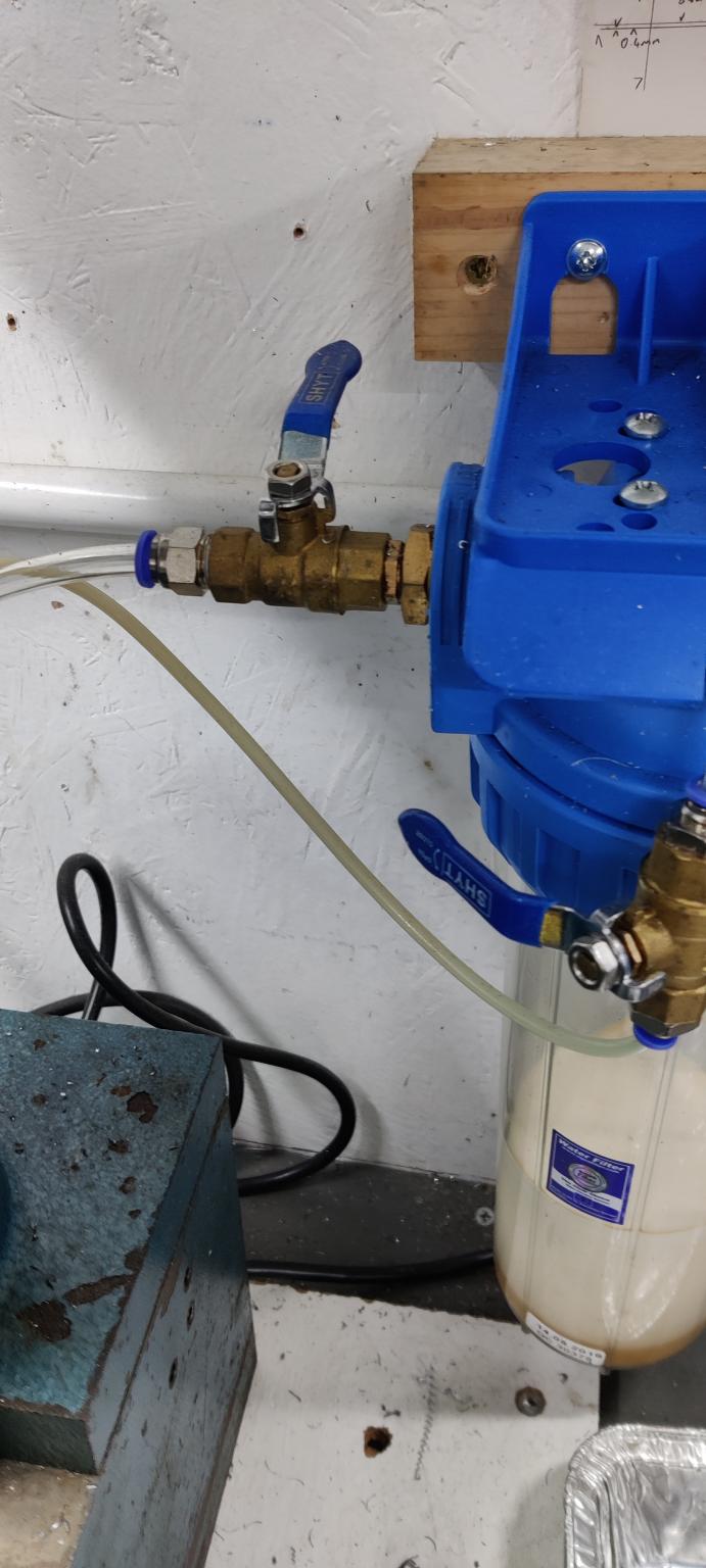

    As per the YouTube comment, here are some pics of my cool mist set up, but for my manual milling machine.
  12. #340
    Those water filters will take 8 bar it will probably say that on the box and the little screw on RH side is for letting the air out (priming) when being used as a water filter .
    Nice vid.
