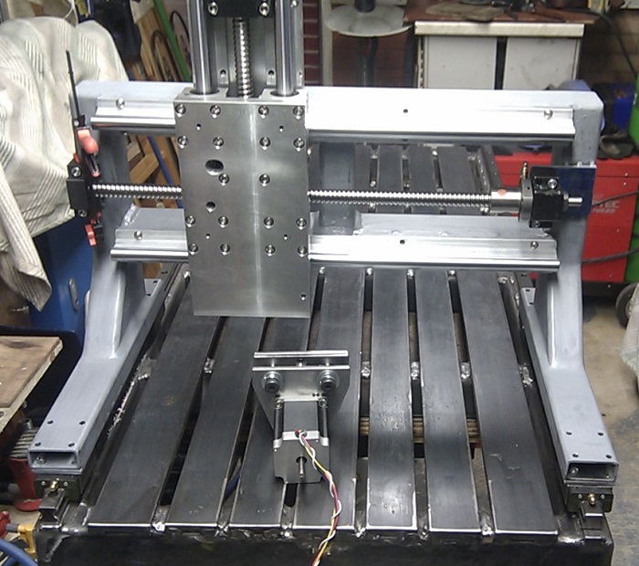

    As I feared the return to work after Christmas means workshop time has significantly reduced. For various reasons I've only been able to get about an hour in there.
    But I have been able to get a few sessions on the CAD and this has meant I was able to go over some of the other designs and have one last go at unlocking some of the compromises. The net result is I've developed some of the other ideas and ended up with what I think is a much better design.
    Old one for comparison:
    Attachment 17242
    Here is the new version:
    iso
    Attachment 17235
    iso rear
    Attachment 17236
    X axis
    Attachment 17237
    Y axis
    Attachment 17238
    Z axis
    Attachment 17239
    Just X axis showing gantry, ballscrews, epoxy (orange), and custom ballscrew floating end as the ballscrews were not long enough to mount the standard floating end.
    Attachment 17240
    X axis drive and belt tensioning arrangement
    Attachment 17243
    Side View:
    Attachment 17244
    The new features are:
    Gantry beams smaller
    They are now 80x40x5 RHS steel (down from 100x60x5). I'd put too much emphasis on huge sections, whereas with a double beam gantry I could afford to scale them down and still have plenty of stiffness in reserve over a single gantry.
    Because they are smaller I was able to re-configure the X-bearings, bring them closer together, and give more travel in X. They are now only 274mm apart which is getting close to my current machine spacing. I was also able to get the X ballnuts at the centre of stiffness, rather than at the ends of the gantry.
    Y rails are much lower
    With the smaller gantry sections the Y rails are now lower and closer to the tool, as are the Y axis bearings, which all provides more stiffness
    Ballscrews lower
    As the gantry sections are narrower I was much happier putting the ballscrews on the front and rear faces as there was much less of a bracket required to join them back to the main Y axis, therefore stiffer.
    These are now much lower in Z which also puts them much closer to the tool, which reduces the moments, which lowers the forces on the Y bearings and makes the machine stiffer.
    I was also able to put the ballnut in the centre of stiffness, rather than on the outer edge of the Y axis. There might be a marginal gain here I really don't know, but it does look nicer.
    Y axis bearings spacing
    By re-designing the gantry end plates to free up some space I was able to make full use of the linear rail and spread the Y axis bearings out considerably more than before - without losing travel. This should significantly improve the stiffness due to moment inputs when cutting in the Y direction. When coupled with the lower ballscrews there should be a double win here.
    In one of my earlier posts I suggested that double ballscrew on Y eliminates racking - whilst this is true for rotations about Z axis, it is not for rotations about the X axis. To eliminate these you could add another 2 ballscrews lower down, but that is not practical (!) so you do still need to space the Y bearings out even with double Y ballscrews. Rotations about the Y axis are dealt with by having the double gantry beams no worries there.

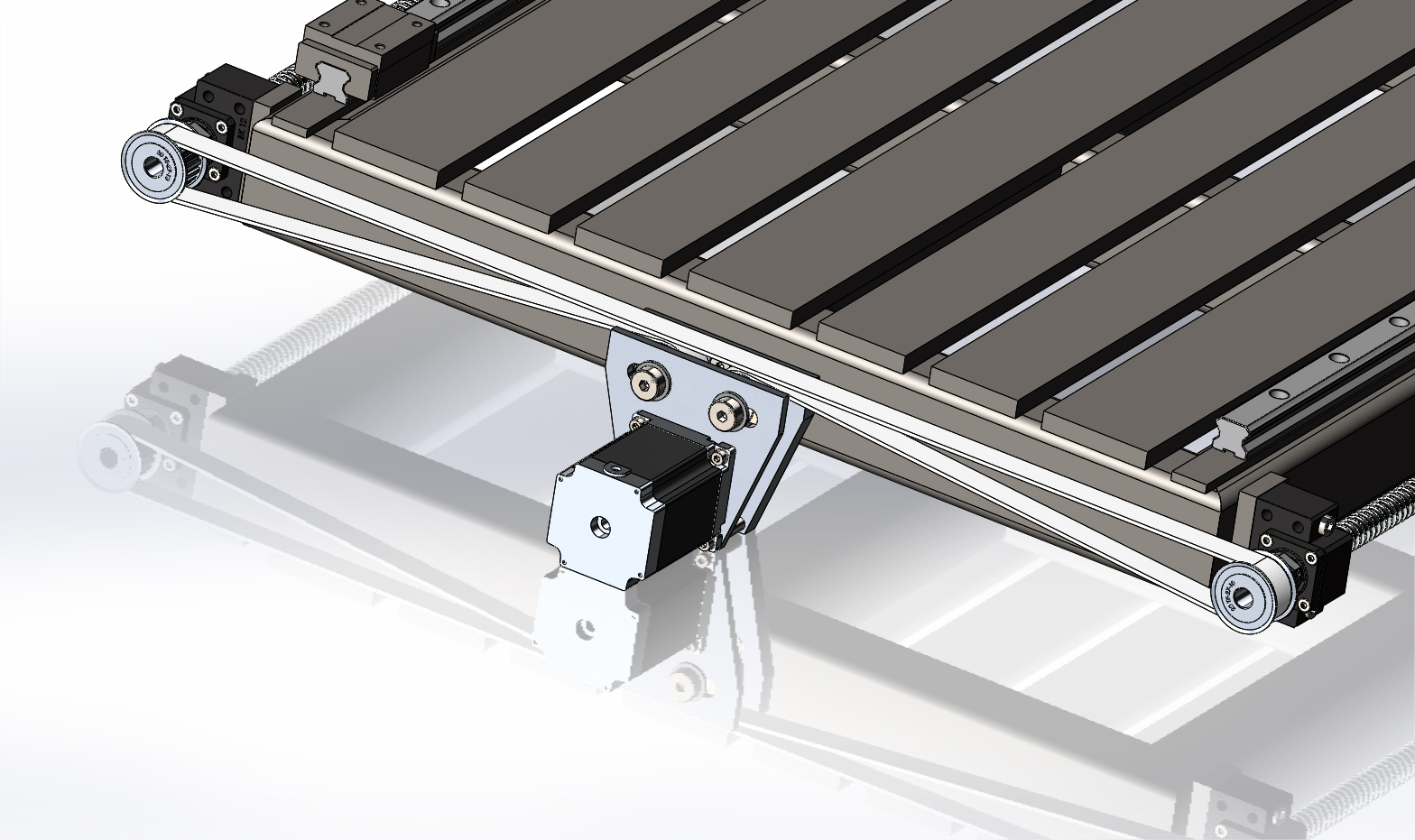

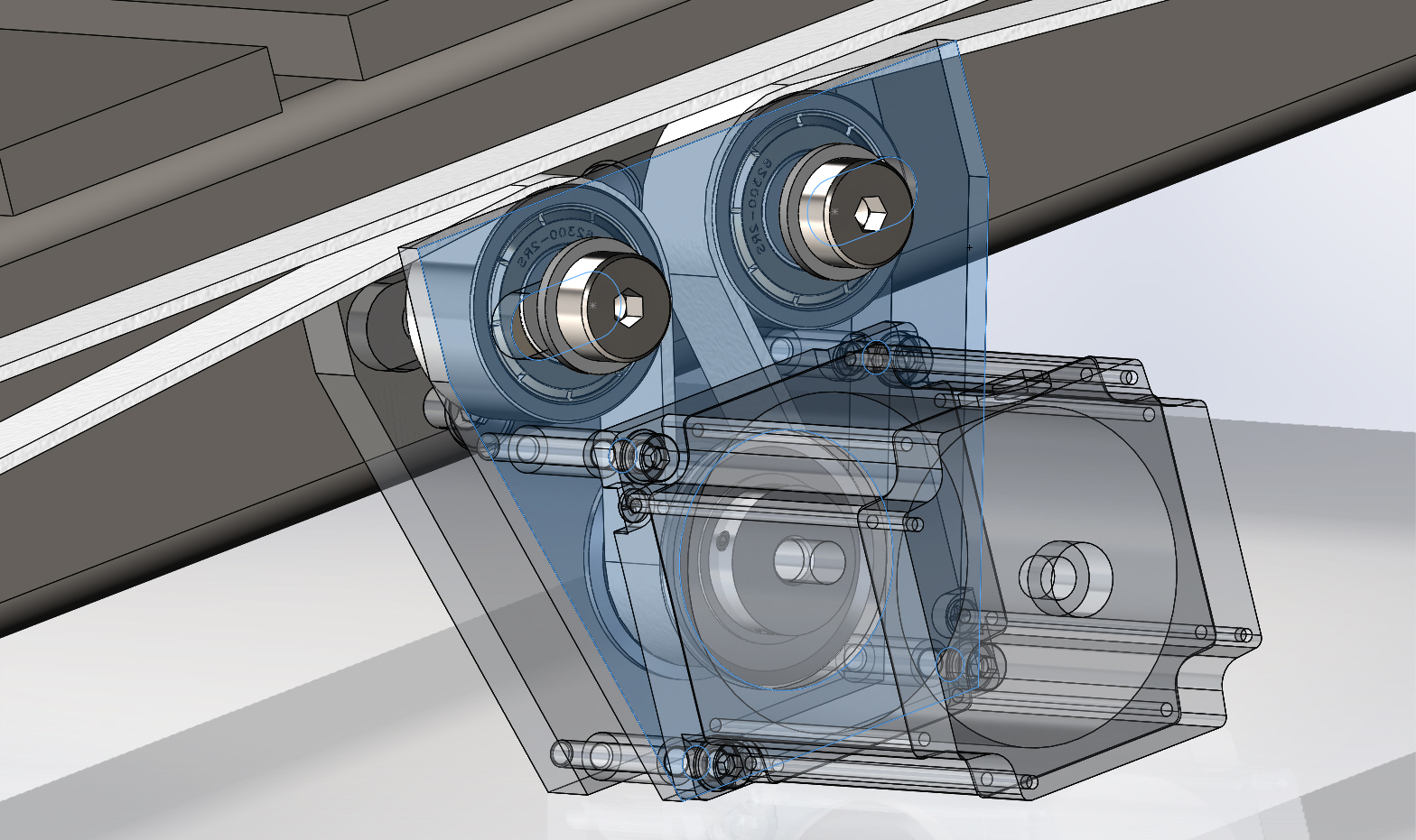

    X drive
    I've gone with something a bit different here which does not use tensioning idlers. The steppers are on plates which are slotted, and the steppers are also in slots. Between them I should be able to tension the short belt up to the ballscrew, and the syncronising belt across to the other stepper at the same time by pushing the motor off into one corner. Everything is 5 HTD with 15mm belts.
    Cooling
    I've decided that there are a couple of options to place the radiator, plus the option just to go for the 'big metal bucket' out of sight. So I'm going to build it and then just see which one takes my fancy. Sometimes you can CAD things too much and get tied up in the last details.
    Luckily the new design retains the parts I'd already made so nothing lost. Thank you for the comments made so far, stirring up the doubts I had about some aspects, and making me revisit the previous designs. I think it is all the better for it.
    Right, time to start CAMing up some of the parts ready for whenever the next workshop session is . . .

    Thanks Tom. Yes, lots of ways to drive 2 ballscrews - that one would work as well.
    Your little machine looks really good. Nicely built !
  10. #69

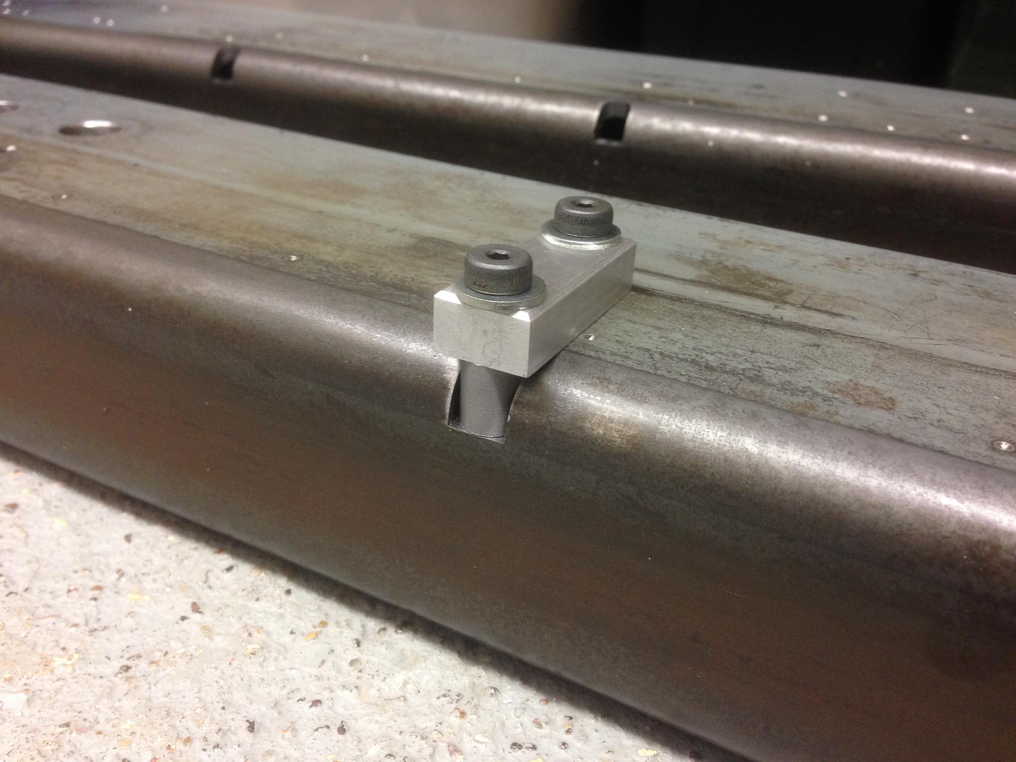

    OK, more updates. To finish off the info on the bed rail supports, here is the little jig I made up to hold the bosses in place:
    Here it is in position:
    It uses 6mm shoulder bolts to give a good reference position and picks up off the inner tapped hole already there. This holds the boss in just the right place for welding. It's now ready for welding - just need to catch my friend with the welder in the next few days or so. This is bolt down the supported rail which obviously uses a pair of bolts on either side of the flange.
    I've also taken the opportunity to spot out the holes for a profiled rail (i.e down the middle) to make a future upgrade much easier to do.

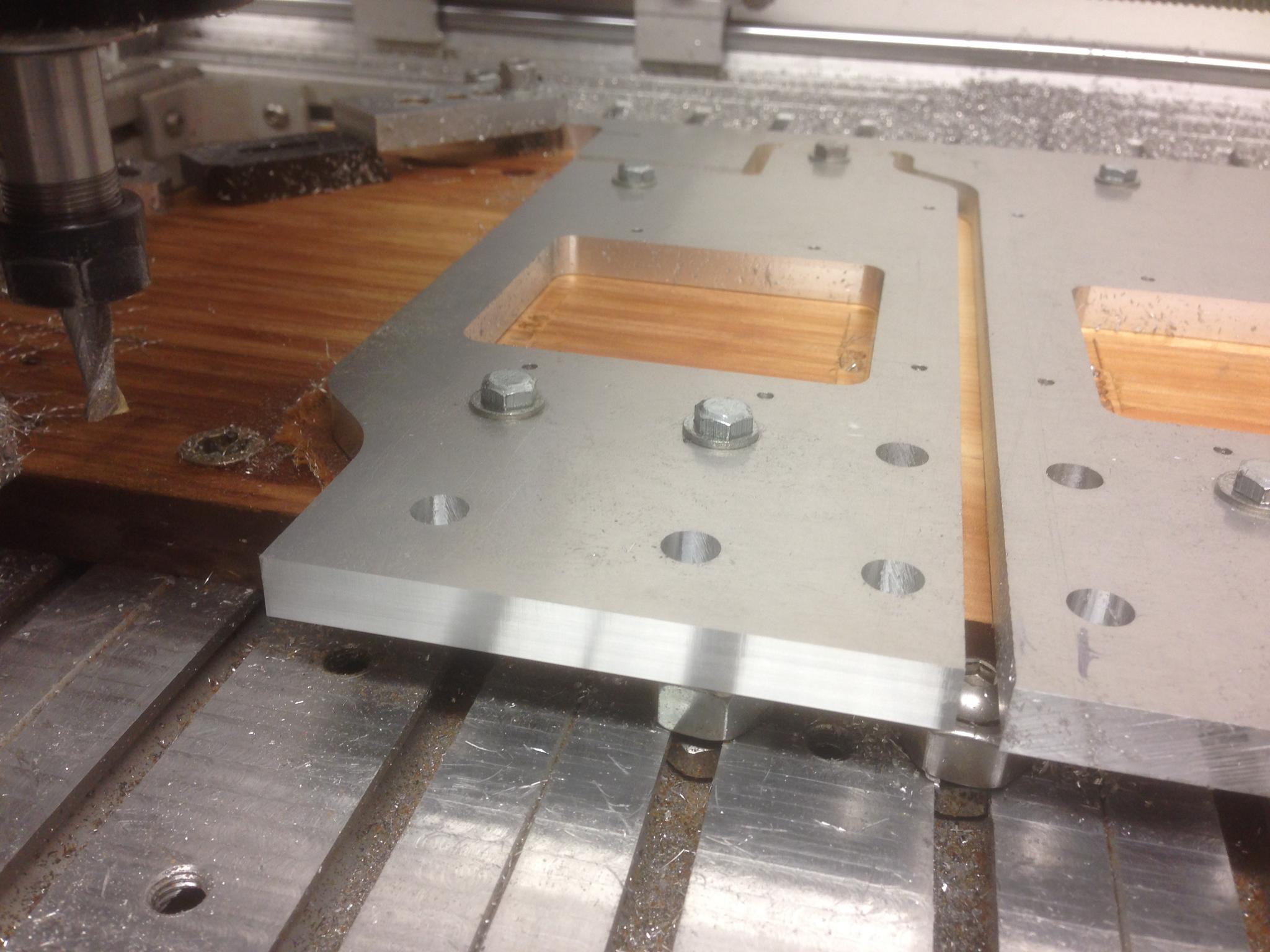

    Next up are the end plates which hold the motor mounting plates. Starting with a nice skimmed off the sacrificial board:
    Then setting up:
    (note that I've scribbled down the X, Y, Z coord of the workoffset on the drawing - I always write them down in case of power failure)
    I'm making a mirrored pair here. A few holes, and a large pocket in the middle of each one. You can drill and screw through the waste first, but and I'll talk you through my approach on the large cutout as it worked quite well as an alternative. This is all to avoid those terrible tool witness marks from tabs.
    1) Use an inside profile with a 1mm offset (remaining stock on the side wall) WITH TABS.
    2) Then drill through the tabs with a cordless drill to remove the waste:
    3) Manually jog the machine to remove most of the tabs (not critical to get all of it)
    4) Clean up profile pass to remove the last 1mm. I do this in 2 stages as this is what works for my machine. 1st cleanup 3mm DOC, 0.9mm WOC, final cut full DOC, 0.1mm WOC.
    Gives this surface finish:

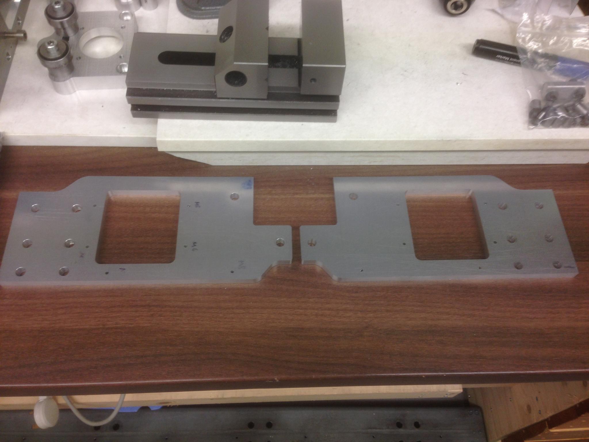

    Then bolting down, removing clamps, and onto the profile cut:
    Same approach as above using a rough cut leaving 1mm stock, then semi-finish 3mm DOC, 0.9mm WOC, and finish full DOC, 0.1mm WOC. A stiffer/better machine might do the finish in one pass. I'm also limited to 6mm max cutter on ER11 collet. Good finish anyway:
    Mirror part cut the same way, then some holes tapped and surface cleaned up:

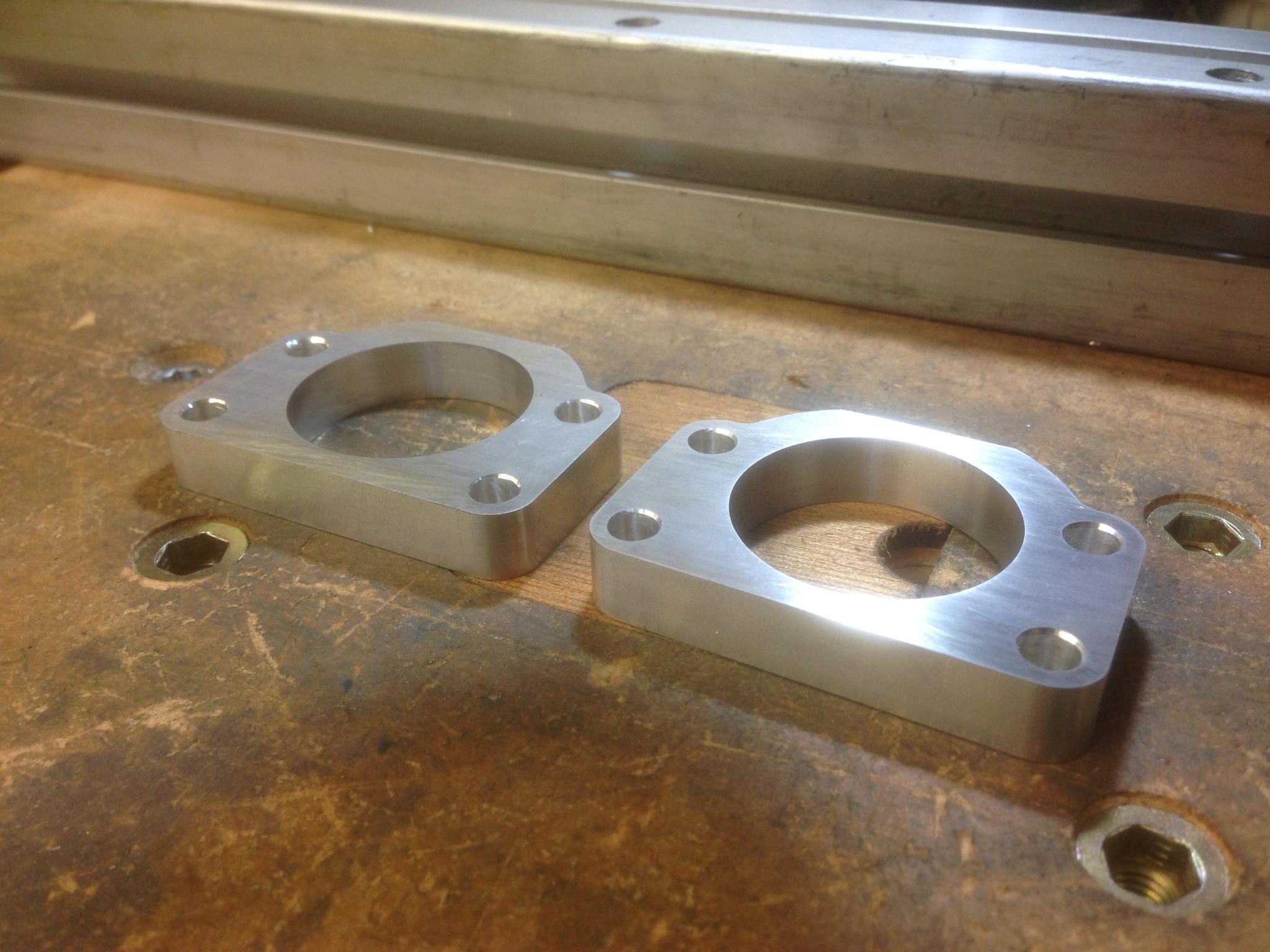

    Then onto the bearing holders:
    They will be a light press fit:
    Second one made:
    Trial fit onto the bearing plates:
    This allows the ballscrew end bearing position to be fine tuned when setting up.
