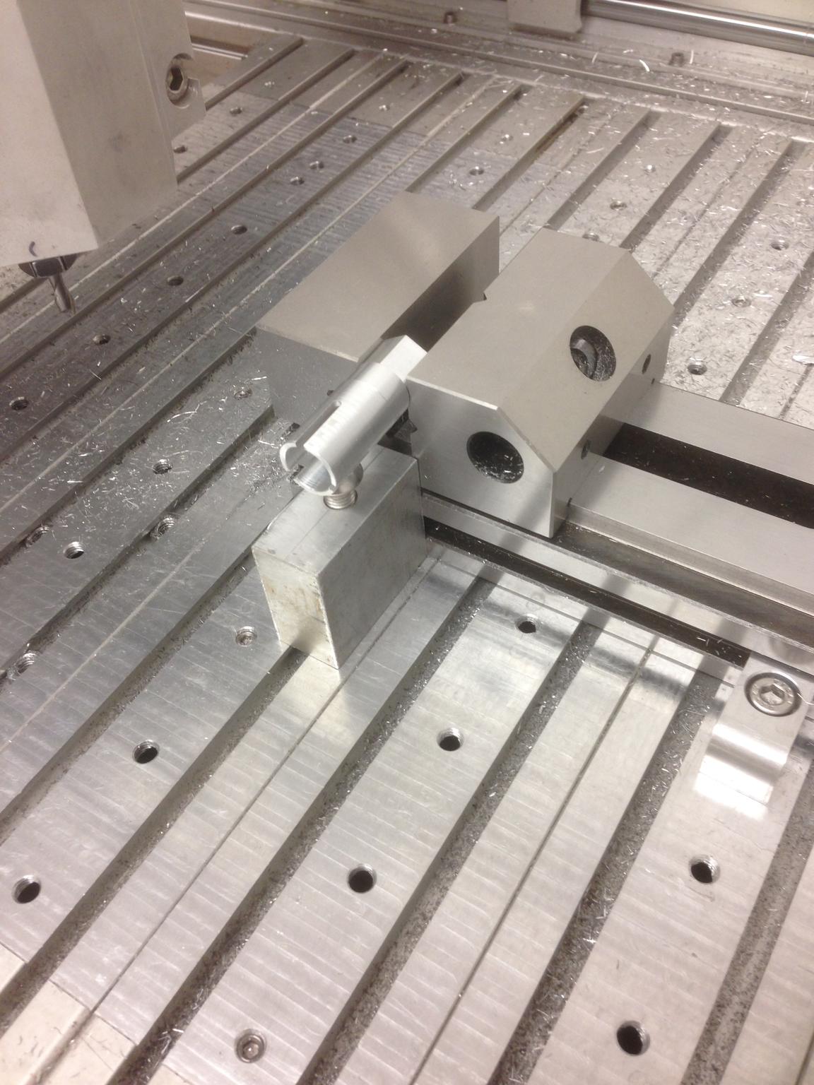

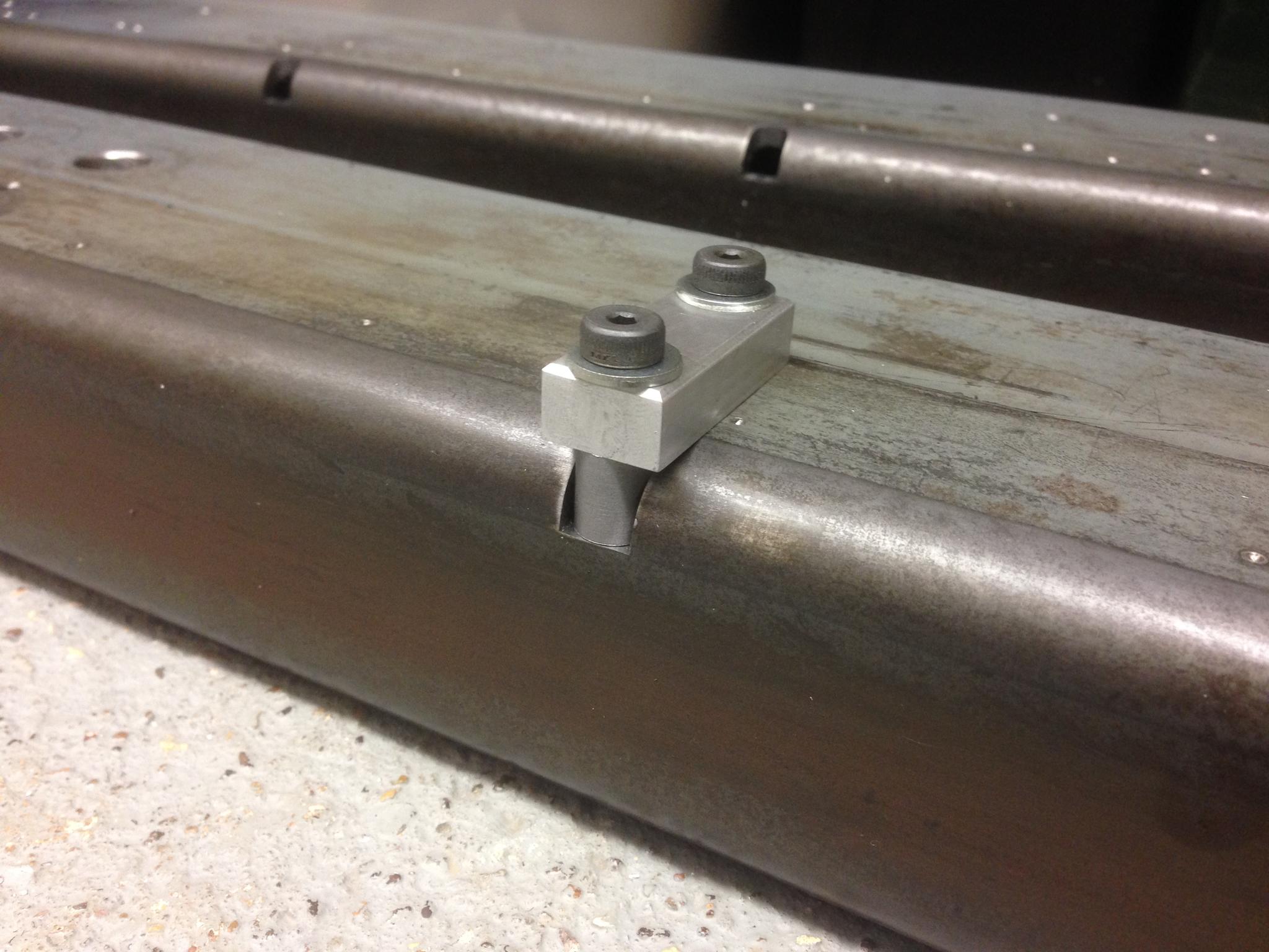

    OK, more updates. To finish off the info on the bed rail supports, here is the little jig I made up to hold the bosses in place:
    Attachment 20182
    Here it is in position:
    Attachment 20183
    It uses 6mm shoulder bolts to give a good reference position and picks up off the inner tapped hole already there. This holds the boss in just the right place for welding. It's now ready for welding - just need to catch my friend with the welder in the next few days or so. This is bolt down the supported rail which obviously uses a pair of bolts on either side of the flange.
    I've also taken the opportunity to spot out the holes for a profiled rail (i.e down the middle) to make a future upgrade much easier to do.

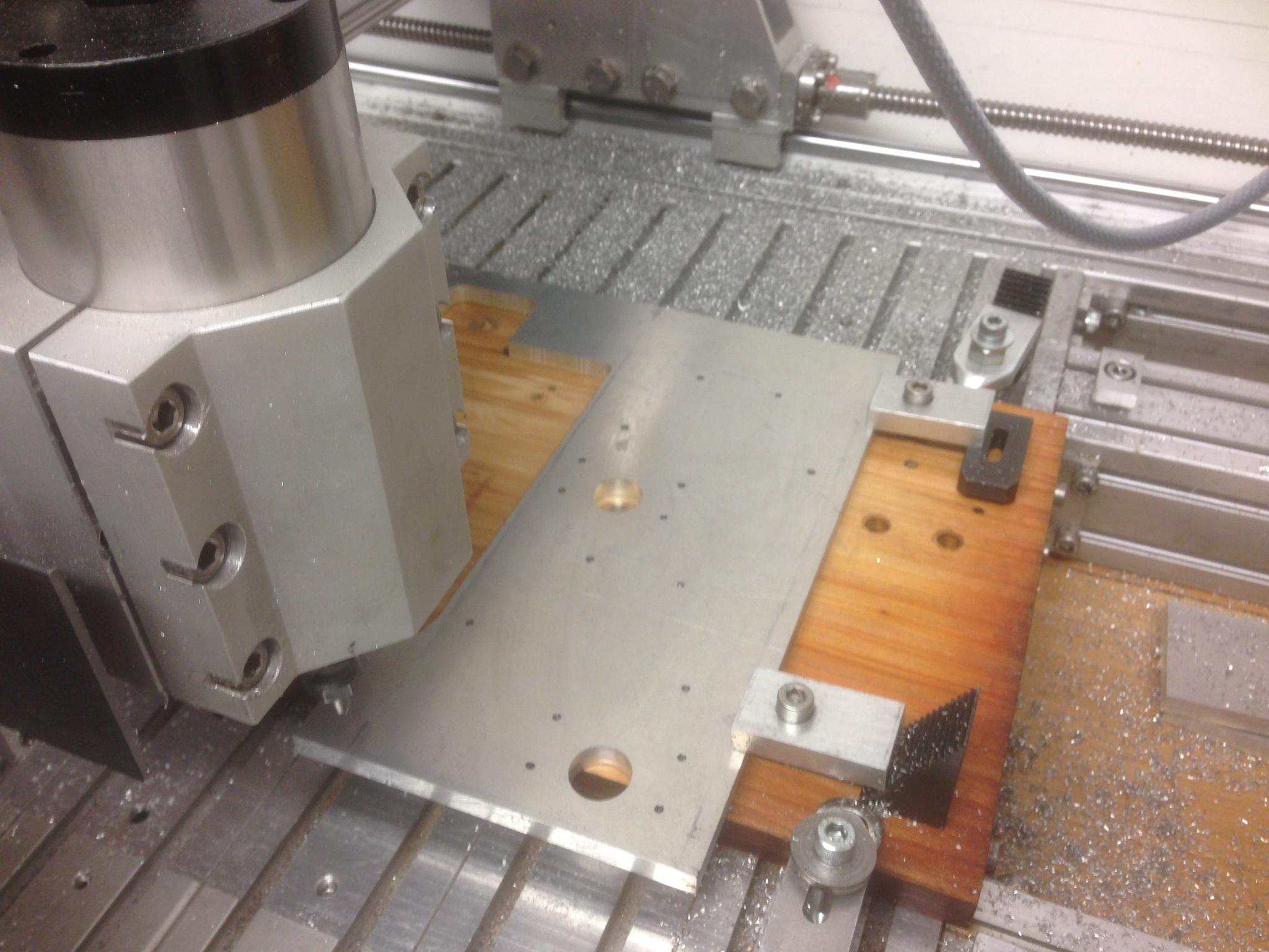

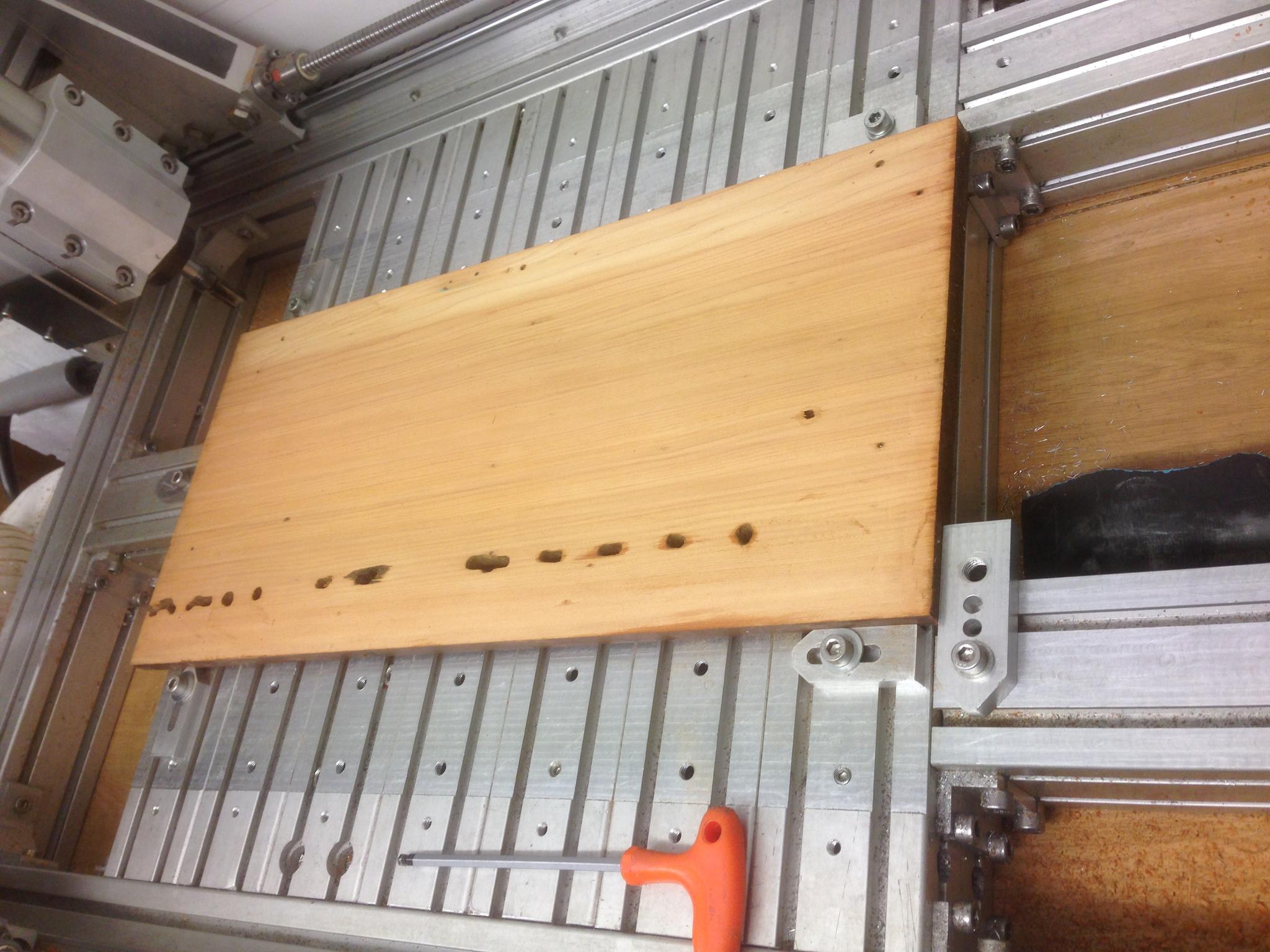

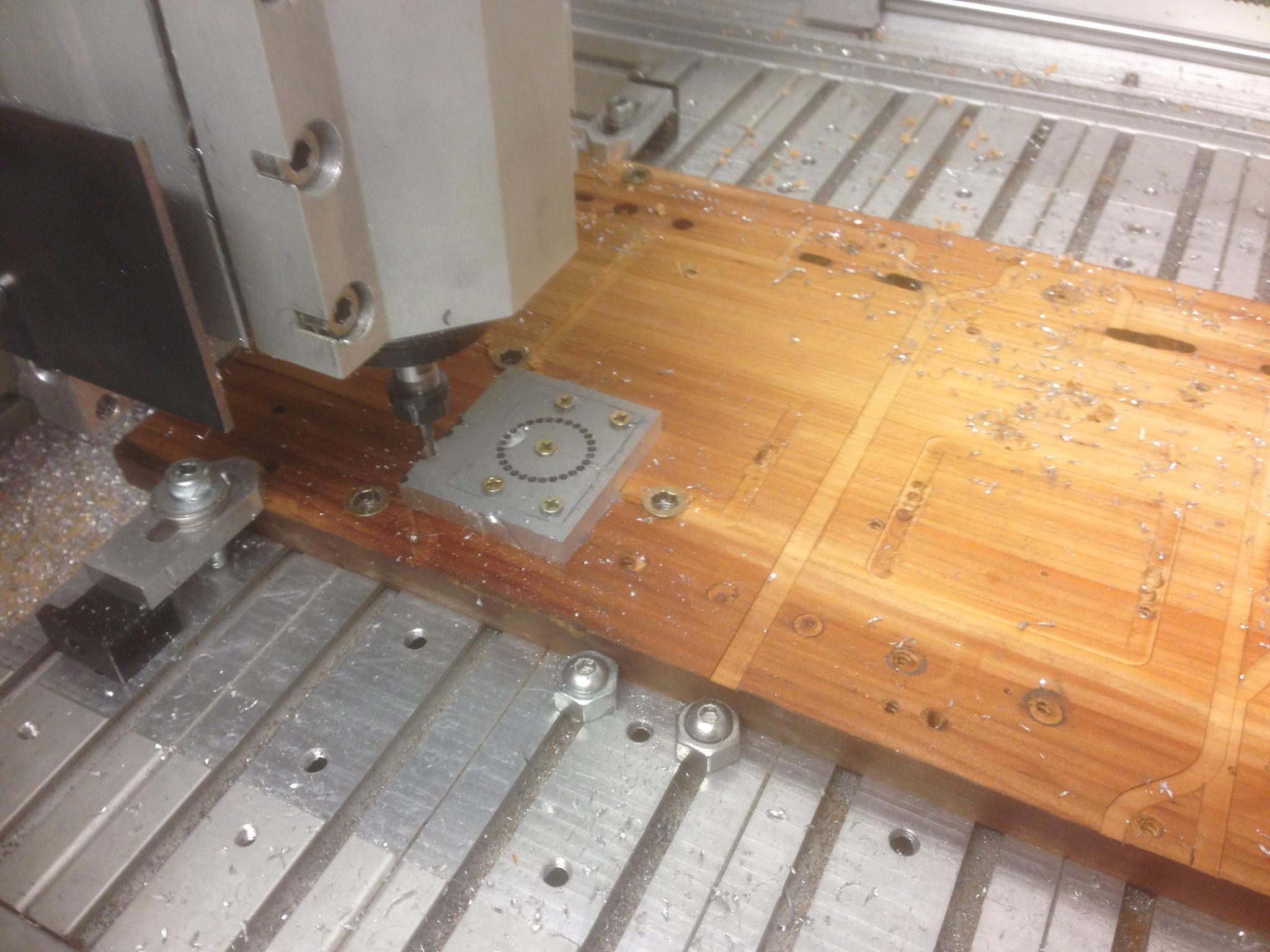

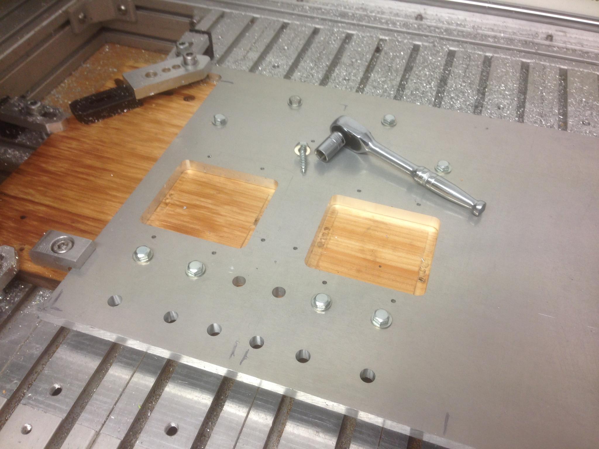

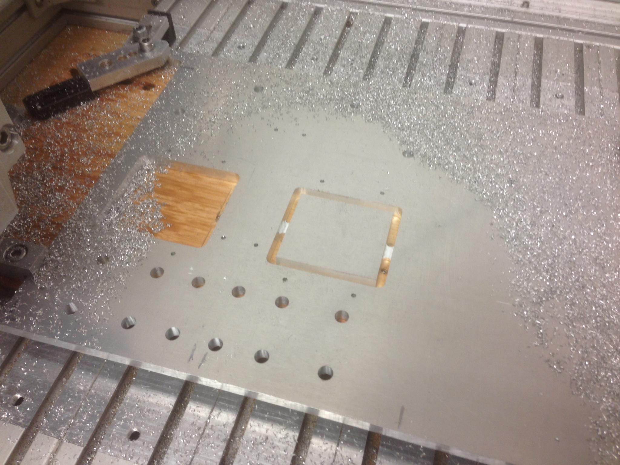

    Next up are the end plates which hold the motor mounting plates. Starting with a nice skimmed off the sacrificial board:
    Attachment 20184

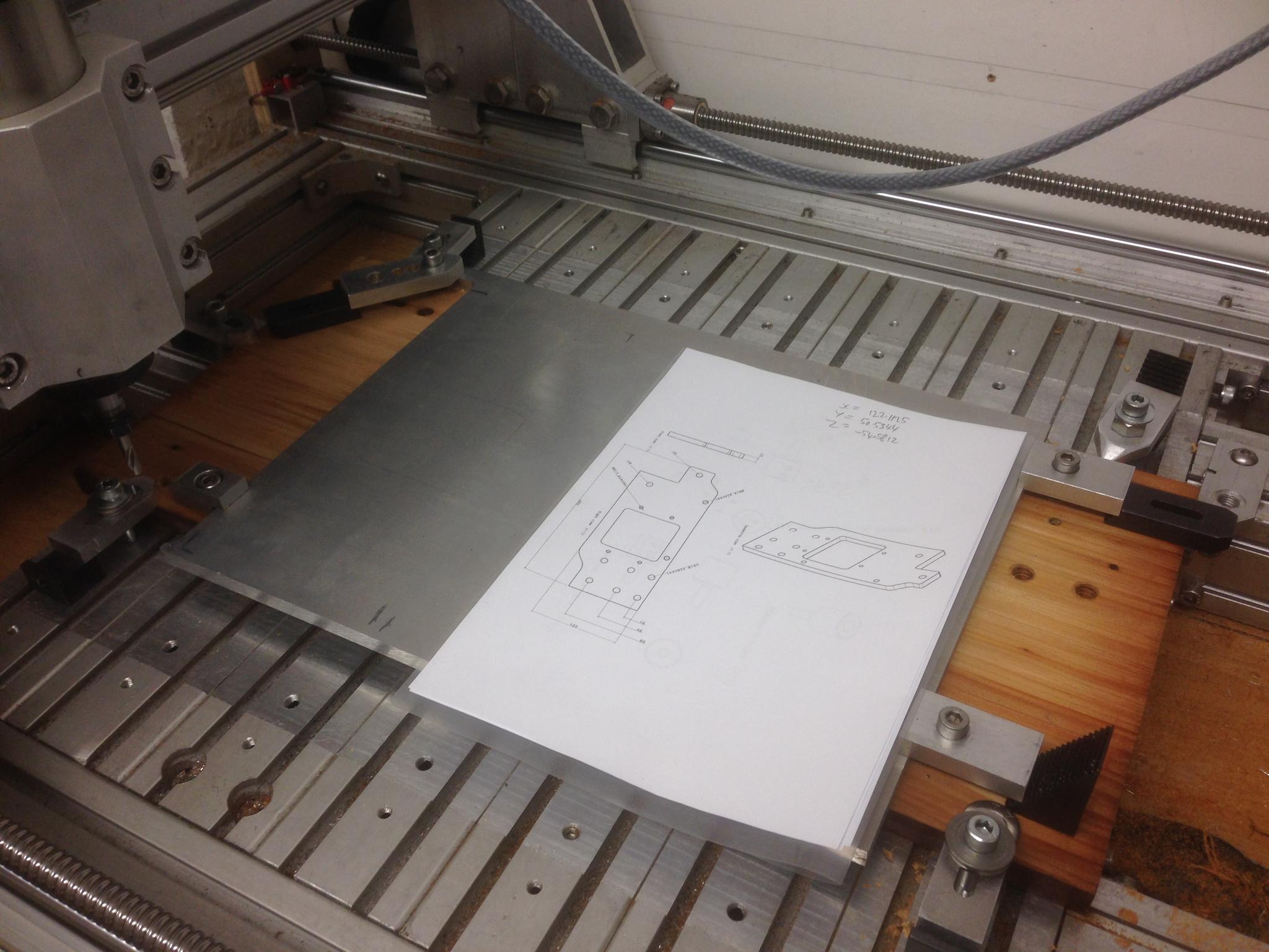

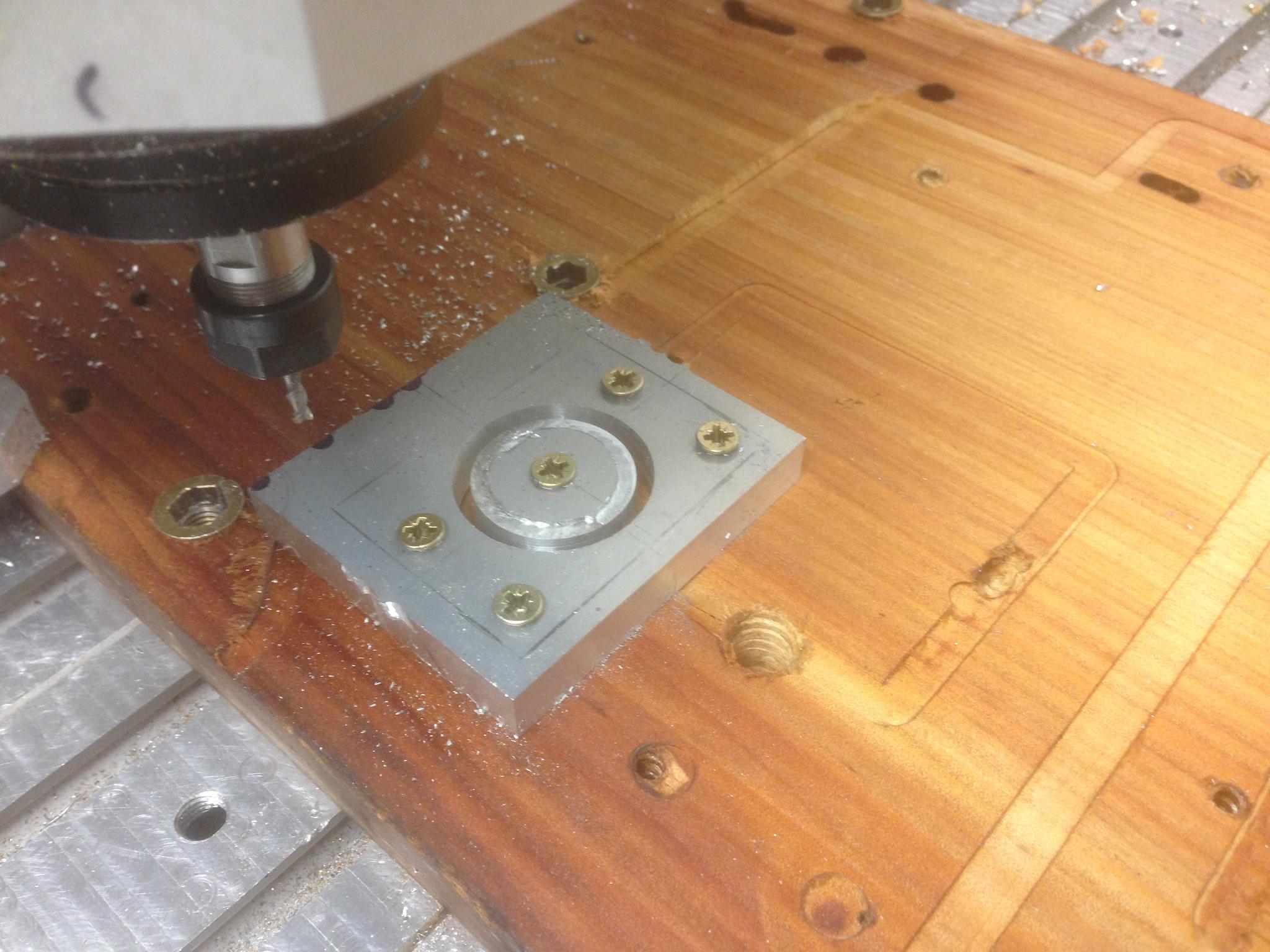

    Then setting up:
    Attachment 20185

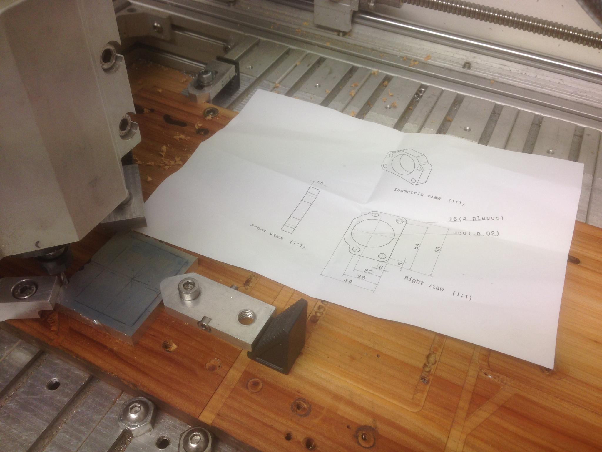

    (note that I've scribbled down the X, Y, Z coord of the workoffset on the drawing - I always write them down in case of power failure)
    I'm making a mirrored pair here. A few holes, and a large pocket in the middle of each one. You can drill and screw through the waste first, but and I'll talk you through my approach on the large cutout as it worked quite well as an alternative. This is all to avoid those terrible tool witness marks from tabs.

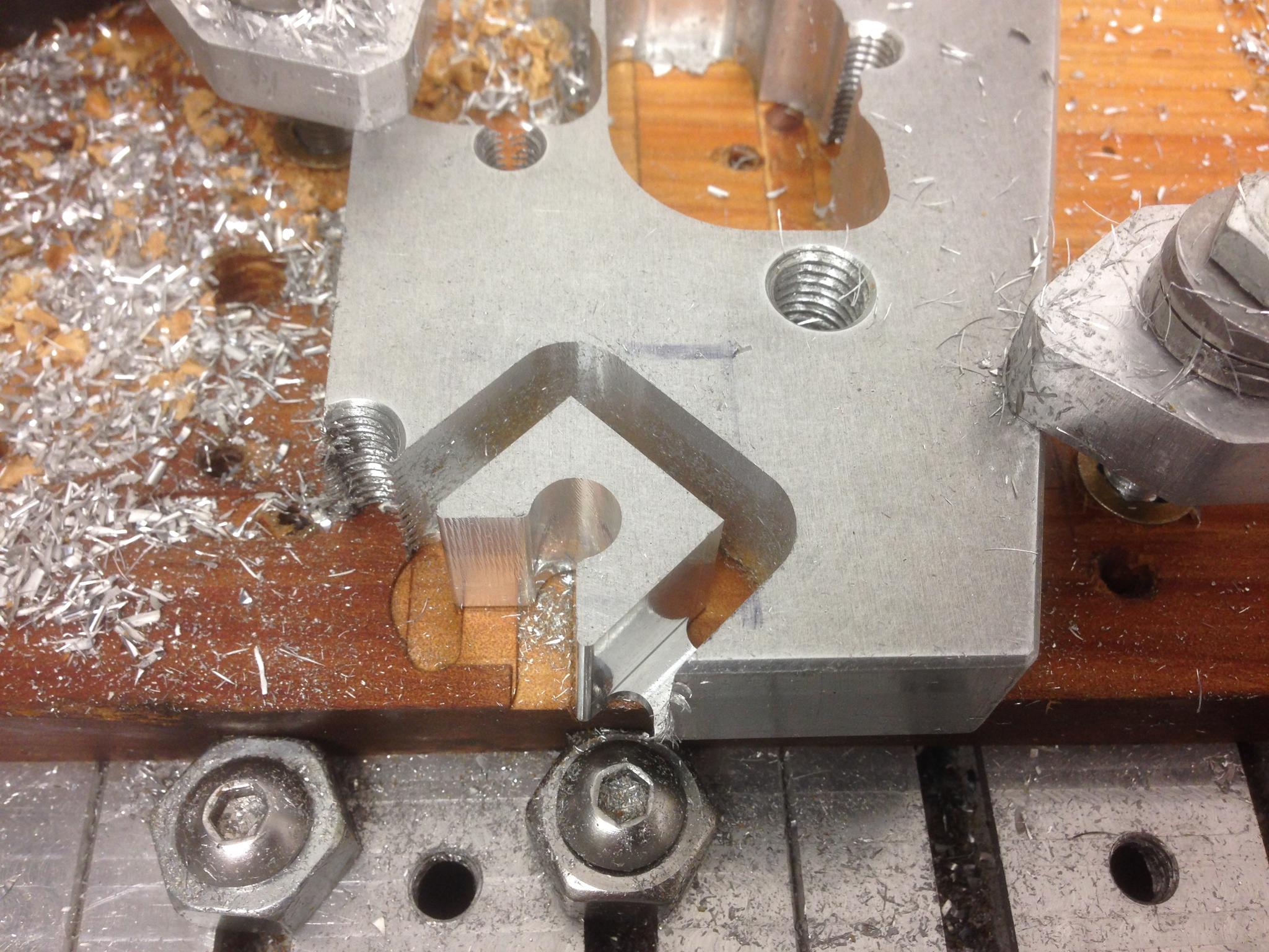

    1) Use an inside profile with a 1mm offset (remaining stock on the side wall) WITH TABS.
    Attachment 20205
    2) Then drill through the tabs with a cordless drill to remove the waste:
    Attachment 20187
    3) Manually jog the machine to remove most of the tabs (not critical to get all of it)
    Attachment 20188
    4) Clean up profile pass to remove the last 1mm. I do this in 2 stages as this is what works for my machine. 1st cleanup 3mm DOC, 0.9mm WOC, final cut full DOC, 0.1mm WOC.
    Gives this surface finish:
    Attachment 20189

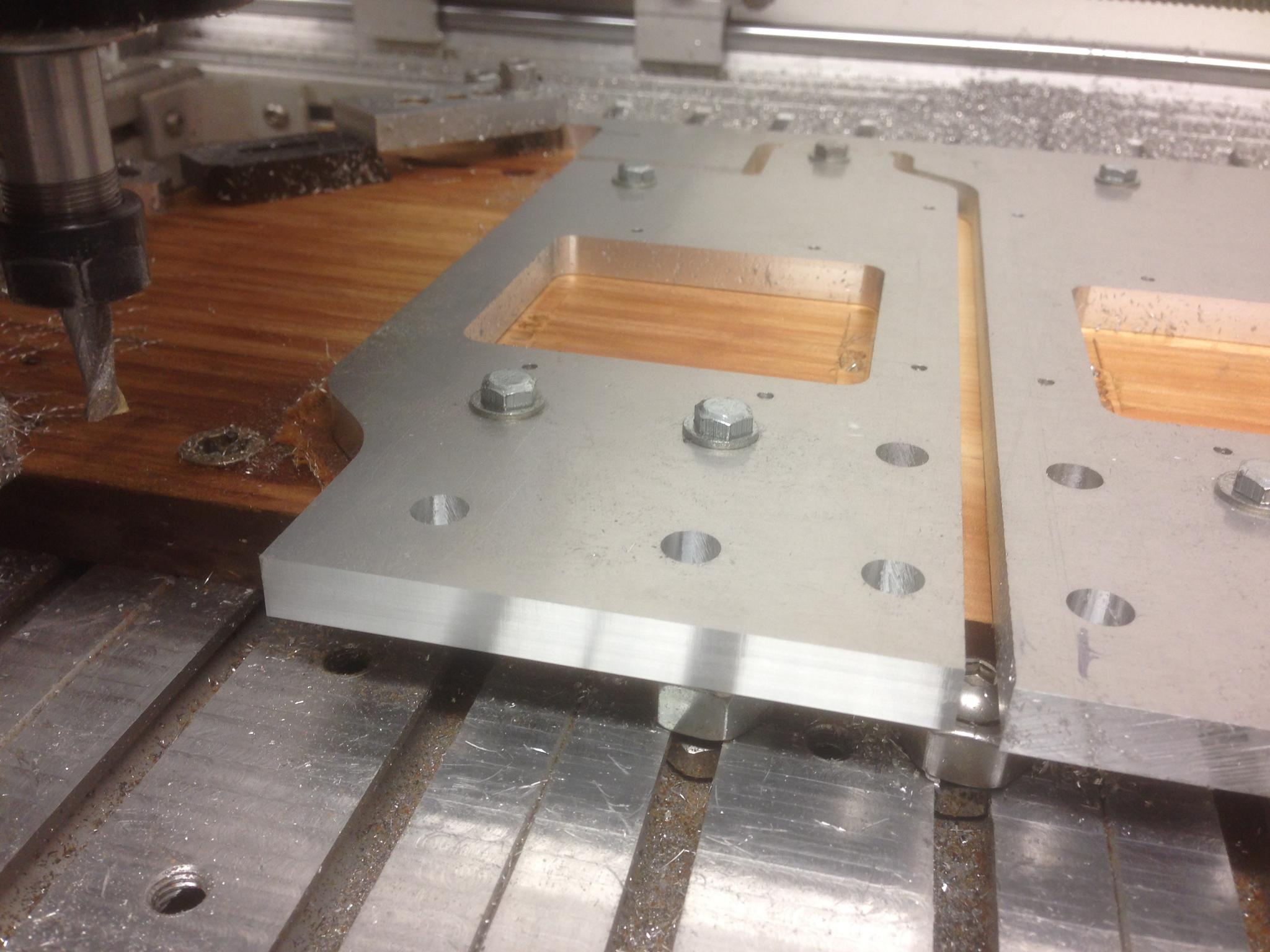

    Then bolting down, removing clamps, and onto the profile cut:
    Attachment 20190
    Same approach as above using a rough cut leaving 1mm stock, then semi-finish 3mm DOC, 0.9mm WOC, and finish full DOC, 0.1mm WOC. A stiffer/better machine might do the finish in one pass. I'm also limited to 6mm max cutter on ER11 collet. Good finish anyway:
    Attachment 20191

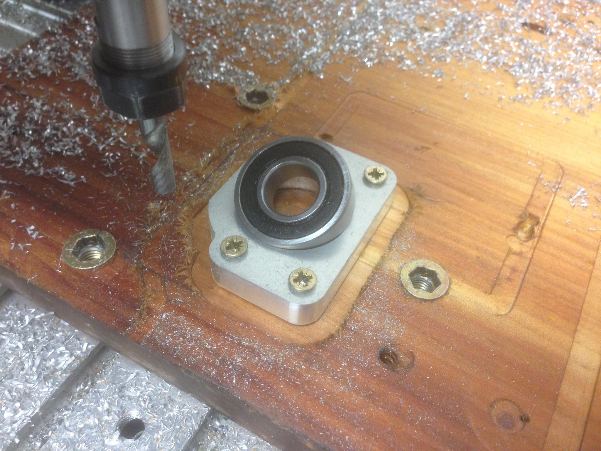

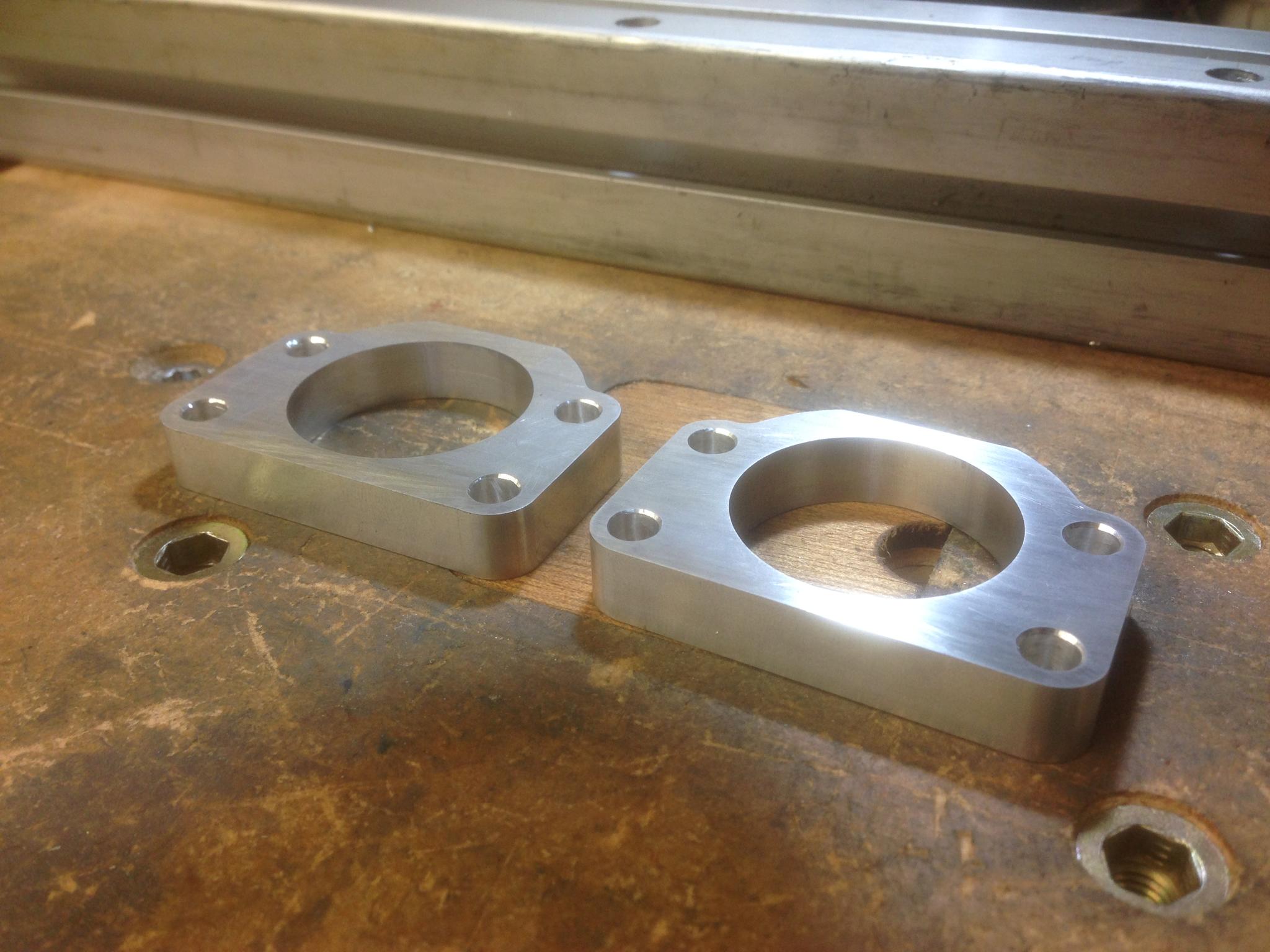

    Then onto the bearing holders:
    Attachment 20194
    Attachment 20195
    They will be a light press fit:
    Attachment 20196
    Second one made:
    Attachment 20197
    Trial fit onto the bearing plates:
    Attachment 20198
    This allows the ballscrew end bearing position to be fine tuned when setting up.

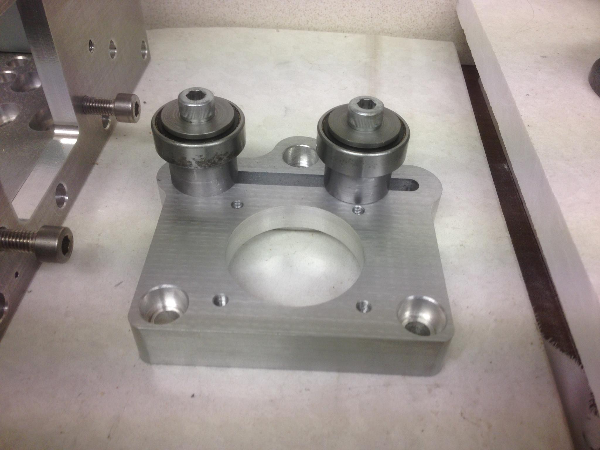

    Moving away from the X axis and onto the Y axis - the belt tensioning system progresses. Turned some standoffs to hold the adjustable belt guide bearings:
    Attachment 20199
    Attachment 20200

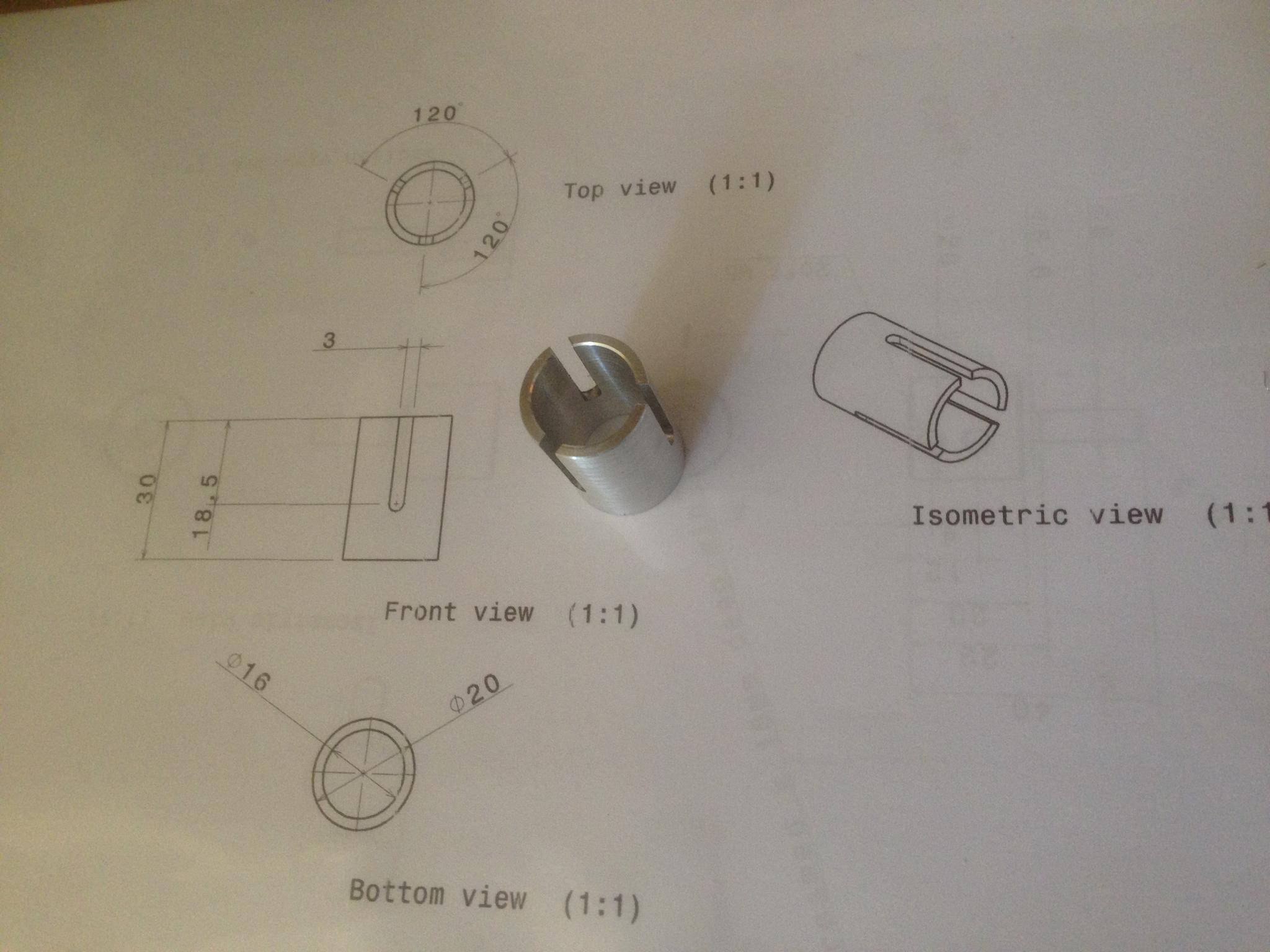

    Then machined a hex onto some round stock:
    Attachment 20202
    Then used the hex to give 120 degree spacing to machine the 3 slots. Don't have a hex collet block which would have done the job!
    Attachment 20208

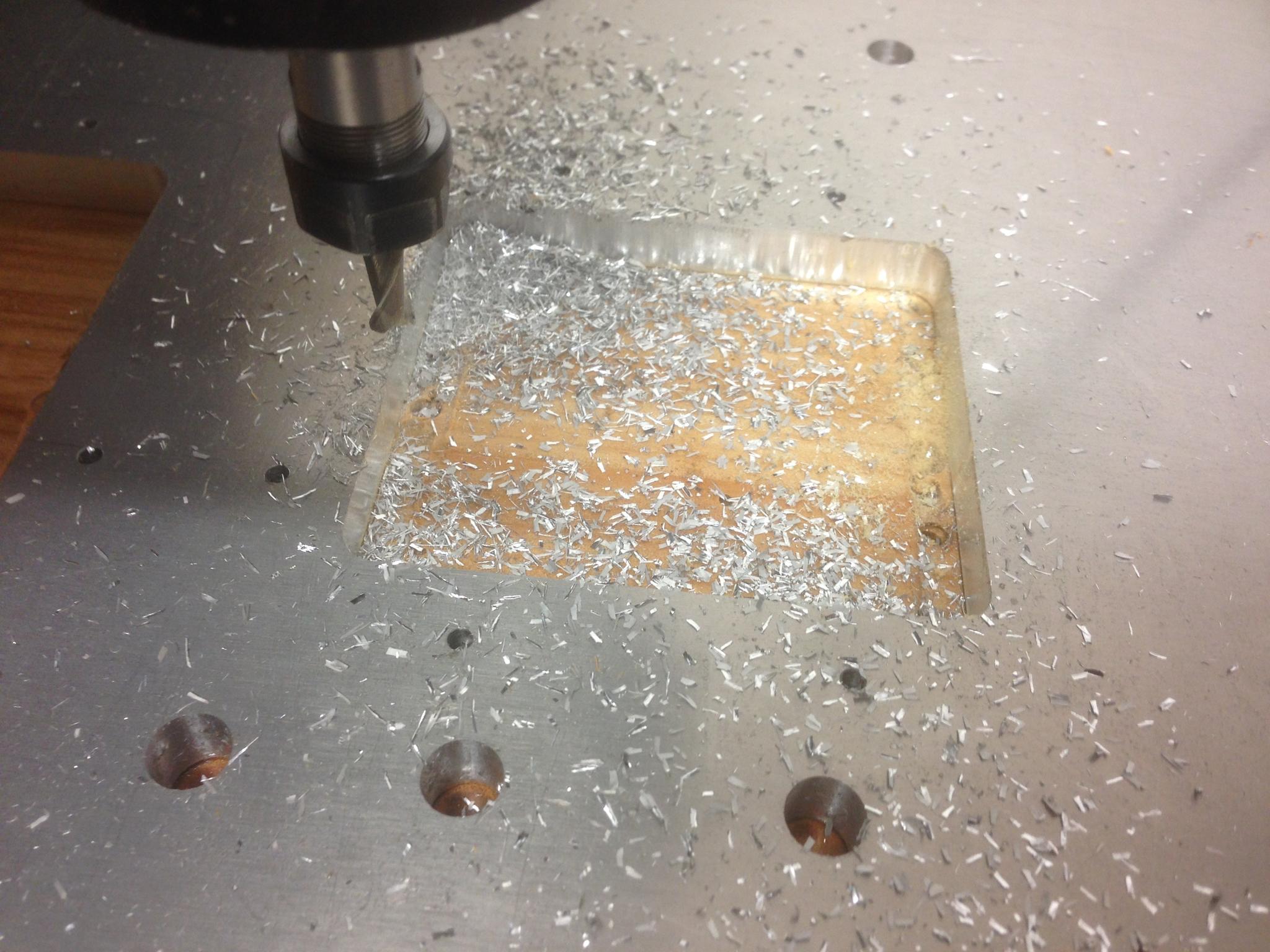

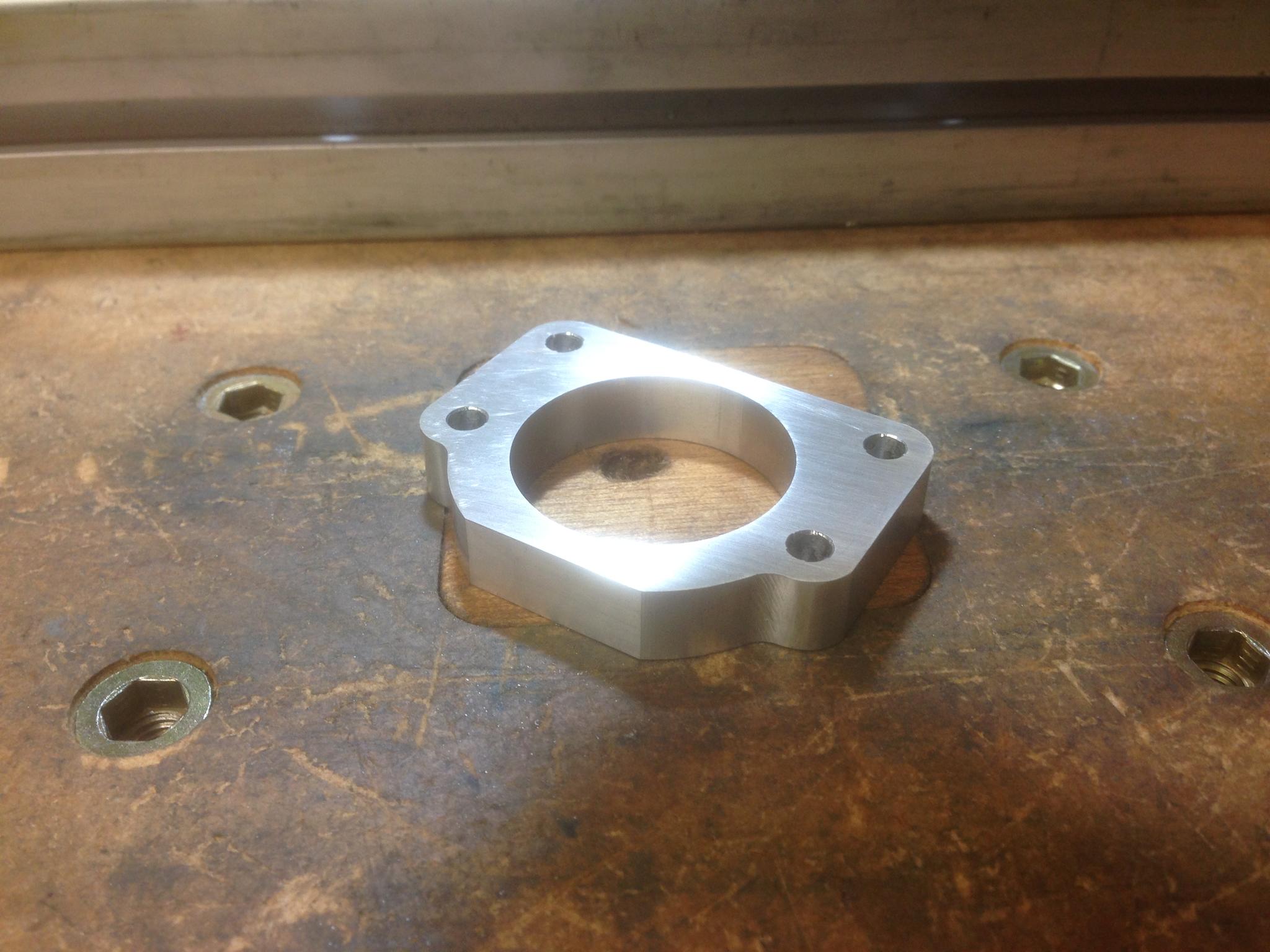

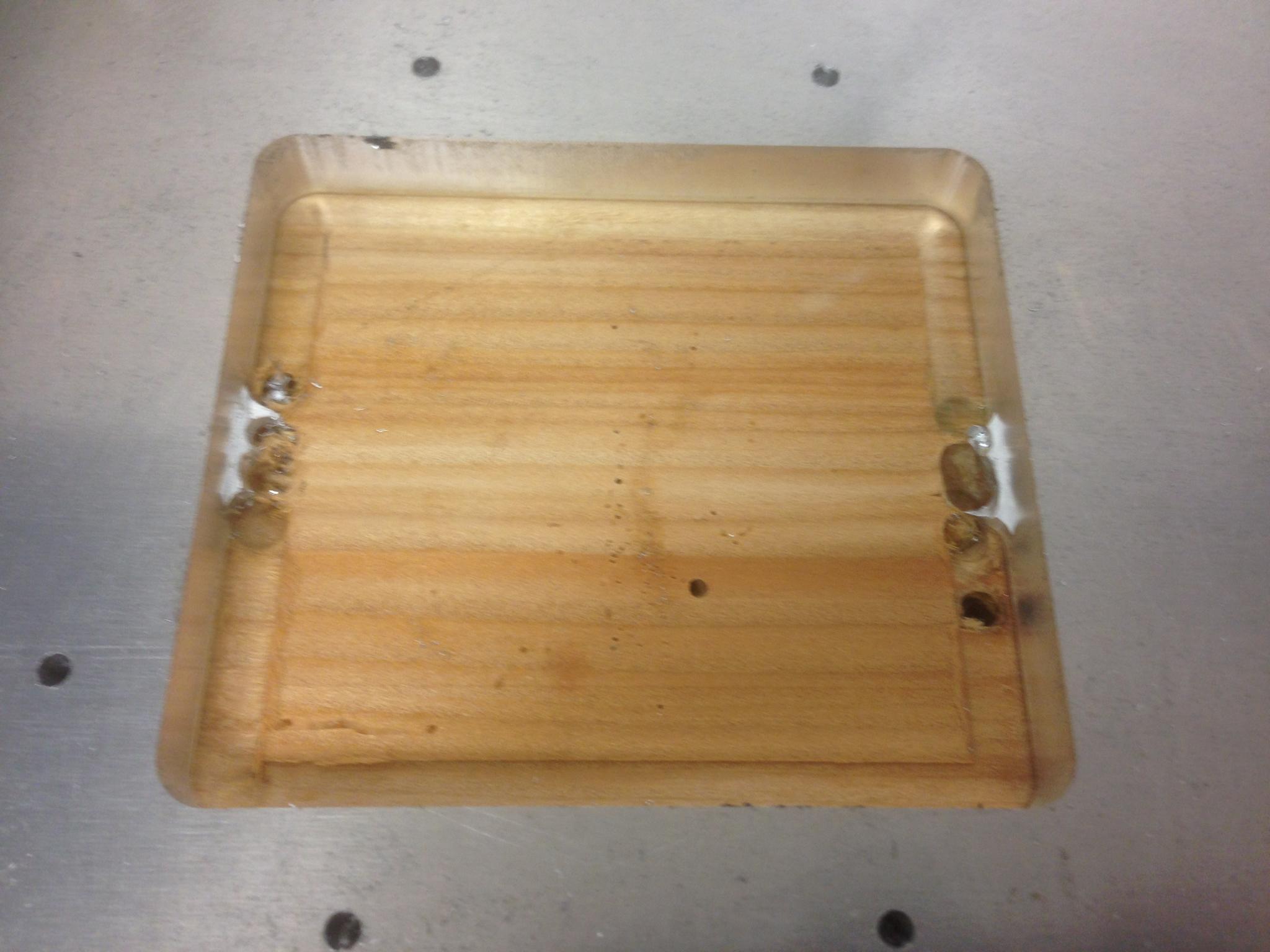

    1. When making the bearing holder I'd broken my last good 6mm carbide the day before and a new one had not arrived. So I was stuck with an old blunt one. To give it a fighting chance at the pocket I chain cnc drilled out some of the material using a 3mm drill bit:
    But the carbide bit made a nasty noise and was not happy. I switched over to a 3mm carbide and carefully cut it out. You can see the evidence of the 6mm blunt carbide on the top surface:
    I had another look through my draws and found a single flute 6mm carbide which I've used for plastic. I cut the outer profile out with that one, plus all of the second part.

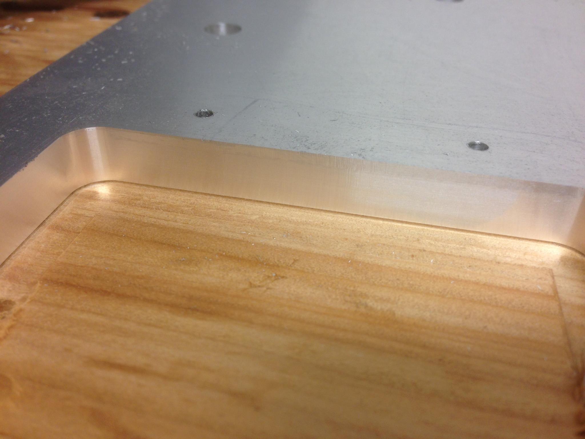

    3. The radius on some of the corners is exactly 3mm. This is bad practice with a 6mm bit as there is suddenly a large tool engagement which leaves a witness mark. Better to go with 3.1 or 3.2 if radius is cosmetic. Look at the bottom right inner radius to see the slight chatter. Not a big deal, but one to be aware of.

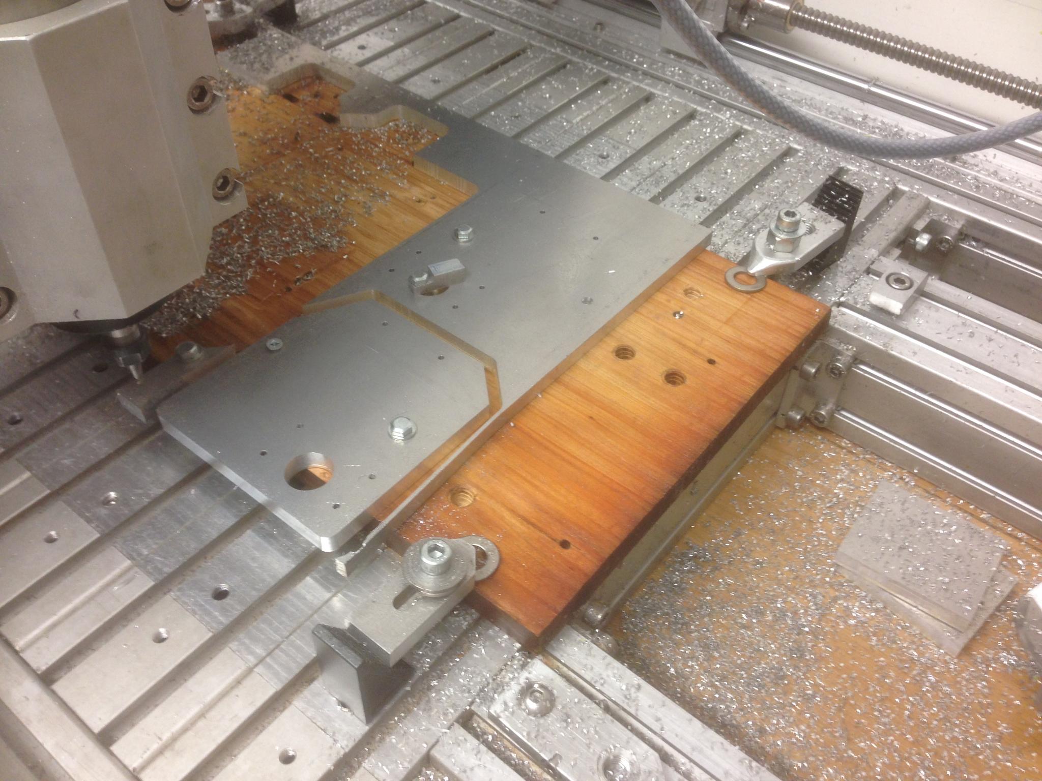

    Brief update. Next up were the plates which hold those bearing holders . . .
    Setting it out, drilling out some of the holes and pockets:
    Then bolting down through the holes so I can machine around the outside:
    Quick trial fit to make sure all is well:

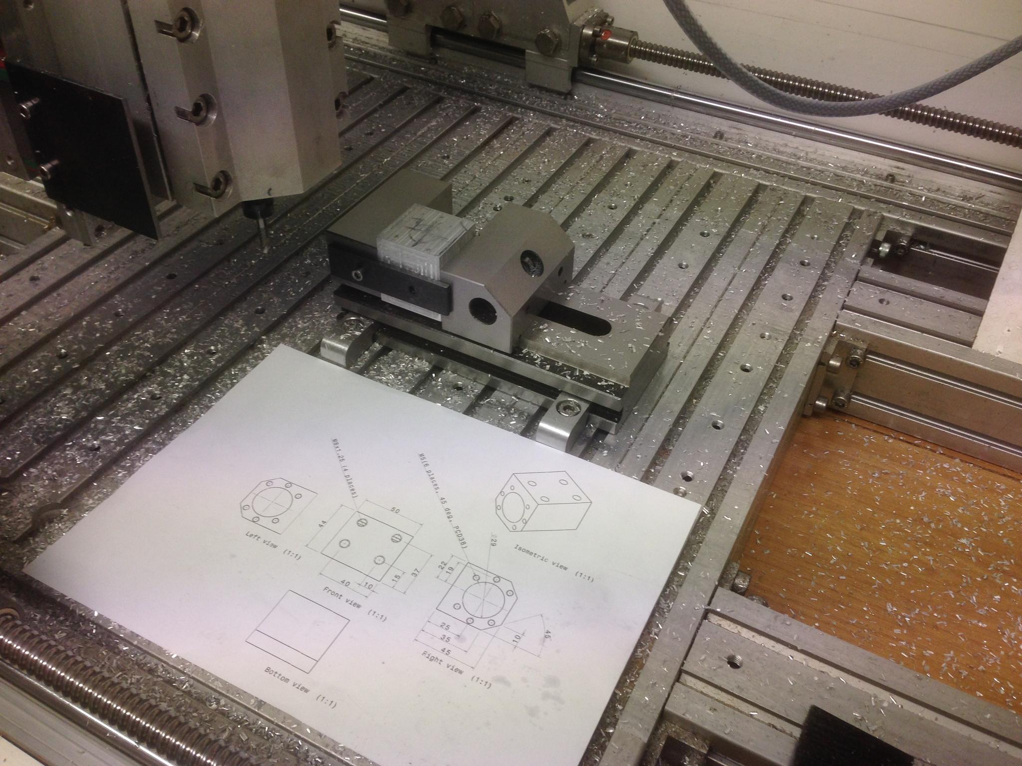

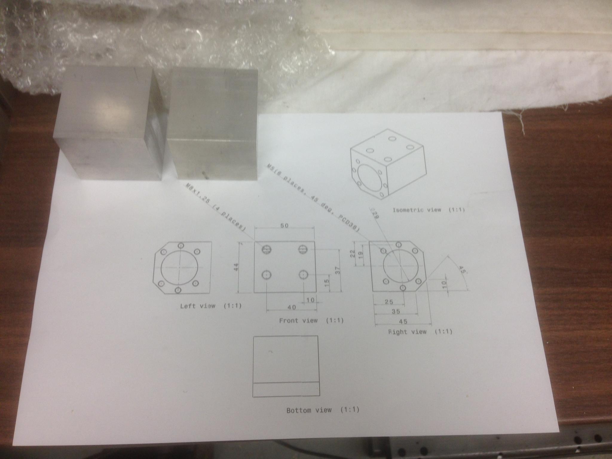

    I couldn't fit the standard ballscrew blocks in under the end of the gantry so am making my own. There will be 4 in total, 2 each side to allow me to pre-load one ballnut against the other to remove the 50 microns or so of ballscrew backlash. Here are 2 of the blocks, with 2 more on order:

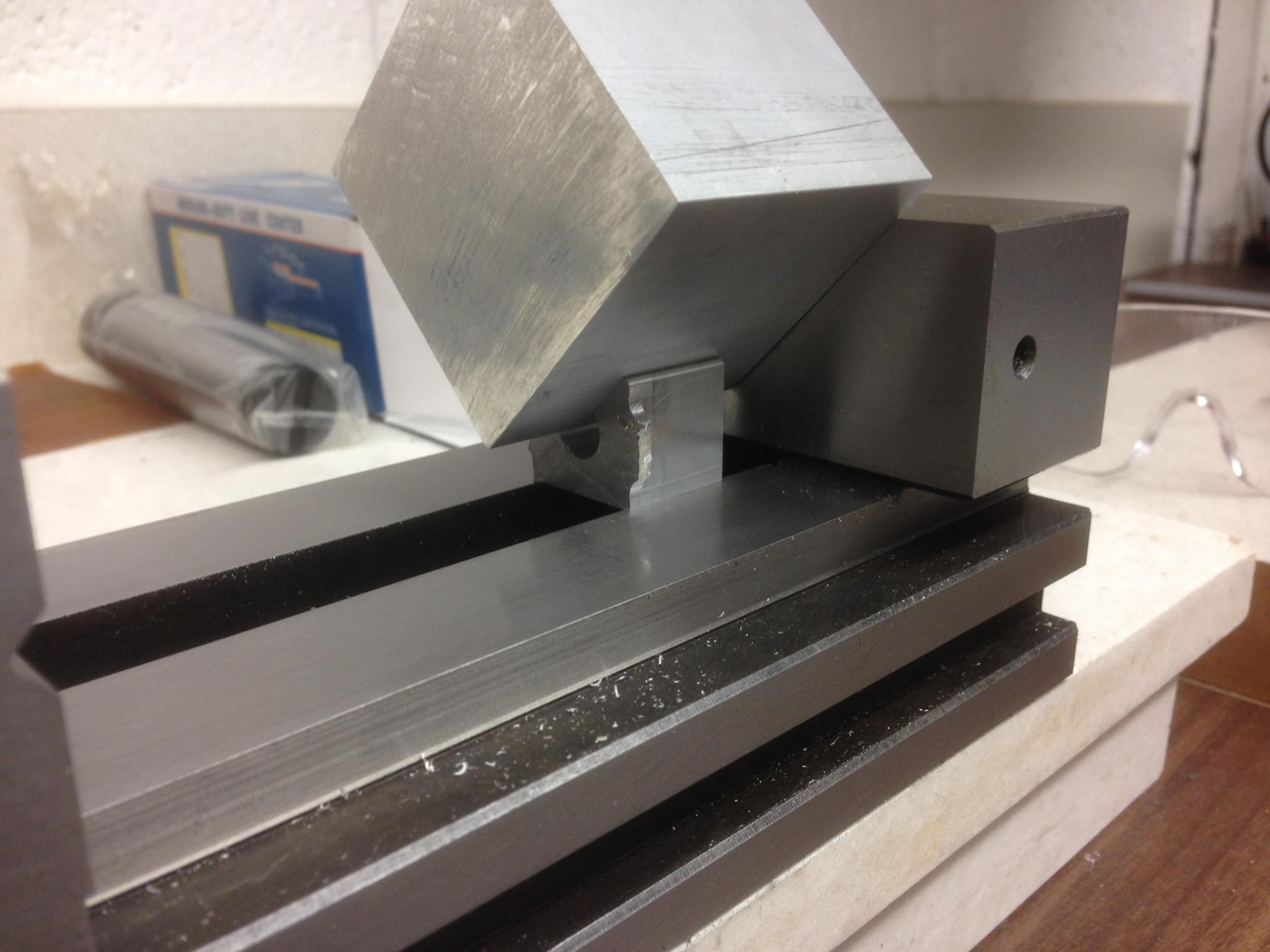

    I need to machine 45 degree chamfers on the top of the block but don't have an Engineer's vee block

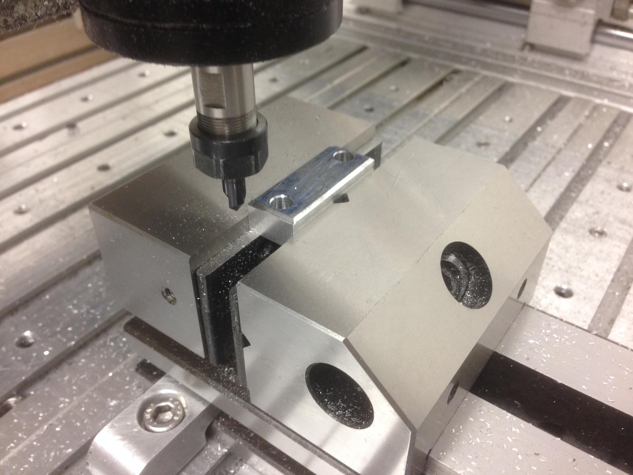

    So I machined up a jig with a 45 degree notch:
    Here it is in position to show the idea (tabs yet to be filed off):

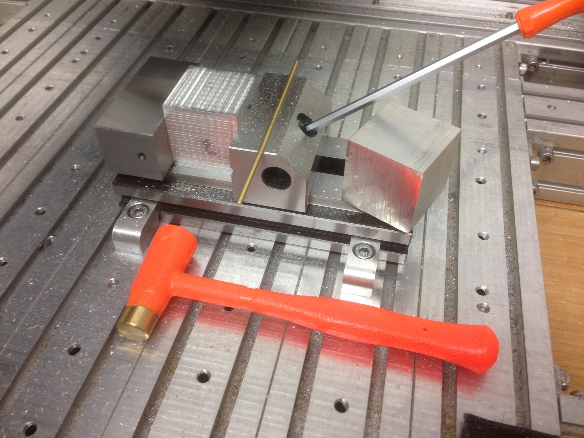

    Then the blocks had to be squared up. There are lots of videos and info on how to do this on the internet so I won't repeat in detail. Great example here:
    https://www.youtube.com/watch?v=tW8HNAlUXxU
    In the photo below you can see a raw block (right) and the squared up block in the jaws (left). The brass rod is used whenever an un-machined face is against the clamping jaw otherwise it won't sit flat against the fixed jaw. The deadblow hammer is to make sure the part is seated in the vice.
    Once squared up I set it up against a backstop (actually a parallel doubling up as a stop - must make something better !). It is now ready to have the details machined into the end such as the ballnut mounting holes. I can't machine the large clearance hole right through the centre because the part is 50 mm long. Even machining both sides its a bit too deep. So my plan is to bore a precise 20 diameter pocket in the end (say 10mm deep), then set it up on the 4-jaw, indicate on that bore to centre it, then bore it out.
