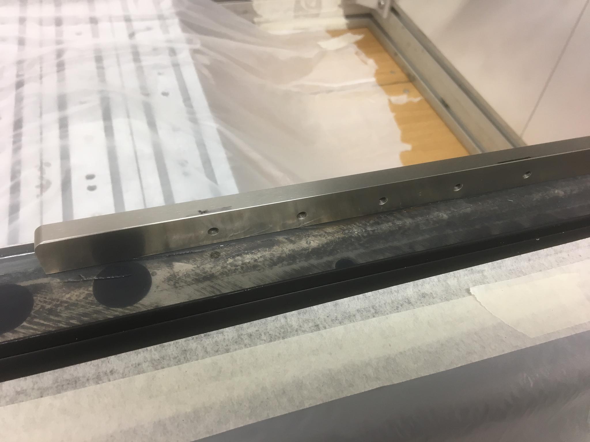

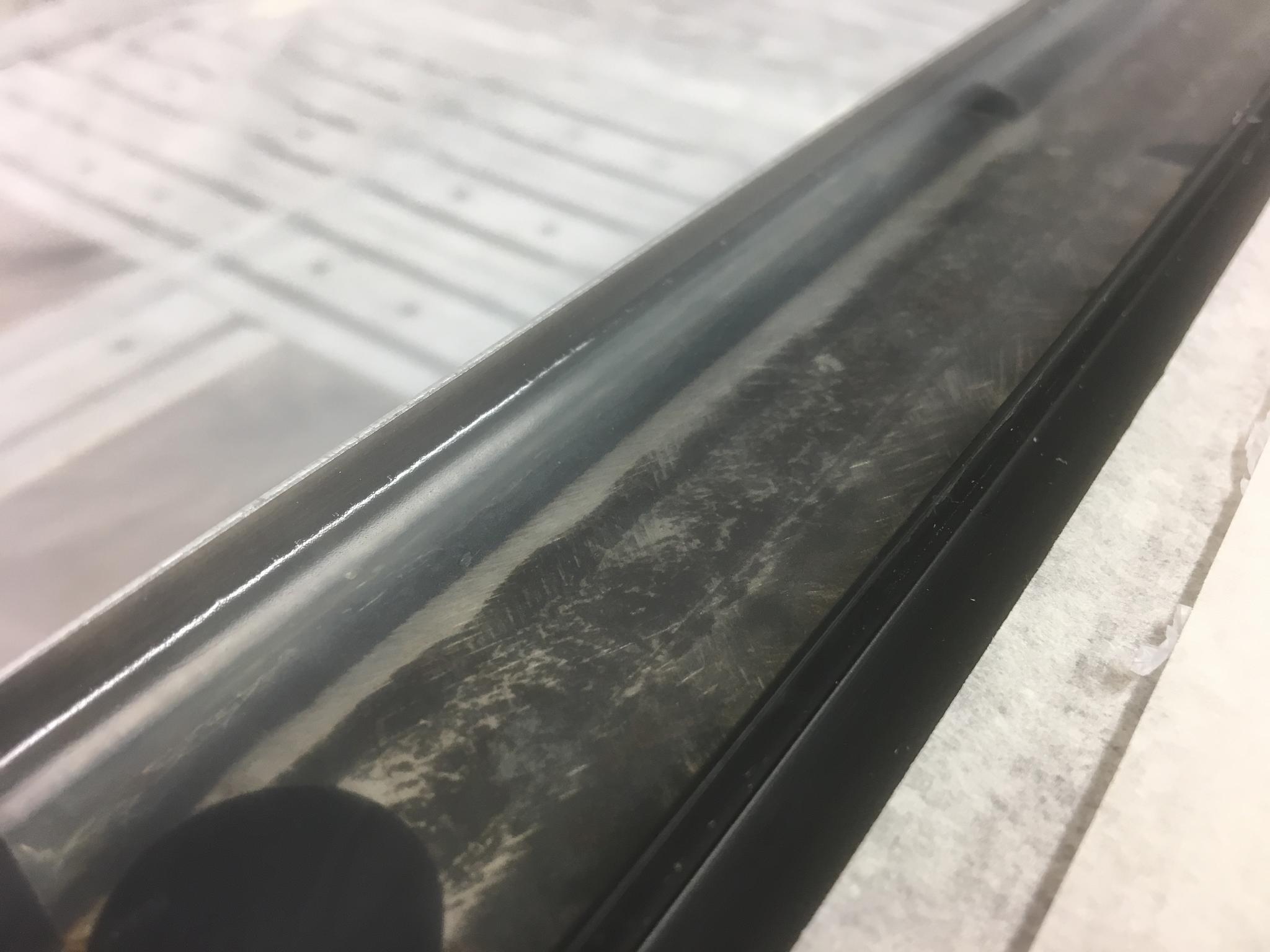

  10. #259
    Cheers Zeeflyboy !
    Looks much better this time. Couldn't resist a quick look tonight (I only poured it yesterday) and it looks so much better than before . . .
    I used a ground flat edge and there was no rocking.

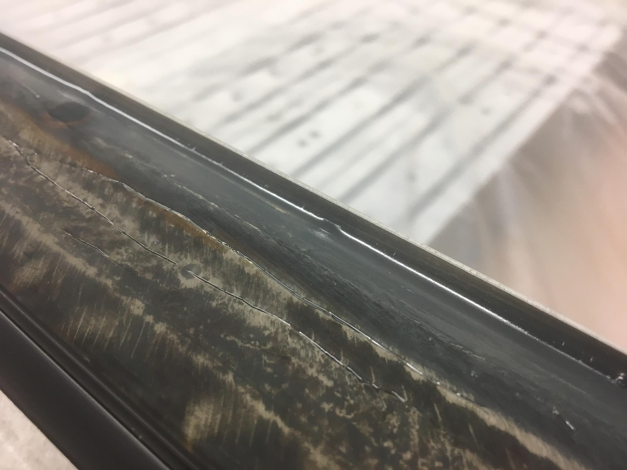

    Then I noticed something at the far end !!!

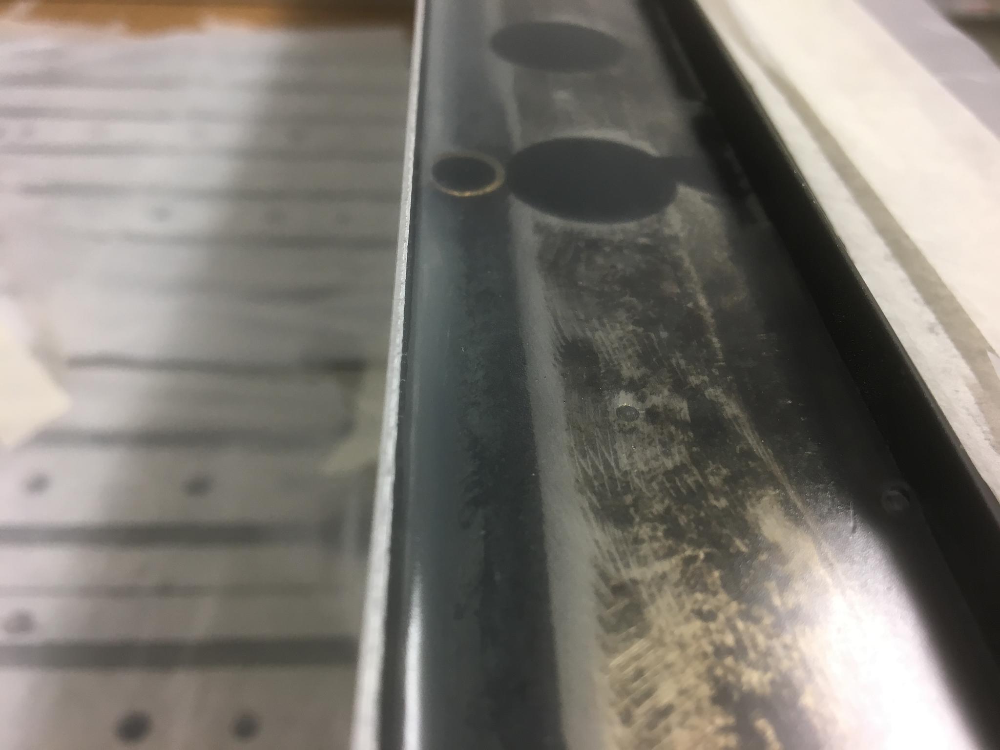

    Checked it with the flat edge and it is very slightly raised:
    This is where I popped and removed the last bubbles with the stick so it looks like it was starting to set. I'm confident I can lap this back down when dry.
    Onwards . . . !
