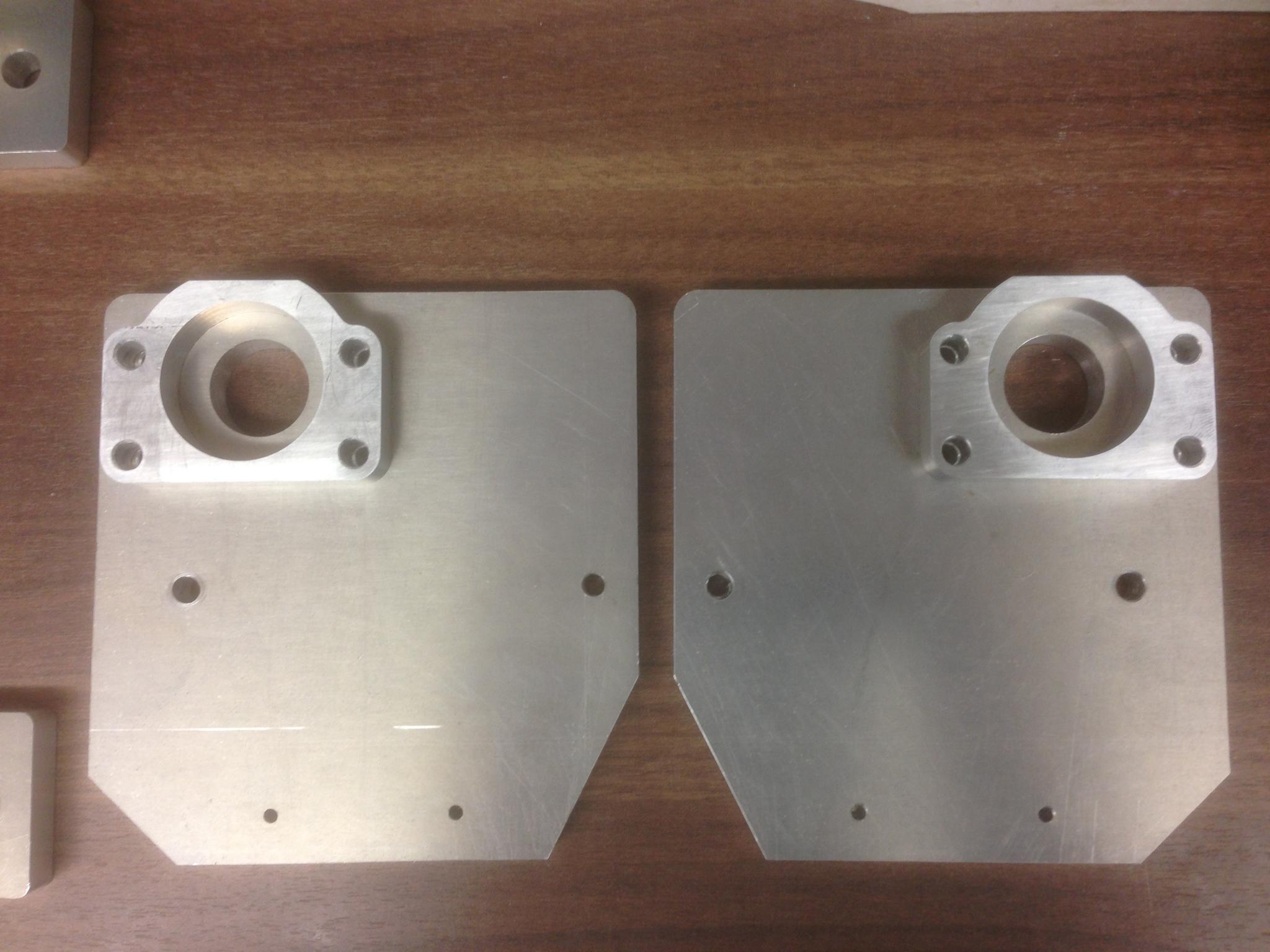

    Then onto the bearing holders:
    Attachment 20194
    Attachment 20195
    They will be a light press fit:
    Attachment 20196
    Second one made:
    Attachment 20197
    Trial fit onto the bearing plates:
    Attachment 20198
    This allows the ballscrew end bearing position to be fine tuned when setting up.

    Brief update. Next up were the plates which hold those bearing holders . . .
    Setting it out, drilling out some of the holes and pockets:
    Then bolting down through the holes so I can machine around the outside:
    Quick trial fit to make sure all is well:
    Went OK but broke a bit when I called for an 11 mm DOC instead of 1 mm in the CAM and didn't stop the machine in time.
