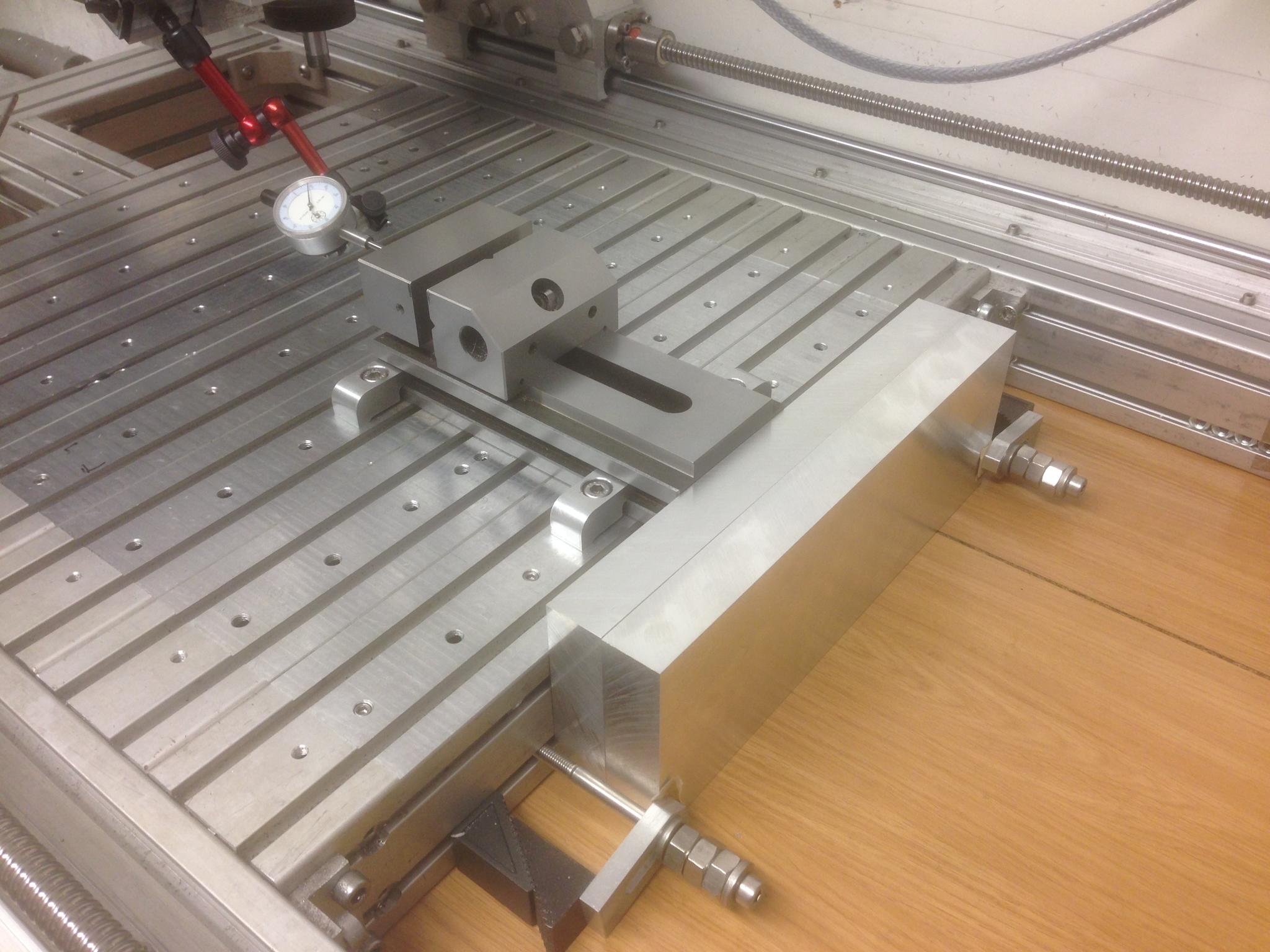

    So onto the Y axis sides. Here is the CAM:

    The second one was made the same way but snapped a cutter with the adaptive being effectively too aggressive. Actually it was my fault as I did not align the blank quite right and so the cut was too wide as the stock was not where the software thought it was. Anyway, we got there.

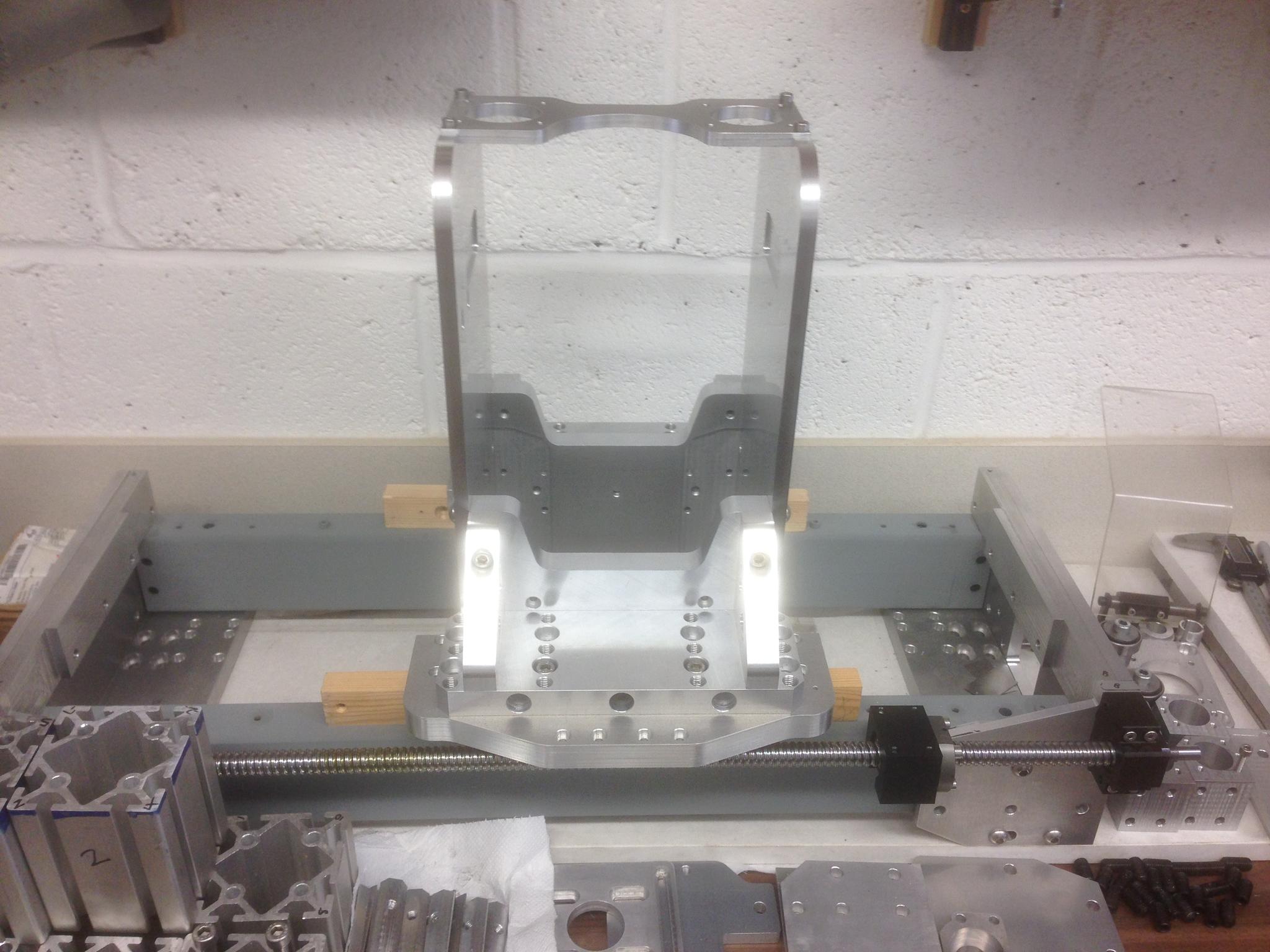

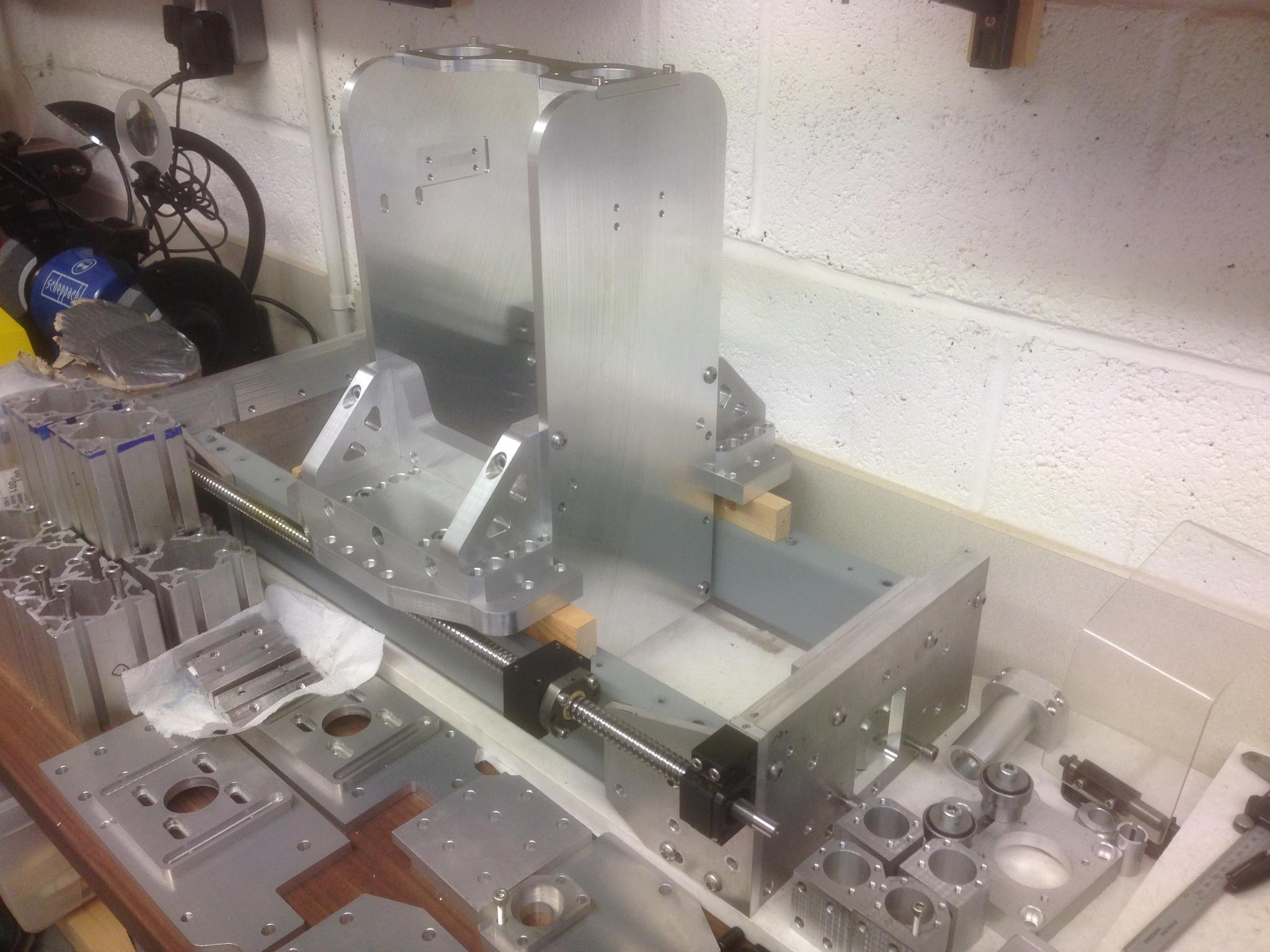

    Couldn't resist a dry assembly to check it all fits:
    There will be a piece of bent sheet over the front and rear, so checking this will fit flush to the stepper bracket:

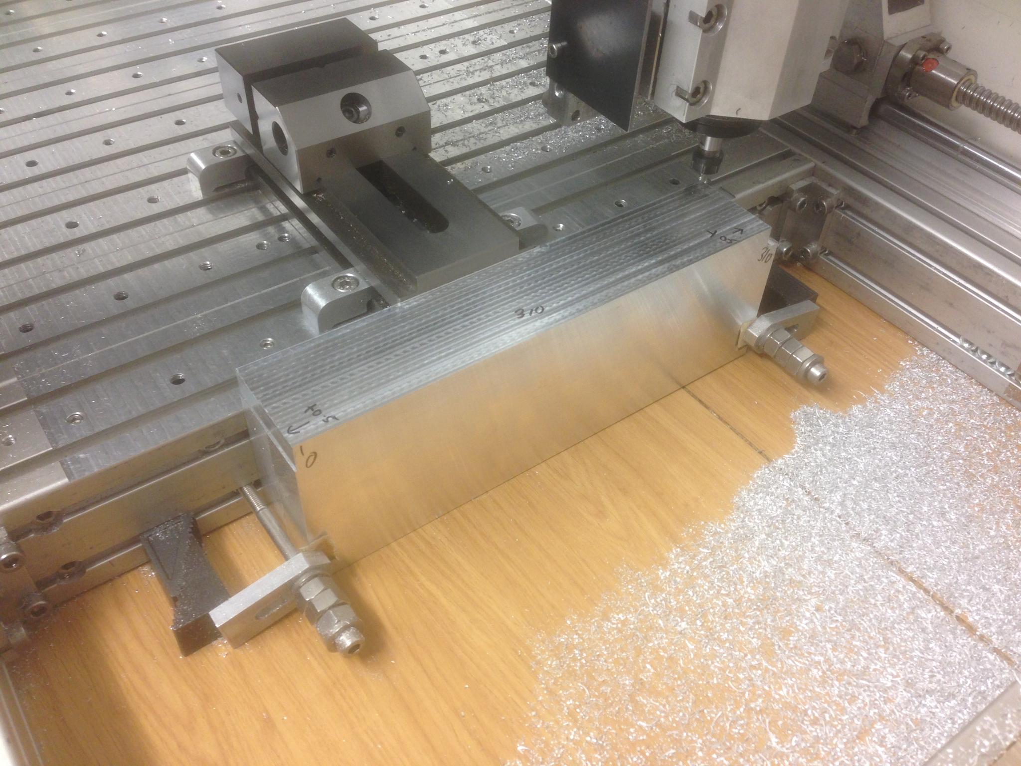

    Onto the top part of the Z axis. Main holes roughed out.

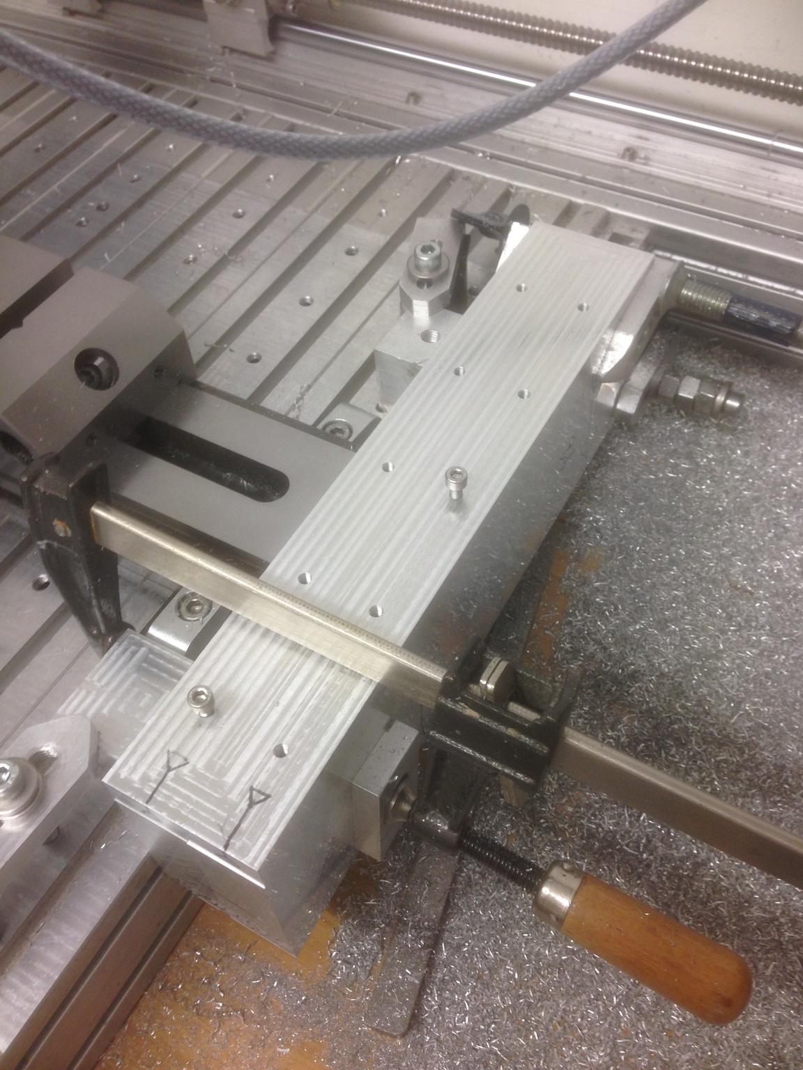

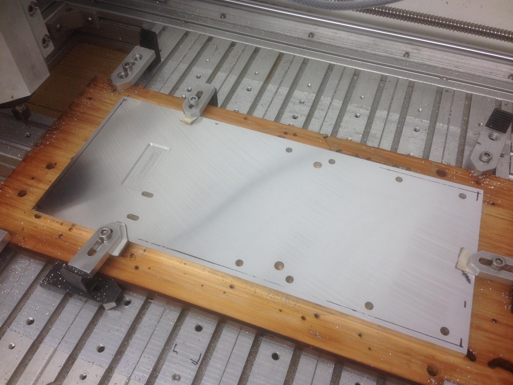

    You will notice that it is all offset to the right and the front. I made an error setting up the job and started to worry there would not be enough stock. In Vectric Cut2D the job always starts at 0,0. So you need to find the stock edge, go in say 5mm, and then zero out there. Then run the part which will give you a margin around the edge. In F360 I defined the stock in the software (which was 5mm larger than the part) and should have zeroed out on the edge of the stock. But instead I used my old method (by habit) and moved in 5mm then reset. The net effect was that the part was 10mm over to the right, and 10mm forward. Would it fit on?
    This hole was supposed to be 5.5mm from the edge - looks like I might be lucky!

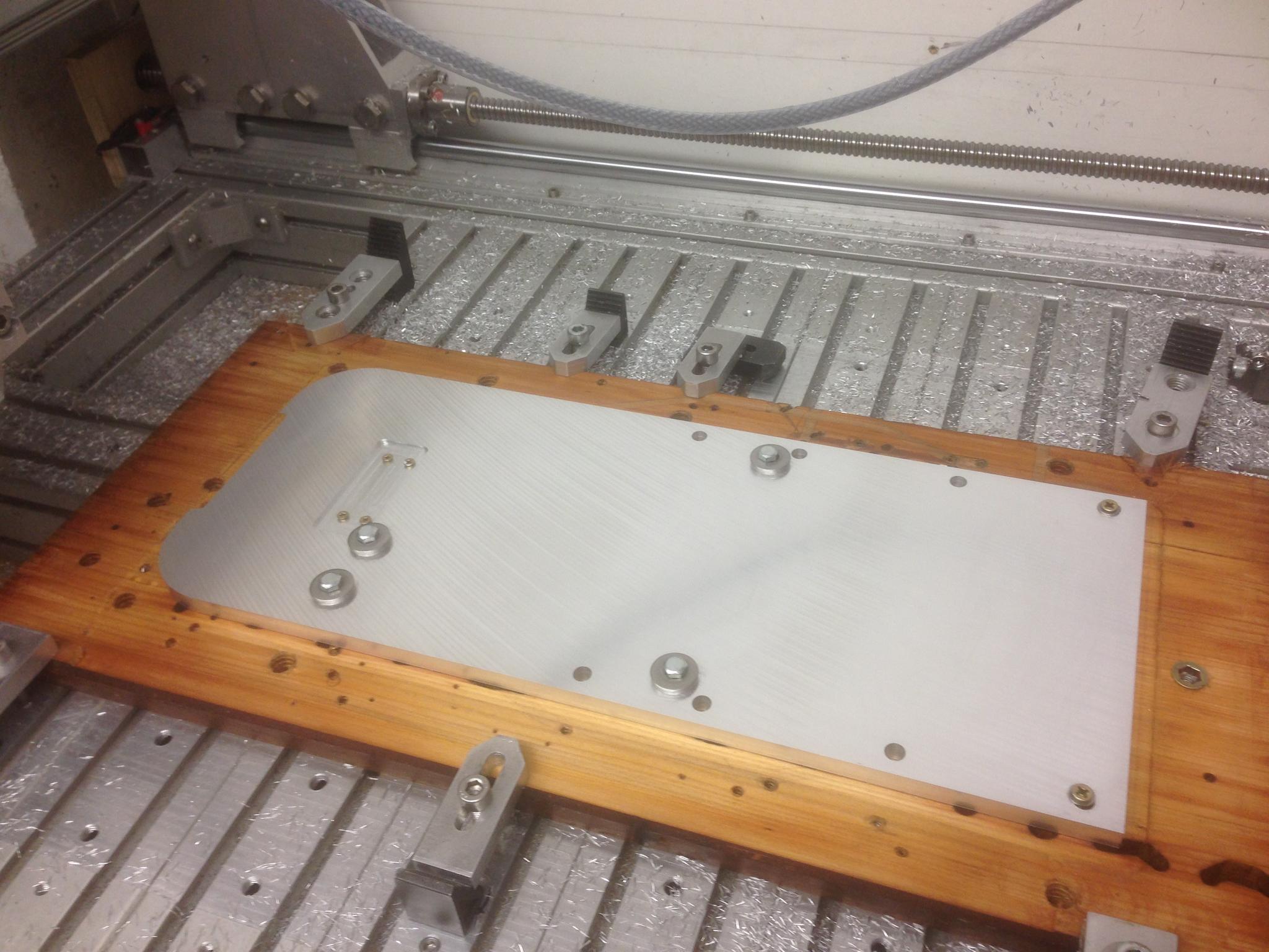

    Counterbores done and used to hold the part:
    Profile cut - ooh, just fits!

    When I was machining these holes I was removing 0.02 mm at a time (from the diameter). I noticed it was consistently taking away material from the half of the hole nearest me, and nothing off the other side. Now these are small distances, and within the 0.05 mm ballnut backlash so could be that, but I did lots of passes and spring passes one after the other and it always cut on the side nearest to me, as if it was progressing / loosing steps in Y- direction.
    Here is the part trial fitted (on top of the sides which are still raw stock):
    You can see that this also has stripes where the roughing stepped down on each pass, even though I did a full depth finishing pass. I checked for play in the Y ballnut and ballscrew mounting bearing and all was well. I pushed and pulled the spindle and all seem OK (well, as stiff as it always was anyway). I'll keep an eye on it as the final few parts need total accuracy !
    Isn't your softwood spoilboard the problem? Holding that chunk of metal with only four small woodscrews... Just a thought, I don't have experience with similar setups.
    I'm following with interest your nice work!
  9. #108
    Thanks Paulus,
    All thoughts are welcome. I did wonder if it might move the part but after it was cut out I grabbed it and tried to pull it around on the spoil board but couldn't move it at all. It was pretty solid.
    I've cut lots of parts out using this spoilboard method and not seen this result before.
    Also before I started the profile cut out I marked around the perimeter with a pen, and the part had not moved relative to this outline.
    For the bores I was also only taking 0.02 mm cuts which is very little tool pressure, just taking whispers of metal off, and yet it still seemed to be progressing in the -Y direction by a small fraction each time.
    So at the moment I'm assuming this is a new electrical or mechanical problem that has developed. I've put this poor little machine through quite a workout considering it was meant for plywood and balsa wood, so anything is possible. Maybe it has finally figured out it is making it's successor . . .
    I also thought about whether I was missing steps on change of direction, maybe somehow the step active high/low setting had changed? Next chance I get in the workshop I'll check that and I'll run some G-code moving the Y axis back and forth various distances and at various feedrates (without load), stopping back against a DTI, and see what happens. Then I'll take it from there, repeating with the spindle on (no load), then some edge cuts, etc. and see if it returns to DTI zero.

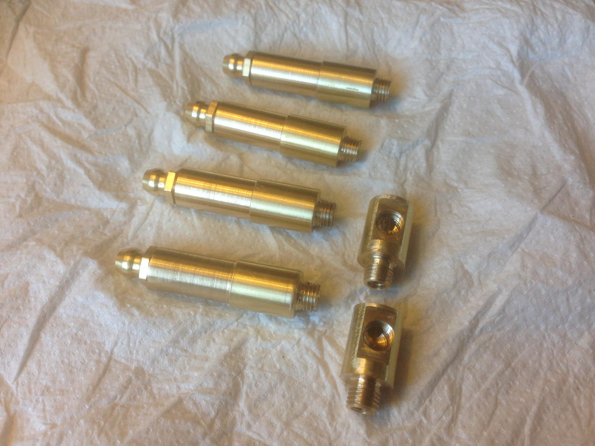

    Time for one of the side jobs. The linear carriages are buried inside the Z axis box so there is no easy access for greasing them. So I designed some remote grease nipple parts, turned from some 10 mm brass bar. Here are some of the almost finished parts (4 off assemblies required, so 2 bits to go . . .plus threads need tidying . . .):

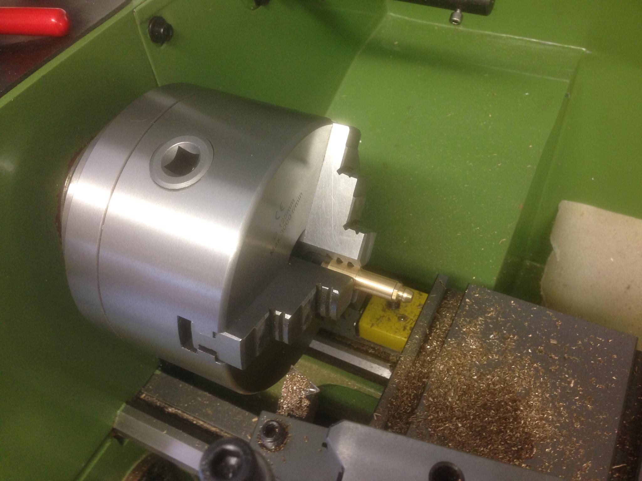

    I had some errors transfering the photos for much of the next steps (files were corrupt) so I'll have to skip a few. First part being turned:

    I'm just in the process of tidying the threads (undercuts, slight taper on first few threads, etc.) so they insert fully home. I've also got to add 2 flats on the outside near the grease nipple so that can be installed/removed with an M8 spanner.
    The 4 upper carriages will have this system, but the lower 4 will have the bolts in until they need to be greased then an access panel will be removed from the underside of the Z axis (which keeps out the swarf as it is near the spindle), then the bolt removed and a long straight nipple extension screwed into each carriage in turn. So I only need to make one adapter for the bottom ones and keep it somewhere safe. That's the plan anyway.
    That was my first thought when I saw your post. I found the same problem on my current machine on the Z axis - didn't show up on simple profiling jobs but when I did some heavy-duty 3D carving, it rapidly showed up. It's probably only a single microstep per reversal so a bit of gcode that moves, say, 50 times in each direction and comes back to a dial gauge will show it up. The clue in my case was that the error was pretty consistently number of reverses times distance moved per microstep. At least it's a quick one to check and eliminate!
