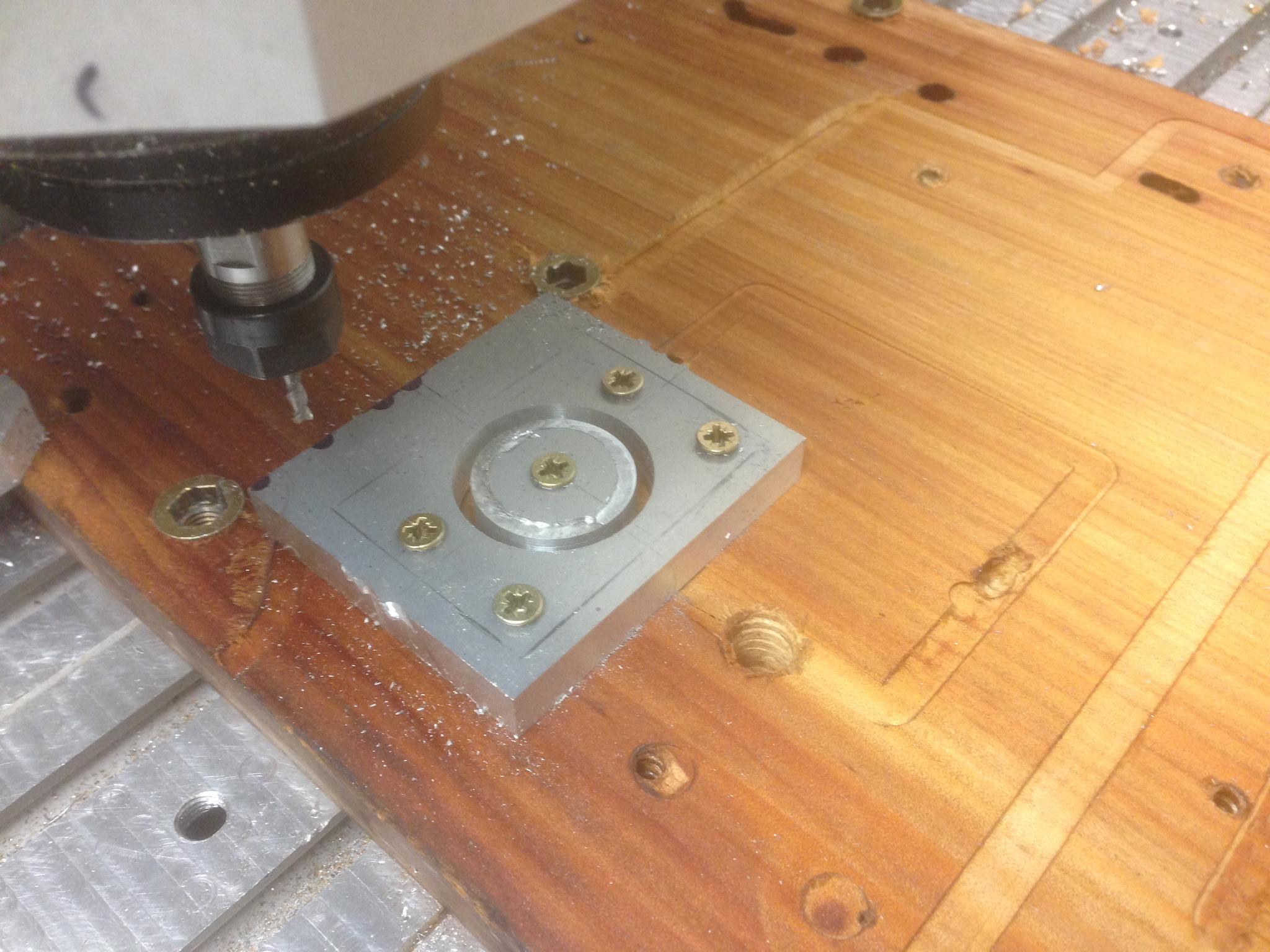

    Bought a new 6mm 2 flute 45deg helix (for aluminium) carbide from 'cncpoorboy' on ebay (for about £9) recently and just tried it out.
    http://www.ebay.co.uk/itm/2014350347...%3AMEBIDX%3AIT
    Very impressed with the finish:

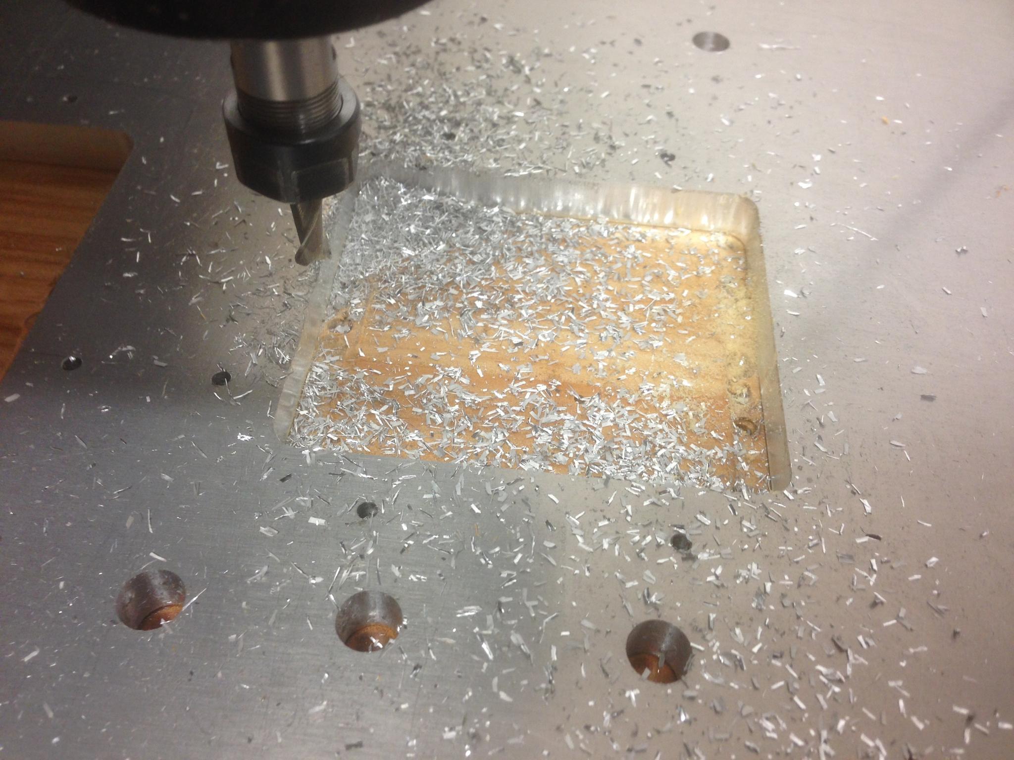

    Also started making one of the bits on the gantry. I snapped a cutter on final the 20mm pass ! Always the worst bit right at the bottom of a deep slot when the chips can't get out. It welded up and I didn't stop it in time.
    Luckily I had a spare so finished the cut. Setting up for the holes in the edges.

    4) Clean up profile pass to remove the last 1mm. I do this in 2 stages as this is what works for my machine. 1st cleanup 3mm DOC, 0.9mm WOC, final cut full DOC, 0.1mm WOC.
    Gives this surface finish:

    Then bolting down, removing clamps, and onto the profile cut:
    Same approach as above using a rough cut leaving 1mm stock, then semi-finish 3mm DOC, 0.9mm WOC, and finish full DOC, 0.1mm WOC. A stiffer/better machine might do the finish in one pass. I'm also limited to 6mm max cutter on ER11 collet. Good finish anyway:
