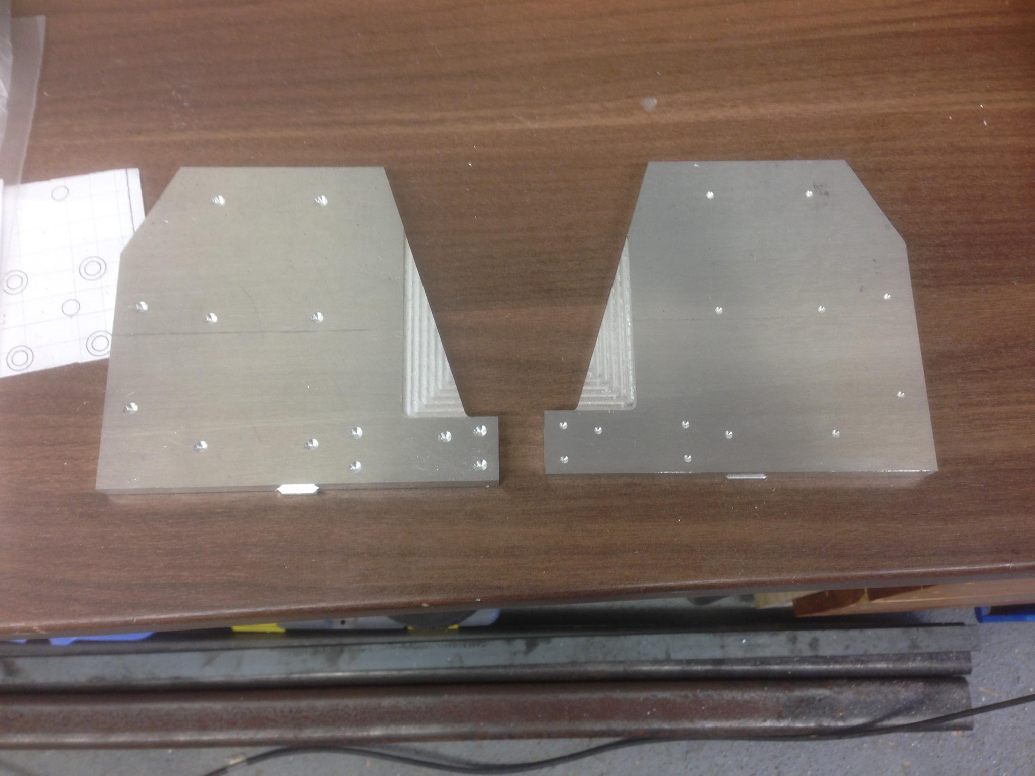

    It's been a while since I last posted and I'll explain why in a moment. I've made a matching pair to the last part, with a bit of finishing off to do:

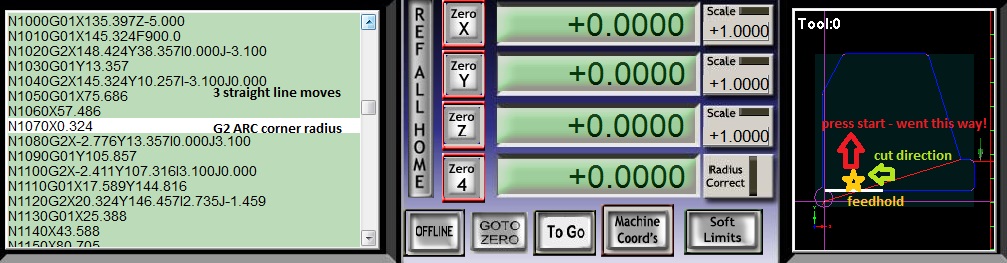

  6. #25
    Whilst cutting another new part I used 'feedhold' to stop the machine just to check something was not going to collide. Then I hit 'start' but instead of continuing on a +X direction to the end of the cut the machine moved in +Y. It was about 8mm into a profile cut so snapped the cutter.
    Luckily this was in the scrap part of the material so no harm done. I changed the bit, homed, ran it all again. Later on in the same profile cut (in the -X direction this time) it was almost to the bottom when I pressed 'feedhold' again to check one of the clamps was not going to get machined through. When I hit 'start' is again went in the +Y direction. Luckily I had my hand over the e-stop but it still took a chunk out of the part!
    I've never had this happen before and haven't changed anything in software, just the Z axis bearing change. Any ideas?

  9. #28
    OK, looking at the gcode where I had the 2 crashes (when 'starting' after a 'feedhold') and I can see there are several straight line moves (must be geometry nodes all along in a straight line from when I was creating and changing the CAD), followed by a G2 radius arc in both cases.
    #1
    I've read about problems with feedhold in arcs so always feedhold on a straight edge. But I was definitely on the straight bit about half way along the top edge when I pressed feedhold. About line 930. It was some way off getting to the G2 ARC at the corner. When I hit start the machine went up in +Y and snapped the tool clean off.
    I've loaded the file onto my house PC (hence the DROs are all zero!) Here is the first one:

    #2
    This time, on the same part, I was cutting along a straight edge at the bottom, -X direction, when I hit feedhold. It had just done line 1060. This time cycle start moved the machine in +Y. I hit e-stop straight away this time and recovered it. However, there was a gouge in the work piece (!). It's cosmetic but annoying none-the-less.
    Looking at the gcode shows another set of linear moves, followed by a G2 arc radius at the corner:
    I'll go back to the CAD and see if there are repeat nodes in the geometry as a start, but I'm confused by this as I've used feedhold for years and not had this problem. Now twice on the same part!
    I went to Mach3 website in case there was a later version - but it's still R3.0.43.066 I which is what I am running now.
    EDIT:
    OK, the reason for the repeat straight moves is that there are tabs on those sides. Vectric obviously adds those moves in on every pass, but only adds the Z up and over move when the required depth is met. However, I was nowhere near the depth to create the tabs (they are only 2mm high) so that might be a coincidence. So, still confused about what is going on . . .
