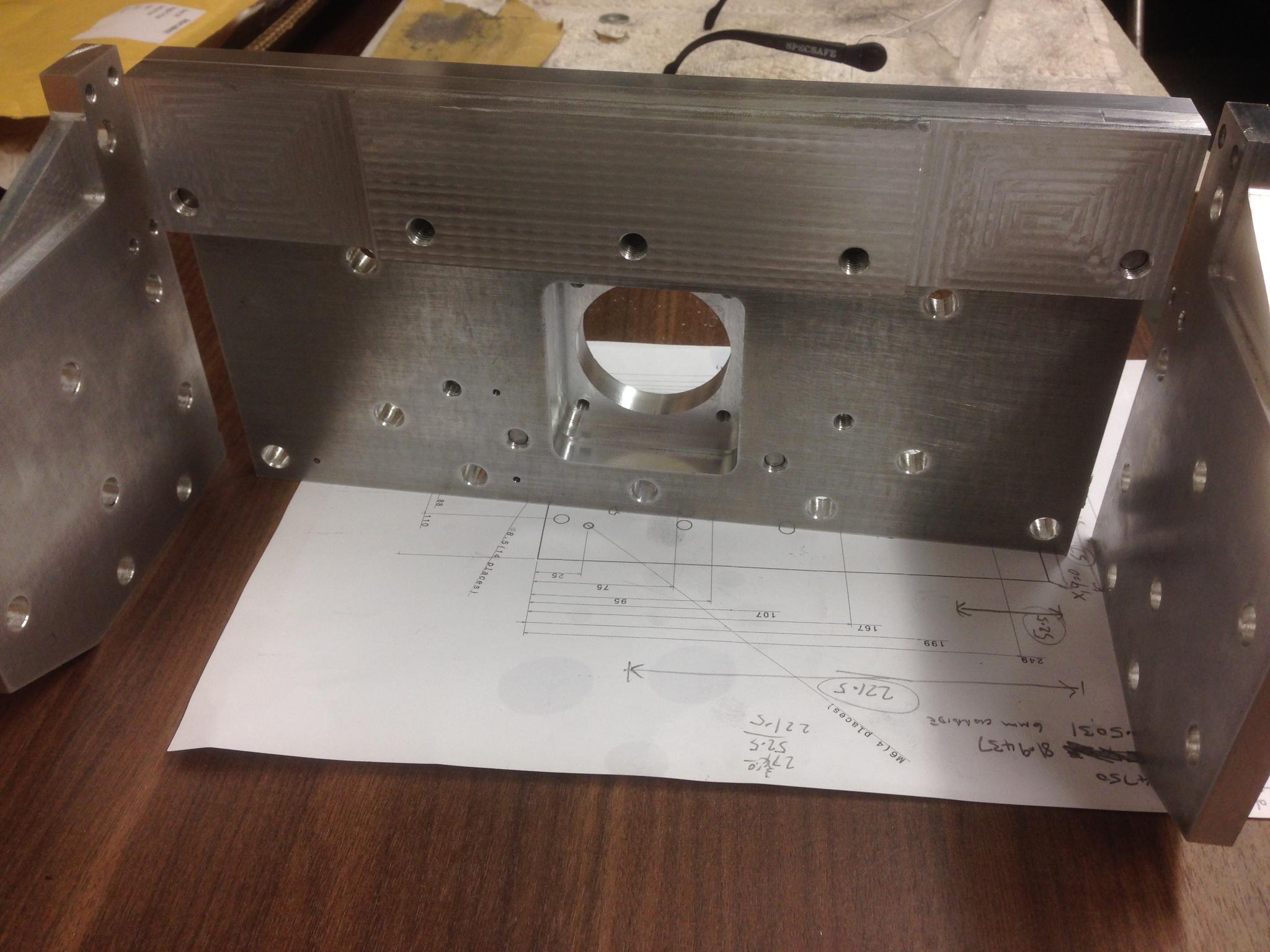

    Bit more progress. One of the gantry end plates was cut out over the weekend:

    Tonight I drilled and tapped all the various holes. Couldn't resist a trial fit of a couple of the previous parts:
    OUTER VIEW
    (Note the tabs on each end still need facing off. I'll wait for the other one to be machined then do them in the same session.)
    INNER VIEW
    With the side plates offered up:
    Another reminder of what the end sections should look like . ..
    I used the tapping chuck again which made light work of the threads. Also discovered I was holding the tap wrong. I had been putting the tap right into the chuck and it gripped on the round shank - liable to slip. Looking at the 3 jaws of the chuck I noticed that it has ridges in the centre of each jaw. If you put the square part of the tap into the chuck these grip the 4 sides nicely, with 2 jaws on the flats and 1 jaw (with the ridge) on one of the chamfers of the square. Hard to describe but just put the square shank of the tap into the 3 jaw chuck and it will not rotate.

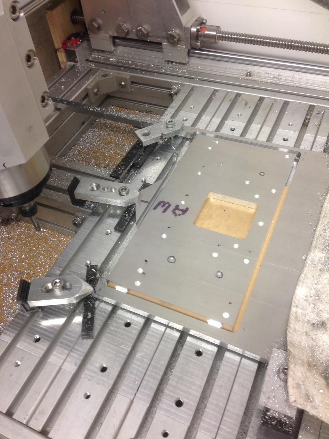

    An update on the next bits on the list - the gantry lower bearing plates. I need to make 2 mirrored parts, here is the first one progressing -
    Setting up and cutting some slots. These are to adjust one of a pair of ballnut brackets. I'm going to run 2 ballnuts pre-loaded against each other:
    The other holes have been spotted (to finish on the drill press) and the profile cut out. I tried something a little different to try and get the profile size as good as possible. As this sits on the X bearings I want this to be a datum part during the build. The rough profile cut was +1.0mm, then another rough cut at 0.2mm, and finally a finish cut at 0mm. You can see the finish in the photo which is excellent. I'll check with calipers how accurate the overall size came out.

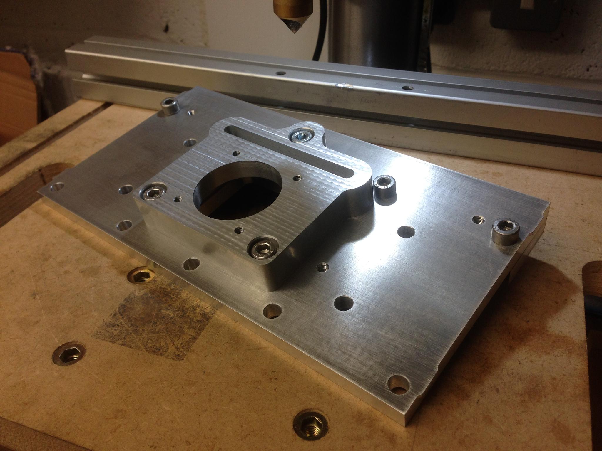

    I've yet to drill out the holes on the top, and there are lots of holes required in the sides, but I thought I'd try a quick fit to make sure all was well. No bolts yet just propped together but looks good!

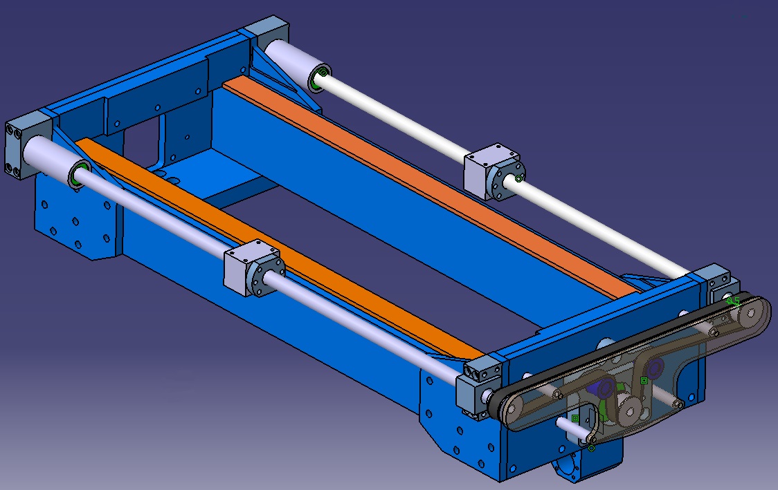

    Also, I'd made a few design changes a while back but hadn't posted them so here they are.
    1. Z axis
    -Twin ballscrew instead of single
    -Main body machined from solid
    -Upgrade from 15mm miniature rails to 20mm Hiwin
    2. Y axis
    -Double ballnuts, one fixed ballnut housing and one floating housing to allow pre-load to be added
    -Simpler bracing pieces
