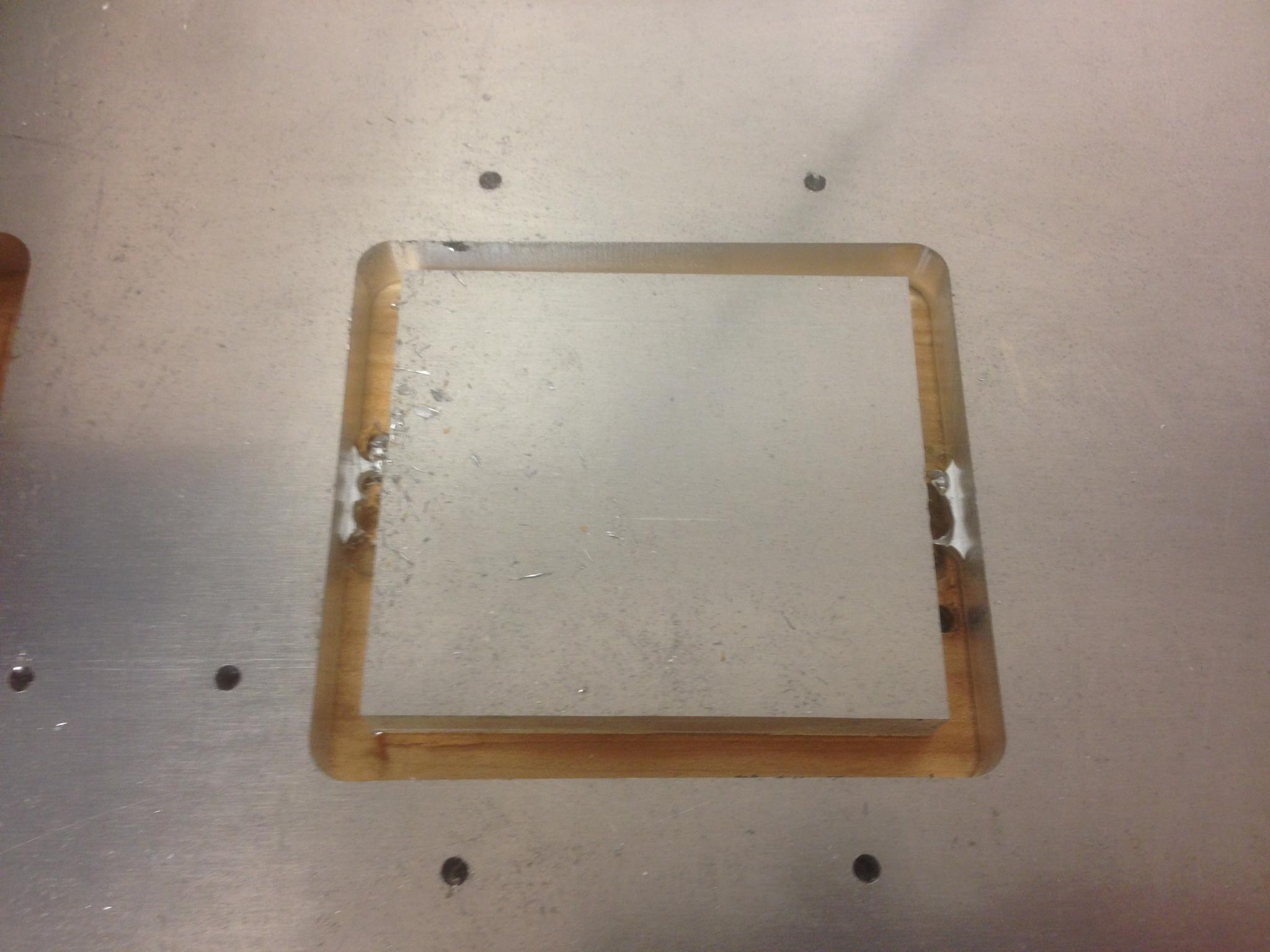

    I'm making a mirrored pair here. A few holes, and a large pocket in the middle of each one. You can drill and screw through the waste first, but and I'll talk you through my approach on the large cutout as it worked quite well as an alternative. This is all to avoid those terrible tool witness marks from tabs.
    1) Use an inside profile with a 1mm offset (remaining stock on the side wall) WITH TABS.

    2) Then drill through the tabs with a cordless drill to remove the waste:
    3) Manually jog the machine to remove most of the tabs (not critical to get all of it)
    4) Clean up profile pass to remove the last 1mm. I do this in 2 stages as this is what works for my machine. 1st cleanup 3mm DOC, 0.9mm WOC, final cut full DOC, 0.1mm WOC.
    Gives this surface finish:

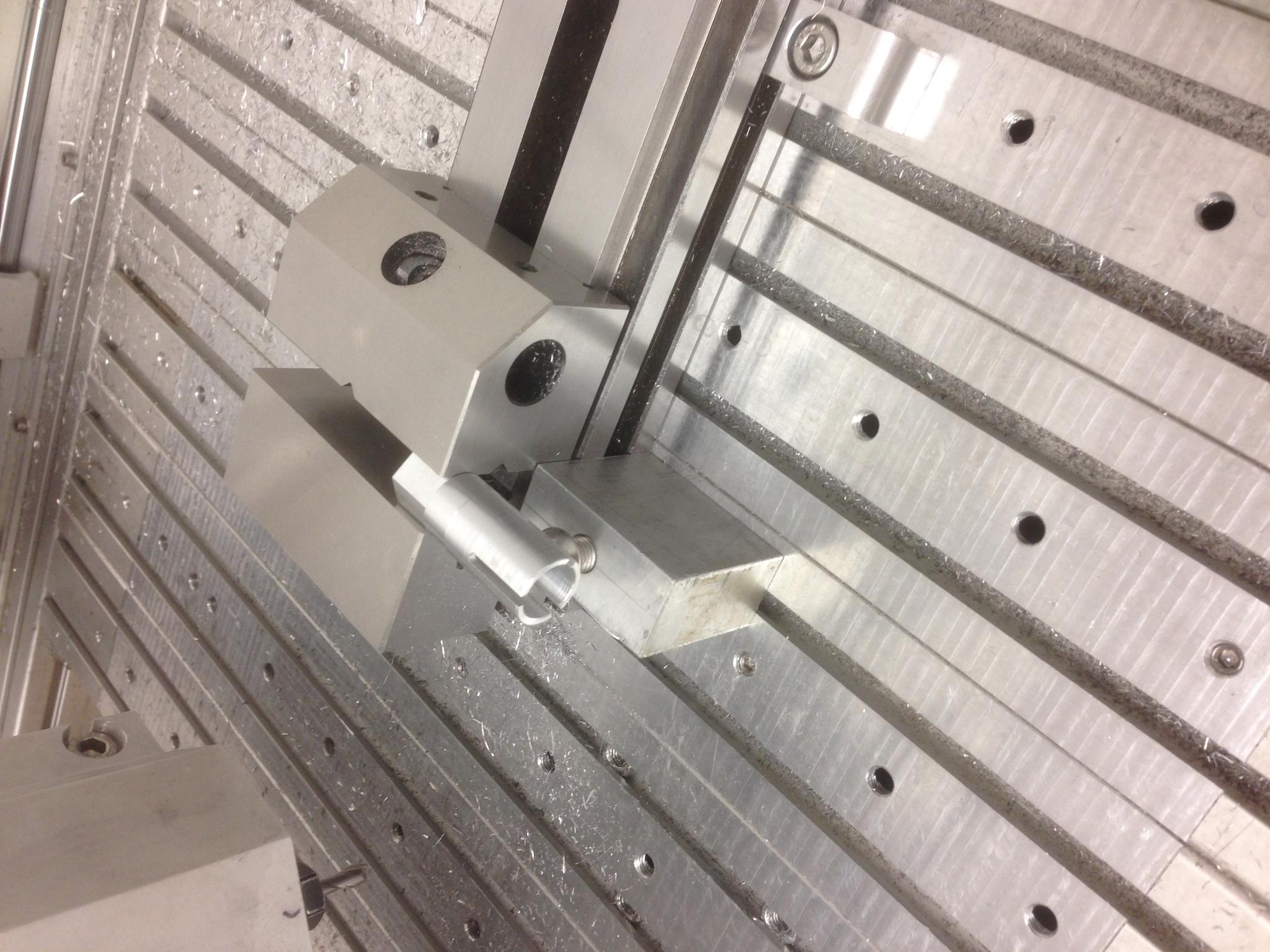

    Looking ahead I need to turn down the end of one of the ballscrews. Made these 2 bits to hold it in the lathe. First is a protective collar to stop the jaws damaging the ballscrew:
    Made it by boring a hole into some round stock on the lathe.
    Then machined a hex onto some round stock:
    Then used the hex to give 120 degree spacing to machine the 3 slots. Don't have a hex collet block which would have done the job!
    Then back to the lathe to part it off:
