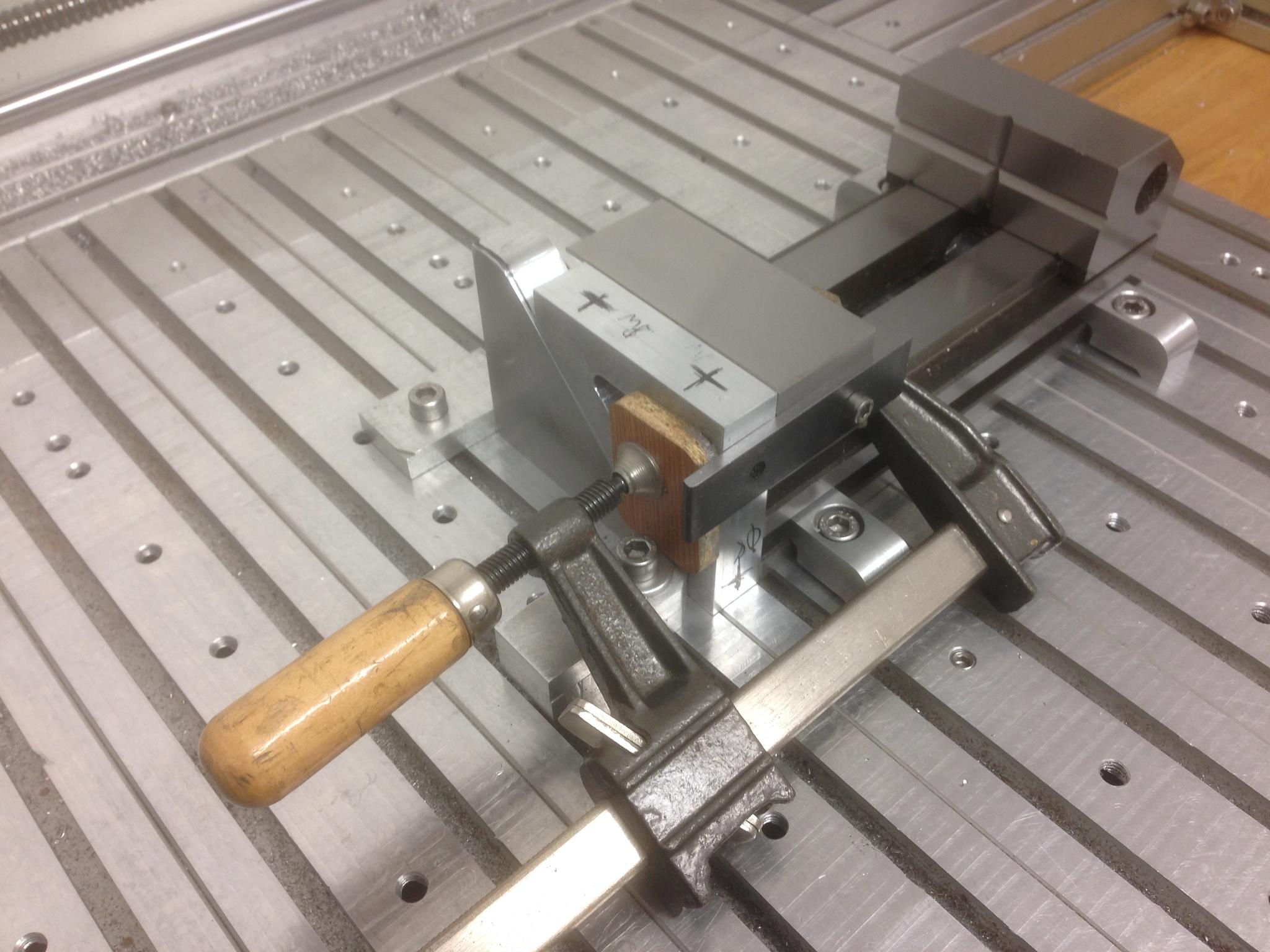

    Then onto the side ops. I need to machine several side features starting with 2off 6.8 pilot holes (to later take an M8 thread). Bit nervous as I'm trialling fusion 360 for the first time as it can do these pilot holes as spiral bores. Done a few aircuts and all seems OK from a cutting point of view (apart from that G28 as mentioned in another post).
    Here is the fixture:
    Luckily I had planned ahead (!?) and the first triangular brace I made with the poor surface finish could be used as a support. It will be sacrificial as one of the ops will cut into it.
    The vertical angle is held by the precision vice, with a backstop at one end. The part just drops in and is then clamped. I was just about to hit cycle start and I was called away ! So it will have to wait . . . .
