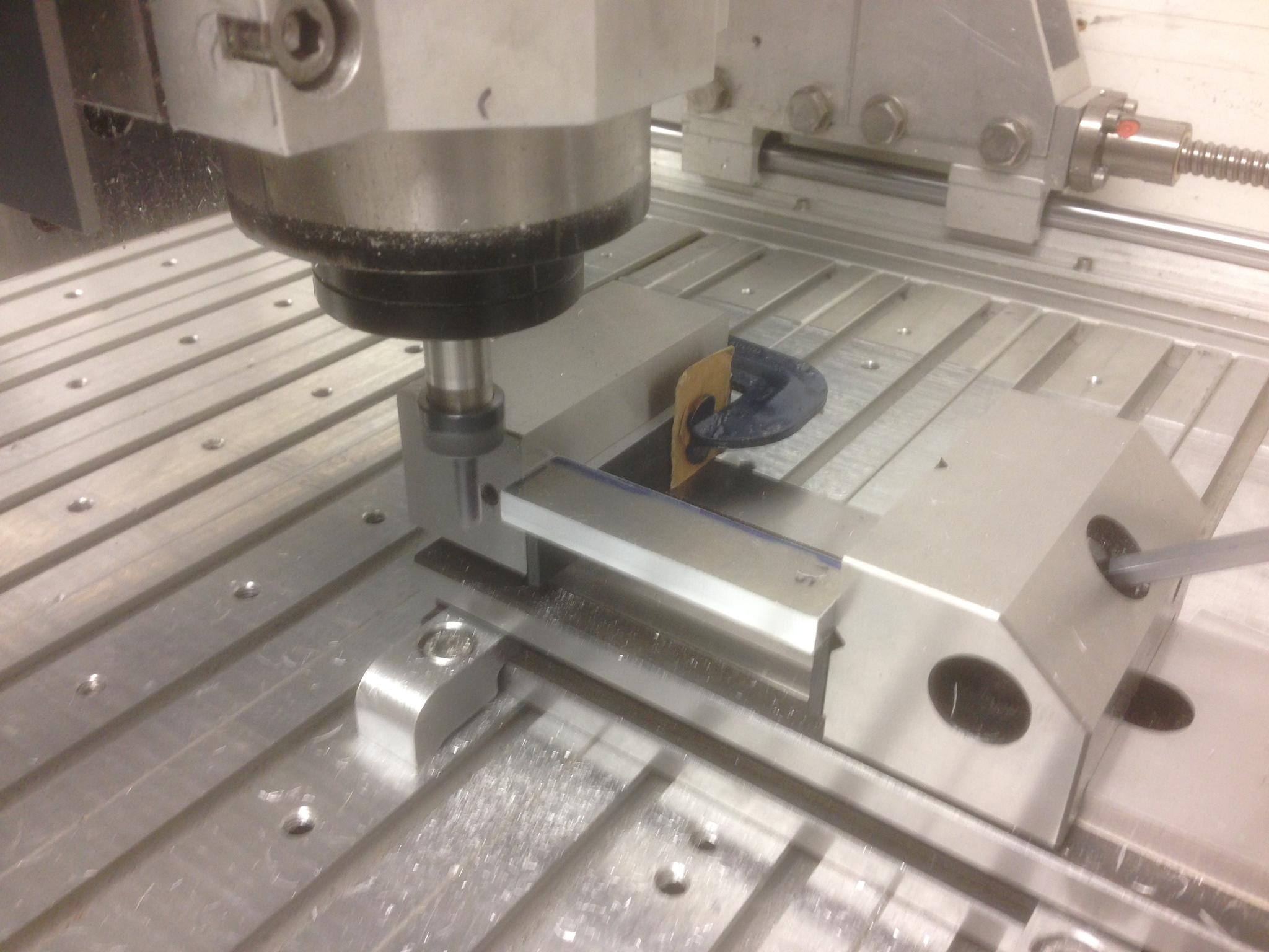

Here is the fixture:
Luckily I had planned ahead (!?) and the first triangular brace I made with the poor surface finish could be used as a support. It will be sacrificial as one of the ops will cut into it.
The vertical angle is held by the precision vice, with a backstop at one end. The part just drops in and is then clamped. I was just about to hit cycle start and I was called away ! So it will have to wait . . . .

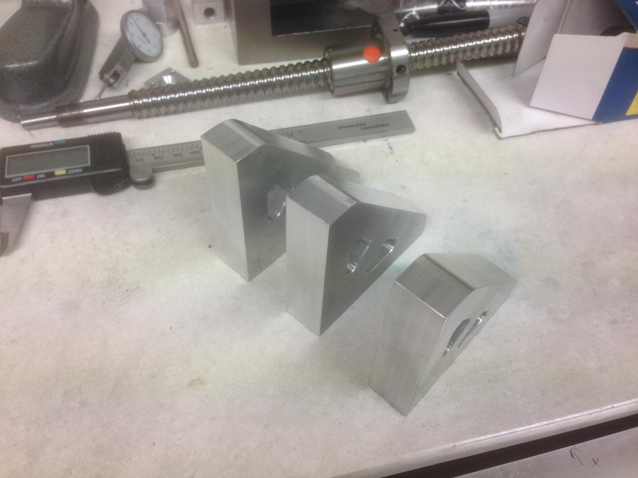

Last time I left you in suspense over the holes in the side of the bracing pieces. Here they are being machined:
All 4 pieces machined:
Two of the holes need to be M8 tapped, and one is a clearance + counterbore. Here is the counterbore being done.
Bit nerve racking for 2 reasons. Firstly the pilot hole was machined blind on the other side, so I had to hope I'd got it all lined up so that the counterbore appeared in line with the hole. As you can see it was all OK:
Secondly, part was a bit close to the chuck. I'd measured it and knew it would clear. Clearance is clearance as they say but still glad it went OK. . . .
Then tapping the M8 holes on the bottom:
All 4 parts done:

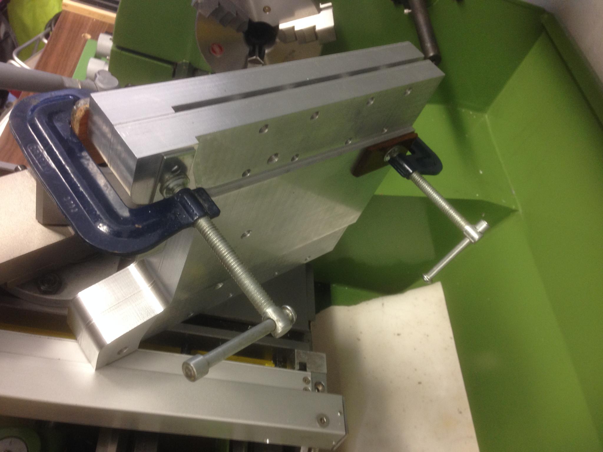

Then back to the side panels. They needed holes on the sides which is always a bit more awkward. Got them dialled in:

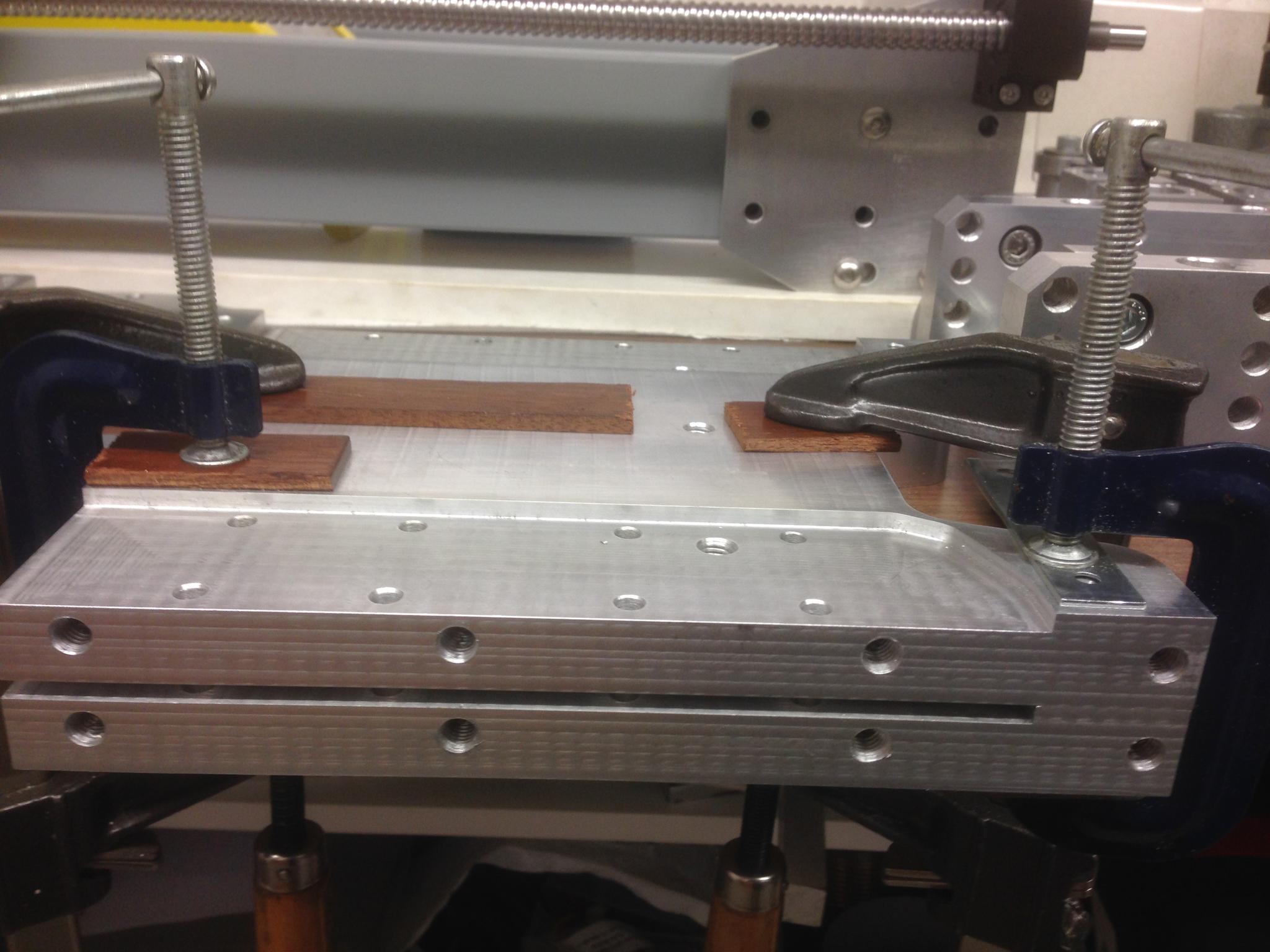

Machined the holes and noticed that the top edge had a slight climb to it across the width with one edge 0.05 higher than the other. I guess this is reaching the limit of my current machine when cutting out a profile. So I took a very light skim to get it square again. This needs to be square to make the whole box square:
Repeated for the other one, then placed them machined edge side down onto an assumed good reference surface (lathe cross slide) to get them level with each other and then clamped them together:
Then machined the other edge, by taking a minute skim off, and then machined out the holes:

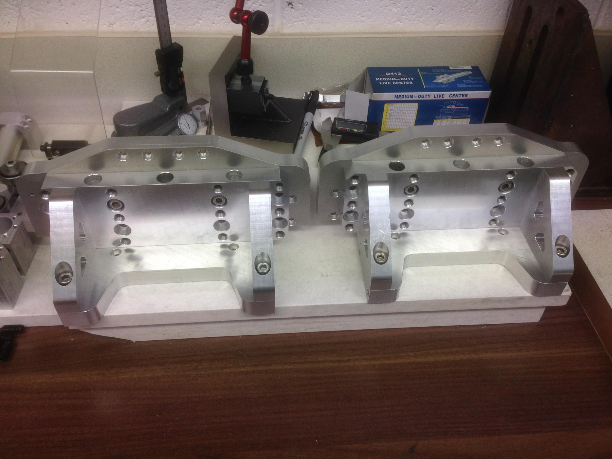

Final dry fit of everything:
More to follow . . .

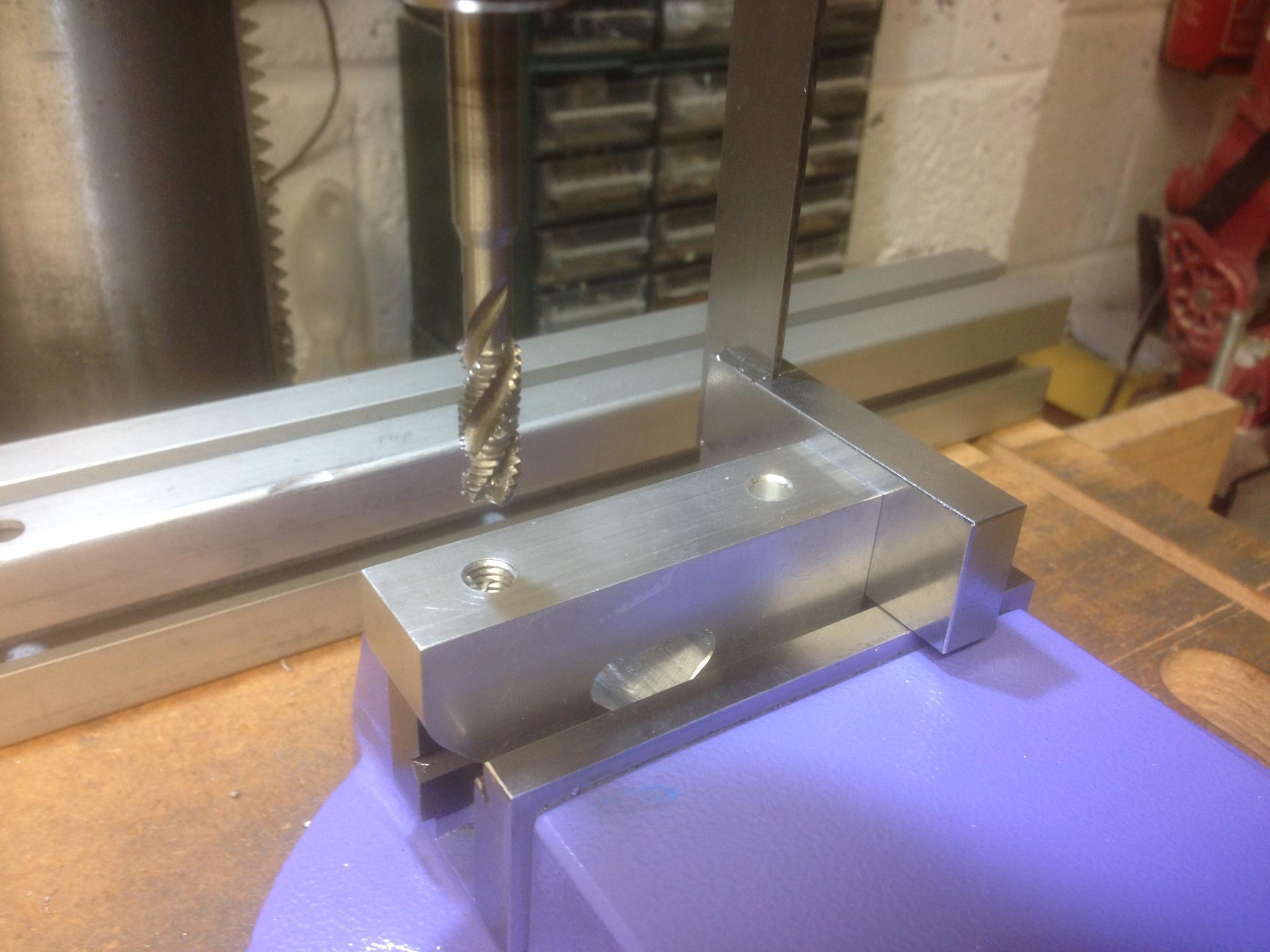

The tram plates also needed holes in the side. Here was the set up:
These holes needed to go all the way through the part, which is quite wide. The cnc machine can bore about 20mm into the hole, so the rest would need to be drilled out. But I didn't trust the drill not to wander so machined the bores on BOTH sides of the part using this fixture. Then drilled it out on the pillar drill from both sides until it met roughly in the middle. Guaranteed to get a straight hole !
Then counter-bored to hide the cap head and cleaned up:
