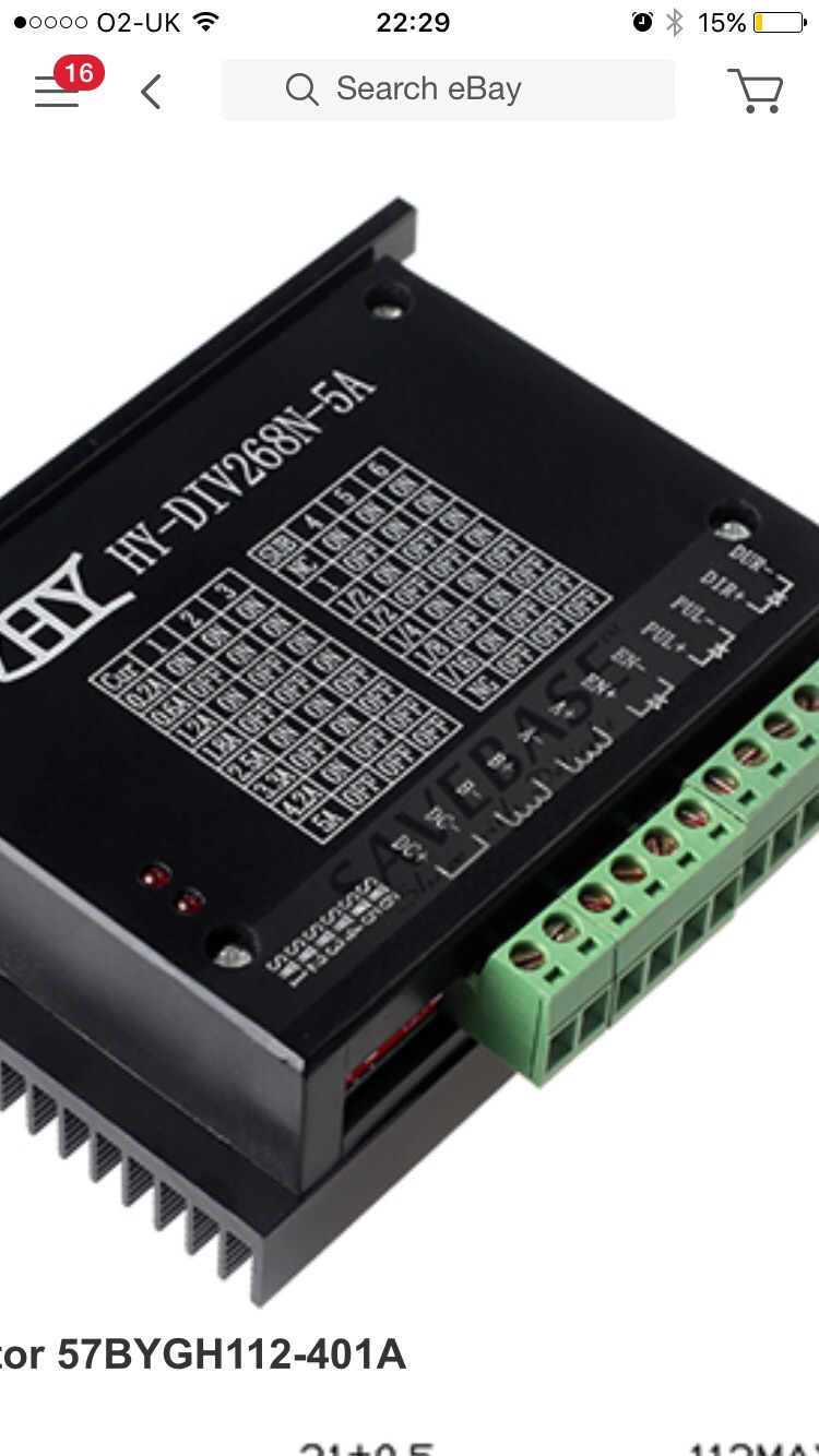

    These are the drivers which are being used on the motors. They are set for 3.3 a

    EDIT: Ok well after seeing the drives then I'm not one bit surprised. Sorry to say this but they are Cheap nasty units which won't have much if any resonance handling capabiltys so it's no surprise motors are complaining.! They also often have slow electronics so it could be a timng issue.

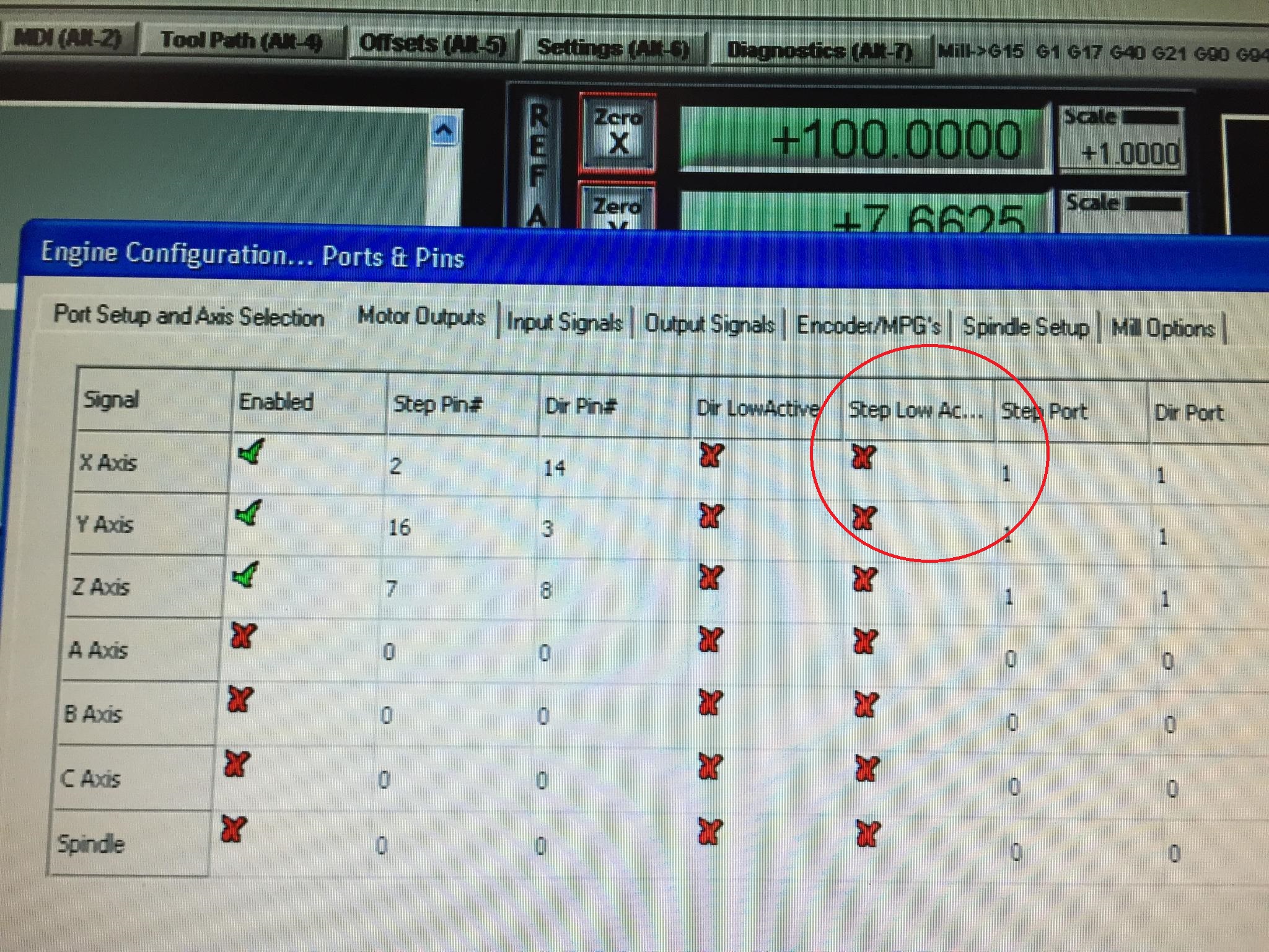

    One thing I've seen work before with these cheap drives is to toggle the Step low Active setting. (it's technical so won't get into why, just try it)
    Also playing with Step Pulse Dir Pulse may be needed because the Opto's could be Slow so the Step pulse needs widening.
    First try setting the Step pulse to 5 and Dir pulse to 0 and see what happens then if no change then toggle the Step Low Active.

    ok i attached the motors to the cnc and still no change. i aslo have change the ms to 1/4 and 80. still nothing.
    where can i find the step low active setting.

    Here.

    As a matter of interest what Voltage is your power supply to the drives?
  8. #18
    Chaz's Avatar
    I was just about to ask the same. Is the Voltage at the right level and 'clean'?

    its getting 24.4v
  10. #20
    Chaz's Avatar
    Quote Originally Posted by Davo242 View Post
    its getting 24.4v
    Is that what the drives need? Sounds low to me but could be correct, not looked at any specs etc
