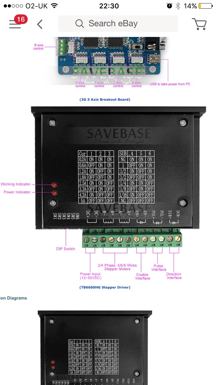

ID:	17024Click image for larger version.
ID:	17025Click image for larger version.
ID:	17026 hope these are ok

    Ok well first turn the Kernal speed sown to 25000hz you don't need it that high. Going to high here stresses the parallel port.
    Next the fact you are testing on the bench and not fastening the motors down will cause resonance which could be some if not all of the problem.
    Also the Steps per setting how did you come to the figure of 320.? . . . . And What are Micro steps set to on your drives.?
    Are each axis set to the exact same step per figure and tuning.? You must select the Axis on the side bar to correctly display for that axis and then save after every change.
    Thanks for replying
    Ok I will try fastening the motor to the frame tomorrow to see if this corrects the problem.
    The steps per setting I have used is what was outlined in the illustrations provided with both the motors and drivers. The micro steps are set at 1/8. On my drivers this corresponds to off on off.
    Yes I have checked each axis and they are correct.
    I will try and upload pictures of driver.
    Once again many thanks for your time and patience
