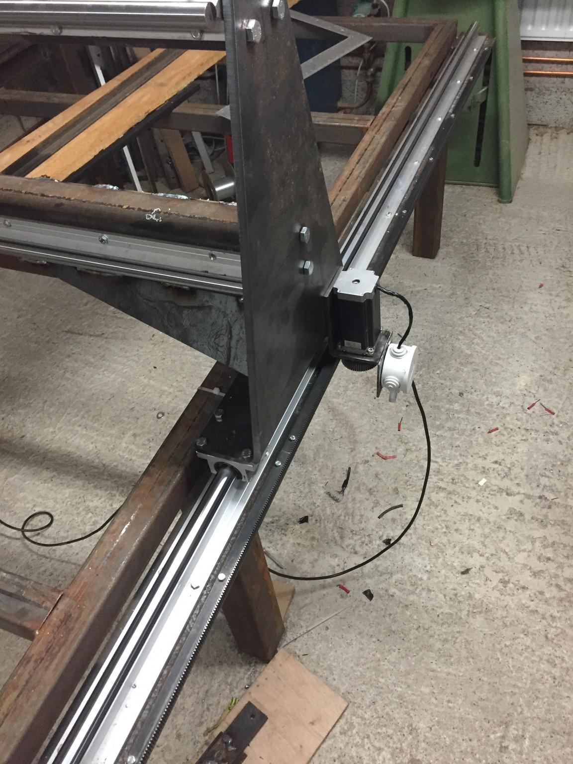

    If you are using the drivers in you picture then 36 V would be a max and the power supply you have will only give 36V. What is the actual problem you have. Pictures of the setup would be a good starting point.
    The motor on the y just seems if it's not getting enough power to drive the gantry the motor gives the odd shudder also I think the problem could be that it's only driven on one side and I'm just trying to tell myself I don't have to hand out anothe £200 odd to drive the other side to. I will upload some pictures this morning.

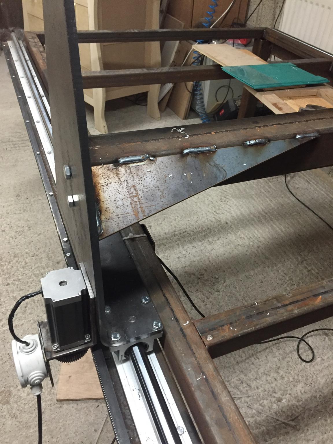

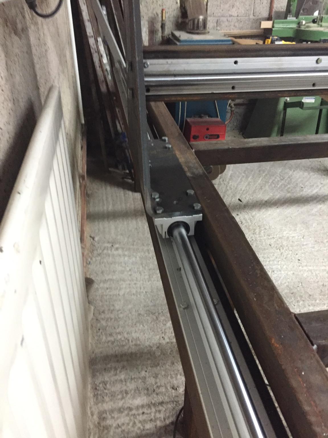

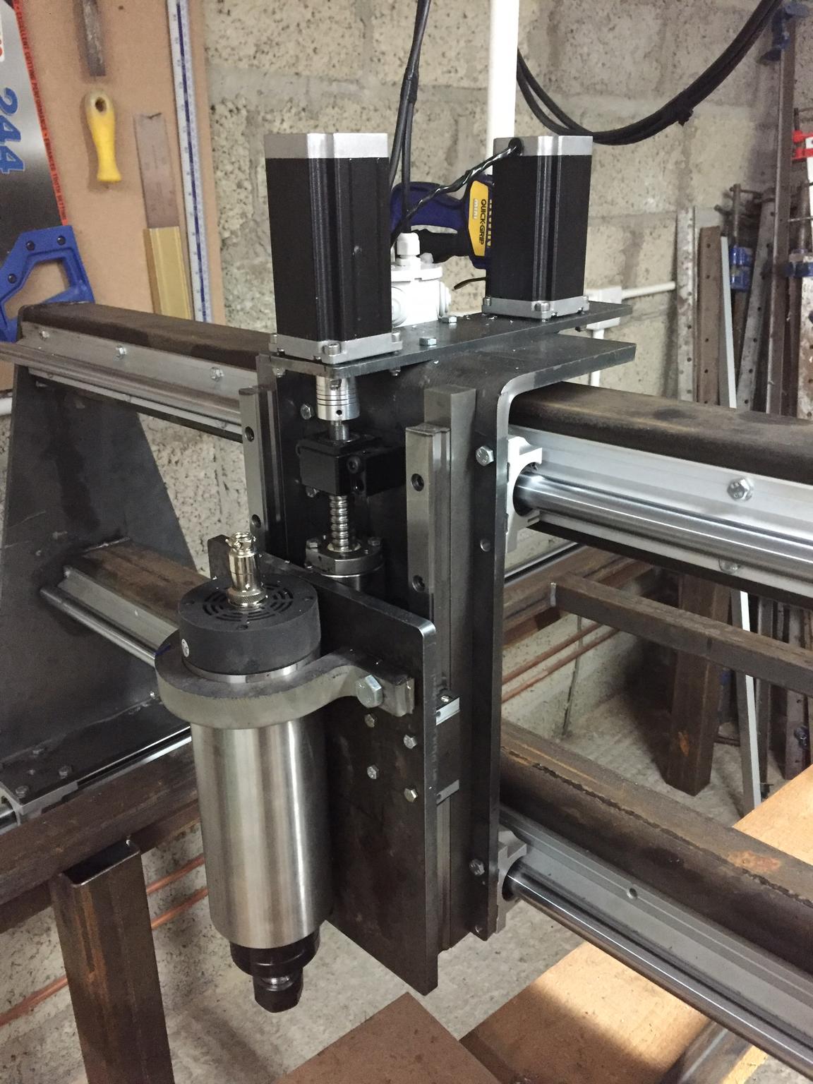

    If you are driving the gantry from the side then it will rack. So lets see the pictures

    For a single CENTRALLY DRIVEN gantry I would not go wider than 600mm. Any wider needs to drive systems (one on each side). Yours looks considerably wider.
    Furthermore, and critically, for your design it is very unusual to try and drive a gantry from one side only. It is very likely to rack / judder, plus give poor accuracy when cutting further from the driven side.
    I expect that if you grab hold of the non-driven side you can push it back and forth several mm, maybe more ? If so racking is a the likely cause of the judder.
    This can be reduced by spacing the X axis bearings further apart fore/aft, but I suspect even this may not be enough if you are still driving from one side.
