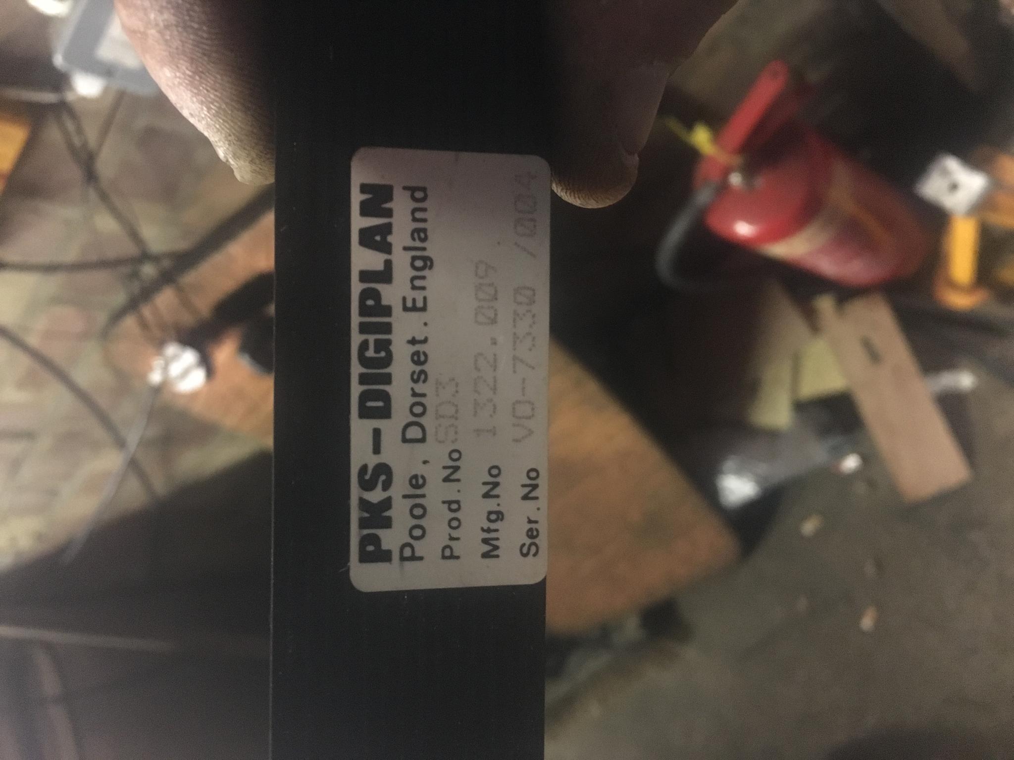

    uli12us my software is the new boxford cadcam desine tool v10.5 i bought it from boxford and it cost 760 all in with some tools i needed its expencive but so easy to use but everyone seems to convert them ill have a look for a wiring diagram for you i took the carrolsel off mine im just waiting on a stepper driver because one of mine went down
