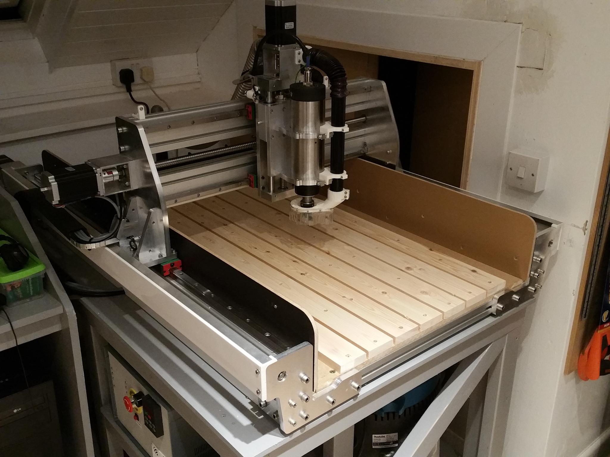

    Hey all..
    Here is a video build log of my recently completed super strong 1000 x 500 machine and first job cuts.
    https://www.youtube.com/watch?v=vjjTnn1KmRg
    Martin

    Great inspiration! Did you fix the rails directly to the extrusions?
    Good work
    /Madman
  7. #6
    Thanks Madman
    Yes. I broke a couple of taps along the way and it took me ages to remove them and rescue the hole.
    I used the completed gantry to help me ensure the rails were lined up. E.g. I made up the gantry first and put the long rails in it before screwing them down.
