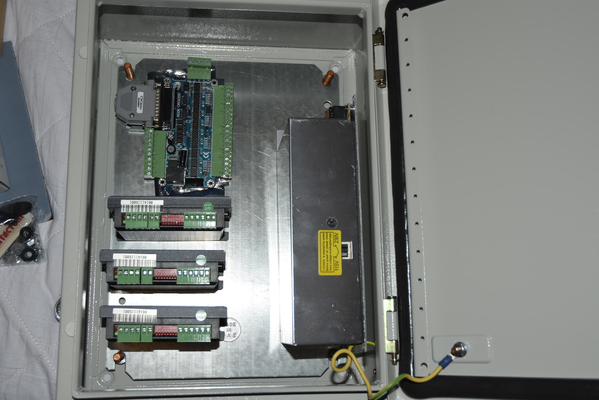

    Hi Dave, looks good. I'm sure the extra space will soon get eaten up with wiring and other goodies like clive mentioned.
    I would maybe swap the drives and the bob though and to try and keep the "clean" signal cables away from the "dirty" mains/drive power cables as much as possible?
    I think most people would consider safety relays a step too far for smaller machines. They have features monitoring to detect if the contacts have welded shut but many don't worry about it. Really depend on your personal view of safety :)
    I picked up a nice one for about £20 on ebay and it also has timed shutdown on one of the contacts which is nice. Can be quite large though and the ones I have seen are all din rail mounted.

    The parts, they produce most heat should be top. On the bottom side your box is open, you should close it with a dustfilter, similiar to the parts used in aquariums. And the heat must can flow out of the box, so you need another hole on the top or upper side of your box.
    Like cncJim said the space will soon get eaten up. I was limited at the time by the cabinet size i could have so i had to work with that, although i managed to fit everything i wanted in. Dont forget space for the wire runs ect.

    Really that case is little on the small side. You also need to think about heat and removing it with some fans.
    Regards layout then first I wouldn't worry about trying to fit it all within in the confines of the plate because the reality is after it's wired you won't ever lift it out.
    So I would put 2 drives up one side with one across top. The PSU like you have on it's side on the other side.
    Then have the BOB Lower down because most of your wires connections will be coming in thru the bottom ie: Limits, E-stop, probes, etc
    All Power and higher voltage wires or devices need to be kept far away from signal wires as possible and idealy run thru separate trunking crossing at a minimum. (See pic to get the idea of layout I mean)
    You will need fuses for each drive and the main Psu. Regards Safety Relay then while you don't exactly need a Proper Safety relay with protected and monitored contacts you do need a Hardware driven safety system, which is what Clive S is refering too.
    Relying just on Software E-stop is dangerous and shoudn't be used even on DIY router. Don't for one minute think this machine won't snap your arm like a carrot if get in the way, equaly neither will it think twice about ploughing it's cutter thru your hand just like it would a piece of Oak.!!
    For this reason you need an E-stop safety system that uses a Relay to kill power to every thing that can hurt you. Then only after it's safe will it allow the system to Reset and Only with a Dedicated Momentery Reset button not just by releasing the E-stop button.
    The extra cost is minimal so it's stupid to not do it.

    Hi Uli12us,
    The case comes with a blanking plate for the hole in the bottom, I was going to fit the stepper connectors and power socket into that.
    Agreed, some more work does need to be done to provide ventilation
