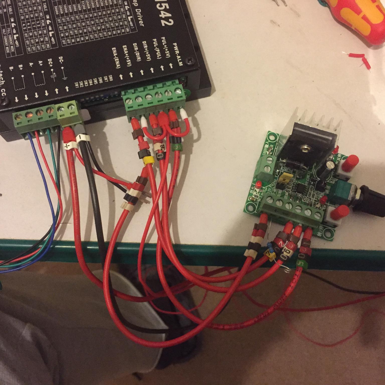

    I've got generator module and stepper driver connected with two power source 24v(driver) and 5v(generator) like in the picture
    I use PUL-, DIR-, and ENB-, 3 cables connected to the M542 driver
    In this setup I should join all pluses together and connect to common anode(+)
    I do not why but everything works without this cable - common anode(+).
    I am confuse here. I send only positive signals to the module
    I can change direction of the motor (DIR) and switch on/off the motor (ENA)
    Not the same situation if I use only PUL+ DIR+ ENB + without common cathode this time(-).
    Without common cathode I can only run one direction (like having only PUL+ and (-)cathode or PUL- and (+)anode two cables connected)
    I can have on/off function (ENA, because module send HI signal and disable(off) the driver.
    I know that signal I get is PWM square wave, multimeter allows to check polarity of such a signal (all + or -)
    Can anyone explain how this works please, many should benefit too.
    System got all function start/stops using ENA and Direction using DIR all done by 3 cable connected to (-) without having common anode(+)
    Tom

    Hi Tom3
    the M542 stepper drive enable is a negative logic input
    the driver is enabled by no input to the enable terminals !
    (+EN &-EN being at the same voltage or left disconnected )
    do you have a link to the instructions for the pulse generator ?
    its not obvious from the picture the function of the terminals you have connected to the stepper driver
    since the M542 driver +ENABLE , +PULSE & +DIRECTION terminals are linked they should be connected to +5V from the pulse generator
    grounding the -ENABLE will DISABLE the driver
    John

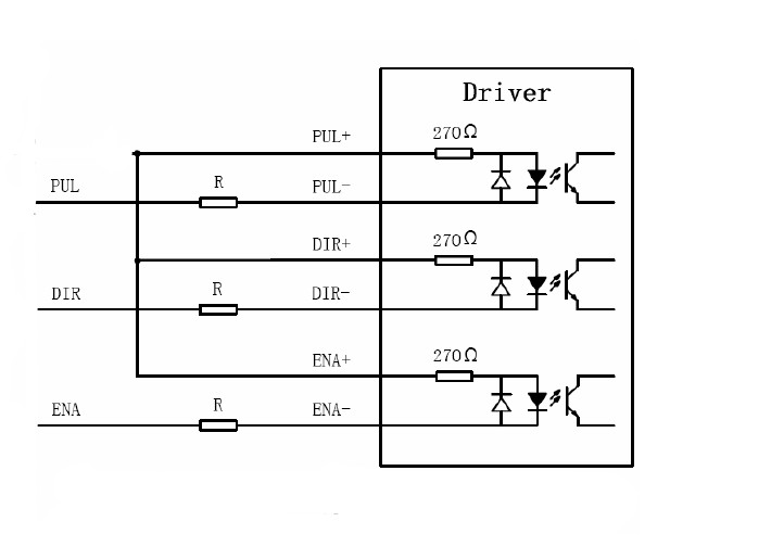

    the stepper driver opto isolator LED's have a diode in inverse parallel
    with the three positive terminals linked
    if the - direction is at a logic 1 (+5V) for example
    the - enable and - step inputs will appear to work until the - direction is switched to logic 0 (0V)
Name:	opto isolator inputs.jpg

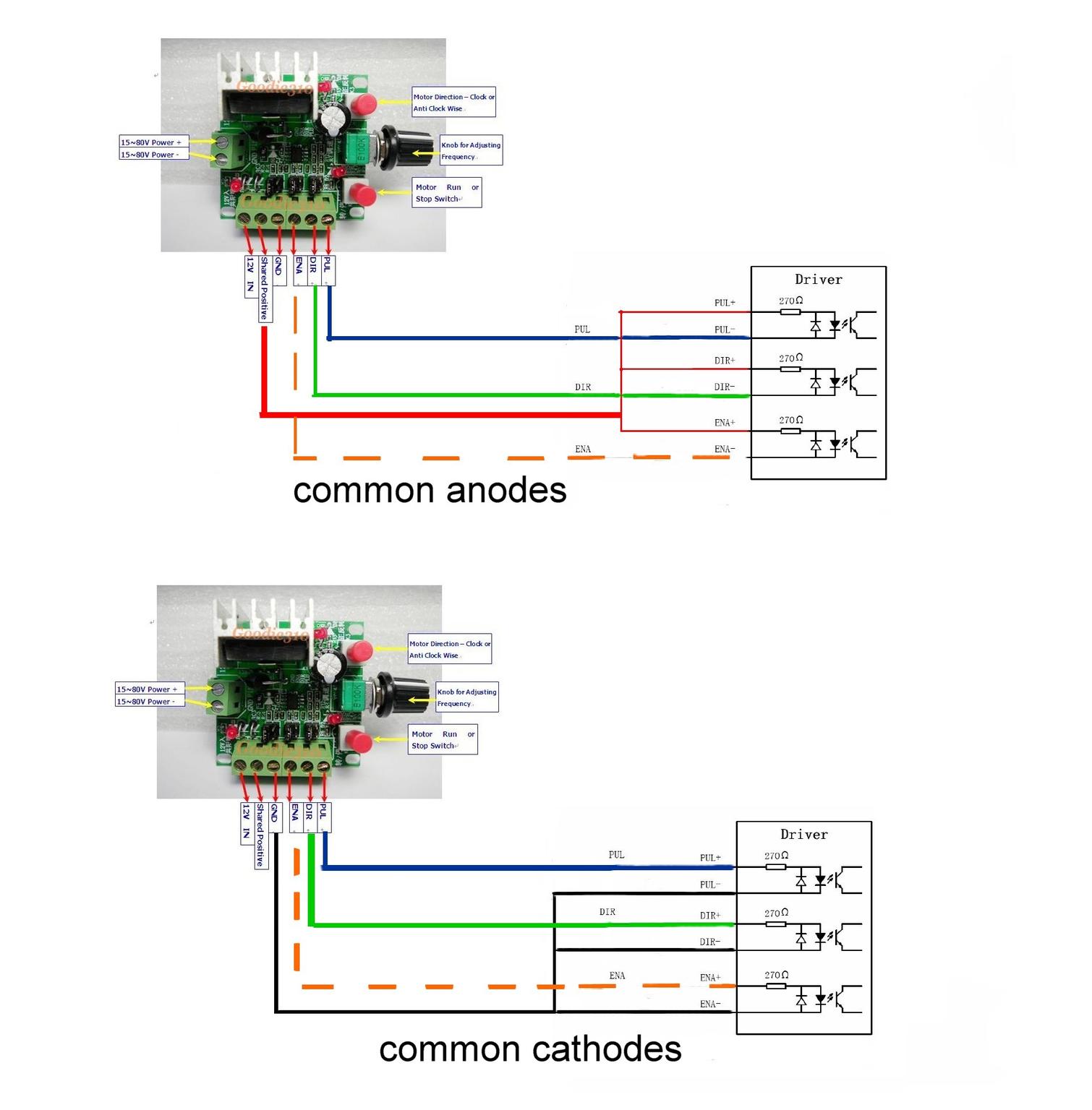

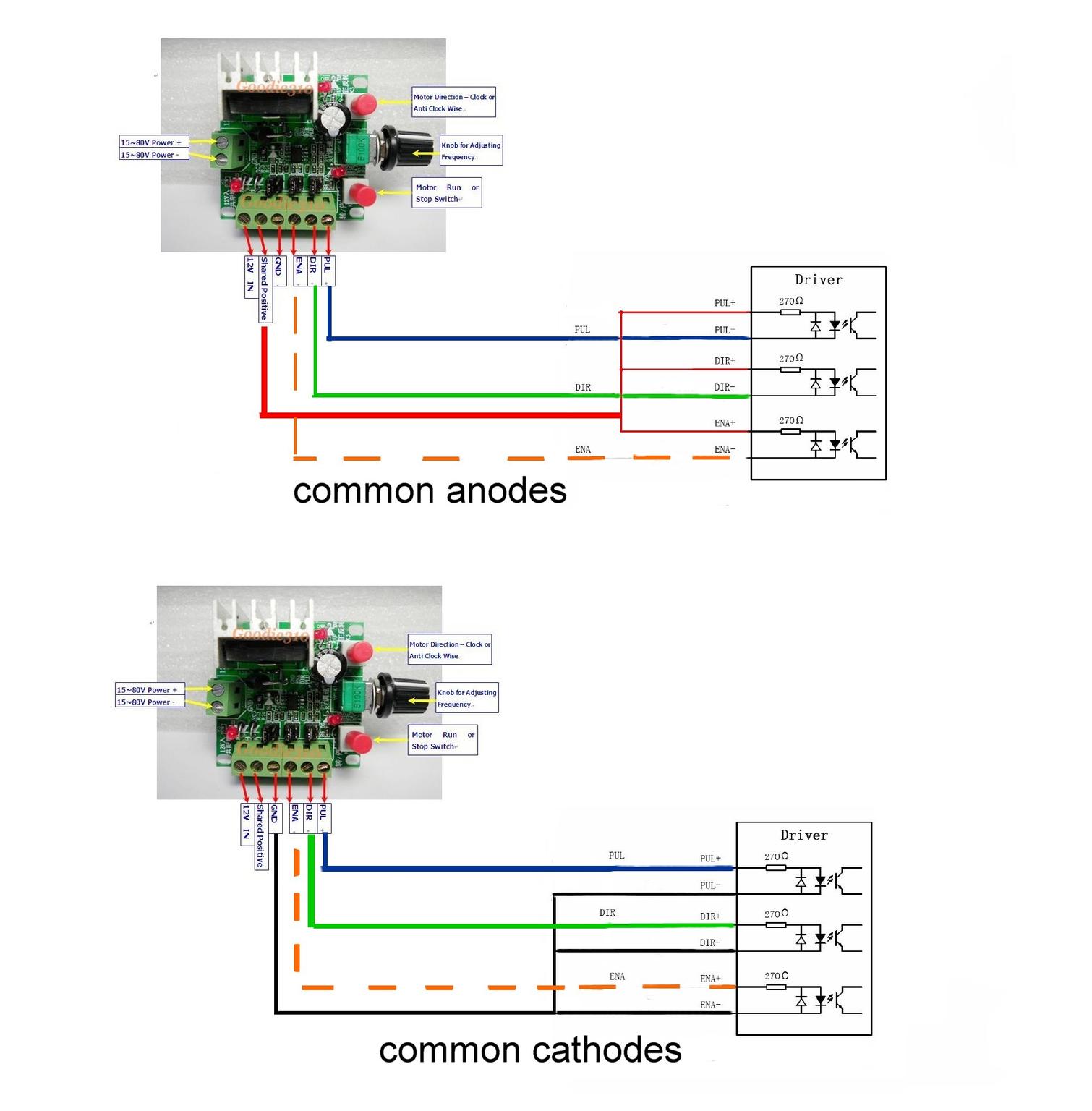

    after following the link and looking at similar pages on the web
    there are two possible ways to connect the pulse generator to your stepper driver
Name:	pulse gen connections.jpg
    with no indication if the step pulse is positive or negative going
    try both ways
    for initial tests you don't need to connect the Enable input
    John
