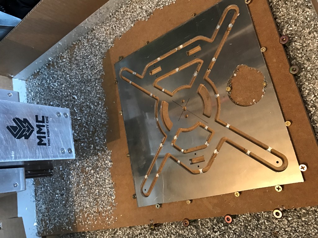

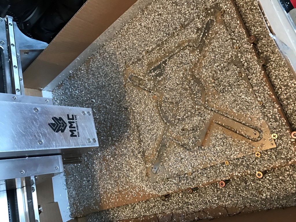

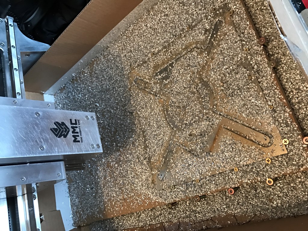

    I have tested aluminium machining. It is a first time that I have machined/cut aluminium and I'm not very happy with result.

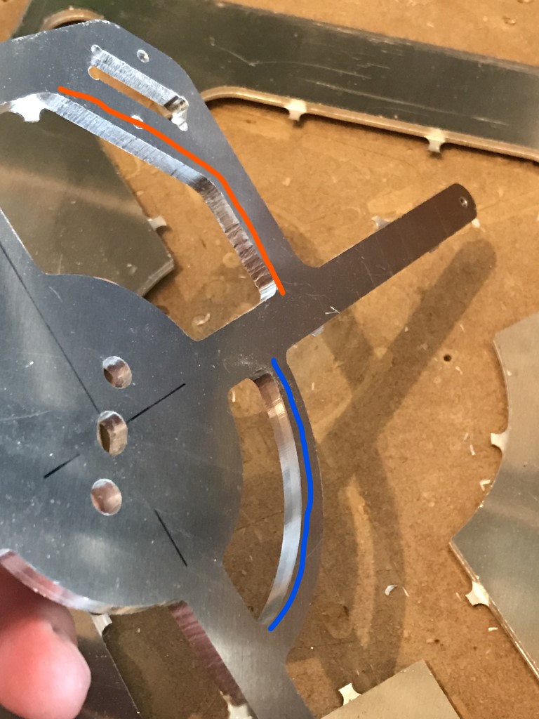

    In the attached picture the blue line indicates the pocketing path and red line profile cut path.

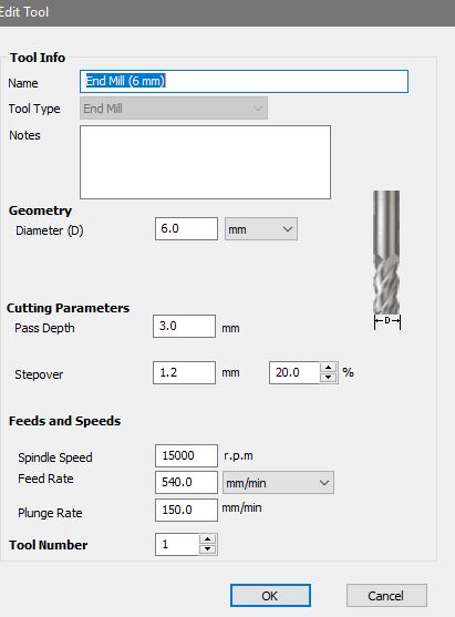

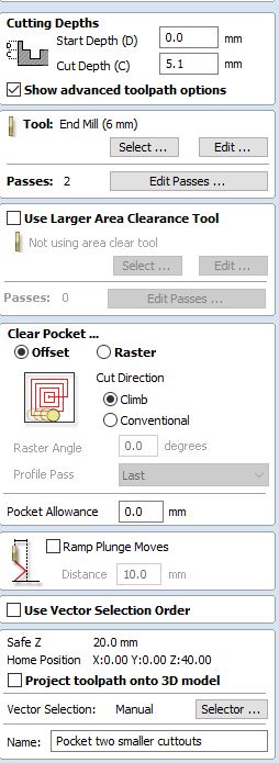

    pocketing path settings:

ID:	20597Click image for larger version.
Name:	pocket settings_2.JPG

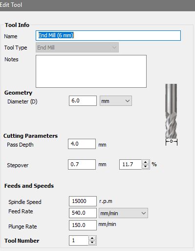

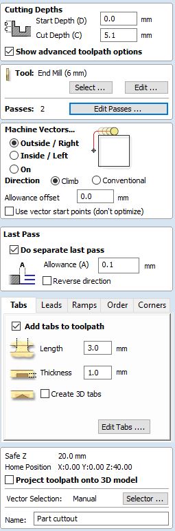

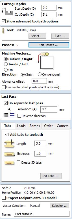

    Profile cut path settings:
Name:	Profile toolaptj settings.JPG
ID:	20598Click image for larger version.
Name:	Profile toolaptj settings_2.JPG

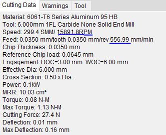

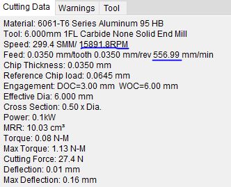

    Spindle speeds and feeds are from HSM advisor:
Name:	from HSM advisor.JPG
    Pocketing toolpath on part looks really good - shiny finish. But on Profile path - looks like crocodile just cut with his teeth...
    Could someone point out where is the issue here and how to get same surface finish as per pocketing toolpath ?
    Thank You
  6. #16
    You'll never get nice finish on slotting profile toolpath without using Finish pass. So leave material offset and do full depth 0.2mm finish pass.
  8. #17
    Thank You, will do so in next tests. What about speeds and feeds - does it look corrcet ? I tried to use G wizzard, but it gaves me somewhat different settings (24000 rpm and approx 1500 mm/min feedrate). So im not sure if I made a good choice :)
  9. #18
    Speeds and feeds are not far off and good point to start. I'd play with DOC to see how your machine handles different depths. 3mm on 6mm tool is little agressive for this type of machine and high spindle feed. Might get better results with 2mm and slightly higher feeds, same out come in cutting time terms but with better finish because less tool chatter.
    Much about Feeds And speeds is learning your machine and what likes or doesn't in terms of tools and materials.!
