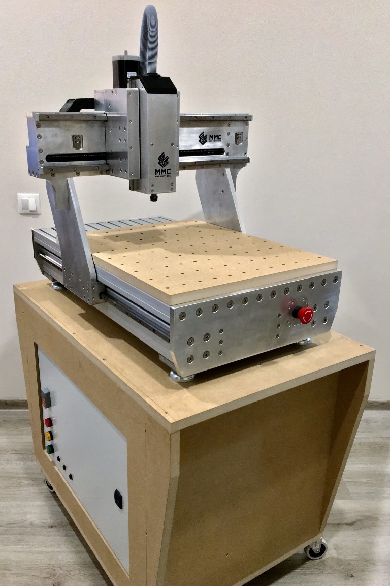

    Hello everyone,
    Bit more than a year passed from my first post and intentions to build a desktop size CNC machine. The design took longer than expected, but this CNC machine is not only about functionality, but about the design too. Machine is designed to have a small form factor but with biggest possible cutting area and be able to cut various materials, including steel. I hope You will like it as much as I do.
    MMC - Mini Mighty CNC:
ID:	20538Click image for larger version.
ID:	20539Click image for larger version.
ID:	20544Click image for larger version.
ID:	20542Click image for larger version.
ID:	20543Click image for larger version.
ID:	20545Click image for larger version.
ID:	20546Click image for larger version.
    Some numbers / info about my CNC machine:
    • FULL Work area X/Y/Z: 480 x 600 x 110 mm
    • Foot print: 416 x 778 mm (to outside of the foots)
    • Machine dimensions (L x W x H): 830 x 650 x 640 (height measured when Z axis UP at maximum, width measured at maximum width of X axis)
    • Weight (kg): approximately 100kg (control cabinet not included)
    • Rapid speed X/Y/Z: currently tested with 10000 mm/min showing very good results
    • Acceleration: X/Y - 2000 / Z - 1200
    • Repeated accuracy: 0.01 mm (check video below)
    • Linear rail types: HIWIN 15mm with carriages HGH15CA
    • Drive train X/Y/Z: Belt driven 1:1 ball-screws for all axis (1610 for X and Y axis, 1204 for Z axis)
    • Spindle: Currently installed 800w water-cooled spindle. (Can be upgraded to 1,5Kw spindle)
    • Drive motors: Steppers NEMA 23, 3.1NM (60BYGH301B)
    • Home/limit switch's: Inductive Proximity Sensor type
    • Sacrificial MDF bed with 54 pcs of 6mm threaded points for material fixing
    • Built entirely from Aluminum
    • Software: UCCNC 1.031 (show the new layout for UCCNC)
    • HB04 Wireless Remote Handwheel Controller MPG Pendant
    Control cabinet:
    • Stepper drivers: Leadshine AM882 Digital Stepper Drive With Stall Detection
    • Motion Controller: UC300ETH-5LPT ethernet motion controller
    • BOB: HDBB2 breakout board
    • VFD: Schneider Altivar 320
    • Toroidal traff: 230V/2x24V 2x12.5A = 68V DC to Stepper drives
    • Capacitors: 2 x 20000/100V
    • And other electronics...

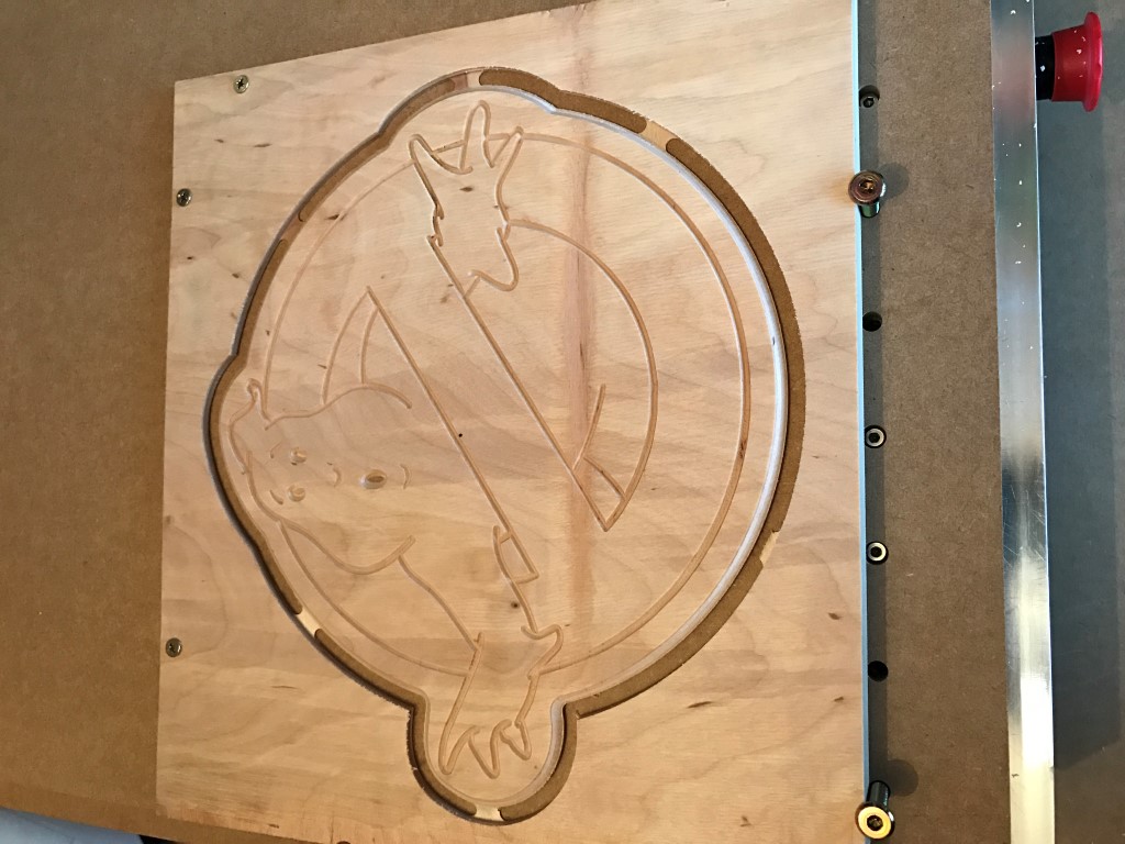

    I made a few checks of machine accuracy and repeatability.
    Here is videos for Z and X axis (Y axis has same accuracy, I did not made a video cause I feel it will boring to watch anyway :) )
    Z axis test:
    X axis test:
    Testing my new CNC machine:
    Very first testcut:
    Material size: X= 285.000, Y= 305.000, Z= 4.500
    Rapid CNC move feedrates:
    X axis: 8000 mm/min
    Y axis: 8000 mm/min
    Z axis: 6000 mm/min
    First toolpath:
    Tool: Solid Carbide V-Bit 90 deg 10 mm
    Cutting Feedrate:1500 mm/min
    Spindle speed: 18000 rpm
    Total depth: 1.2mm (Two passes: first pass at 1.0 mm, second at 1.2 mm) The two passes strategy was chosen in order to check repeatability of machine witch showed perfect results.
    Second toolpath:
    Tool: Solid Carbide End Mill 6 mm (1 flute @ 25degree)
    Cutting Feedarte: 1000mm/min
    Spindle speed: 14000 rpm
    Total depth: 4.6 mm (Two passes: first pass at 3.6 mm, second at 4.6 mm. 1x10 mm tabs to hold peace in place were generated)
Name:	Apsire - Ghostbusters.jpg
ID:	20549Click image for larger version.
Name:	Apsire - Ghostbusters-cut completed.jpg
    Next time, for such thin material, double sided tape will be used to avoid any material vibration during machining.
    Looking forward to cut some Aluminum and Steel.

    Currently I'm working on additional features for this machine and hopefully I will be able to post the results faster than next January :))) :
    • Dust shoe
    • Auto tool zero probes (stationary and handheld for semi automatic tool changing)
    • Mist system
    I'm very thankful to all of You, who gave me some kind of advice and support.

    Looks like a very nice machine its a credit to you. Its always nice to see the first cut.
    +1 on that.
    Lot of work and thought gone into the finer details of that machine which others might not see or appreciate well done. .
    Nice machine. Now you need a dust shoe so you can leave it alone working on it's own...
