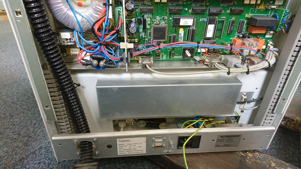

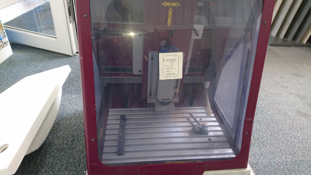

    Hi very interesting, I bought the day before yesterday a CPM - 3018 from a place in Harwarden for a offer of £100 plan on using a elderly PC i have in shed and https://charter-controls.com/product...rollers/g251x/ drives no idea what breakout board as PC dose not have a pparallel port
    when i get it home tomorrow i will run a demo software on it to ensure it moves, dont see why not it seems to have had little use
