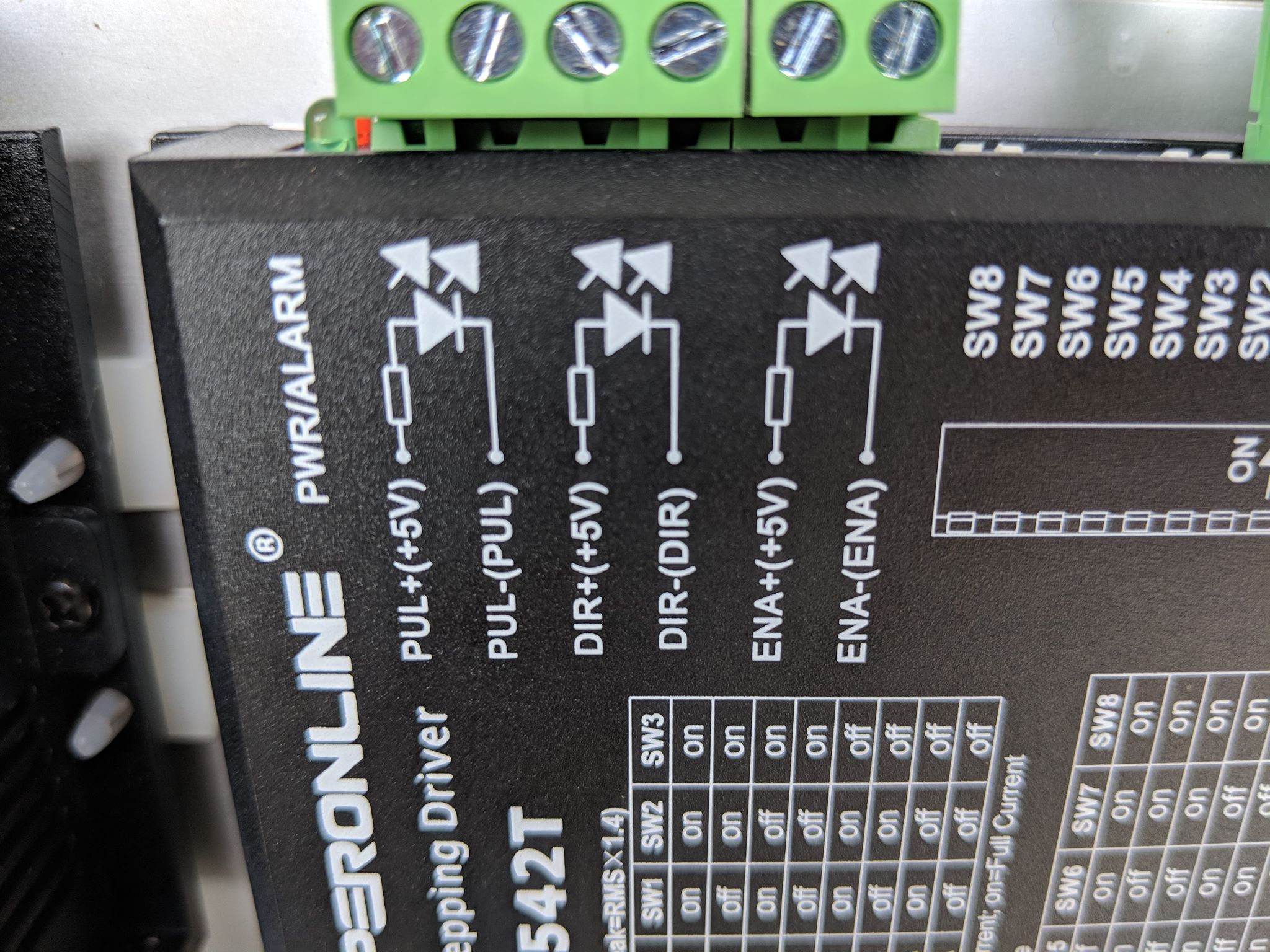

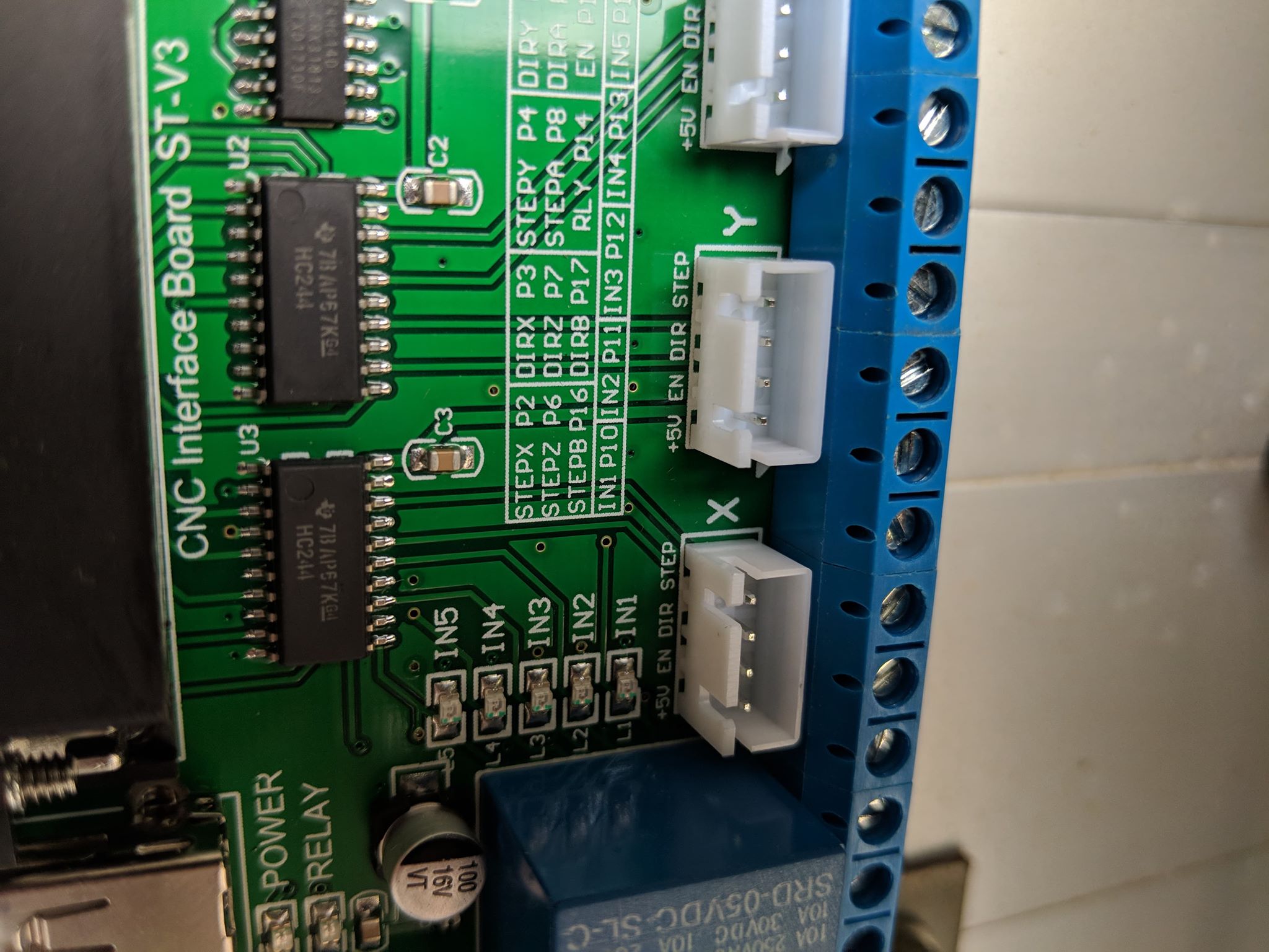

    Ok i'm at the final point, i think..
    but I am a little confused, i'm a newbie to setting up my own controller..
    The BoB I has (+5V, EN, DIR, and STEP) the Drivers has (Pull + / -, DIR + /-, and ENA + / -)
    I know the BoB EN = ENA on the Driver, DIR = DIR + on the driver and STEP = Pull + on the driver.. but what do I do with the extra 5V on the BoB?
    Thanks for the help!

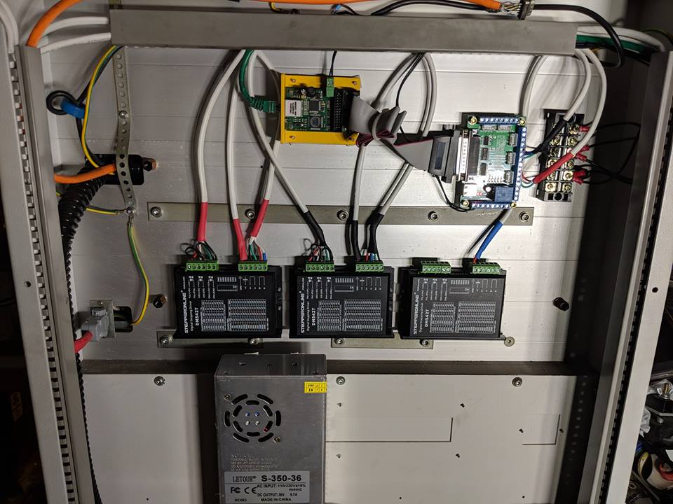

    I was able to get the X and Y axis running last night.. I will hopefully have enough time tonight to finish the Z axis.. I'm still not sure on how to setup the micro stepping and the motor velocity in mach3 (cause I don't know what values to use)
    Anyway, here it is moving.. https://youtu.be/iSry6ZRe8bI

    Well I got everything wired up as far as limit switches and motors / drivers go.. everything moves and stop when a limit switch is touched..
    tonight ill be installing the relay (router control) and maybe make the first chips..
  6. #66
    Well I'm all done with this conversion..
    https://youtu.be/sR1u89dEdgc
    Thanks for helping!

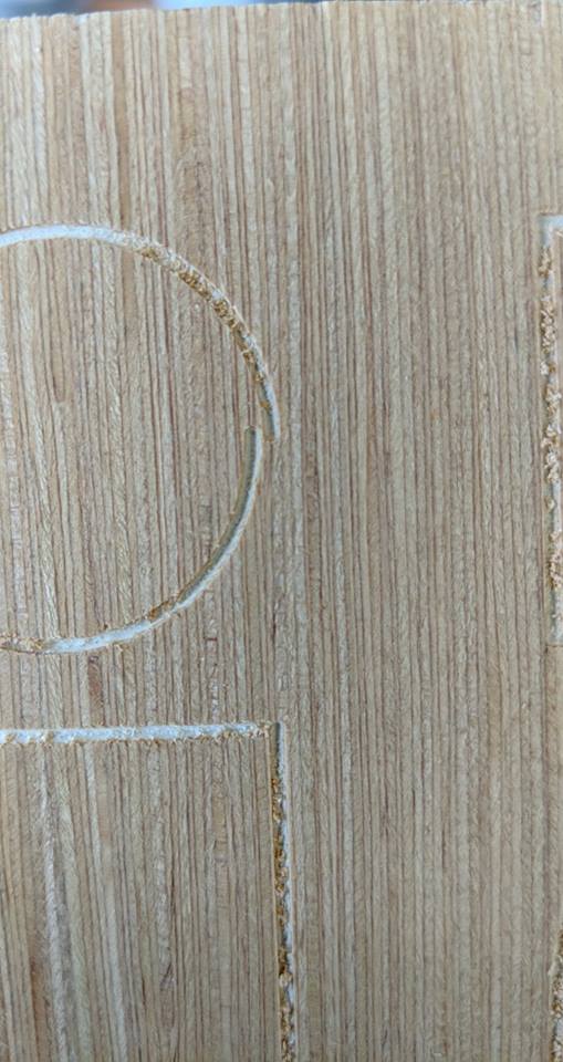

    Well I thought I was done, but it seems like the microstepping I have set aren't working right.. This is also going to be a pain since the lead screw is in metric, but we use imperial on this side of the pond..
    Anywho.. I thought I had everything configured properly, but the x axis keeps skipping a step randomly..
  11. #70
    Are you sure all vectors are connected/joined together?
    Phill
