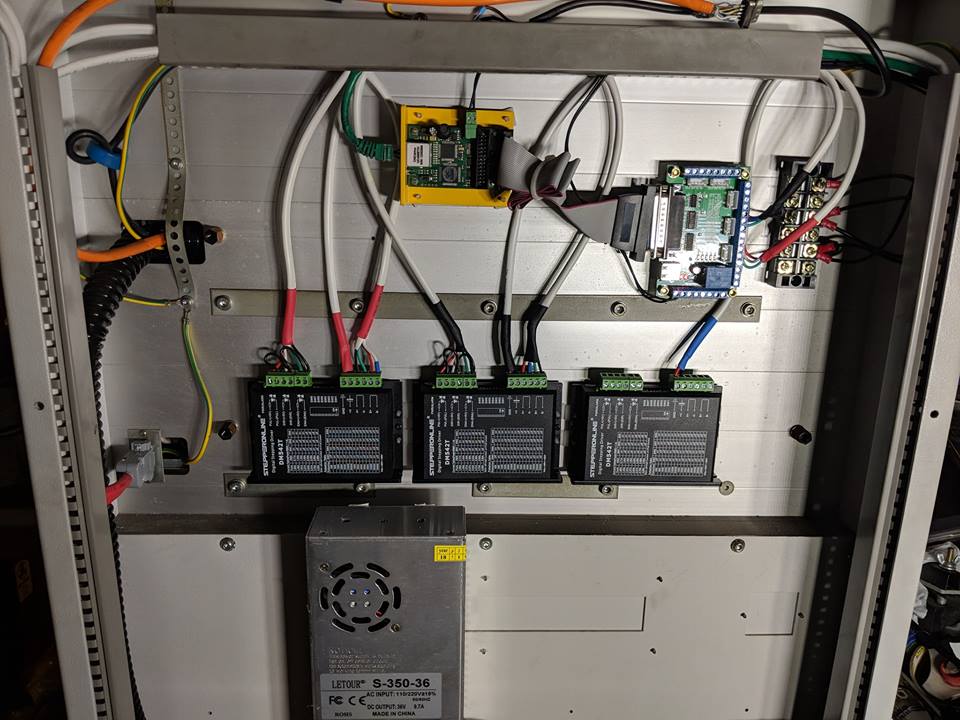

    I was able to get the X and Y axis running last night.. I will hopefully have enough time tonight to finish the Z axis.. I'm still not sure on how to setup the micro stepping and the motor velocity in mach3 (cause I don't know what values to use)
    Anyway, here it is moving.. https://youtu.be/iSry6ZRe8bI
    Attachment 24432
    What model are the Stepper Motor Driver Controller you put ?
    The picture appears to show Stepper Online DM542Ts.
    https://www.omc-stepperonline.com/di...or-dm542t.html

    Hi guys,
    the subject is a little dated, but I am looking for information and especially help.
    I just bought an ICP4030, same machine but bigger and more resent.
    I want to do the exact same retrofit : UC400ETH + BOB + UCCNC
    I am looking for information on how to wire the machine
    Someone to help me ?
    @mchipser ?
    @Steve-m ?
    Thks !!

    Thks MarMix, but i'll do it.
    I don't have Galaad, and I would rather pay for a UCCNC license than Galaad.
    I have the pdf of the pcb, but it does not bring me anything.
    I'm looking for how to identify the wires that go from the Nema to the drivers.
