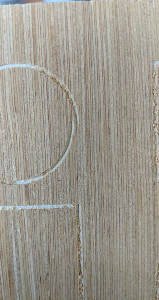

    Well I thought I was done, but it seems like the microstepping I have set aren't working right.. This is also going to be a pain since the lead screw is in metric, but we use imperial on this side of the pond..
    Anywho.. I thought I had everything configured properly, but the x axis keeps skipping a step randomly..

  11. #70
    phill05's Avatar
    Lives in Derbyshire  UK, United Kingdom. Last Activity: 15 Hours Ago Has a total post count of 302. Received thanks 30 times, giving thanks to others 13 times.
    Are you sure all vectors are connected/joined together?
    Phill
