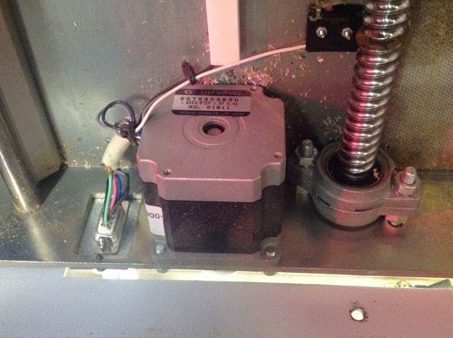

  1. Ok, I've managed to uncover the motors
    Motors are a Shinano SST58D 3830. 1.5v 4.4A
    data sheet here http://shinano.com/motors/docs/SST58D.pdf
    Anyone give me any hints on what this means - good or bad news? Please tell me I don't have t replace these!!
    They look OK to me. Can you find out what the secondary Voltage says on the transformer (or can you measure the DC Volts across the blue capacitor) in the power supply as Dean (Jazzcnc) has asked before
  3. Ahh across the blue capacitor, thank you! - it measures 24.5v .... Not the 36v suggested!
  4. #14
    Quote Originally Posted by craynerd View Post
    Ok then it looks like you will need to build a new power supply it basically consists of the transformer, Caps and a rectifier about £45-£50. What part of Manchester are you in?
  5. #15
    Like clive says motors are fine and you will be better using a new PSU with more voltage. If tight on budget then Technicly don't need a new psu and the machine will work with 24v even with new drives but you'll get much better performance with more volts. Not changing would be like having a ferrari and never taking out of 2nd gear.!
