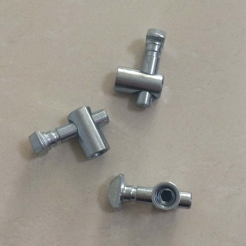

    I could use anchors, like these Click image for larger version.
Name:	T-Anchor-fastener-90-degree-center-angle-connector-aluminum-anchor-connectors-for-4040-aluminum-.jpg
ID:	17581 or even combination of 90 degree angle and anchors under them? Lots of thoughts how to start everything and put together, so sorry if all those questions sound silly :)

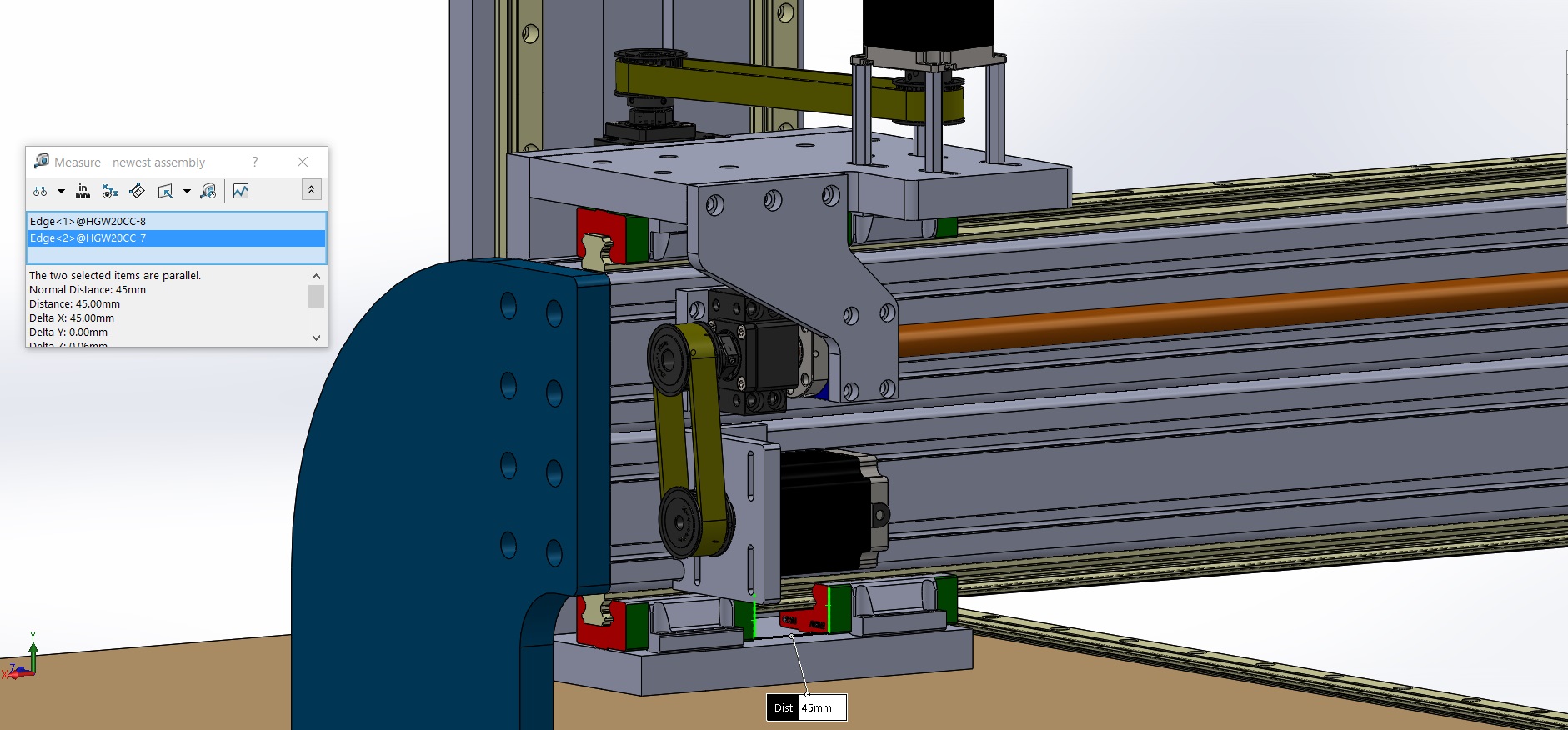

    I am going for a bit smaller size than said in the beggining. Now I am using 1400mm length rail (x axis) and get 1190mm of travel from it leaving 5mm each end unused, in Y axis using 1150mm lenght rail and get 940mm of travel, the same using 5mm each end. Should I leave more in the ends?
    All the plates seen in screenshots are 20mm thickness except motor mounting brackets and y axis ballnut housing attachment to z axis.
    Thank you for any input!

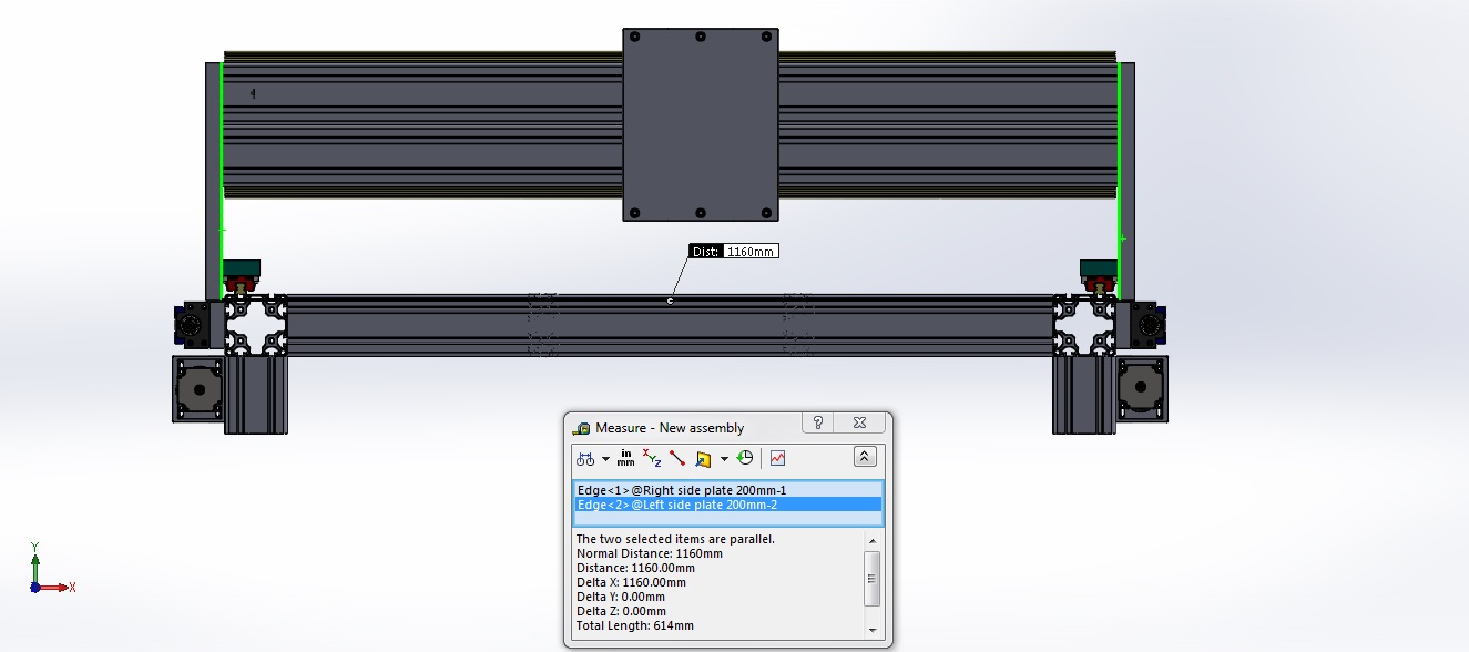

    Hello again after a while. Had some interruptions, broken computer, but i am back again with in my opinion more or less final design. Mainly i am going to use it for woodworking, and hopefuly i will be able to machine aluminium at low speed. 2.2kW water cooled spindle should be capable doing that?
    Lets start from main dimensions.
    X(longer) axis. 1400mm lenght Hiwin 20mm rails with HGW20CC carriages. 200mm between carriages ends. It gives 1190mm of travel leaving unused 5mm of rail each end.
    Y(shorter) axis. 1170mm lenght Hiwin 20mm rails with HGW20CC carriages. 200mm between cariages ends. It gives 970mm of travel leaving unused 5mm of rail each end.
    Z axis. 330mm lenght Hiwin 20mm rails with HGH20CA carriages. 178mm between carriages ends. It gives 133mm of travel leaving unused 9mm rail each end.
    The frame, legs, and gantry is from 80x80 extrusion. Frame cross bracing is 40x80 extrusion.
    All the plates are 20mm thickness except Y axis ballnut housing connection plate (which is 10mm thickness) with Y and Z axis assembly.
    For bed i iam going to use 20mm plywood sheet.
    Have 4 adjustable feets in all corners. Do i need in the middle aswell?

    Another question is what spindles positioning is the best? Here Z axis is all the way up:
    And all the way down:
