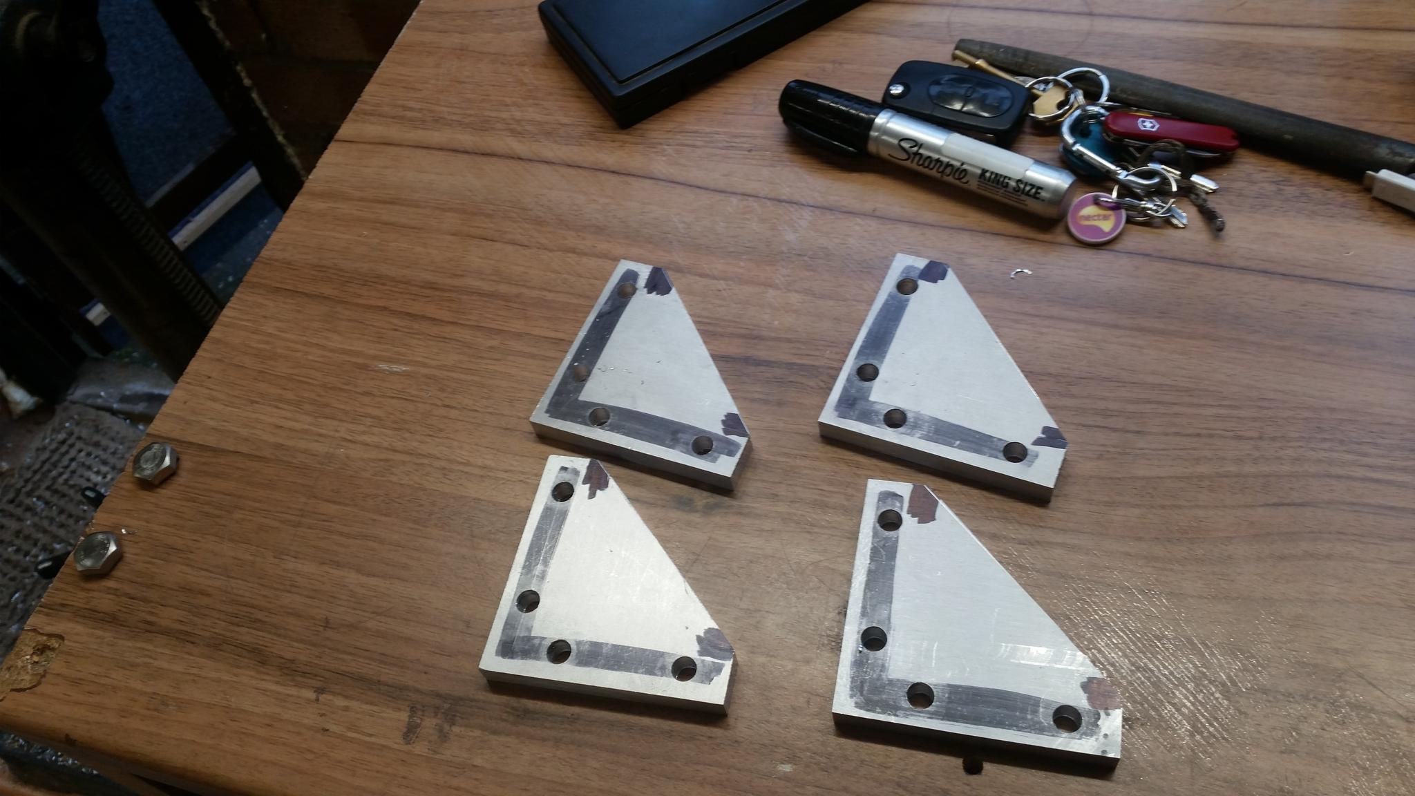

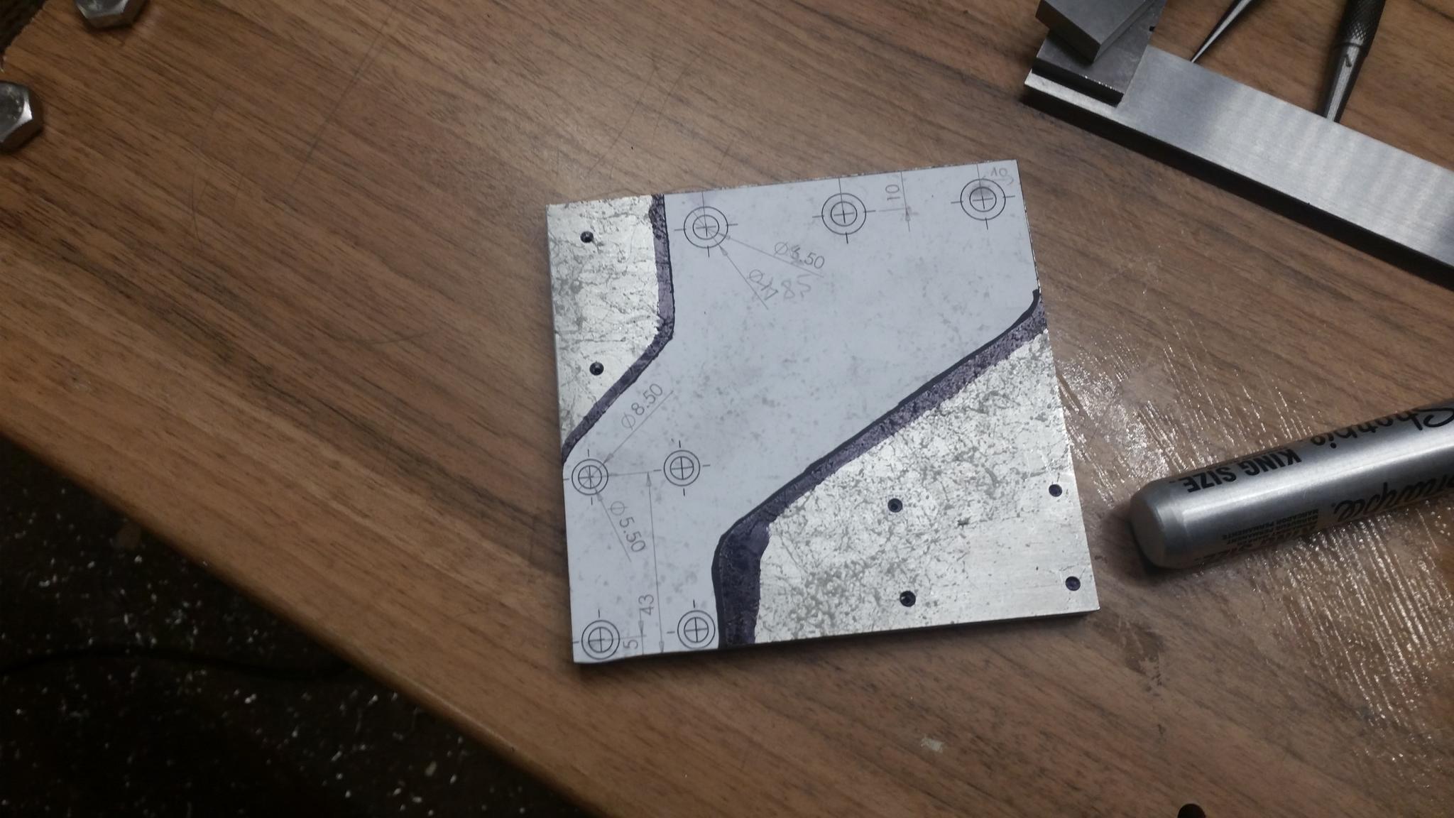

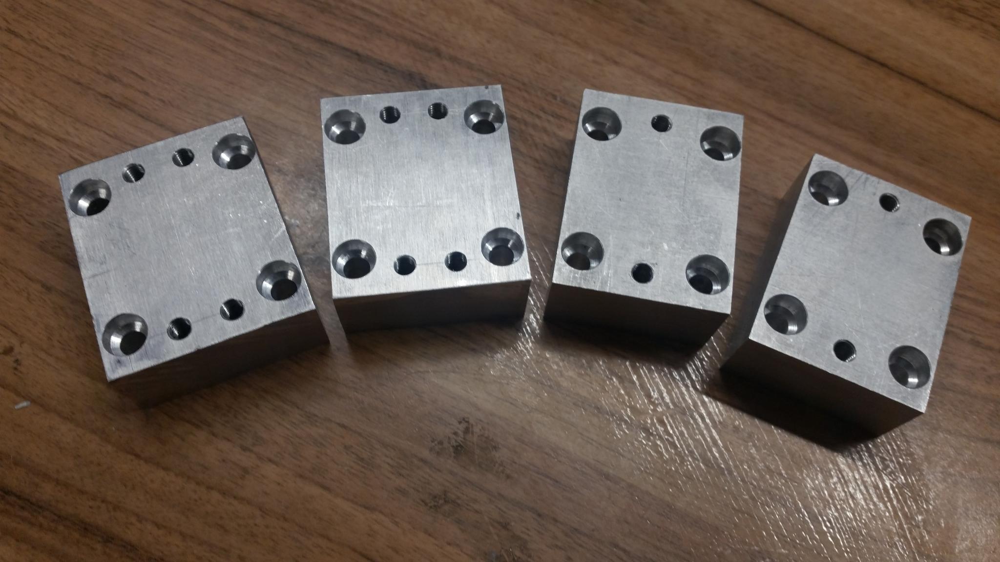

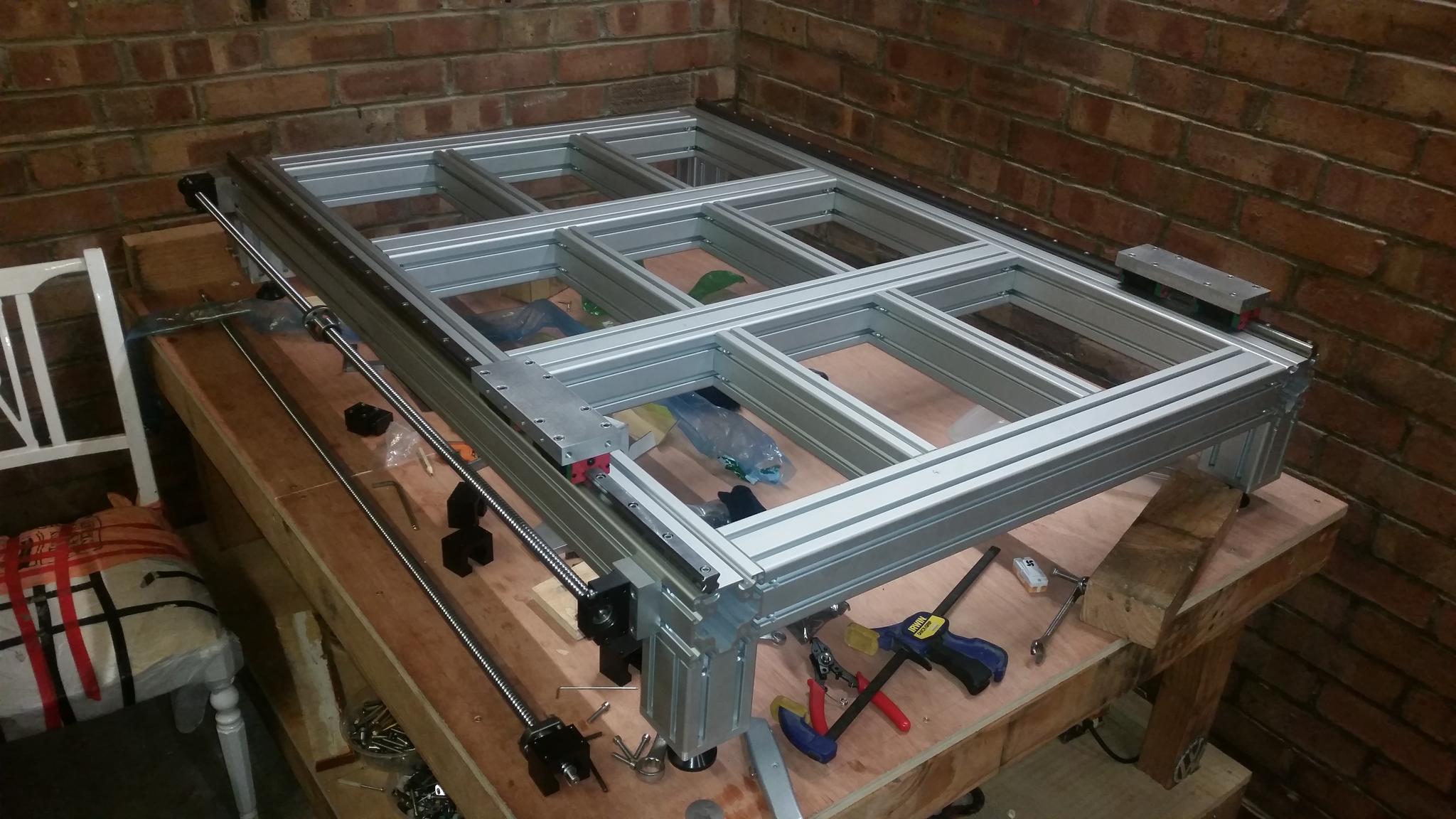

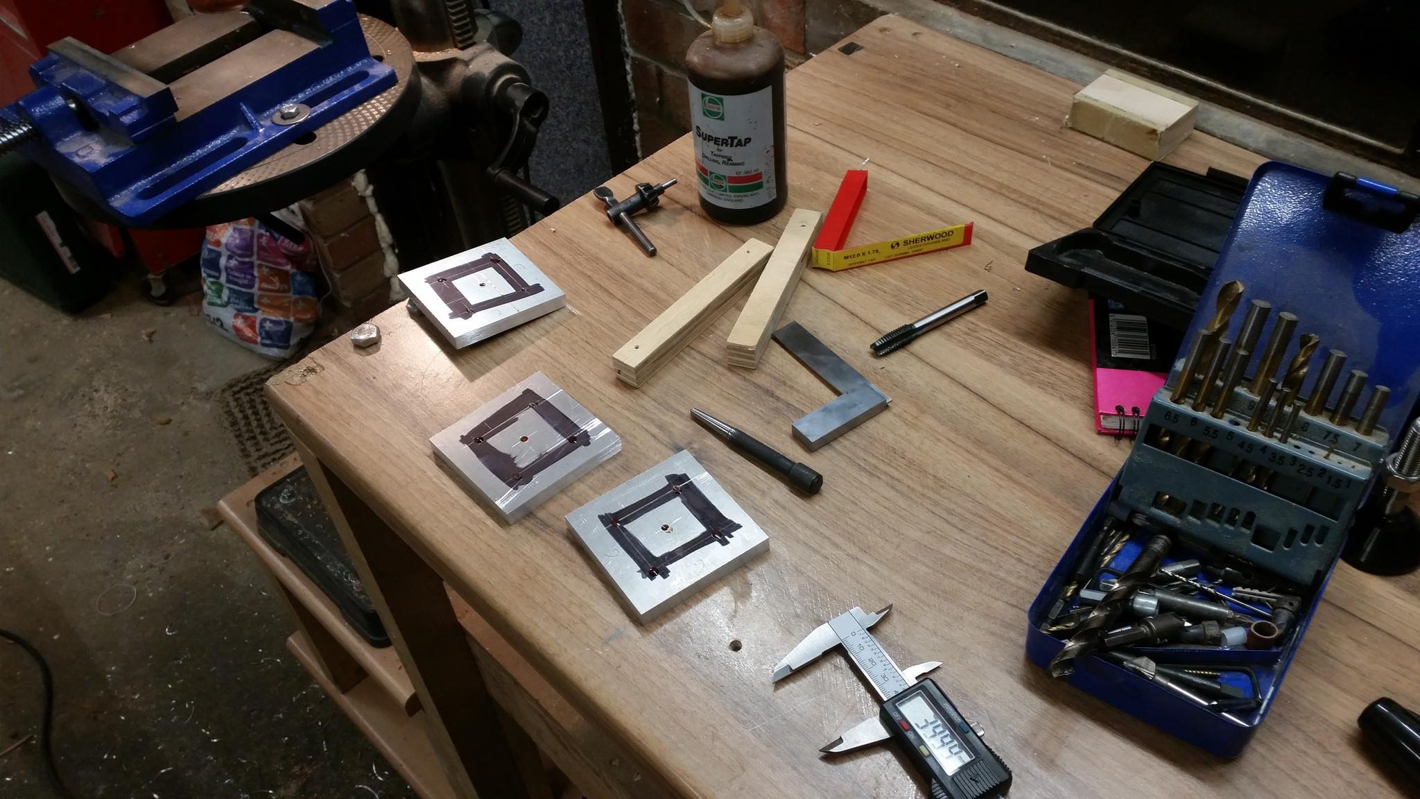

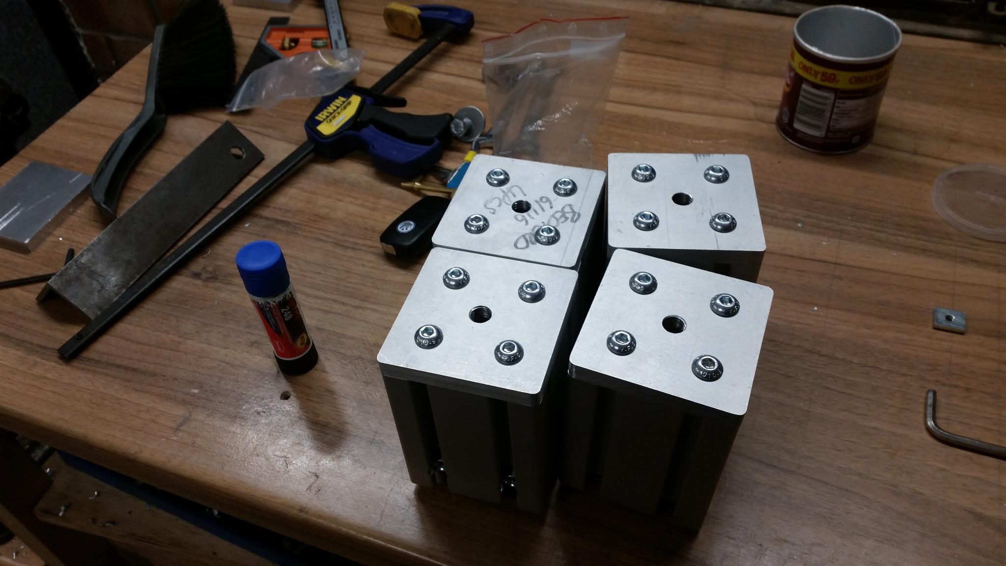

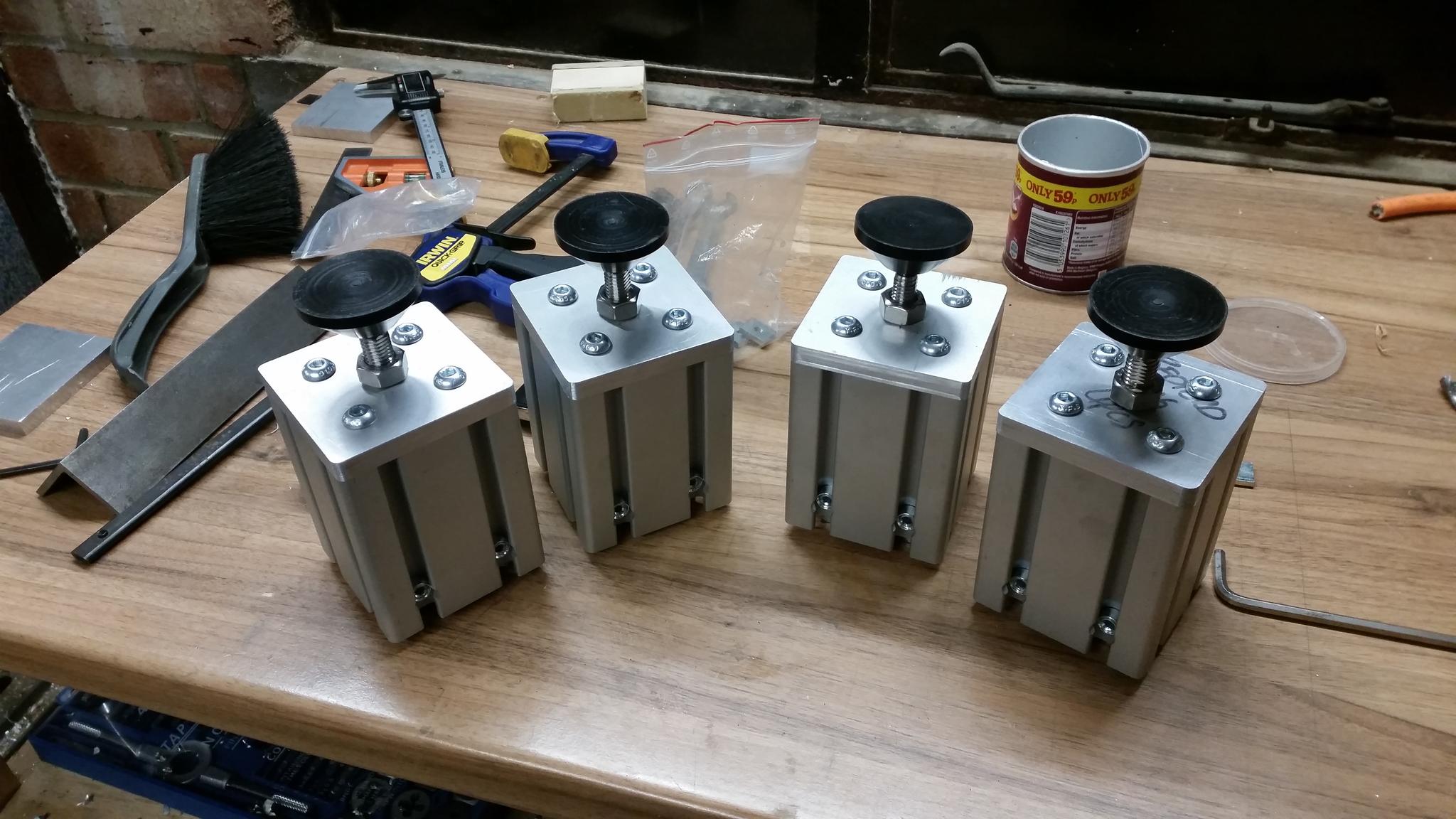

    Hello. Its been a while after my last post, but things kept moving a bit. Since that got aluminium plates, simple ones drilled and and tapped myself , more crucial parts like gantry sides, z axis plates, motor mounts will be machined by our guru JAZZ.

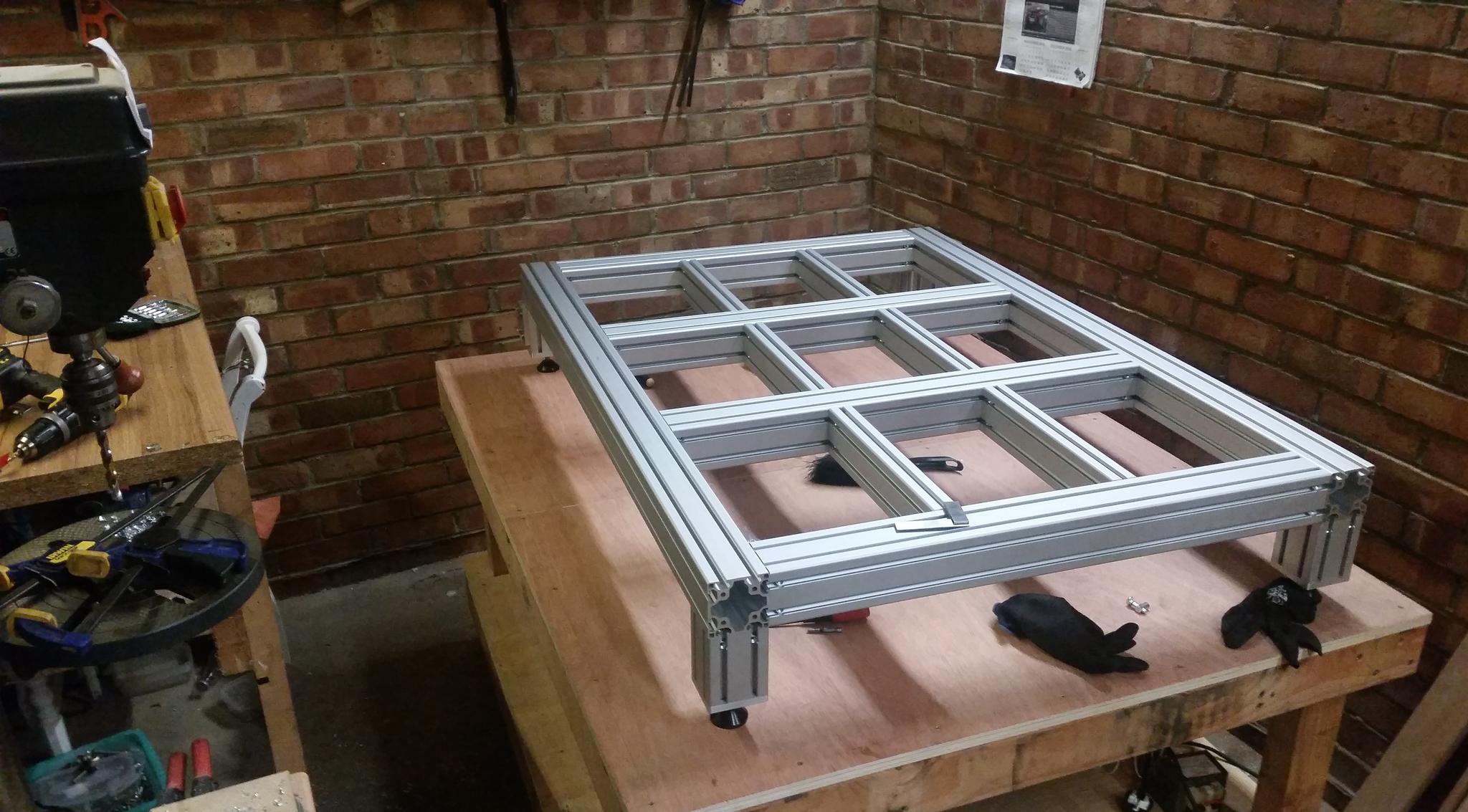

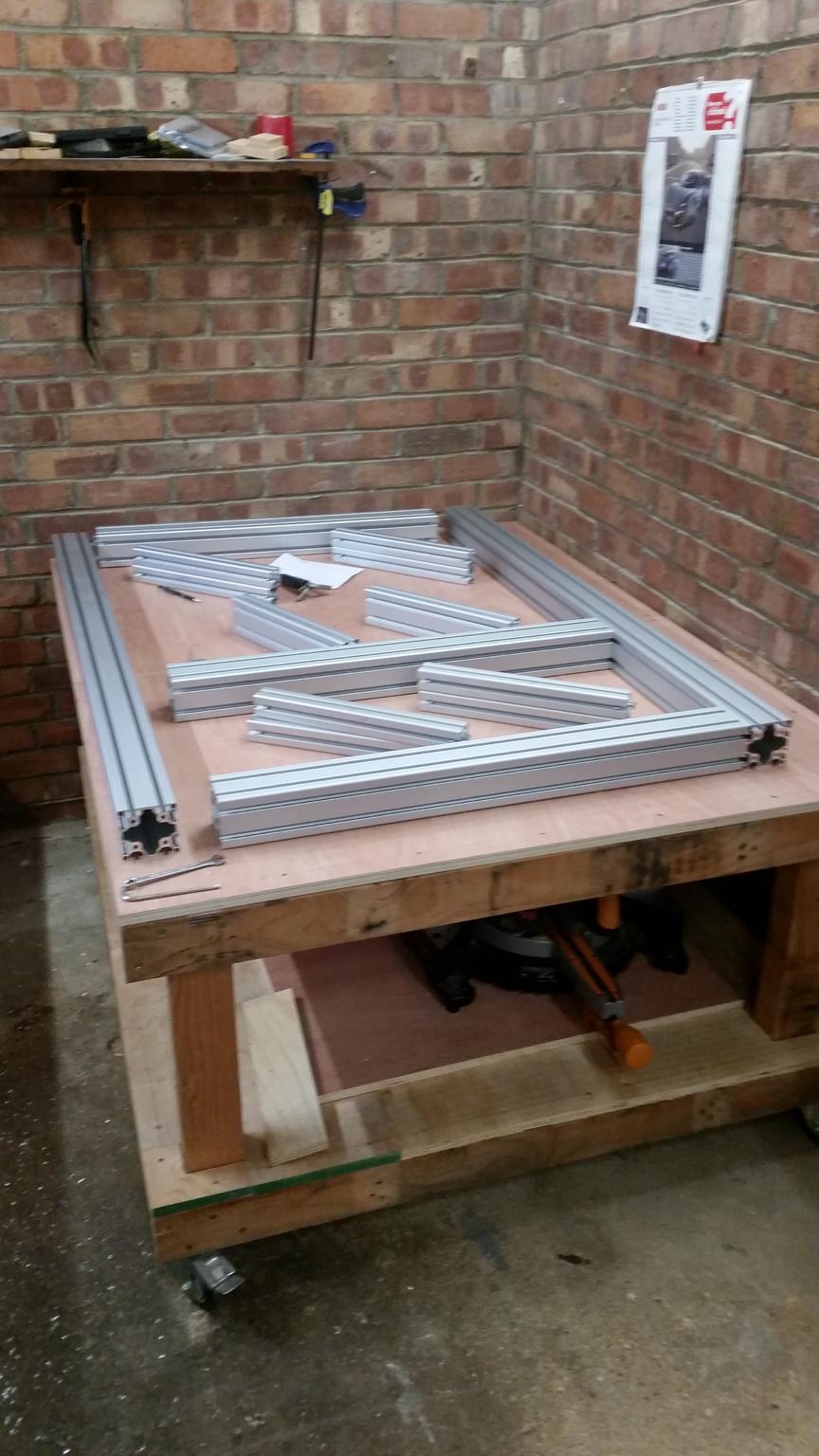

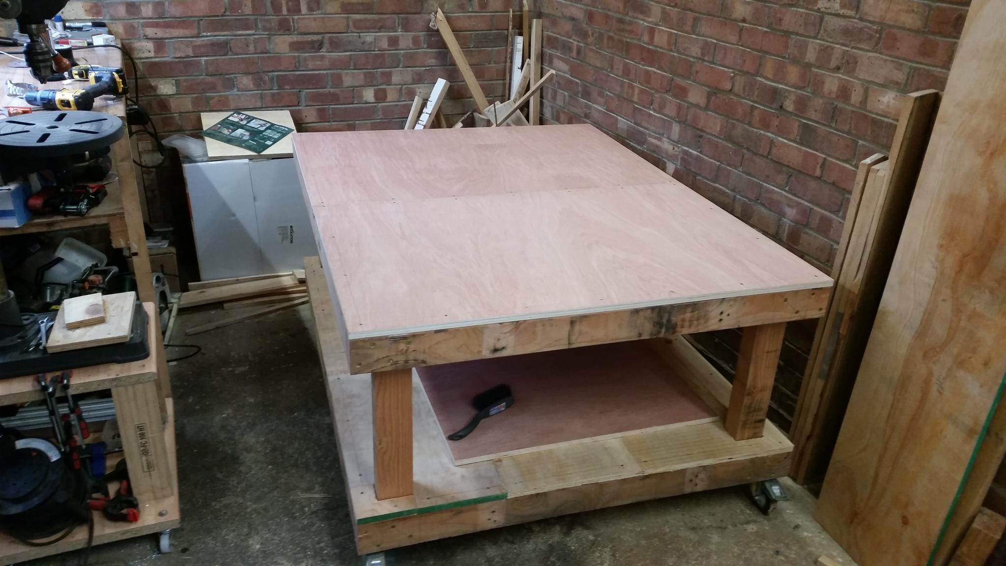

    Then built a bench for machine to sit on Click image for larger version.
ID:	20450 and started to lay the frame profiles Click image for larger version.
ID:	20451 after drilling holes for profile fixings i put them together and here is my base of the machine Click image for larger version.
ID:	20460Click image for larger version.

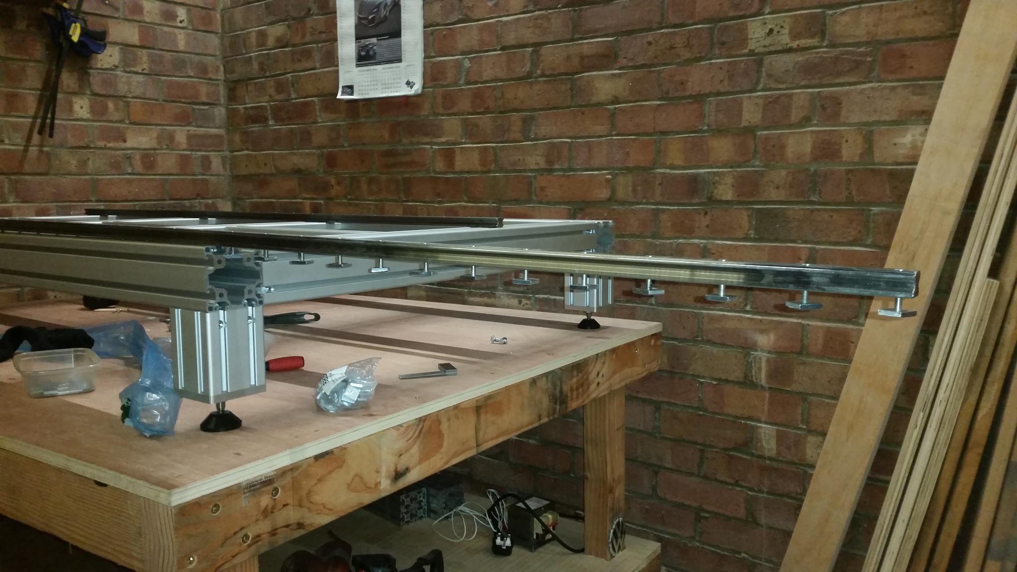

    After that folowed rails, cariages, plates, ballscrews, pulleys
ID:	20455Click image for larger version.

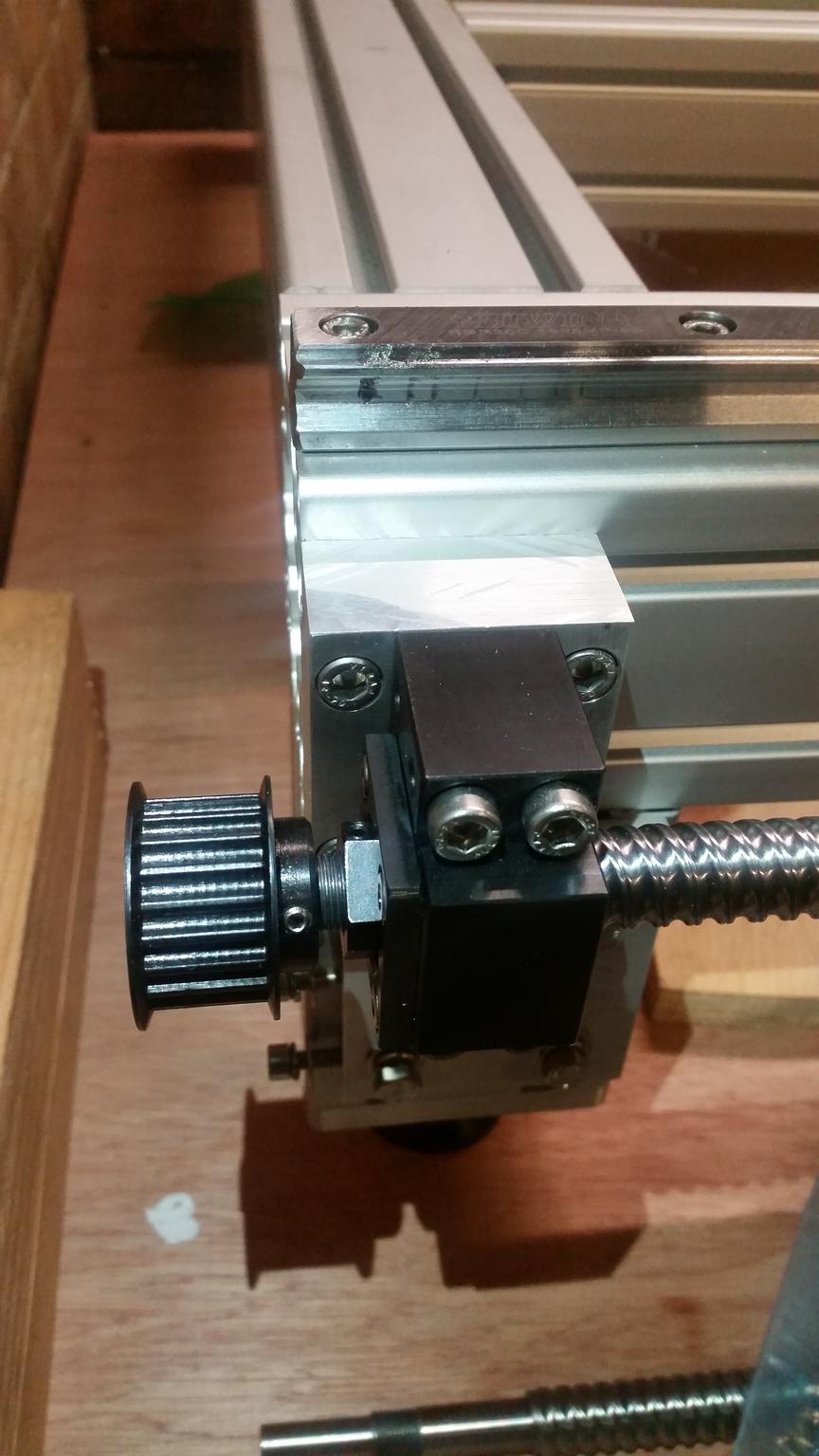

    when i was assembling bearing blocks when i put together bk bearing i have a gap between lock nut and pulley which i did not see anywhere in peoples threads, and i am thinking maybe i assembled them wrong ? everything is tight and there no playClick image for larger version.

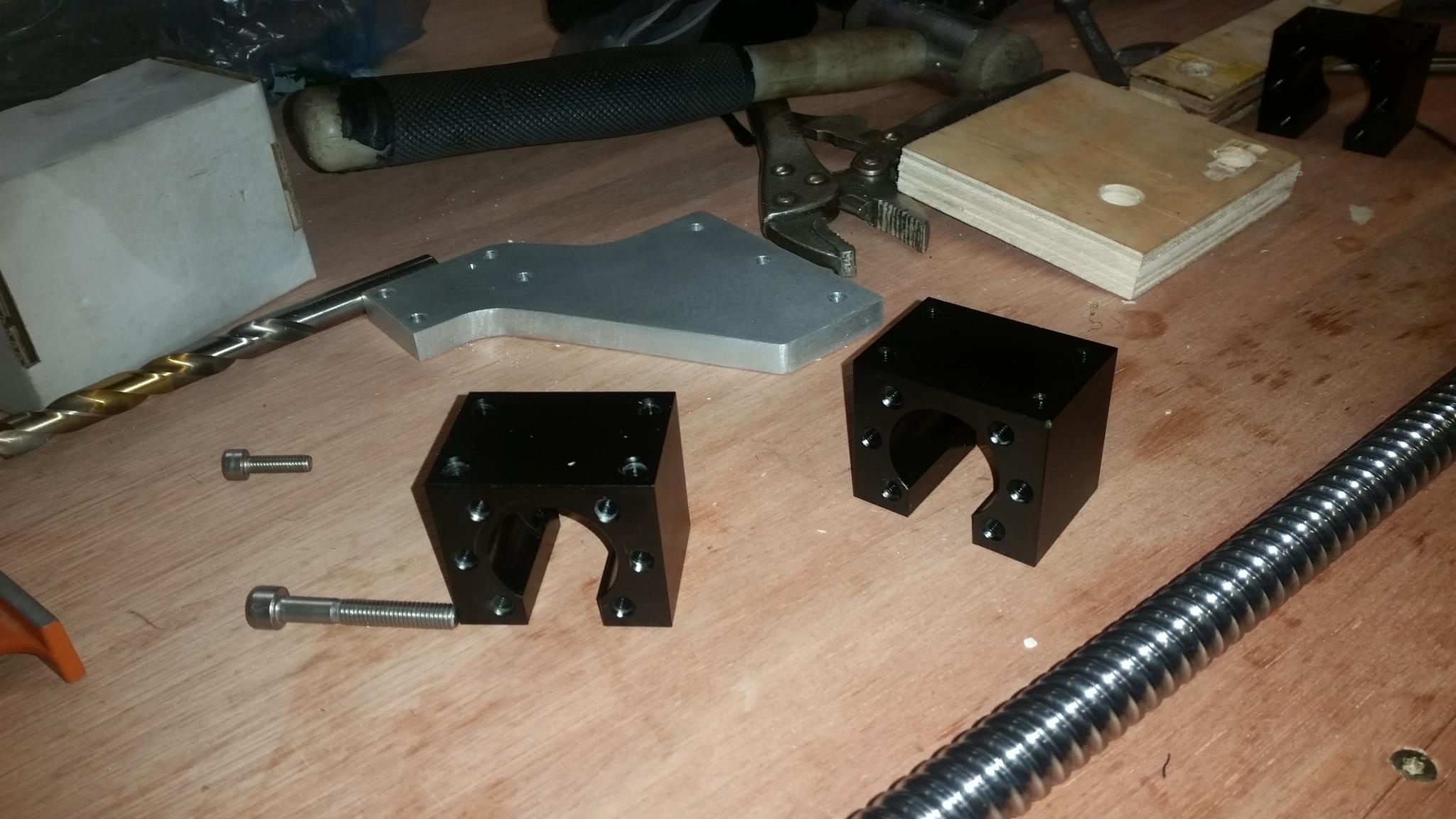

    Other weird thing is that i could not put all six screws through balscrew nut into its housing, holes doesnt align poperly. Once i put one screw i could not put second one because it just doesnt catch the thread. I have only one ballnut which took all 6 screws with no problems. Click image for larger version.
ID:	20458Click image for larger version.
ID:	20459 And i thought that is not a big deal i will just open the holes a bit more, but i couldnt do that because the metal is very very hard. Then i noticed that the "Good" ballnut has tapped hole in it. it must be oiling point, all other ballnuts doesnt have it. Any one had issues like that? I probably would need to contact Fred to see what he will say about it, I bought all components from him. Thats how it looks for today Click image for larger version.

  8. #67
    Looking very tidy well done!
    Gap between lock nut and pulley:
    That is not a problem. The lock nut is used to pre-load the angular contact bearings inside the bearing block by pulling the shoulder of the ballscrew against the bearing on the other side. If there is no axial play and they turn freely then all is well. The pulley is only held onto the shaft with one or 2 grub screws so it can go where ever you need it to align it to the belt. It doesn't need to butt up to the nut to function.
    Ballnut/mount hole alignment problem
    I've always made my own ballnut holders/plates, but for my current build I bought some of those C shaped ballnut blocks that you have in the picture. However, I've not looked to see if the holes are aligned. Next time I'm in the workshop I'll have a look. Also, all the ballnuts I've bought (various places including Fred) have oil holes so makes me wonder if the ones which don't fit (and don't have oil holes) have been "sourced" elsewhere and not been to the standard. Did Fred have a drawing of the ballnuts on Aliexpress? If you measure your part and it is not per the drawing it is worth saying so. Good luck with it - I've not had to return anything to him so I don't know how good his returns policy is . . .
  9. #68
    I contacted him, now waiting for reply. We didnt have any drawings it was only been said that ballnuts are comming together with ballscrews. But yes they are diffrent the flat side of the "good" ballnut goes flush with housing or lets say are in thevsame plane, whereas others has a step between them. Hopefully he will be able to send me the balnuts and i will just swap them.
    Išsiųsta naudojantis SM-G900F Tapatalk 4 Lt
  10. #69
    Fred is decent, i have had a couple of bits missing and one BK block was sent as a BF instead - in all cases he fixed the error, the only issue was the time delay due to distances.
  11. #70
    Quote Originally Posted by valdis034 View Post
    Put some pics up showing exactly what is wrong ie. is it the ball nut or the ball nut mounting that is wrong. I doubt he will just send a ball nut without the screw
