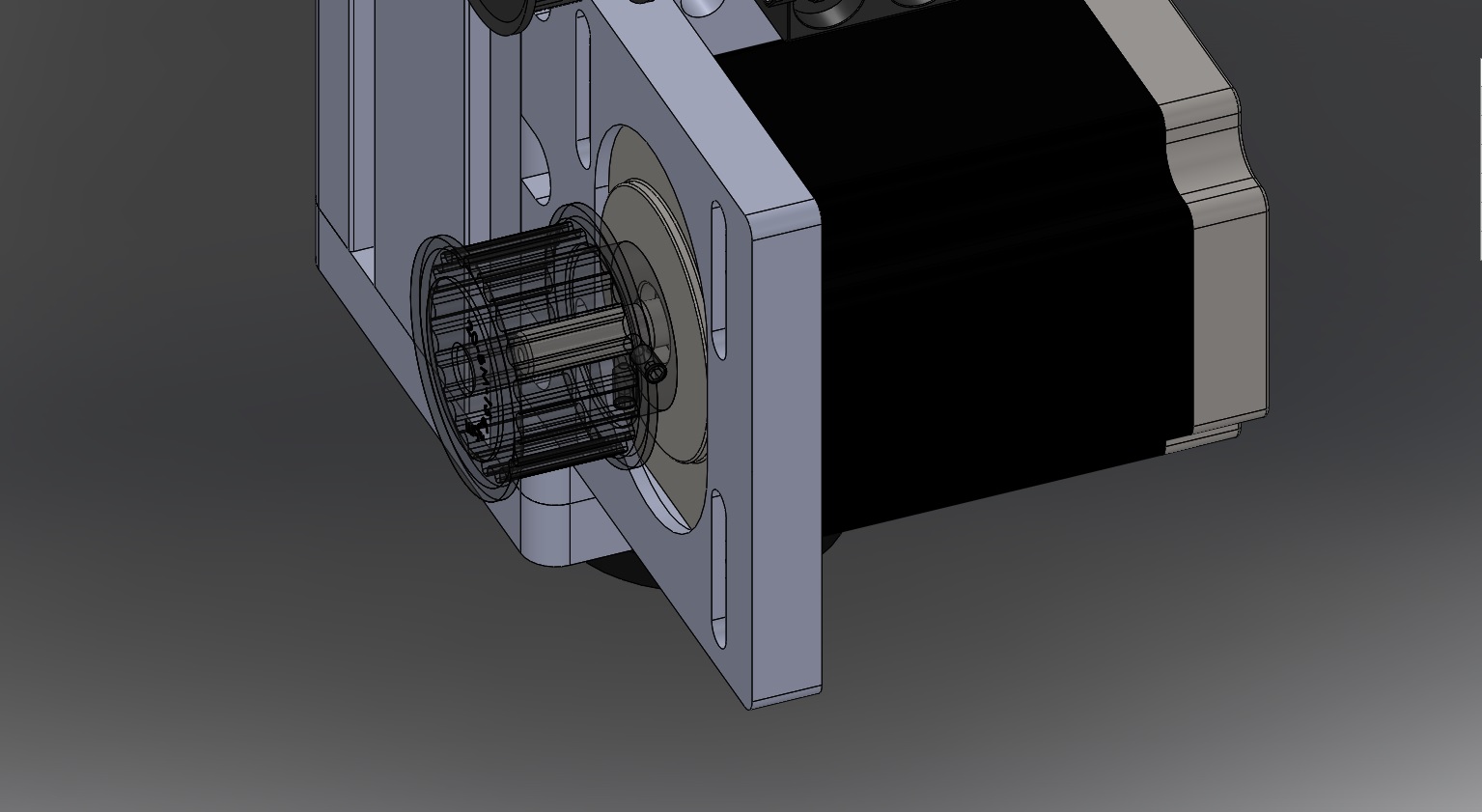

So do we actually need that thickness of a plate if anyway we are machining almost all the through the thickness?
Išsiųsta naudojantis SM-G900F Tapatalk 4 Lt
22-07-2016 #2
It has to have some inherent stiffness to stop any bending forces from the belt, I had it 20mm thick as it came out the same sheet as the rest and I needed the thickness to put the M8 bolts into....
