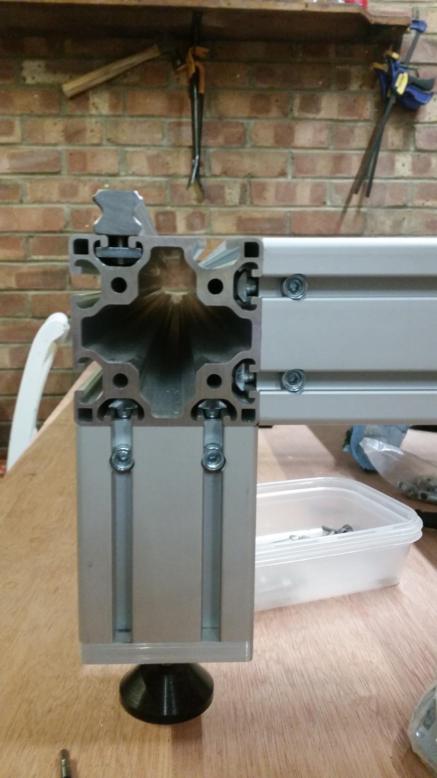

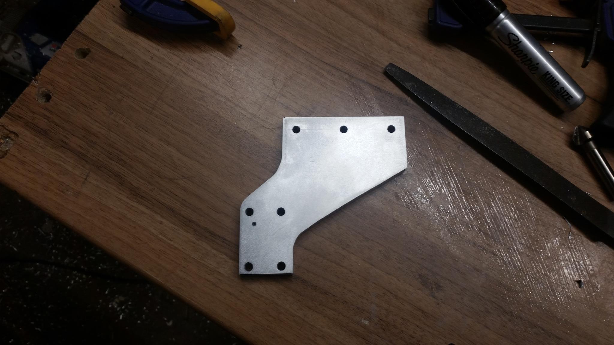

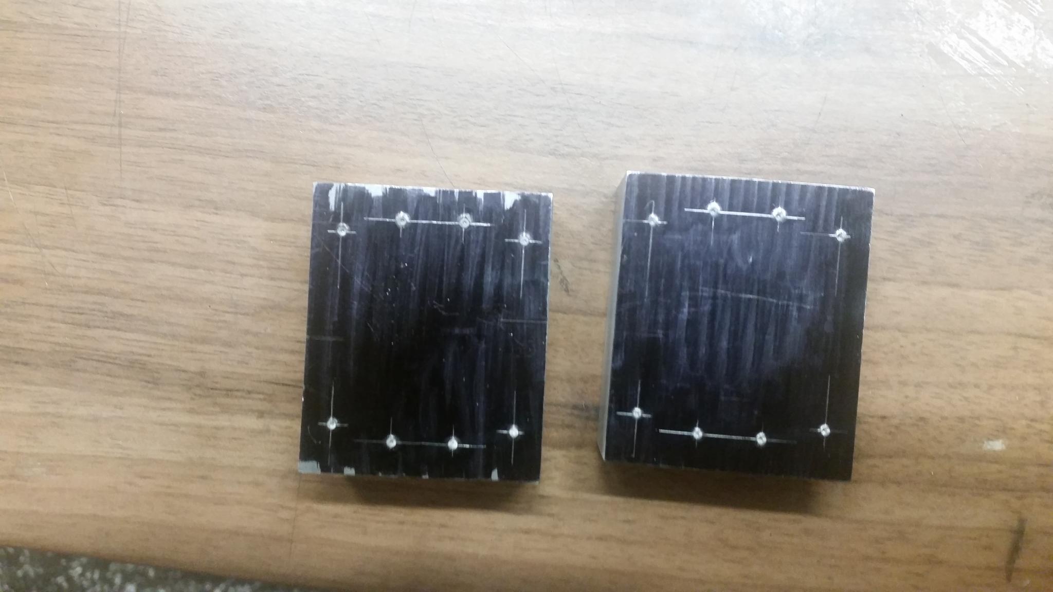

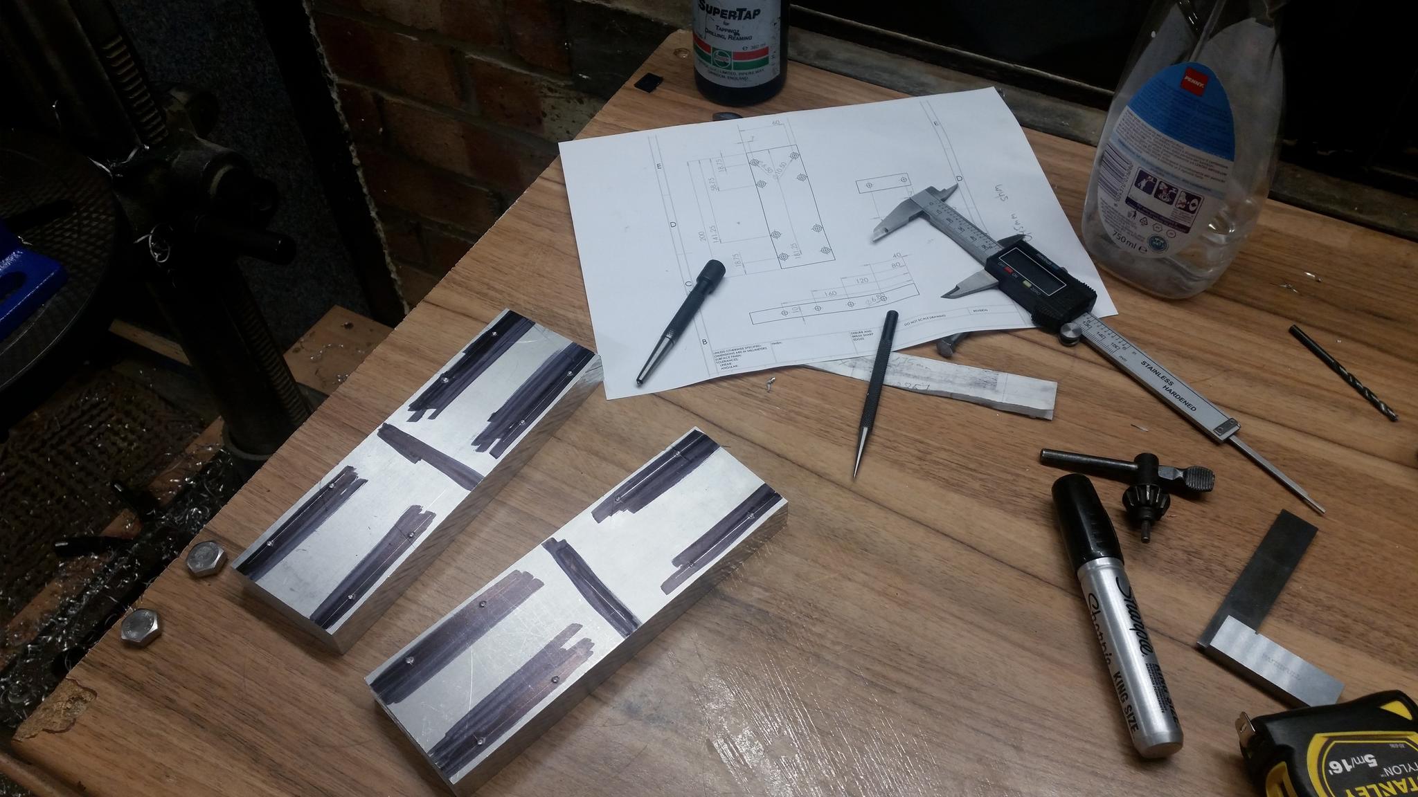

    Hello. Its been a while after my last post, but things kept moving a bit. Since that got aluminium plates, simple ones drilled and and tapped myself , more crucial parts like gantry sides, z axis plates, motor mounts will be machined by our guru JAZZ.

    Then built a bench for machine to sit on Click image for larger version.
ID:	20450 and started to lay the frame profiles Click image for larger version.
ID:	20451 after drilling holes for profile fixings i put them together and here is my base of the machine Click image for larger version.
ID:	20460Click image for larger version.

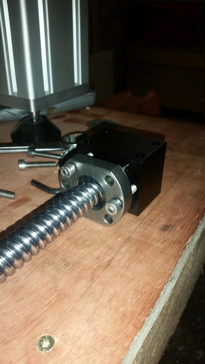

    Other weird thing is that i could not put all six screws through balscrew nut into its housing, holes doesnt align poperly. Once i put one screw i could not put second one because it just doesnt catch the thread. I have only one ballnut which took all 6 screws with no problems. Click image for larger version.
ID:	20458Click image for larger version.
ID:	20459 And i thought that is not a big deal i will just open the holes a bit more, but i couldnt do that because the metal is very very hard. Then i noticed that the "Good" ballnut has tapped hole in it. it must be oiling point, all other ballnuts doesnt have it. Any one had issues like that? I probably would need to contact Fred to see what he will say about it, I bought all components from him. Thats how it looks for today Click image for larger version.
