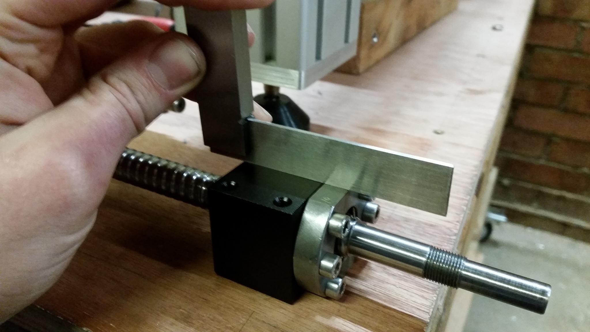

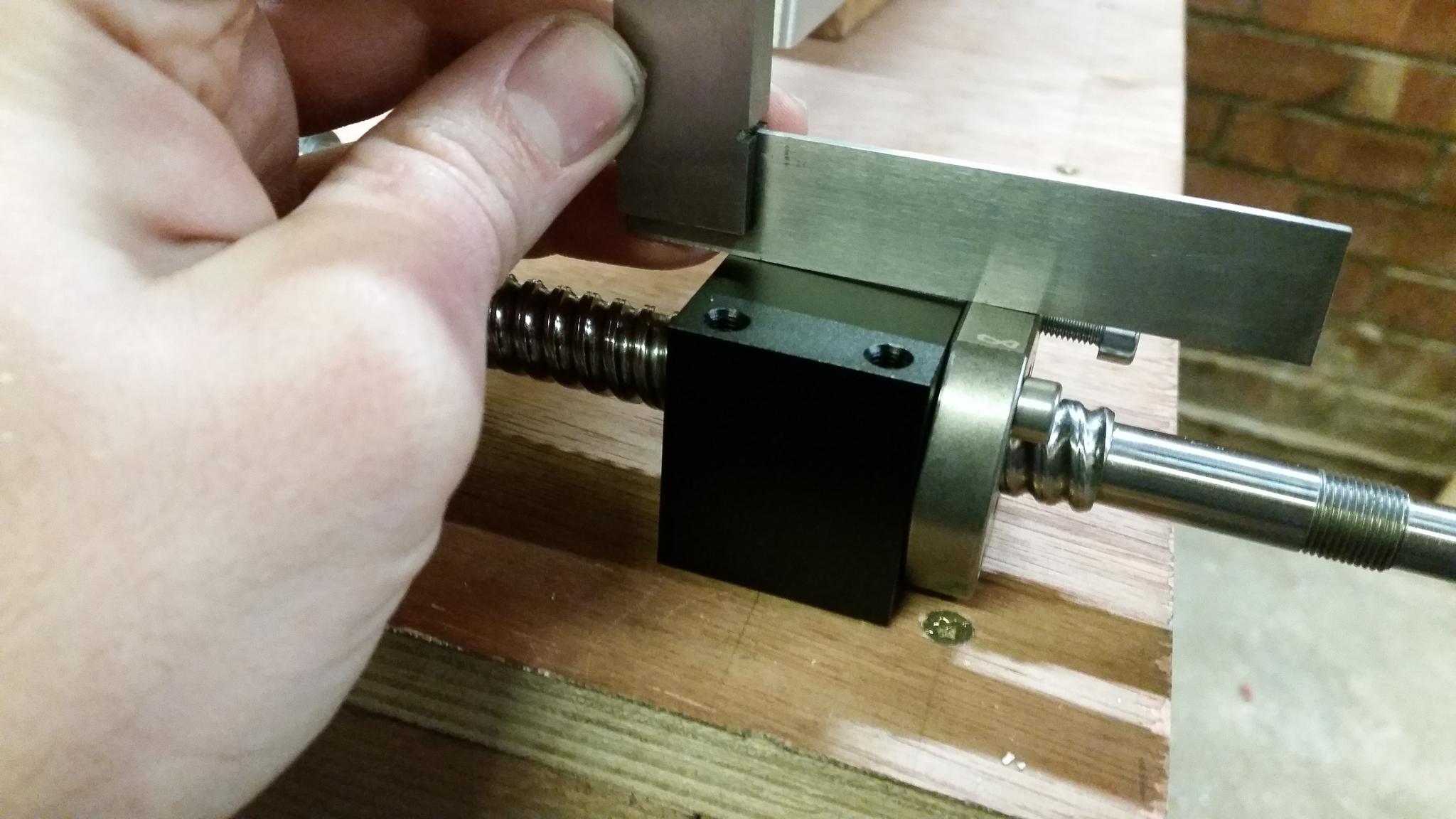

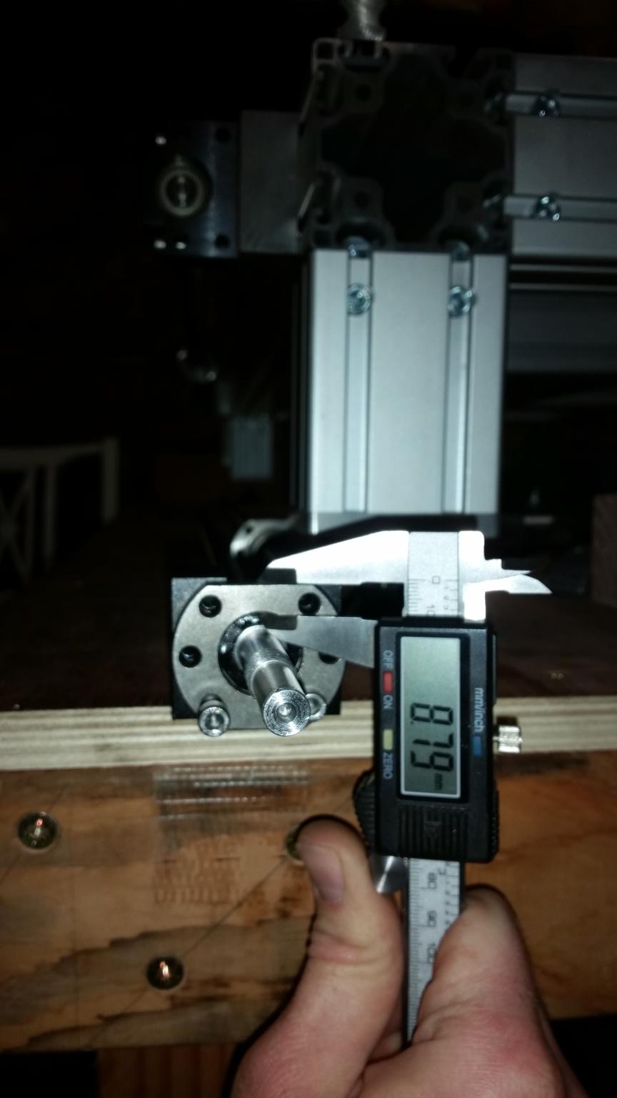

    Put some pics up showing exactly what is wrong ie. is it the ball nut or the ball nut mounting that is wrong. I doubt he will just send a ball nut without the screw
    Here are some pics. I think whole centre hole for ballscrew is off center, thats what causing missalignment.

  3. #73
    Hi Valdis
    Machines looking good.
    If you have a couple of V blocks you could support the screw in the blocks and put a DTI on the diameter that inserts into the block rotate the nut and record the runout. no idea what the tolerance is for the positioning of the flats but it could be +/- 0.5mm from centre. Dean might be able to better advise, as he is working with this stuff all the time, but if you measure as directed you have better information to give to Fred.

  4. #74
    So here it is. All I can say Fred is top man, he takes all responsobility for that. His prices are a bit higher, but his service is awesome. Here are his last emails:
    "Hi Valdas,
    Thanks for all your help.
    So sorry for the inconvenient to you,it is my first time to aware the ballnut size may have error possibility.
    You are correct,seems the whoel centre hole are out of the position,the ballnut are produced in bulk quantity,I guess there may have some other wrong size ballnut went into market :(
    I sincerely apologize for the problem to you,generally I will test whether it is in smootly running and the backlash,not measure size in before time,could you please tell me which the length for which 3set ballscrew have problem?I guess maybe all for 1610 model?
    As now we are in holiday time,and here it is my opinions,
    1)If you can waiting and build your machine in the later of next month,
    Then I will arrange new production for you once back to office around on Feb.10,and hope can delivery around on Feb.12,if everything going well then shold can arrival on Feb.20.
    2)If you need start your project as soon as posssible,
    Then can check what's the selling price in your local market for similar Chinese ballnut?I know it will much higher than we selling,but since it is our mistake,so we have to afford all the responsbility,in order not influence your schedule too much,if you can get the ballnut from local market,no matter how expensive will be for the similar Chinese ballnut,I will pay for it.
    Another question,are you skilled to install new ballnut?guess you know,the ballnut can't remove or install directly if there is no some tube between the ballnut,that means there must have something(like tube) in the middle of the ballnut,to prevent the inside steel balls dropp,and if you buy ballnut from local market,it is not 100% sure can be use directly,may need adjust the backlash to suitable according change different size steel balls.
    If you didn't install the ballnut and adjust the bachlash in before time,then we will send the new ball screw with ballnut together to you,or you can buy the completed set for ball screw and ballnut together.
    You can do it in any convenient way for your project.
    Sincerely apologize again.
    Best wishes
    Fred
    [email protected]"
    Another one:
    "Hi Valdas,
    Thanks for your kindly waiting,really sorry for delay your schedule,in order to aviad the the new ballnut not in correct backlash in your present ball screw,I think we'd better delivery the completed set to you,so I will arrange the ball screw with ballnut together for the new delivery.
    Will arrange the production work once back to office."
    So actually i will get another set of ballscrews the only downside of its the time.

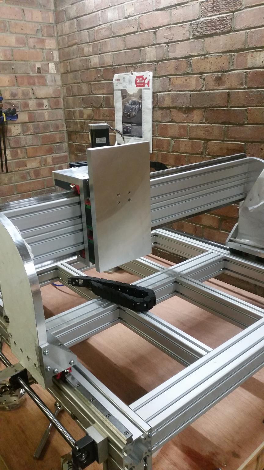

  7. #76
    Hello. Coming back with some updates from my build.
    So the news shortly are that mechanically machine is done, and partially wired. Now it will be time for the electrical drawings, laying out components buying some of them, mounting everything into electrical boxes..
    Some progress photos:

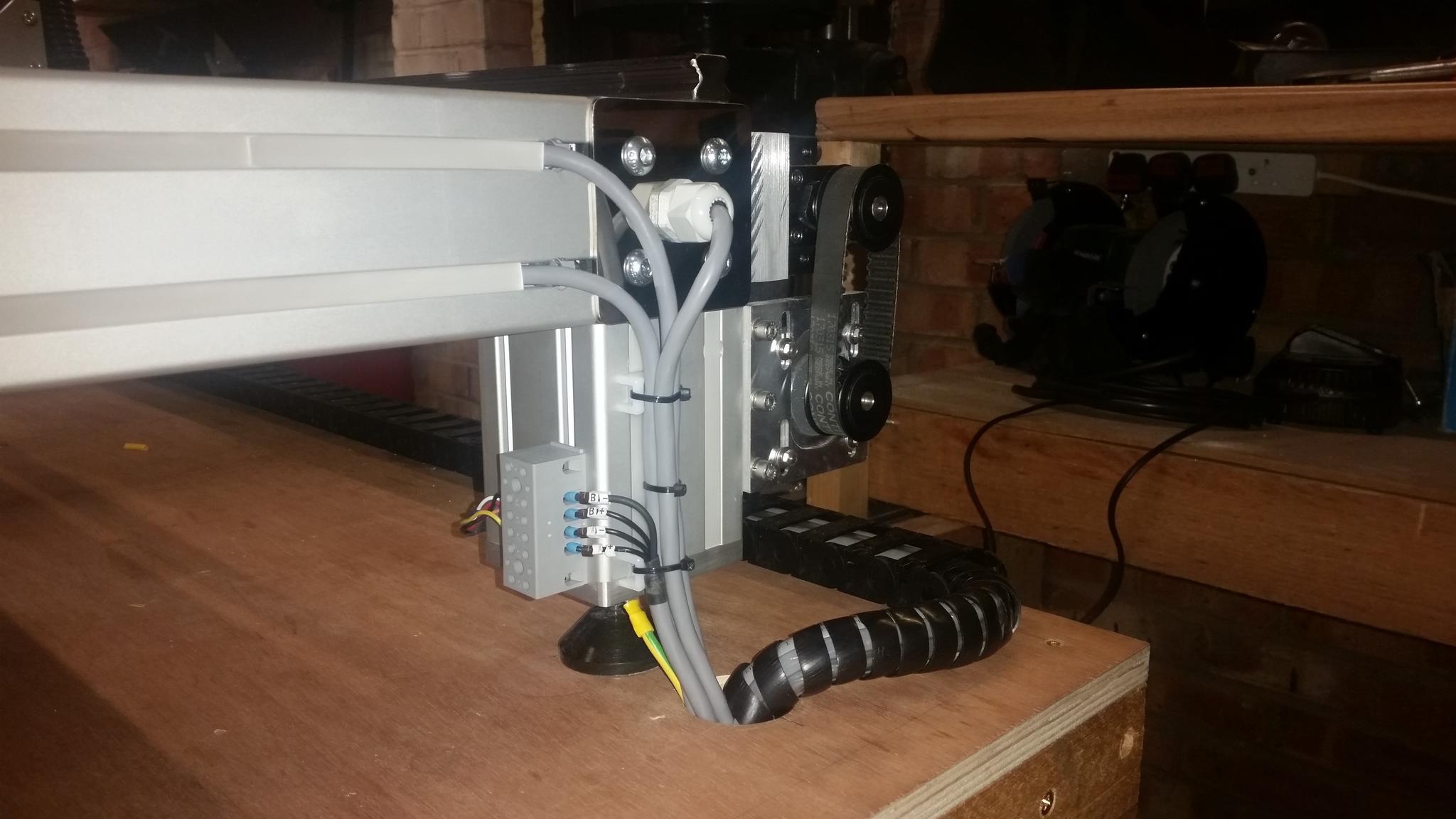

    At the moment I ended up with some cables which will need to go to two control cabinets. Two because one is not enough which I got initially, so I got another one the same size, so I am thinking to have mains voltage distribution, for pump, powers supply, and vfd in one box and all the electronics to have in another one. Click image for larger version.

    Now I will be doing a bit more reading about electrical side, try to draw some drawings. Have couple of questions for now
    1. About x axis (long one ) home and limit sensors. As I am using one sensor for homing and limits I will have senor traveling with the gantry (one sensor on each side of the gantry) and it will see a bolt in the extrusion channel in each end of the machine. How will I make them bolts in each side to be in exactly the same position so gantry will be square when it reach the sensors?

  9. #77
    You will need to be able to adjust one of the bolts when the machine is built so that you will be able to square the gantry by moving it one way or the other. In Mach3 you will set it up with homing and shared.
