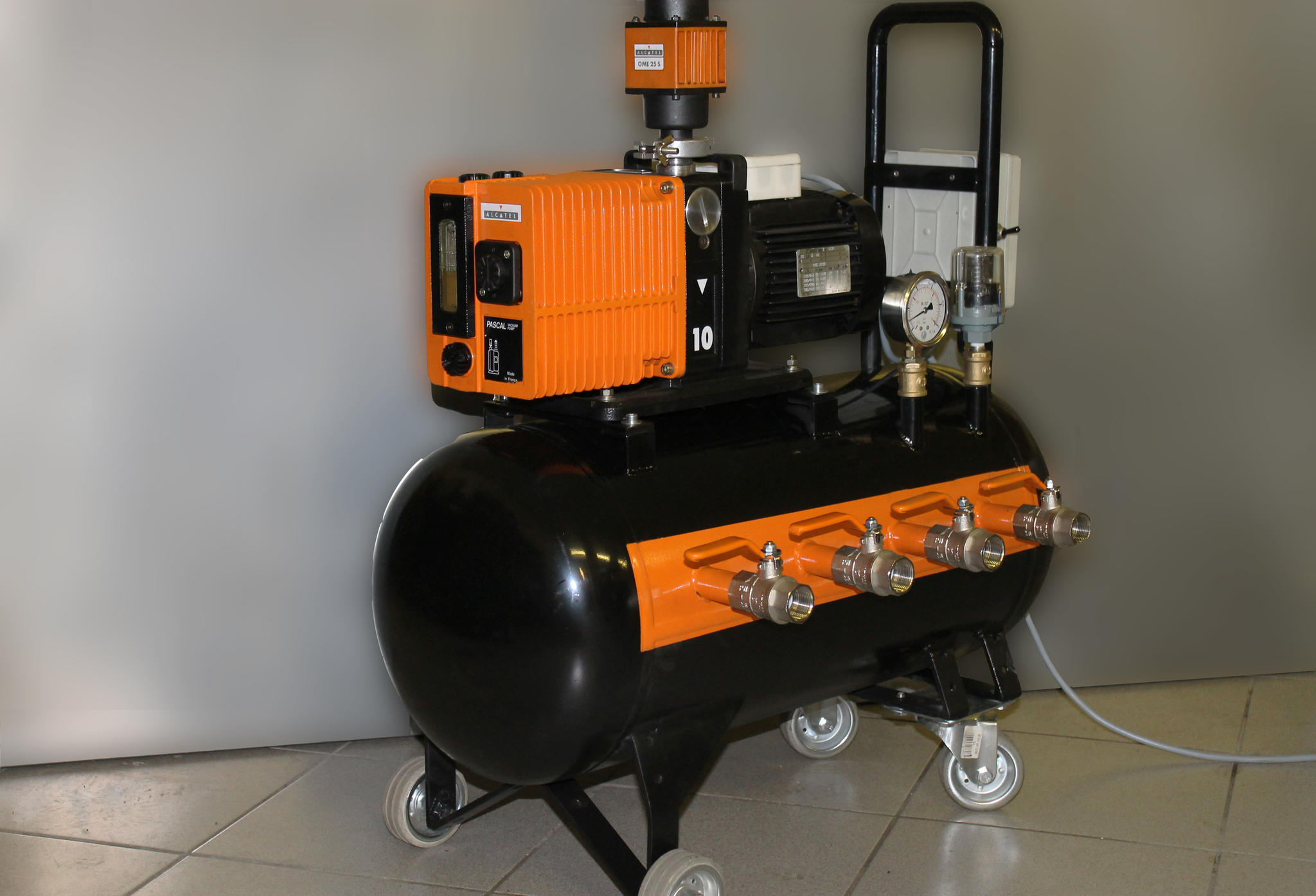

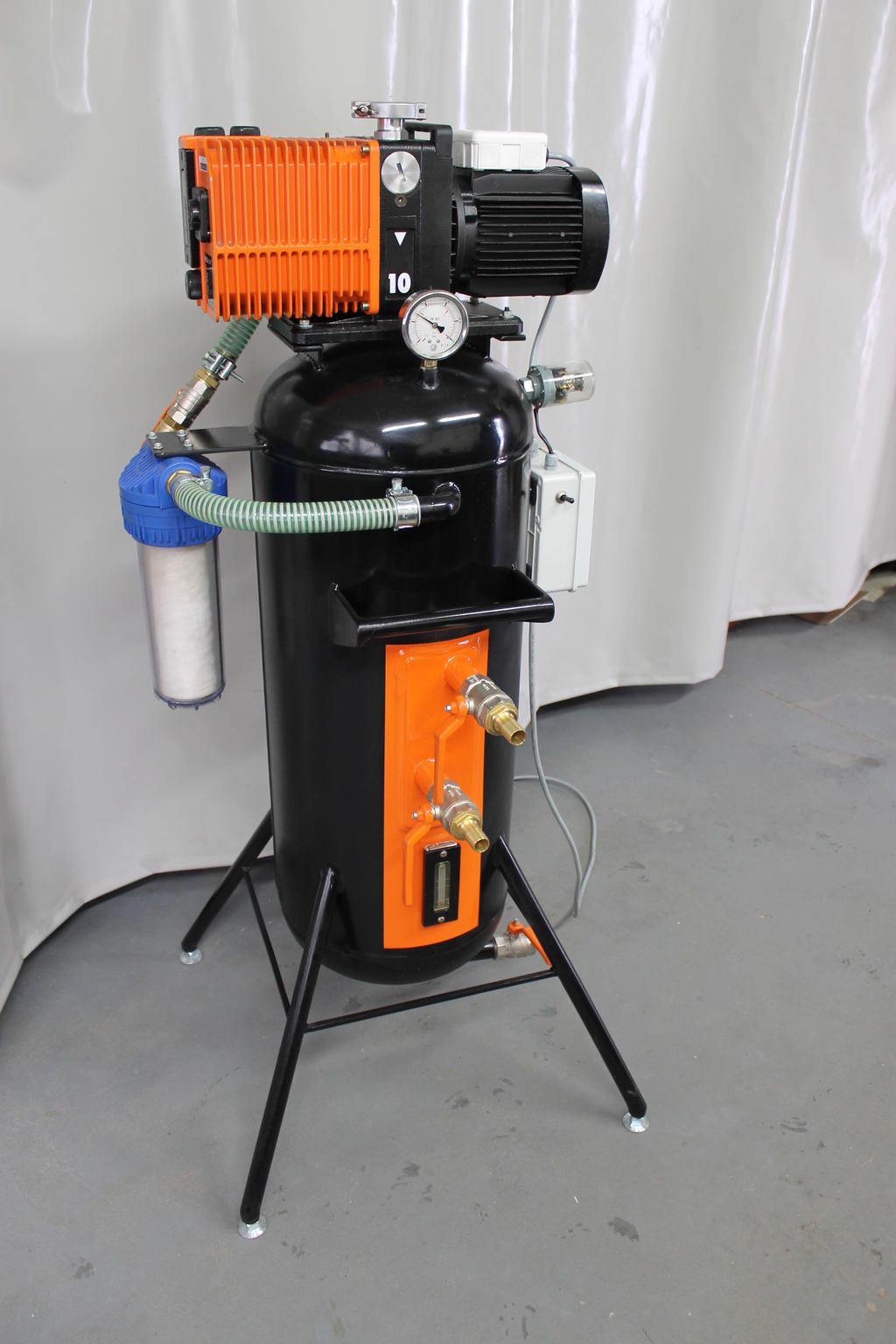

    follow up of this thread about vacuum pumps and this one for vacuum fixtures, is that i bought the Alcatel 2010 /7 cf per min/ vacuum pump from ebay and am waiting for it come next week.
    I bought it altogether with original exhaust and the clamps. Was going to do it with 2 capacitors but right now Arturas / the guy selling them/ offered me Eurotherm VFD, so i will buy that also from him. By the way, very helpful and knowledgeable seller. Plus i have seen the pumps he sells and they are excellent.
    So later will be some photos of my setup, but more or less i will follow what Arturas makes. take a look at the photos he send me of his Vacuum stations. BEAUTIFUL!
    So now i will go out for orange paint and start destroying an old compressor to give it new life :-)
    Notes:
    -I was thinking first to use directly the pump, no deposit, but when i saw those beauties, i decided to make one
    -The good thing of this system is that its silent and only 0.37kw for 7cf per minute. aint that great + the deposit...
    -Now the capacitor thing will not work for me. Due to the need to automate things. The capacitor thing is cheaper but i have to be present to switch start and run capacitor manually. Not so with the VFD
    What you say guys?
